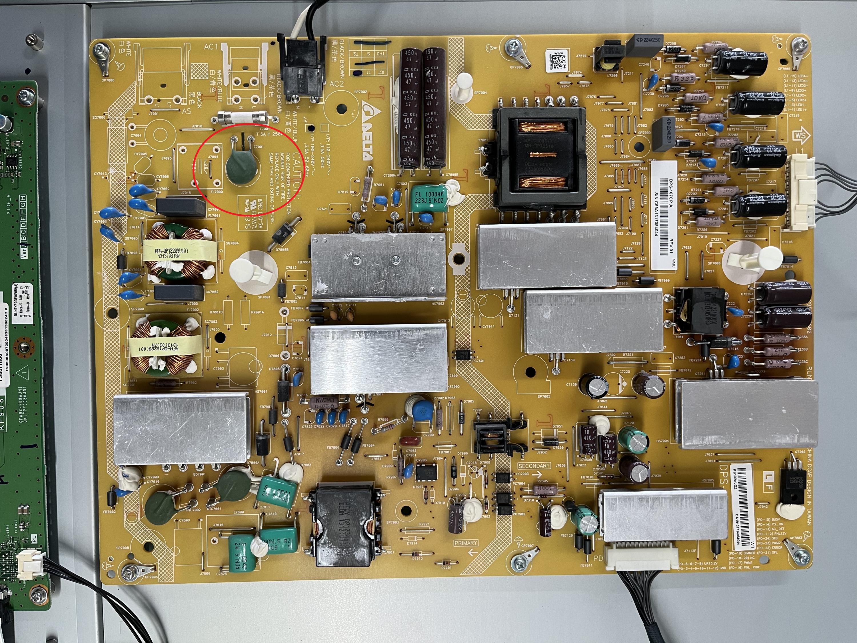

    LC-60LE550U No Power
    When I check Z7001 (I cant remember what its called. Is it a thermistor?)I am seeing 123V when measured across both terminals and it also reads about 2M ohm. Thats bad right? How do I determine the replacement value. The board has zero voltage except across the input and the fuse.

    Re: LC-60LE550U No Power
    thats your metal oxide varistor, just measured the one on my bench, its about 1 m ohm, the other similar looking component that sometimes gets confused with it is an ntc which is a thermistor, those are about 10 ohms.
      yours looks to be ok.
        to test you just measure resistance, thats ohm scale, high reading varistor is good, low ohms means its bad, ALL ohm readings are done with tv UNPLUGGED from power.
          OK. thanks for the info.. Its measuring 1.6M ohm
          Any suggestions of what else to check?
