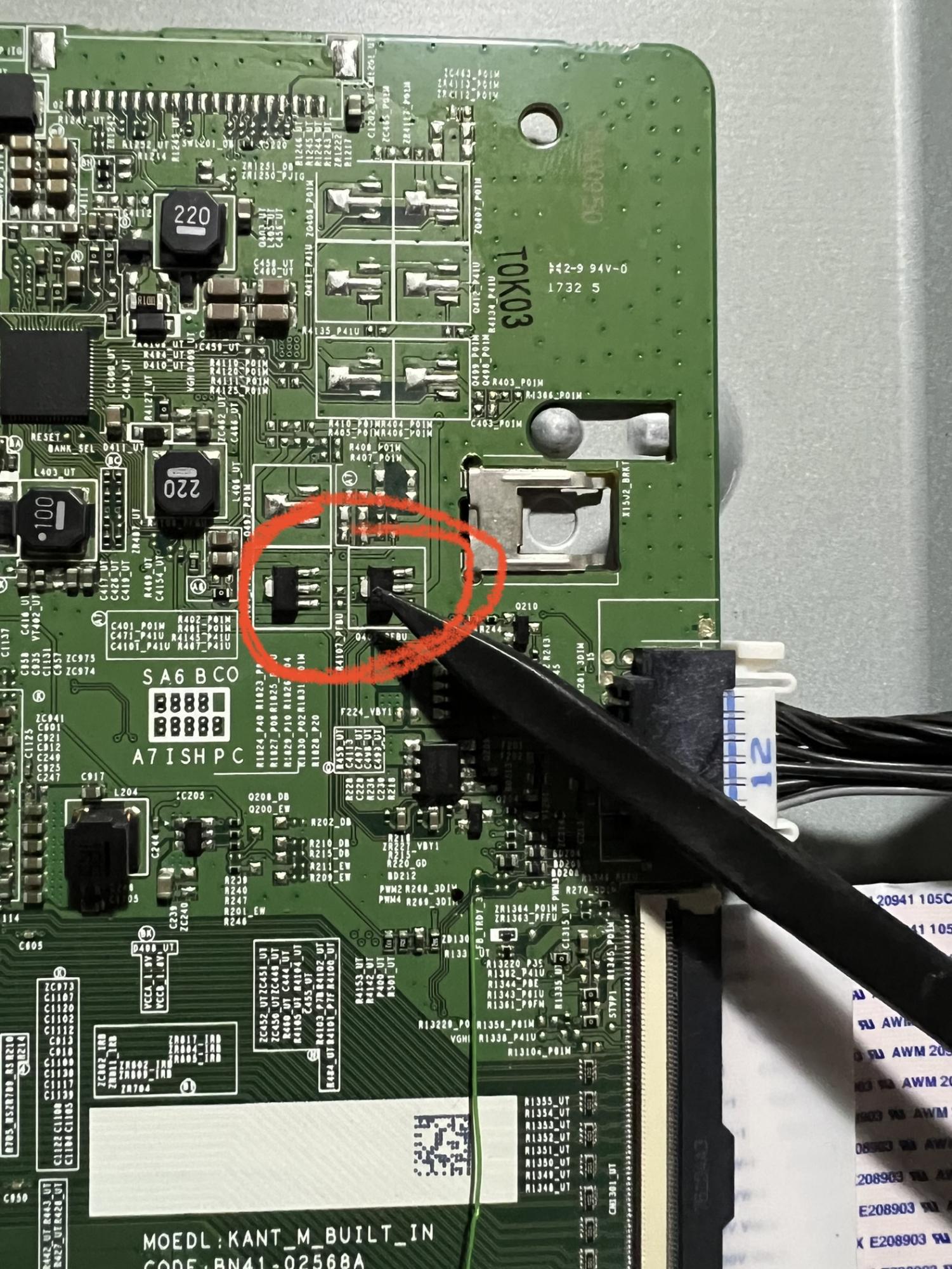

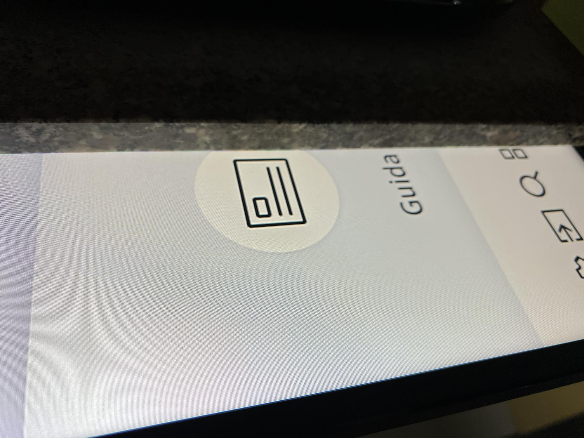

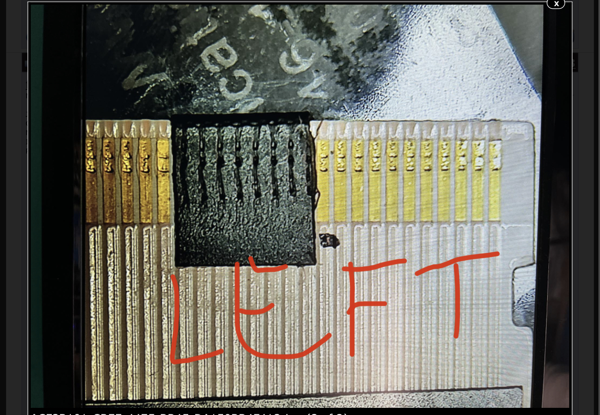

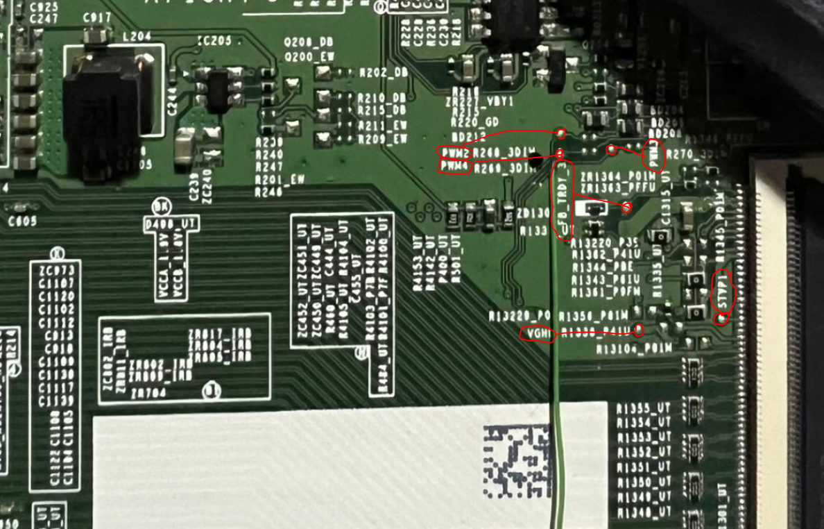

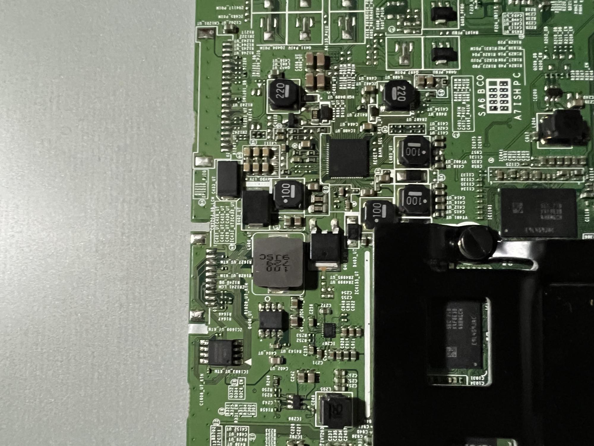

Re: Samsung UE55MU6120K Boot loop with backlight no video
according to your photo then I made the bridge between pwm4 and rdy1, how can it be that it works now? it's still on without the jumper
Update
take some current photos with the TV on, the temperatures seem perfect both on the motherboard and on the flats of the right and left panel cards which are usually always hot
Samsung UE55MU6120K Boot loop with backlight no video
Re: Samsung UE55MU6120K Boot loop with backlight no video
yes, it seem the correct T-RDY3 point is the one marked by Lotas, not so easy to understand..
Don't expect it will work for long time.. something wrong may exist too..
Let us to know how it goes, i'm much curious..Last edited by Davi.p; 02-24-2023, 12:20 PM.Leave a comment:
Re: Samsung UE55MU6120K Boot loop with backlight no video
I have an update, as usual strange things only happen to me, I left the TV off for 3/4 days with the bridge on points RDY1 and RDY3 today I borrow a friend's thermal imaging camera and turn on the TV (with the bridge and the connected flats) and immediately after 1 second I see these 2 components (in the photo) heating up so much, I disconnect the bridge and turn the TV back on and it works, the whole display works, you seeLeave a comment:
Re: Samsung UE55MU6120K Boot loop with backlight no video
I check as soon as possible, I test as soon as I can with a bench power supply and you updateLeave a comment:
Leave a comment:
Re: Samsung UE55MU6120K Boot loop with backlight no video
is there any 1,8v? you must check which of these two voltages are present on the smaller caps near the source cofs therefore the ribbons on the bottom side, that tension must be provided constantly to the panel toghether with avddLeave a comment:
Re: Samsung UE55MU6120K Boot loop with backlight no video
the 3,3 are present only for a moment as the tv restarts every 2/3 secondsif masked avdd or vcom the mainboard circuitry goes in trouble and reboots, injecting on avdd can pop a suspected bad cap so you can replace it, but 12v are enough, the important is that 1,8v/3,3v must be present, therefore cof are powered.. prepare to switch off everything when you see smoke, but pay attention first on screen's glued ribbons, them must not burn!Leave a comment:
Re: Samsung UE55MU6120K Boot loop with backlight no video
if masked avdd or vcom the mainboard circuitry goes in trouble and reboots, injecting on avdd can pop a suspected bad cap so you can replace it, but 12v are enough, the important is that 1,8v/3,3v must be present, therefore cof are powered.. prepare to switch off everything when you see smoke, but pay attention first on screen's glued ribbons, them must not burn!Leave a comment:
Re: Samsung UE55MU6120K Boot loop with backlight no video
the question is isolating those 2 lines (avdd and vcom) shouldn't it turn on and not restart if the short is there? do you think the short could be on avdd? so your suggestion is to inject the 15v directly on one of the two display boards with everything connected?Leave a comment:
Leave a comment:
Re: Samsung UE55MU6120K Boot loop with backlight no video
please excuse my stupid question
But to really rule everything out please tell me which photo is which cable and if it is mainboard side or gate driver side.Leave a comment:
Re: Samsung UE55MU6120K Boot loop with backlight no video
for information when I did the tests with scotch tape I also isolated the vcom and avdd signal and it always restartsOk, so without a bench PSU i can only suggest this type of test, remove each one of the diode packs on the screen's boards, test entire tv after each removing, if it doesn't change (i think is not there the problem), repeat same thing also with the bigger caps that are probably on the Avdd/15v line..
just to be clear, the buzzing noise confirms that there is a short circuit on the screenLeave a comment:
Re: Samsung UE55MU6120K Boot loop with backlight no video
Ok, so without a bench PSU i can only suggest this type of test, remove each one of the diode packs on the screen's boards, test entire tv after each removing, if it doesn't change (i think is not there the problem), repeat same thing also with the bigger caps that are probably on the Avdd/15v line..
just to be clear, the buzzing noise confirms that there is a short circuit on the screenLast edited by Davi.p; 02-22-2023, 02:48 AM.Leave a comment:
Re: Samsung UE55MU6120K Boot loop with backlight no video
read above, united points (the correct ones I assume because without flats they don't restart), with all flats the result is that only once it doesn't turn off, it keeps restarting with the variant that emits a bad buzz in that area of the motherboard , all components are cold except for the cpu which is slightly warmLeave a comment:
Re: Samsung UE55MU6120K Boot loop with backlight no video
so to be more clear, TRDY jumpered , but not the ones told to you by Diah, the ones actually marked as them, no tape on the flats, and it keeps restarting? i don' think so, i remember you posted only one picture clear of TRDY point, and the other one?Leave a comment:
Re: Samsung UE55MU6120K Boot loop with backlight no video
kept on even more than 3 minutes nothing heats up on the display board, in fact I tried 5 times, 4 times the TV restarts the same repeatedly, only once it stayed on, the only thing I noticed was a hum in this area but nothing elseLeave a comment:
by TakeatrySamsung QLED QN50Q — purchased 2022 started experiencing a delay in the picture coming on in the morning less than 2 years later. Did not know the term boot loop at that time. As the loop delay ran into a few minutes did all the recommended troubleshooting, soft and hard reset, changing cables and outlet locations, no help. As the delay increased contacted Samsung tech group and allow them remote access the tv. Tech was moving too fast to see exactly what he was doing but this ultimately it was also no help. Lived with the delay until it stretched out over 6 hours. Pulled of off the back cover...2 Photos
by torchzackHi Team - just joined to see if anyone can offer some expertise in diagnosing an issue with a TV.
I've done a few hours googling and youtubing but just seeing if anyone has any insight here. I got a 55" Samsung UE55MU6470U which seems to boot loop and then after 10 mins will boot, work for a few minutes, then turn off and repeat.
Whilst it's on into the normal Samsung menu/boot screen it looks perfect - so I can't see there being any screen issues. I've seen lots of videos with taping across clock lines to diagnose which particular one may be an issue but i don't... -
by NolesFanHello all... TV started boot looping. Opened the back panel and tried to isolate the problem. Just PSB no boot loop. PSB and MB no boot loop. Plug in the LVDS from panel to MB and boot looping starts up. It doesnt matter of order that I plug the LVDS ribbons back in, only 1 and no boot loop but as soon as 2nd one plugs in boot looping. I then noticed a flicker on the screen when I was closing the clip on the harness to the LVDS. Shut the lights off so I can see better, and I noticed as i slowly close it, I will get a picture, but as soon as it clips in, I lose picture and booting happens. So I...2 Photos
by eigmaHi, I rescued a Samsung UN40H5003AF (H = 2014 FHD) from the curb. Symptoms are: standby (red) light comes on, stays on for 8 seconds, flickers off, then comes back on, and the cycle continues.
Service manual: https://www.electronica-pt.com/esque...is-u8la-71272/
SMPS board: checked voltages, all seem normal (A13V = 12.8V, UD = 3.3V, PWM_BLU = 0.77V, PS_OnOff = 5.5V). Remove 10p cable to main board -> backlight comes on. I think this means SMPS board and backlight are good.
Main board: BN94-07592P / BN97-08922R...1 Photo -
My Samsung TV had a black patch on the left side of the screen for a while. One night it shut off and then became stuck in a boot loop. I initially believed the back-light was the issue and replaced the LEDs but it still boot loops. I've since replaced the main board and the issue persists.
With the main board unplugged, it powers on and the back-light comes on. I've tried the tape method but I gave up as I don't know what pins I need to cover.
I suspect the panel itself it broken but have no multi-meter to test. Is it worth investing in one to test?... - Loading...
- No more items.
Leave a comment:
