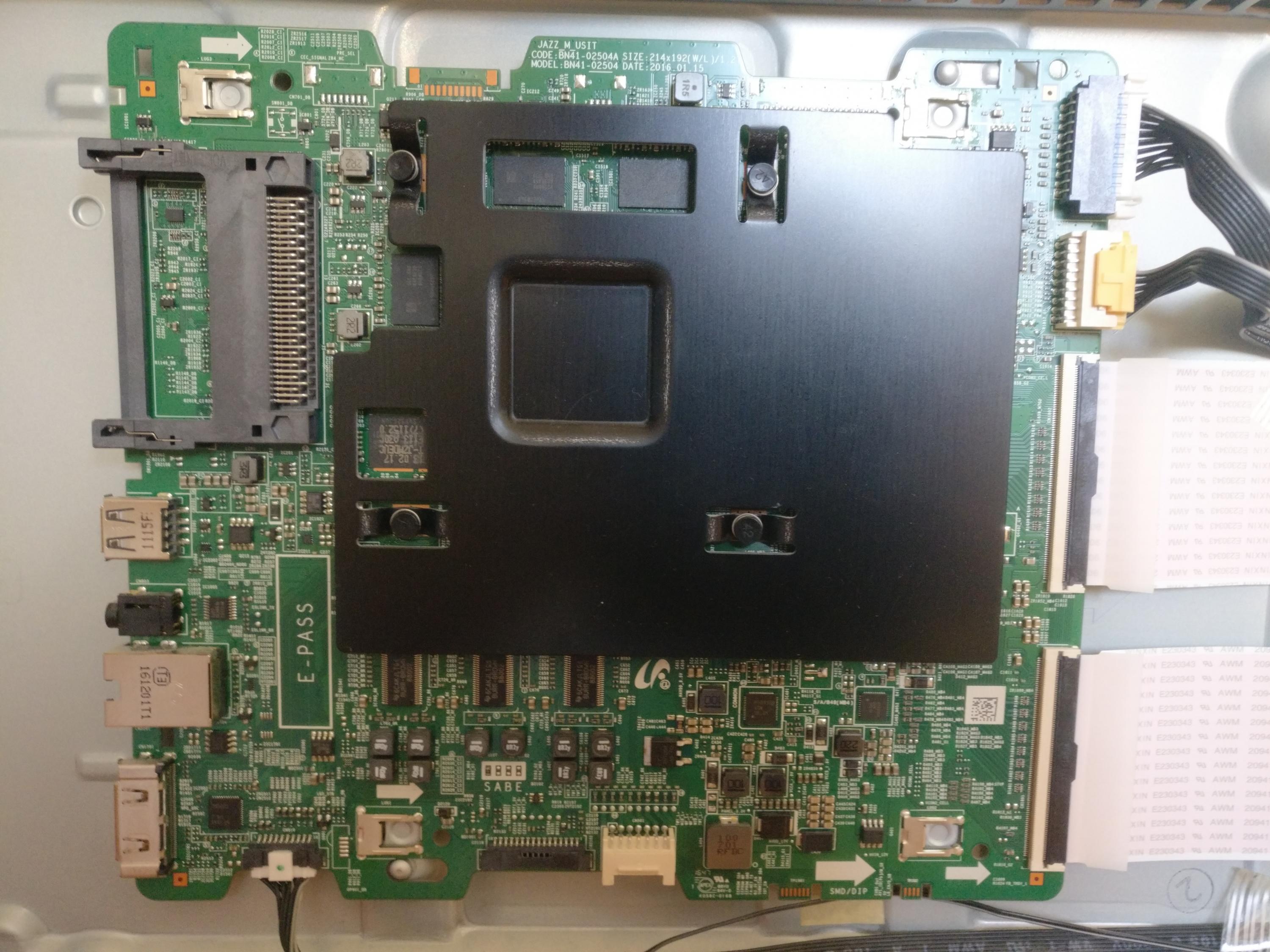

    Hello!
    My second TV to fix, first one was a success So the problem with this one is the power cycling. At first I did the led test, plug out MB (mainboard) and plug the powercable. Backlights turn on and TV stays on.
    At the moment MB is plugged in, standbylight turns on, TV turns off for a couple of seconds and then tries to start. Backlight flashes bright, dims out and TV turns off while PSU is having a faint ticking or clicking noise. TV stays off for a couple of seconds and tries to start again. This power cycle happens for as long powercable is plugged.
    I disconnected everything else except IR-cable from MB, same behaviour. This made me think problem lies in the MB and ordered a new one. But the new MB did not make a difference. Same behaviour. So I think the problem is after all in the PSU.

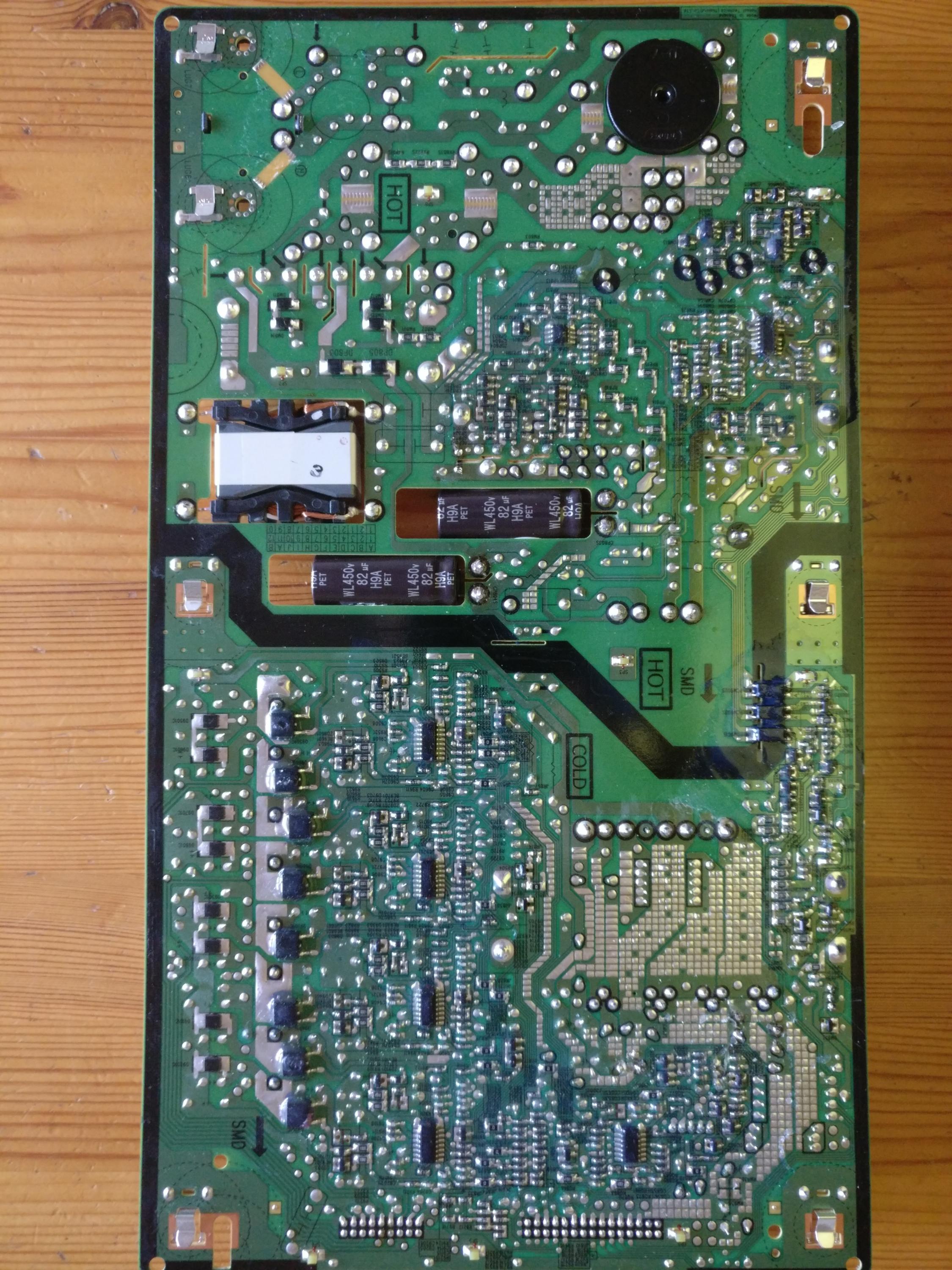

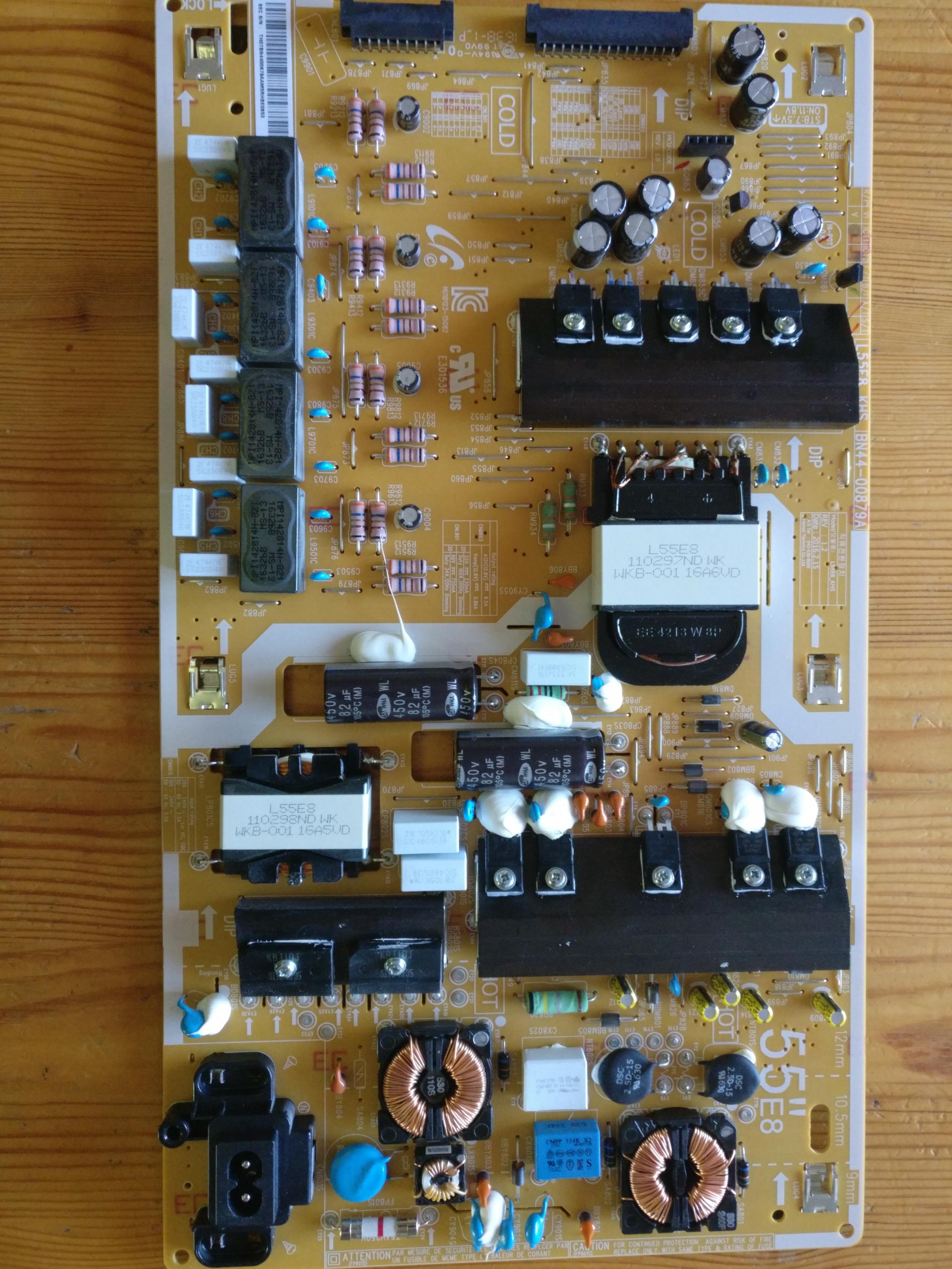

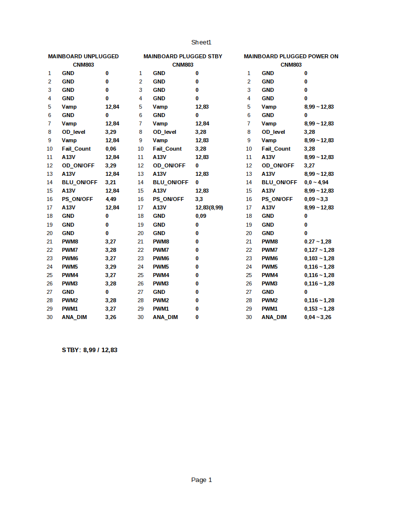

    Capacitors are tested and are OK. I took voltages which are fine with MB unplugged. Attached is a picture with voltages in three different states. PSU has a jumper wire where standby is supposed to be measured, saying it should be 7.5V and at power on it goes up to 11.8V. When measured they are 8,9V and at power on 12,84V. Is it supposed to be like that?
    Otherwise, voltages seem ok when MB is unplugged. Even in standby they seem about right? But at power on, things go weird. Voltages drop to a certain point at power off and rise again at power on. I'm baffled, please help!
    Thanks in advance.

            I kind of suspect that its a mainboard issue, try the hairdryer test, with everything plugged in heat up the electrolytic caps on POWERBOARD for a couple minutes then try the tv, don't wait til it cools off, try it while its still hot but your powerboard looks good to me.

              does the place where you got the mainboard have another they can send you if you send that one back? but don't pay twice, if they do have another available, send one back and they should send the other out.

                  Re: Samsung 55KS8005TXXE power cycling
                  Ok, heated with hairdryer but the capacitors don't feel that hot, can easily hold finger on them without burning. Same effect. Heated for about 3-4 minutes.
                  The seller (Aliexpress) said the boards are tested. Getting a new one takes about 4 weeks to arrive.
                  do try it with the panel button cable unhooked, the one with volume channel up down etc, sometimes they go bad and are to blame for the cycling.
                  It has only power button. Disconnected but cannot power it up so TV stays in standby now

                      I see, sometimes the boards can get damaged in transit, did it arrive in a anti-static bag?

                          and you're sure that the replacement board is a match? usually you need to match the alphanumeric digits on a sticker on the board, not sure if the one in the picture has one, I just see the QR deally.
                                Yes, by sticker number on chassis and labels on mainboard. Seller wanted pics of the original board to use for comparing. Seller had compared some resistors and capacitors different places on the board.
                                and you tried it with the wifi board unhooked?
                                As written in first post, disconnected everything except IR-cable. Also tried disconnecting only one of them in order.
                                Originally posted by Storyteller12
                                Disconnect both lvds cables going to the panel and try to power on. See if the backlights stay on or if you can hear anything on the speakers.
                                Did this a couple of posts above. No difference. Backlights stay on ONLY when mainboard is unplugged

                                  well if the cable from powerboard to mainboard is ok, then it must be the mainboard at fault.
                                    Yeah the cable is tested with continuity and seems ok.
                                    Oh crap, but how can they both be broken the same way? Any clues where to start "debugging" the mainboard?
