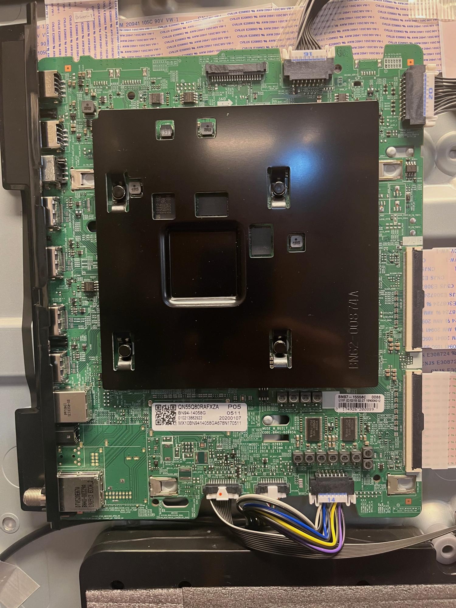

    Hi, I am working on a 2020 Samsung QLED QN55Q80RAFXZA Version FA02. On Christmas Day, the TV made an odd sound while off (in standby). After that it would not turn on. There was no red standby light.
    Based on what I read on the net, I ordered and replaced the Power Board, the Main Board and the LED Driver board with a kit from TVPartsToday. After these were installed, the TV would start up and play the startup tone but the screen was still dark. By shining a flashlight onto the screen, I could see the faint image that was on the screen as it was in the startup mode looking for me to select a source. When I turned it off, the red standby light was now on and working. Progress but not enough.
    To test for the backlights: I unplugged the unit. Unplugged the Main board power cable coming from the Power board. Plugged the unit in again….still a dark screen, no backlights.

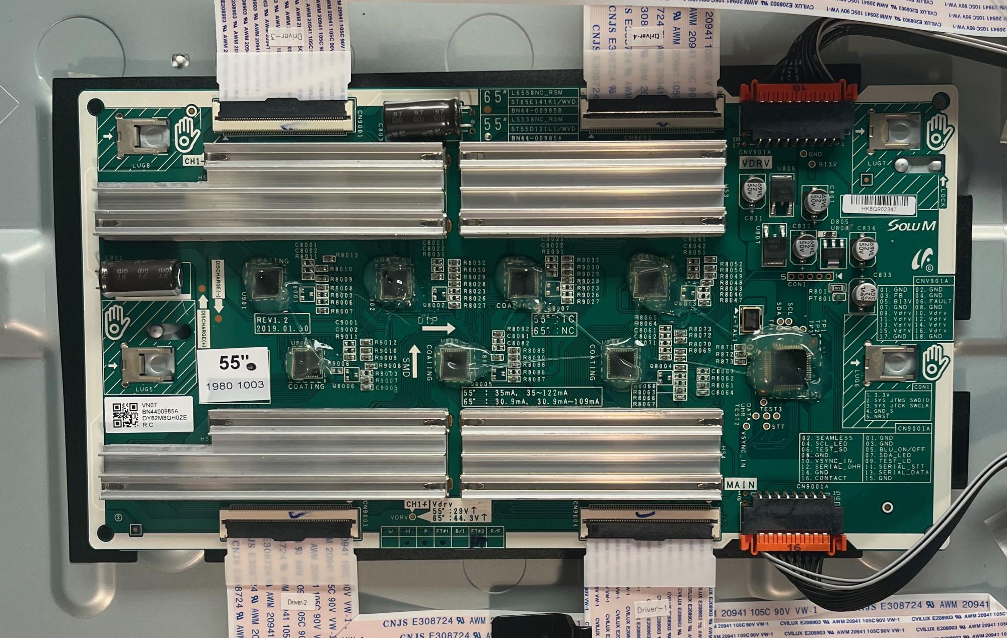

    I was advised that the LEDs were probably blown so ordered the LED strip kit from ShopJimmy. I got the LED strips installed after a long painstaking disassemble. I did not replace the board in the center of the chassis that all of the strips plug into. It didn't seem to have any electronics other than wiring and connectors.
    After reassembly of the unit but with the back off, I fired it up again. Same result. Unit starts up, sounds a tone, screen is dark except for what you can see with a flashlight as before. Red standby light on when powered down.
    Sorry for the long novel, but I am hopeful there is something that I overlooked that someone can advise. I am not a technician but have sufficient knowledge and experience to be dangerous.
    Any advice on what to do next? Might the Main or LED driver board that I installed be defective? (I did try using the original LED driver board in place of the one from TVPartsToday and got the same results).

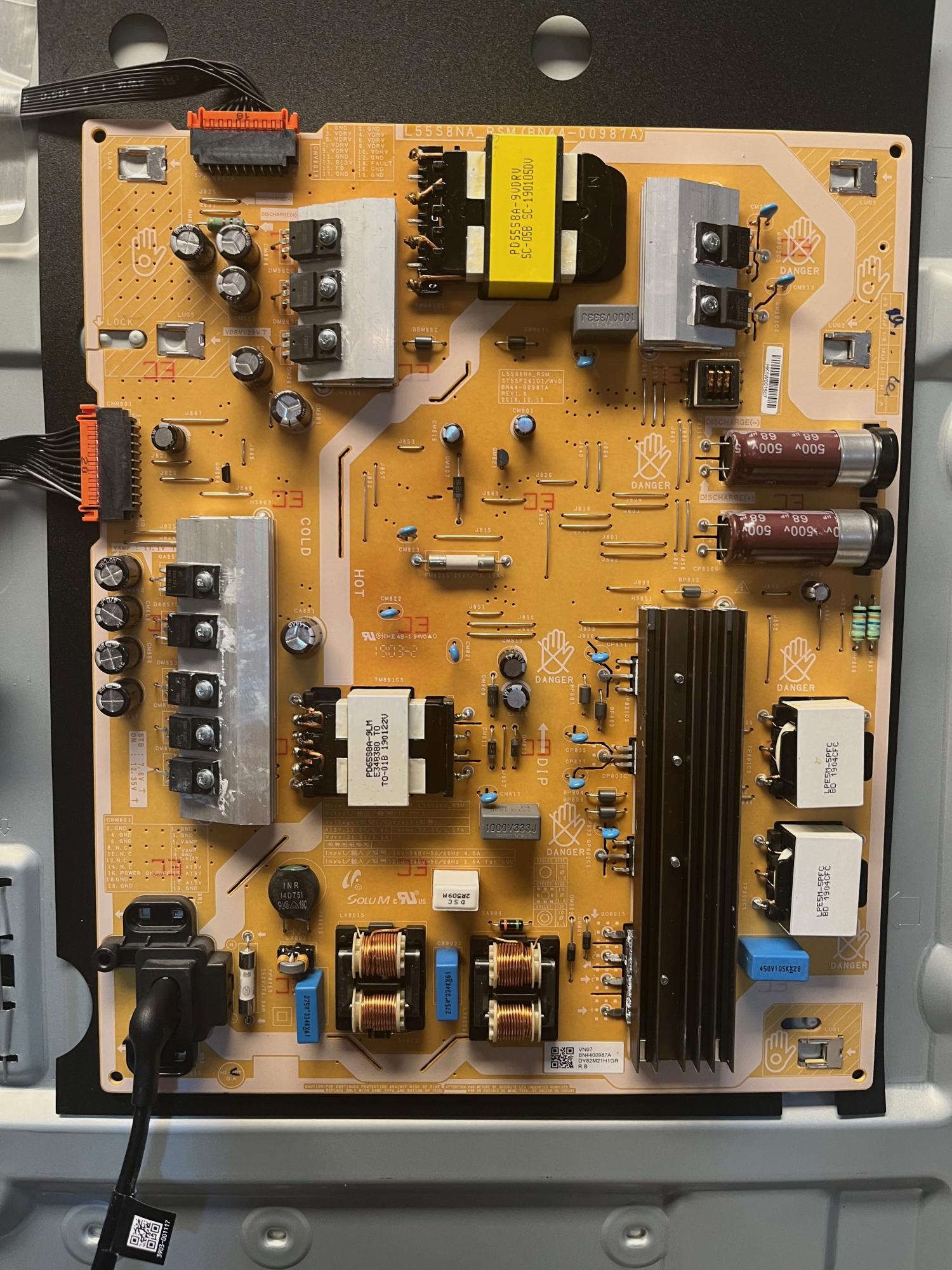

        I took these measurements on the Power board connector that leads to the LED board on the pins that were accessible.
        All connectors in place. Powered up.
        - 18-pin connector on Power Board: measured between Pin X and Pin 17
        - Pin 1: GND = 0V
        - Pin 3: VDRV = 33.36V
        - Pin 5: VDRV = 33.36V
        - Pin 7: VDRV = 33.36V
        - Pin 9: VDRV = 33.36V
        - Pin 11: GND = 0V
        - Pin 13: B13V = 2.6 mV
        - Pin 15: FB = 0.39V
        - Pin 17: GND
        Removed connector to Main board. Powered up. Result: No backlights on.
        - 18-pin connector on Power Board - measured between Pin X and Pin 17
        - Pin 1: GND = 0V
        - Pin 11: GND = 0V
        - Pin 13: B13V = 1 mV
        - Pin 15: FB = 0.517V
        - Pin 17: GND

          Pictures of the three boards in question

            It lacks of B13v, the original leds are probably good, all this repair job is made without any technical expertise, wasn't it better to consult a technician? Before giving a cross to a certain brand it would be helpful to know why it brokes and if is by a certain scarceness of the product or an electrical problem occured in your house in that moment, anyway there are not much better piece of hardware out there.. most of the brands are Chinese controlled scarce hardware now..
            check 6. fault and on CN9001A 5. blu on/off

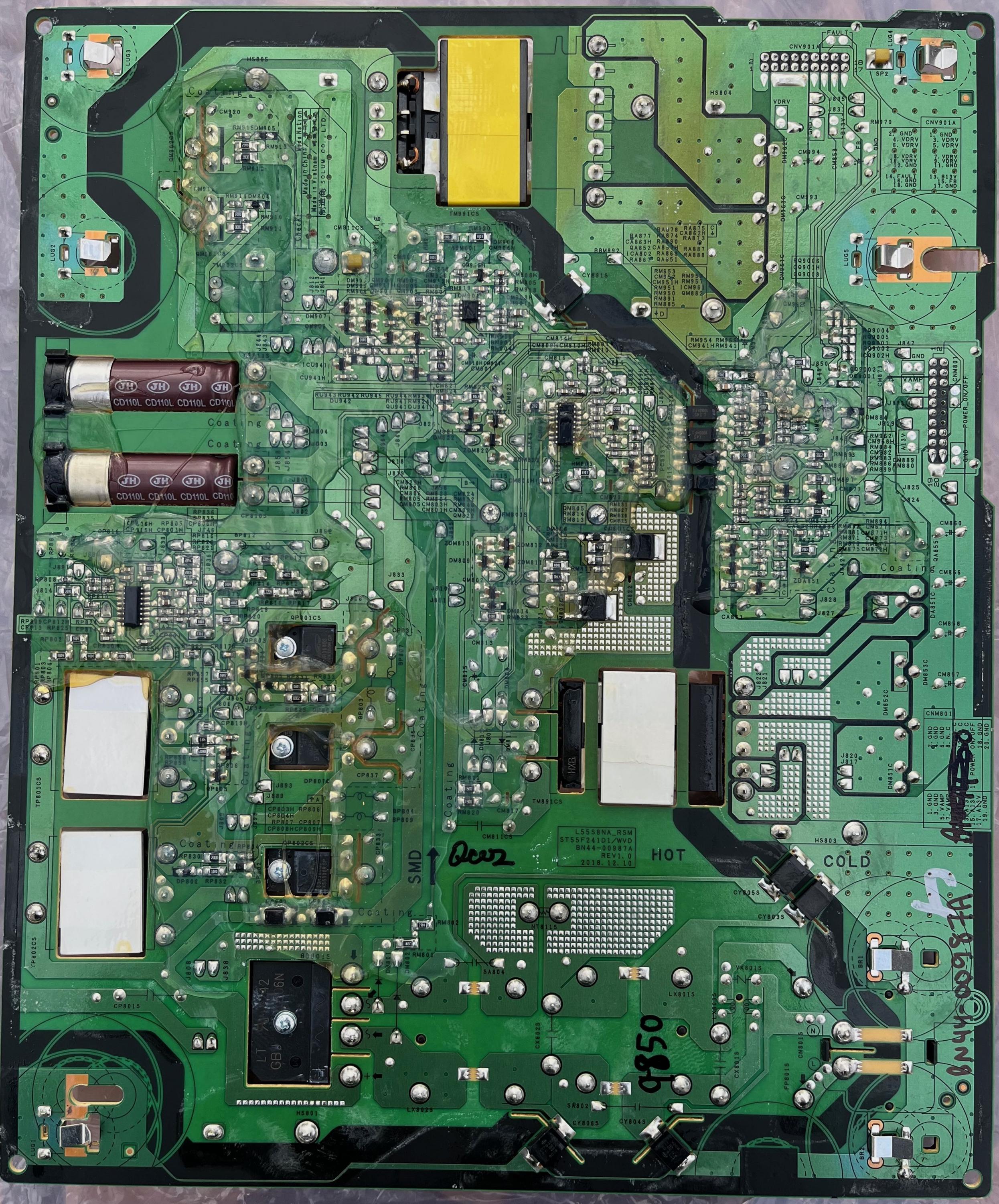

                        Storyteller12, also on the old board, the fuse next to the power cord connecter, FP801S, is blown. This was surely the original problem but I suspect it had other effects downstream.
                        When I installed the boards, I didn't make progress until I changed both the Power and Main boards. I tried them one at a time in different order and did not get to where the unit powered on at all.

                              Davi.p, here is the picture of the back side of the power board. Not much sunshine here today so let me know if I need to take another with better lighting.

                                    All cables in their place, tv on, read tensions on CNM801, A13v must be connected to B13v through the medium size transistor QM884.. (center pin B13v, lower pin A13v).. A13v feeds most of the main board comprehensive the CPU so it must be there.. whatching bottom side of board, if ps on/off is more than 0,7v you better remove if possible the glue around the QM884 and surrounding smd components, but also we could try to make a jumper soldering on bottom/lower pins of QM884 so the led board be energized, only for test..
