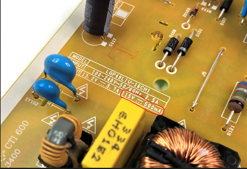

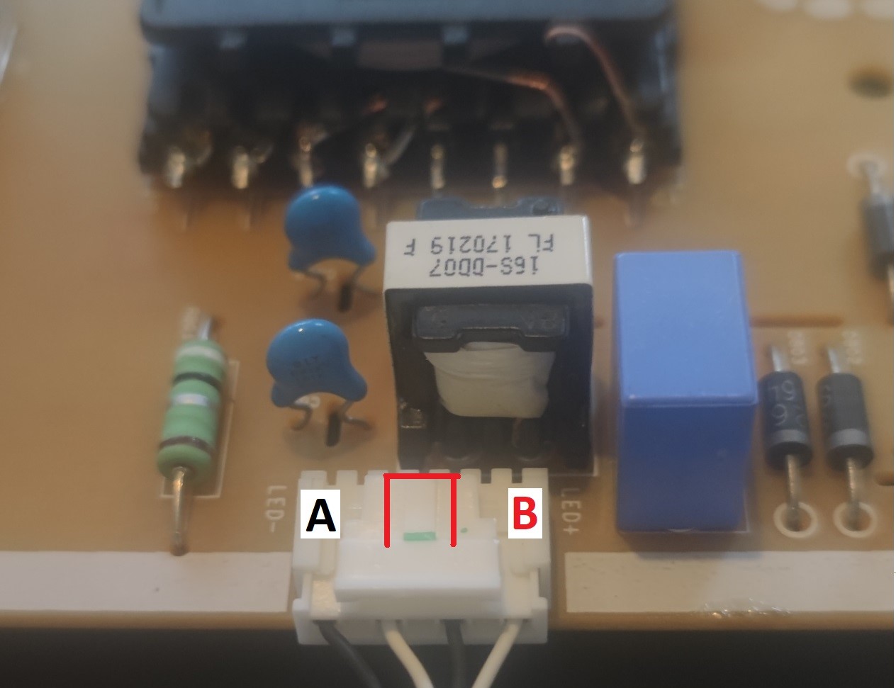

          Got a feeling this is one of the rare cases then. I watched a video of a guy diagnosing then changing the backlights on an LG 40LF320v. He measured between A and B and read 250v dc which he stated was a good supply voltage for the backlights.
          If I measure this bigger set between those 2 points I read a PD of only 98v. If I measure A, the midpoint and B with respect to chassis I get 64v, 113v and 165v respectively.
          I'm just hoping that someone can confirm that these voltages are indeed too low before I order a replacement.

            Typically, the power supply board consumes output voltage and backlight current.

              Thank you lotas. I completely missed that info on the board. I have just checked the board from the video I watched and it is marked 264v so seemingly this board may be supplying a near enough correct supply voltage.
              Seems there is very little choice other than to remove the panel and take a look at the backlights.
              Thanks again.

                    Can you post the PS board model? 165v respect to gnd and only 98v A>B is not good, i think something is wrong with the led driver ic or the current sensing resistors...
