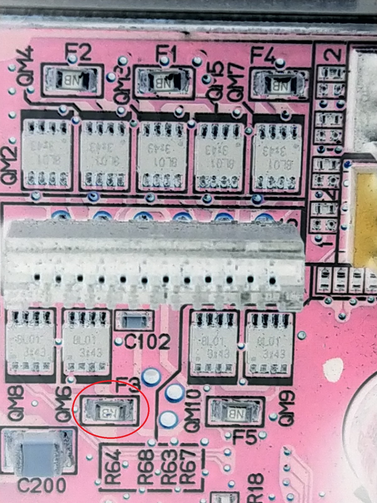

    hello,
    i have this matrix printer, there are fuses for the pins on the head, one is open but i am not able to identify it and find replacment. its marked just NB, F3 on the board (red circle)
    the printer is EPSON LX-350

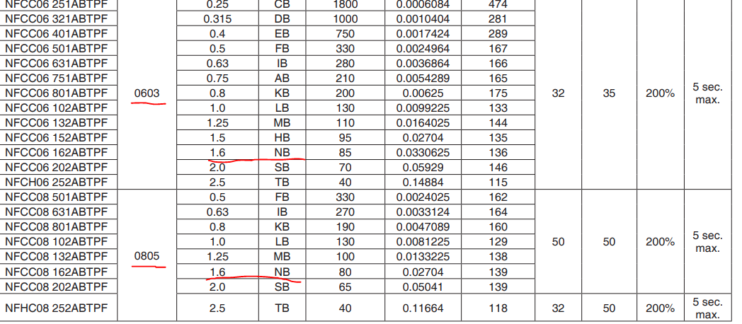

    Re: matrix printer,help identify smd fuse
    Nb - 1.6a
      Originally posted by lotas
      Nb - 1.6a
      10x a lot man!
