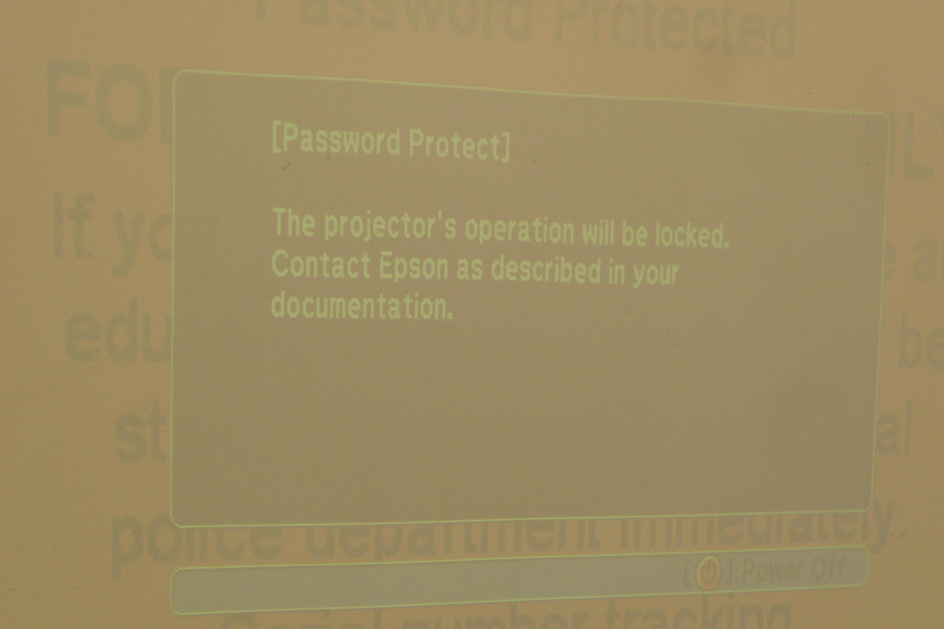

    Re: REMOVE PASSWORD EPSON EMP-400We
    See picture

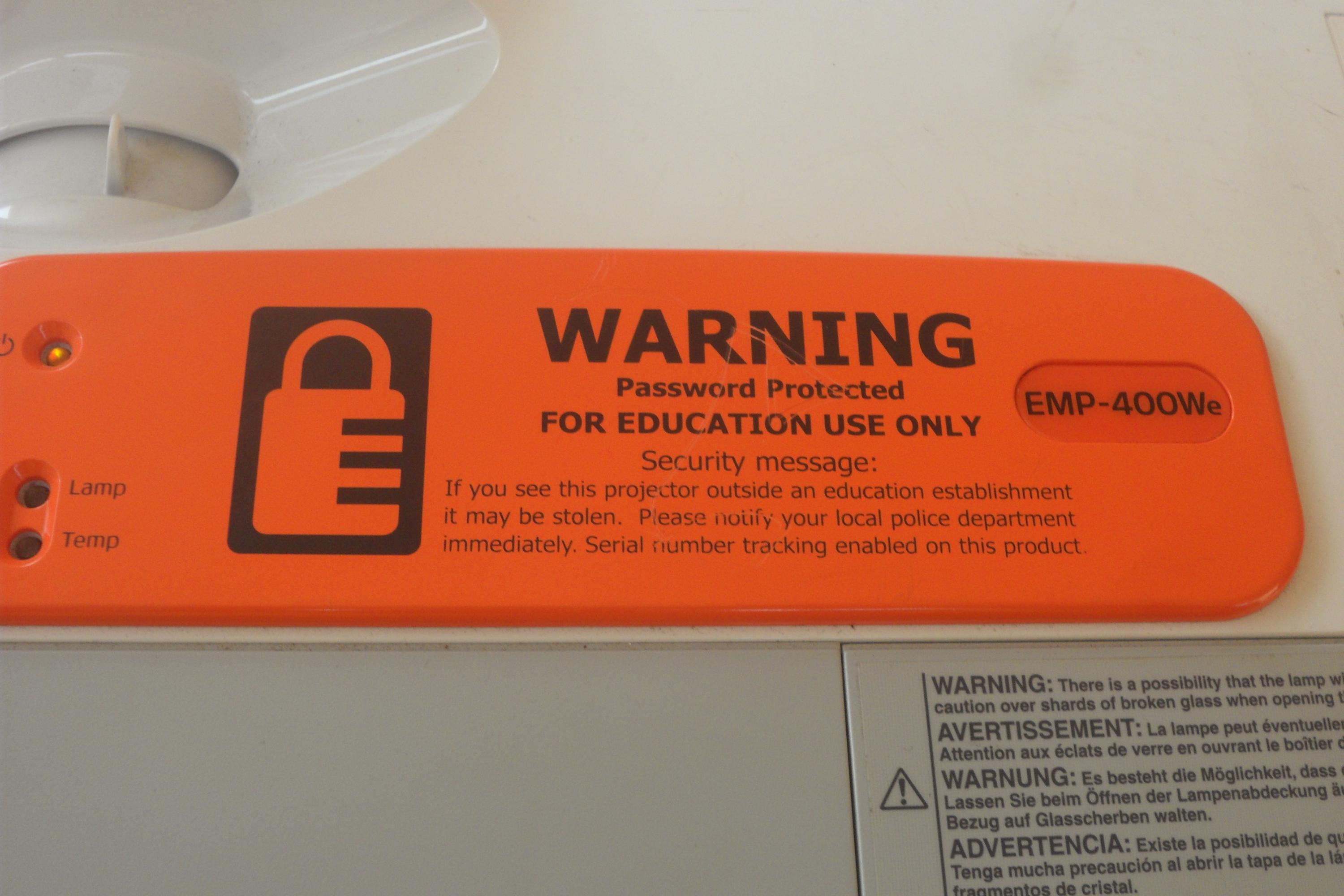

      is the "We" for eductation?
      maybe re-flash the firmware with "W" version if it exists?
        • 30919
        ah yes.
        The EMP-400W is basically the same device as the 400We —sans the security features.
        also found this:
        The factory default password is to hold down the number button and press 1793 on the remote control
              will try to remove the panel

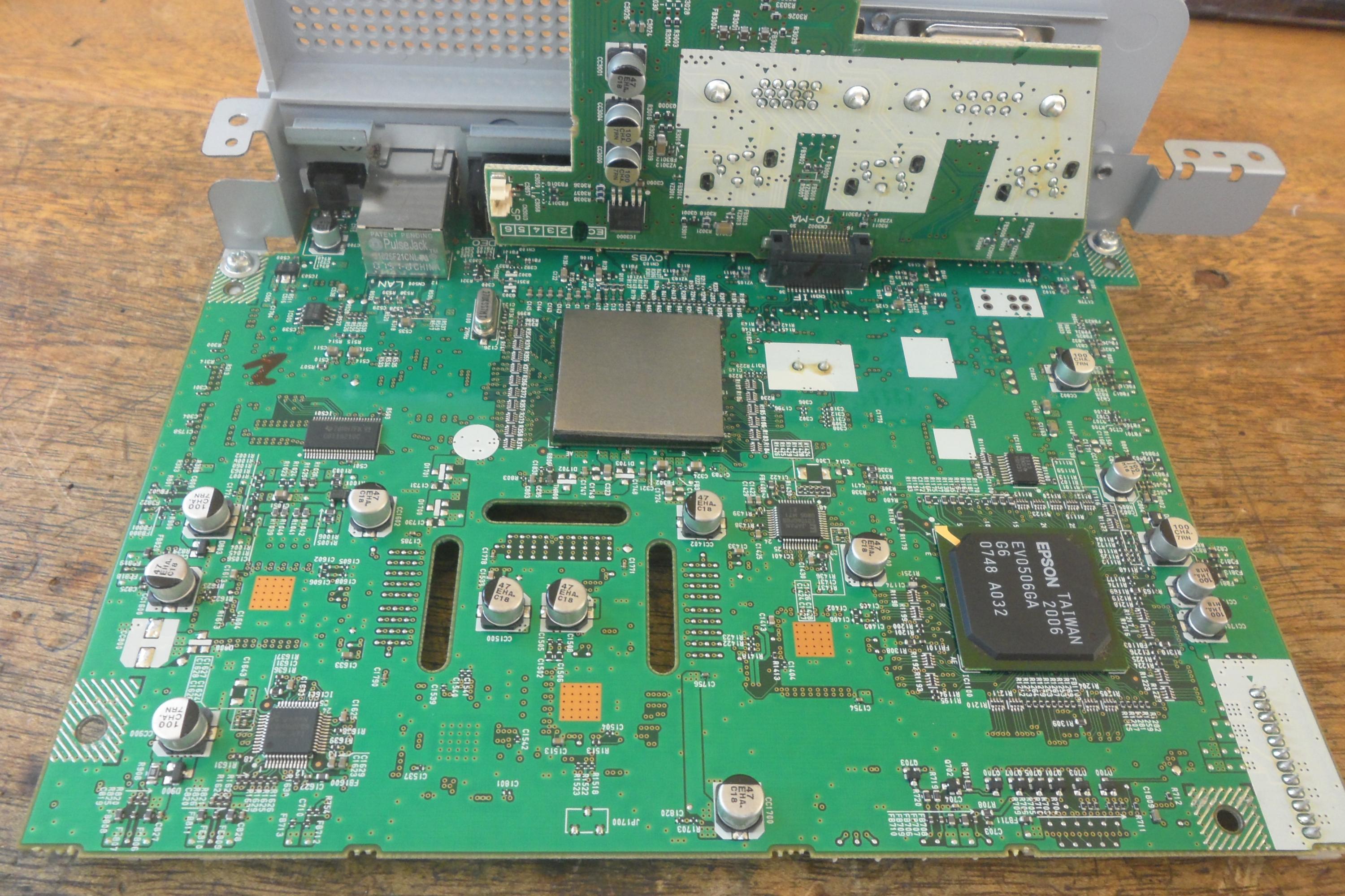

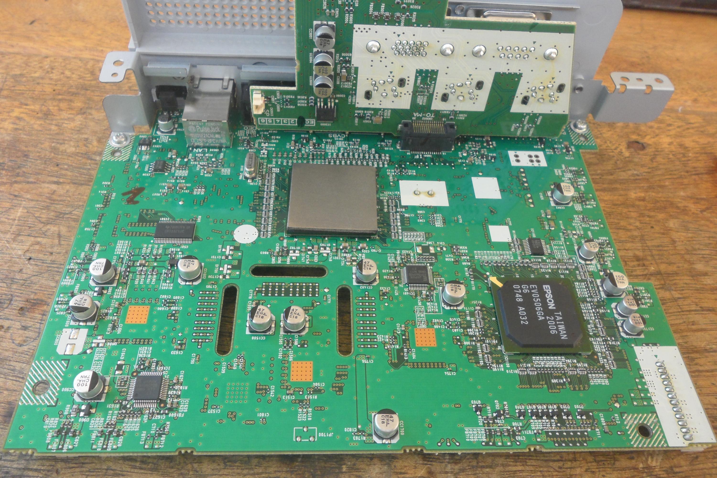

                board pictures.nothing under the orange panel only diode led

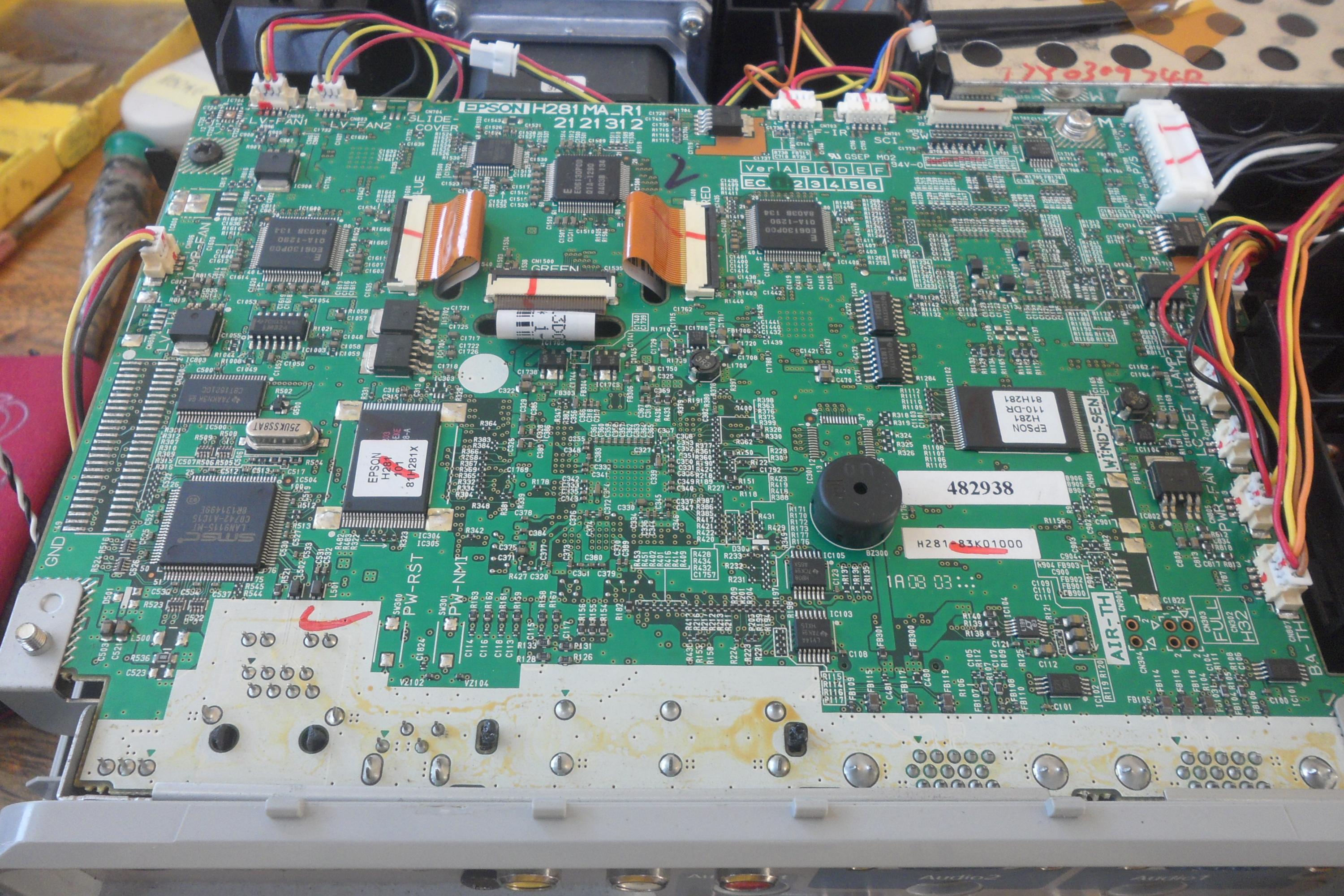

                    those 2 test points look interesting!
                    PW-RST & PW-NMI

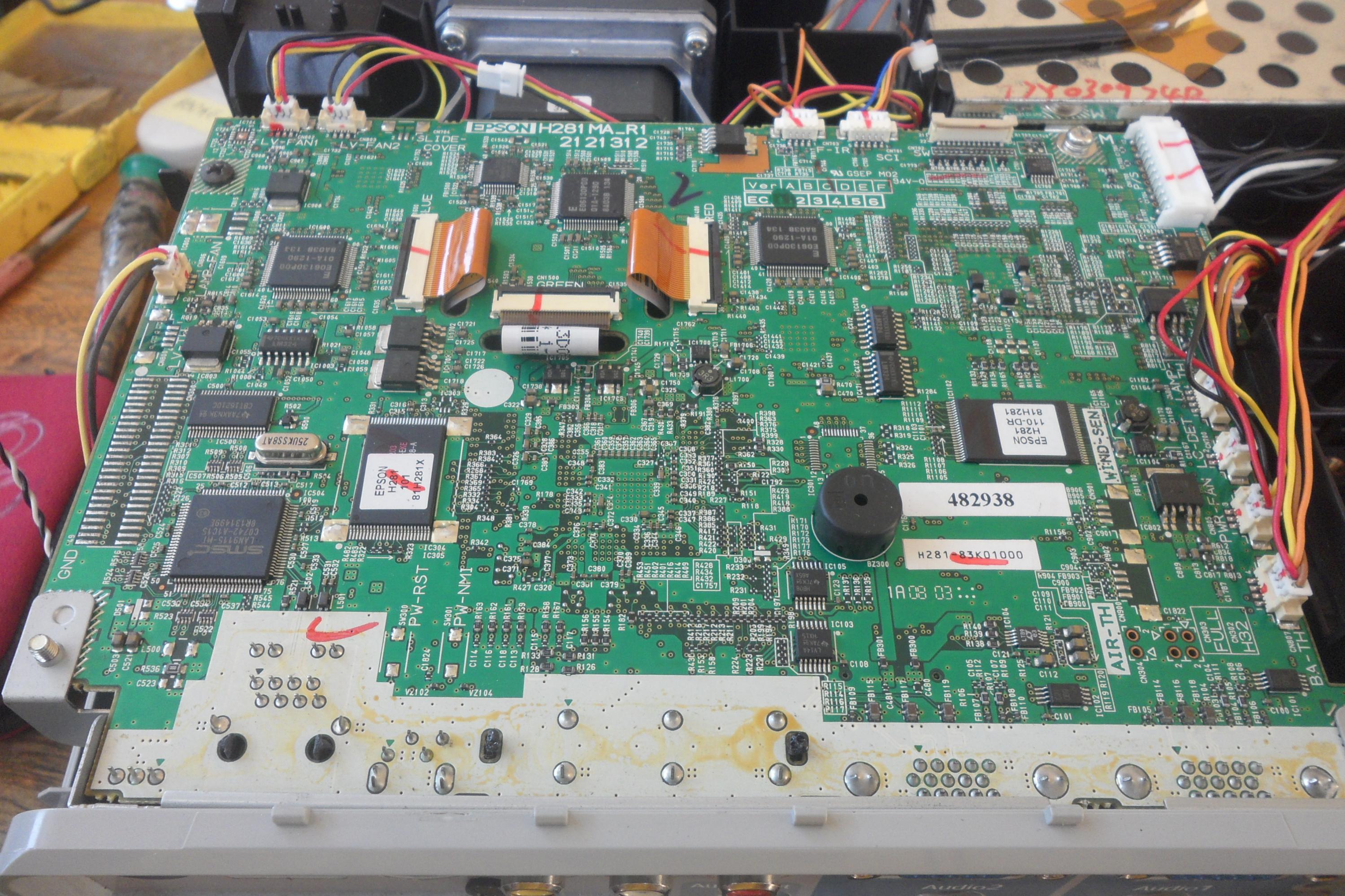

                      • 30919
                      page19
                        Pw-rst & pw-nmi
                        for sure . I will take the risk to short them and see what will happen, even if i am not sure that i will remove easily the password this way
                          • 30919
                          i think it will always have a password, but if you reset it then atleast you know what it is.
