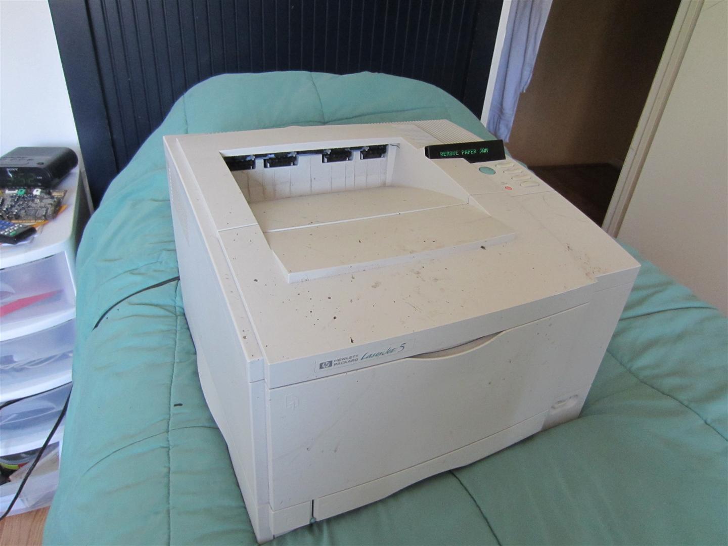

    My buddy at UCSD found a 1997 HP Laserjet 5 on a pallet of stuff ready to be thrown away. I've been wanting a laser printer for a long time and I have always liked these old HP tanks so I hauled ass over to La Jolla to pick it up.

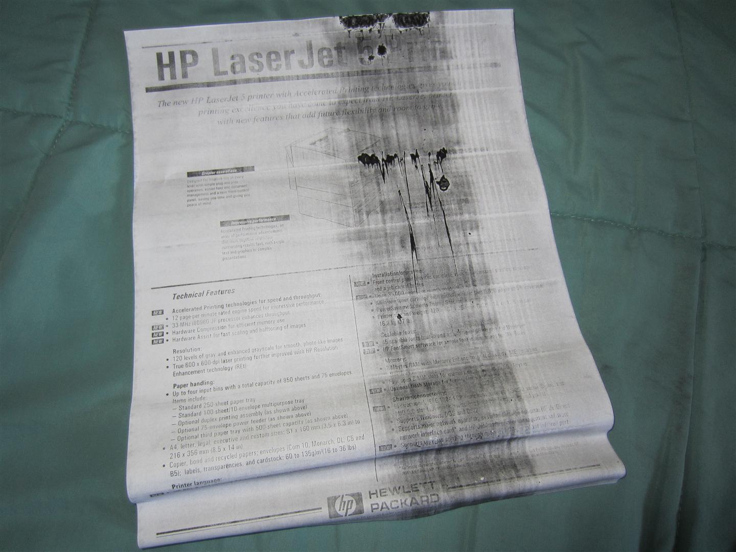

    It powers up and prints a test page, but it makes an accordion paper jam and the printout is faded and has 2" gray bands going through it. The toner cartridge in it is completely empty.
    I know nothing about these old printers. If I put in a fresh toner and fix whatever is causing the paper jams, will I be left with a good printer or are those gray bands indicating that it needs a new fuser?

            Here is a pic of the printer and a picture of the demo page. I am heading over to Fry's to pick up a new toner cartridge right now. I'm going to have to get a remanufactured one because HP discontinued toner for these older LJs.
            This thing is built like a tank and Made in Japan. I'm liking it so far.

              Pictures didn't upload for some reason.
              Those black stains on the page didn't start appearing until I cleaned the roller on the cartridge itself, which makes me thing the cartridge is definitely fucked.

                Put the new toner in and this thing is printing beautiful. Makes inkjet printouts look like crap. I just need to order that roller replacement kit and she should be good to go!
