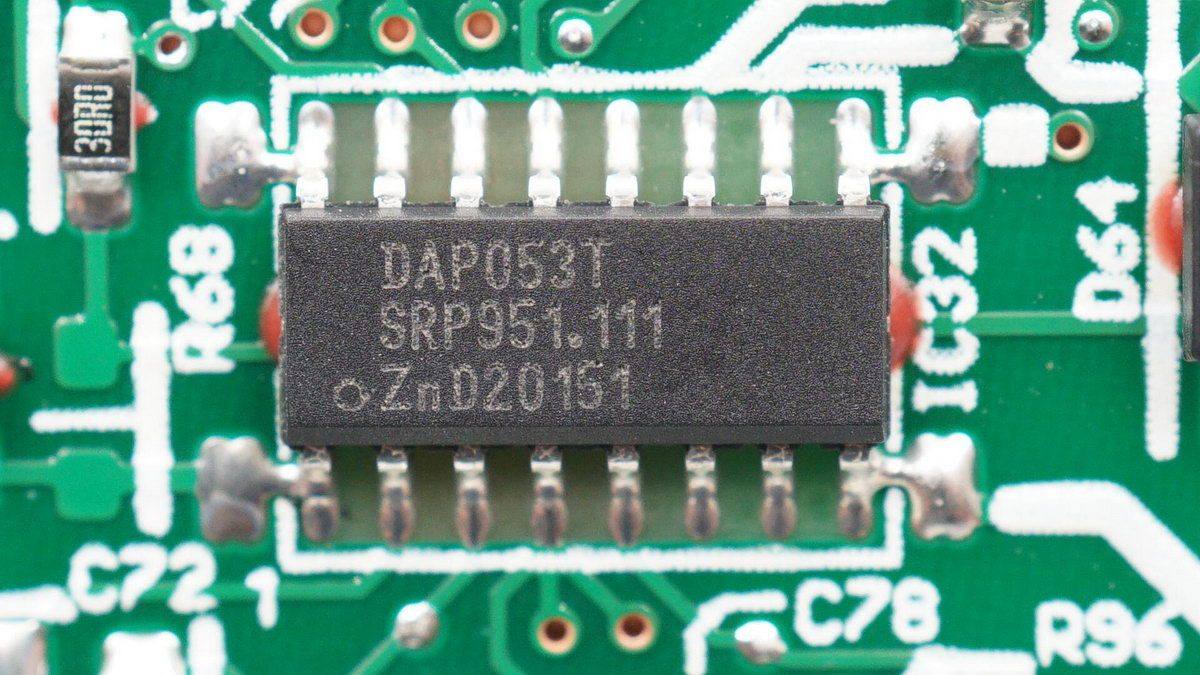

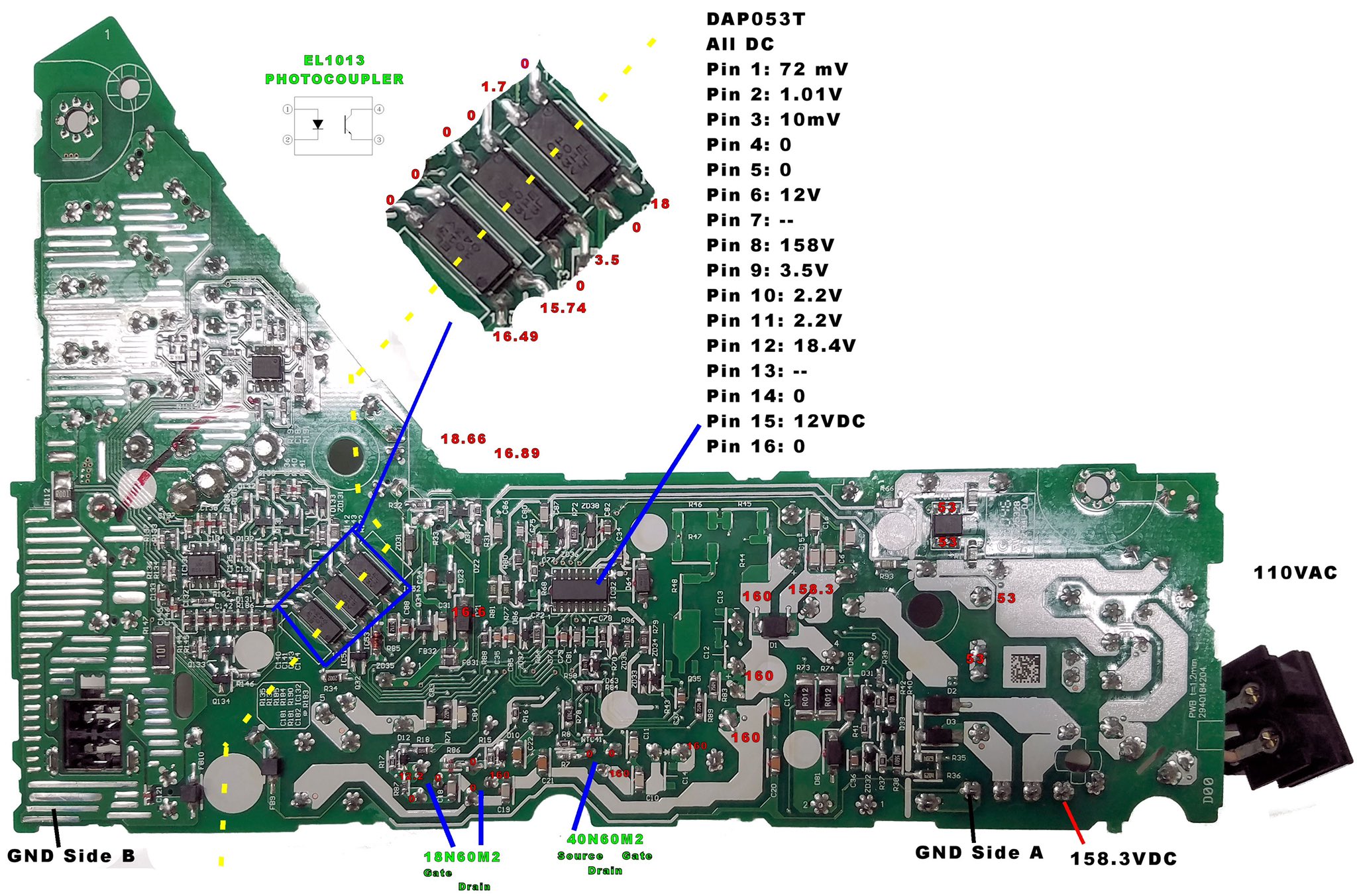

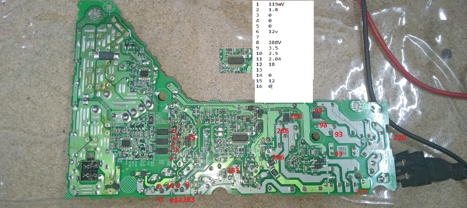

Hello. Brought Sony PS5 with a malfunction does not turn on. Found that the power supply is not working. No visual defects were found. Full fuse. Capacitors C2, C5 are charged (voltage comes to them). Does anyone have a diagram or can you please tell me how to fix it. Little experience with power supplies. I will be glad for any of your help. Thank you.
