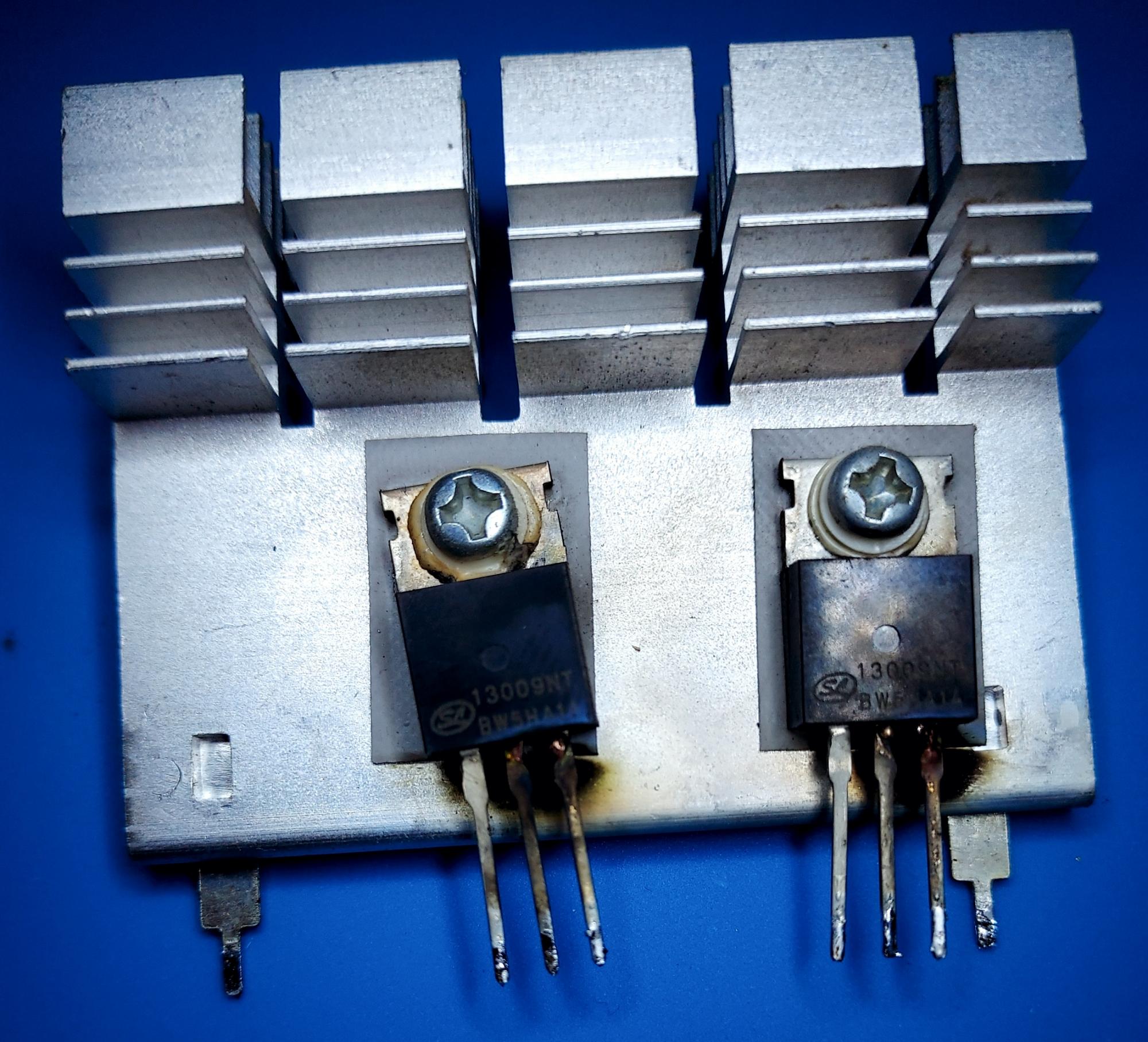

    I am trying to repair an ATX power supply, where "everything" blow up.
    - The Fuse
    - The Diode bridge
    - the 2 "mosfets"
    I would like to ask you about the "mosfets" because when I look for the reference 13009 they seem that they are NPN transistors. (hopefully attachment is inserted).
    2+1 questions I would like to raise.
    - Does the brand that appears on the chip looks familiar? it's not ST, right?
    - Are these NPN indeed?
    - With all the listed casualties. From your experience......anything else to look at? PWM chip?? (schottky diode are ok).
    Thanks in advance,
    Francesc.

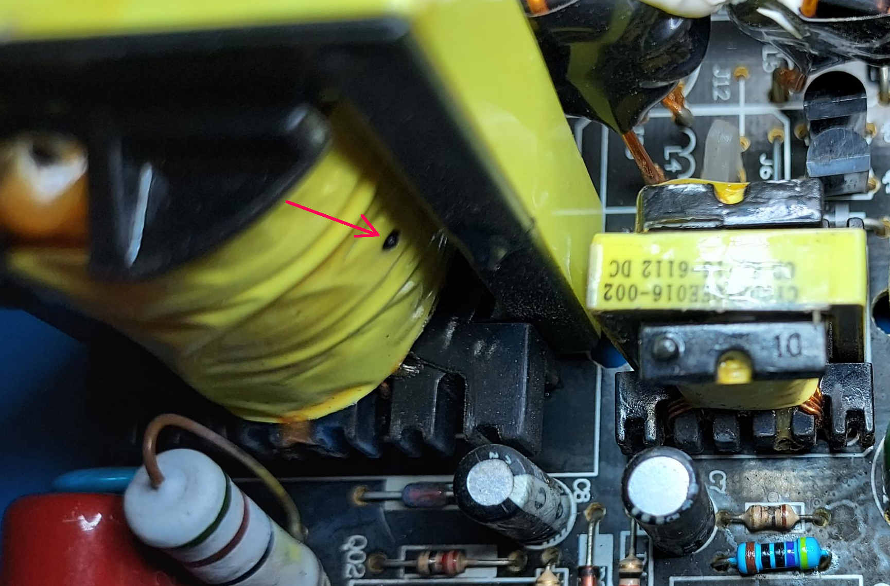

        The black spot on the transformer, is that from an arc inside the windings or schrapnel from transistor popping?
        This is cheapened, they have jumpered many parts out. No X cap or CM choke but... the NTC inrush thermistor TH1 is jumpered out and of course the bridge rectifier sees stress.
        The transistors are MJE13009 (or ST13009, FJP13009), they are not mosfets.
        I would also replace the small electrolytics C7, C8.

          Q01 & Q02 13009 are not mosfets, just transistors

            The MJE1300# are bipolar transistors, originally of the 1970s vintage Switchmode series from Motorola. The MJE1300# are in the TO-220 package (originally, at least); the 2N654# were of the Switchmode series, but in the TO-204 ("TO-3") package.
            The MJE13007 and MJE13009 are examples of parts that work too well to kill off, though the trend toward higher efficiencies will accomplish that sooner or later.

              I think the transformer might be pooched?
                You scared me......I didn't see it before. It's a black spot but from silicone

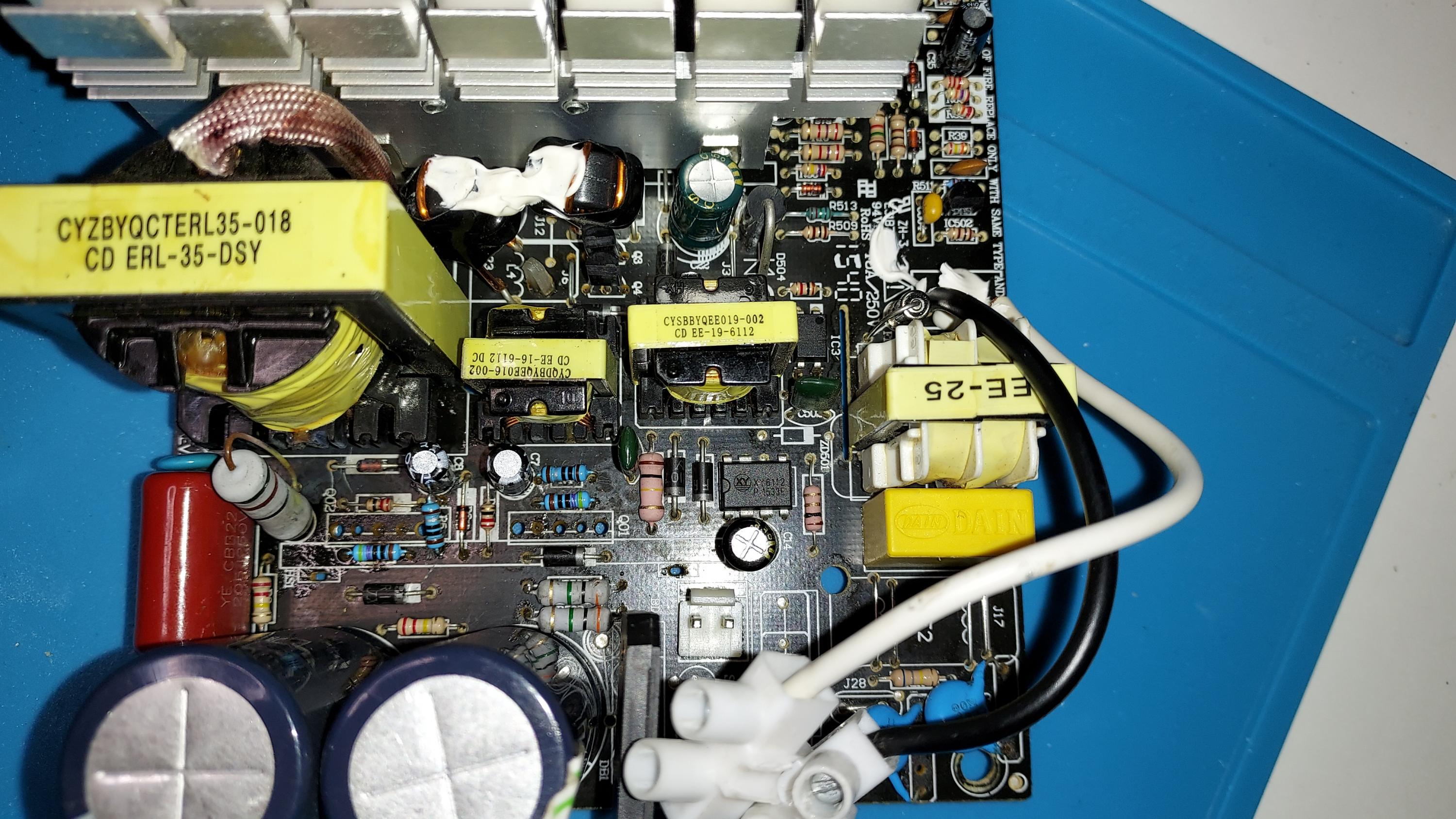

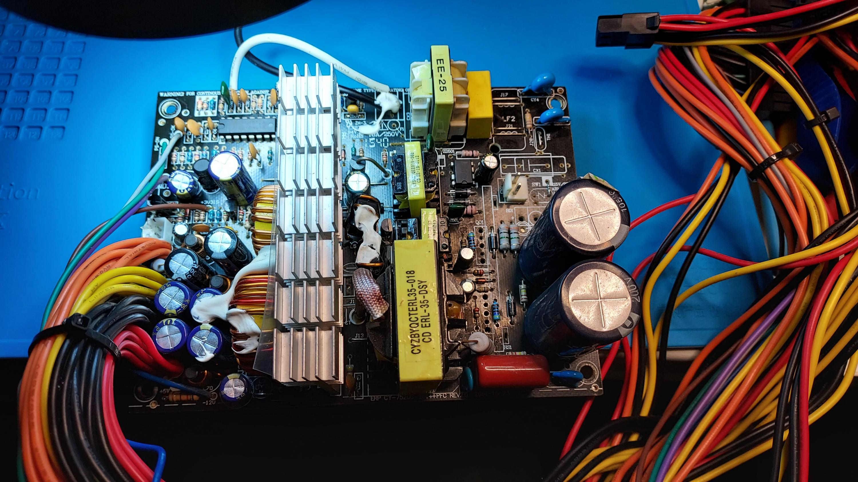

                  Pieces arrived (bridge, NPNs, Fuses).....
                  So I replaced all of them but.......current situation is that SMPS has 5V Standby only (and 5V in the green wire also).
                  When I switch on the SMPS by shorting the green wire to ground, there is not output (3.3V, 5V, and 12V).
                  However:
                  1. The SHJ1512A / CG8010 has Power in pin 13.
                  2. Pin 7 and 8 measure 37kHz......so it seems that is oscillating
                  3. These signals arrive to Q3 & Q4 Base transistors.
                  Could you please provide me some guidance about what I should measure next?
                  Thanks in advance.
                  Francesc.

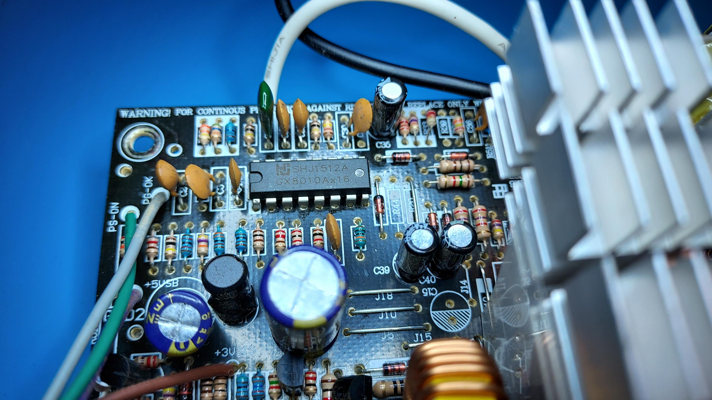

                    • 31161
                    Re: Restoring ATX supply for learning purpouses.
                    look at the parts between the driver chip (pins 7/8?) and the transistor base pins
                    when they shorted they usually damage the drive circuit
                      • 31161

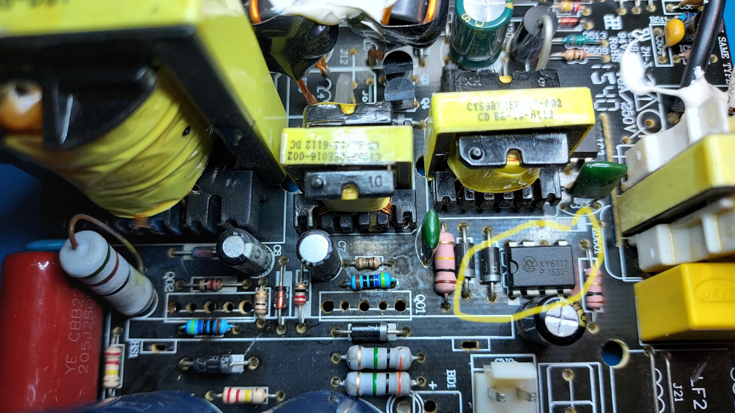

                      looking at the pictures,
                      check the resistors
                      47ohm (yellow purple black black)
                      and the small ones - brown,black,gold < bet those are fucked!

                        Q3 (C945 NPN) was bad, so I've replaced it.
                        I've also checked optocoupler and it's ok. Between pin 1-2 I have 1.1V and in pin 3-4 0.7V
                        Could be XY6112 faulty?
                        - Between Pin 2-3 there are 5V
                        - In Pin 7-8 about 320V dc
                        Is there any procedure to test/validate this chip?

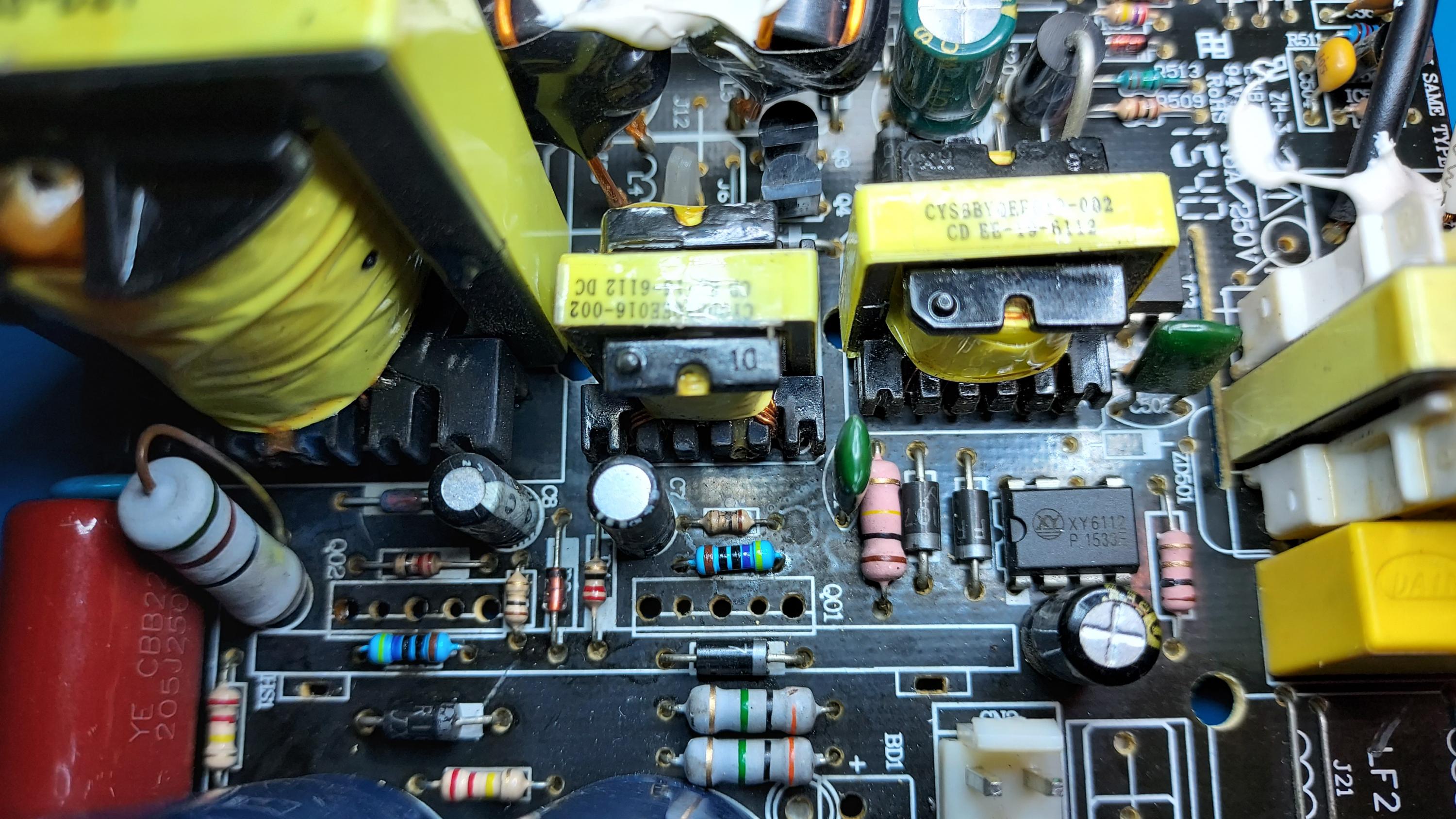

                        (I'm using an old photo where some components have already been changed and the Big power transistors soldered )
                          • 31161
                          you have burned out resistors in your picture
                          • Francesc V.
                            Tempus fugit
                            • Nov 2022
                            • 231
                            • Catalonia
                            I must admit that you were absolutely right @stj. Thanks for your perseverance pointing at the resistors several times in the post.
                            Two 1ohm resistor in previous picture were open. Now I am posting the final picture
                            So Now, it switches on and it has all voltages!!

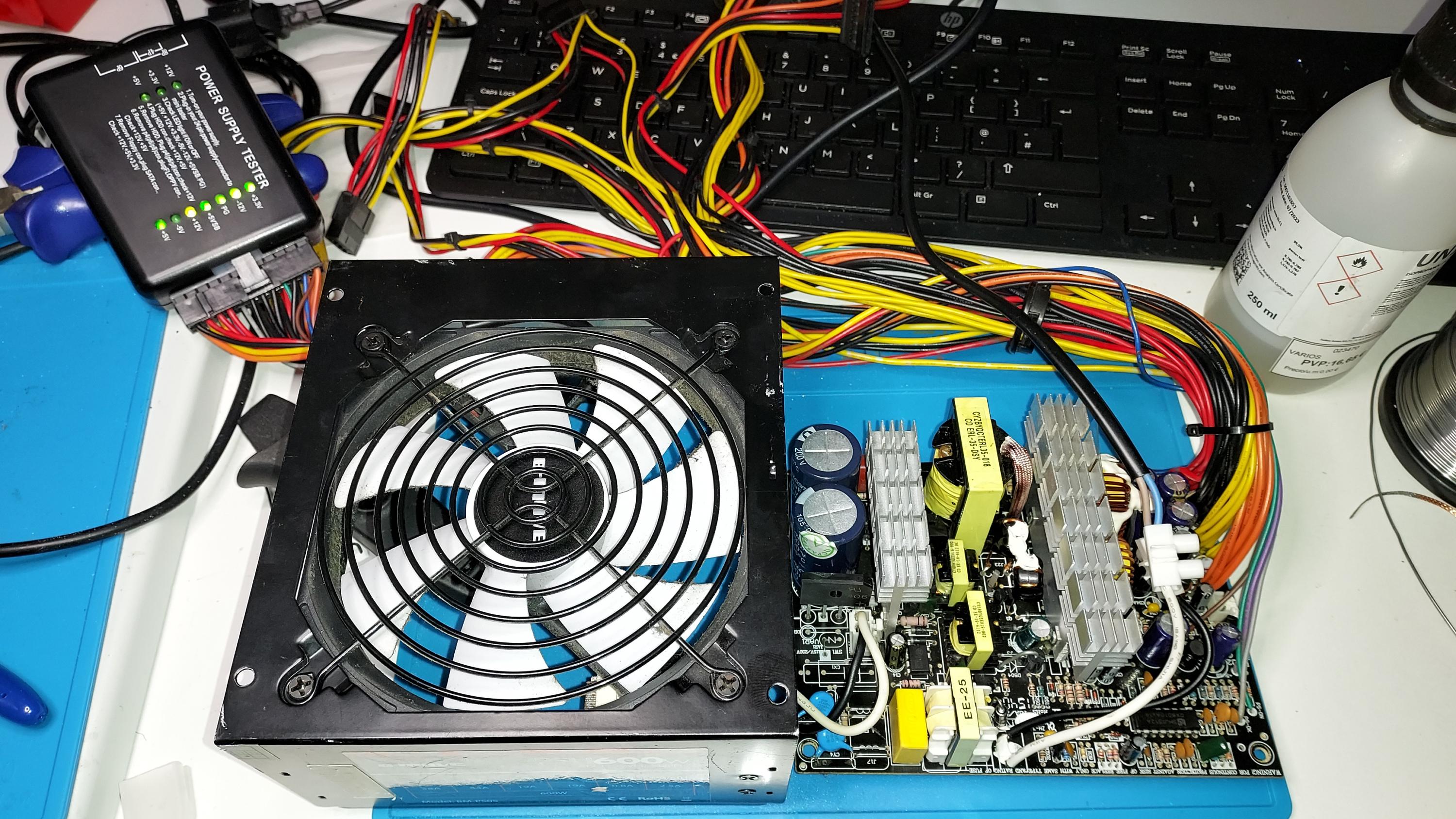

                            I connected the SMPS to a motherboard with embedded graphic card, and a SATA Hard Disk. I have started to install the operating system until the system shutdown about 20 minutes later.
                            Now the SMPS tries to swich on and then switch off and then again and again.........
                            Could it be the BIG capacitors?????? it has 2 in serial from 680microfarads and 200V. Although they have a low ESR, they only measure about 400. Or the problem is more likely on the filter capacitors on the low voltage side?? (all other capacitors on the hot side are already changed/measured).

                                      So now the SMPS seems to work. At least right now and from the last 2 hours. I tested under load using light bulbs simulating load in the 3 rails (3.3, 5 & 12)..........and the PG signal was always ok.
                                      Then I assembled in a PC (the one I am right now using for this post) and it's working fine..........not sure what to think. Maybe a wrong/bad connection...........or something that I de-soldered and soldered again.
                                      It has been worth it a lot trying to repair it...........not for the materials and the hours invested. :-)
