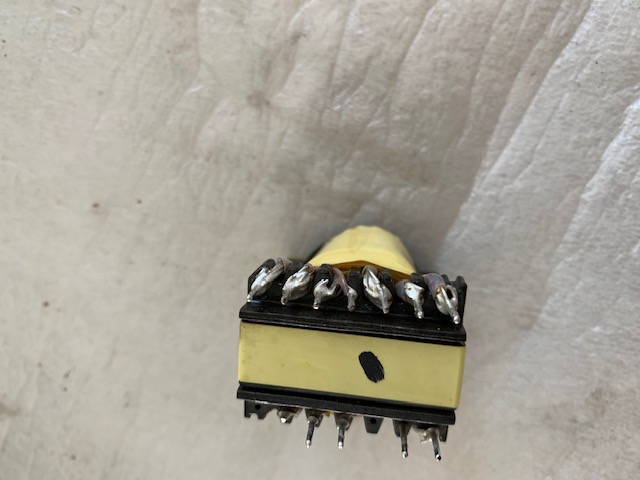

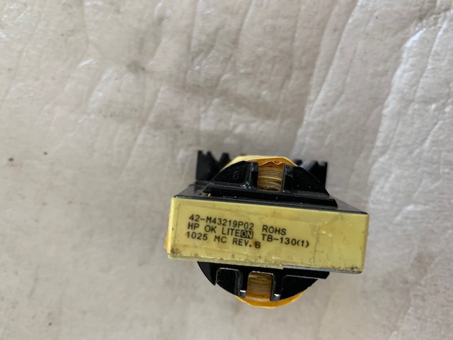

    Dear all
    i have several power supplies that when the transformer is connected on board
    secondary pins are all shorted (7pins).
    by removing it pins 1 and 5 are shown short and 2,3,4,6,7 are shorted between them.
    i tried to find datasheet but nothing. ps is manufactured by LITEON
    CAN ANYONE HELP!
    THANKS.
    ON PS I HAVE 4.3V ON POWER SWITCH ON

    Re: Hp smps power suppy ps4321 help!!!!!!
    It is a high frequency transformer, you can't ohm measure it.
    You need to use a transformer tester like a ring test, can also be done with an Oscilloscope if you Google for it.

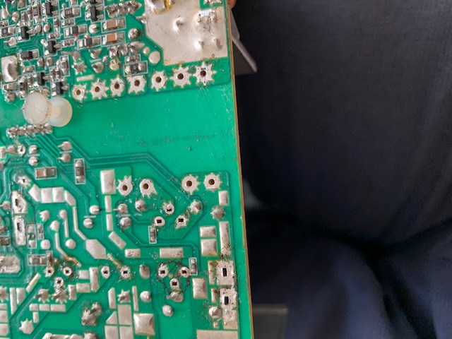

        Thanks for your message.
        i have noticed when transformer is installed on board and leave it rest for some time without power i get a very small resistance which means is not short but power supply has 4.3-4.5v stb voltage and is not turning on.
        there is PS25A and TL594 ic on secondary side which are not short.
        i checked all diodes and capacitors and non of them seem to be short.
        there is a transistor near the 3 optocouplers on which i get the 2.45v
        on the optocouplers on secondary side first one reads 0v and the other 2 read 10.8 to 11.5v.
        i removed optocoupler primary side and i placed diode instead to see if there is getting something HOT but nothing.
        do you have any ideas.
          Change out the caps for the 5VSB rail.
          • NConstantinou
            • May 2017
            • 354
            • Cyprus
            The 5vsb and 12v ca0s have been replaced
