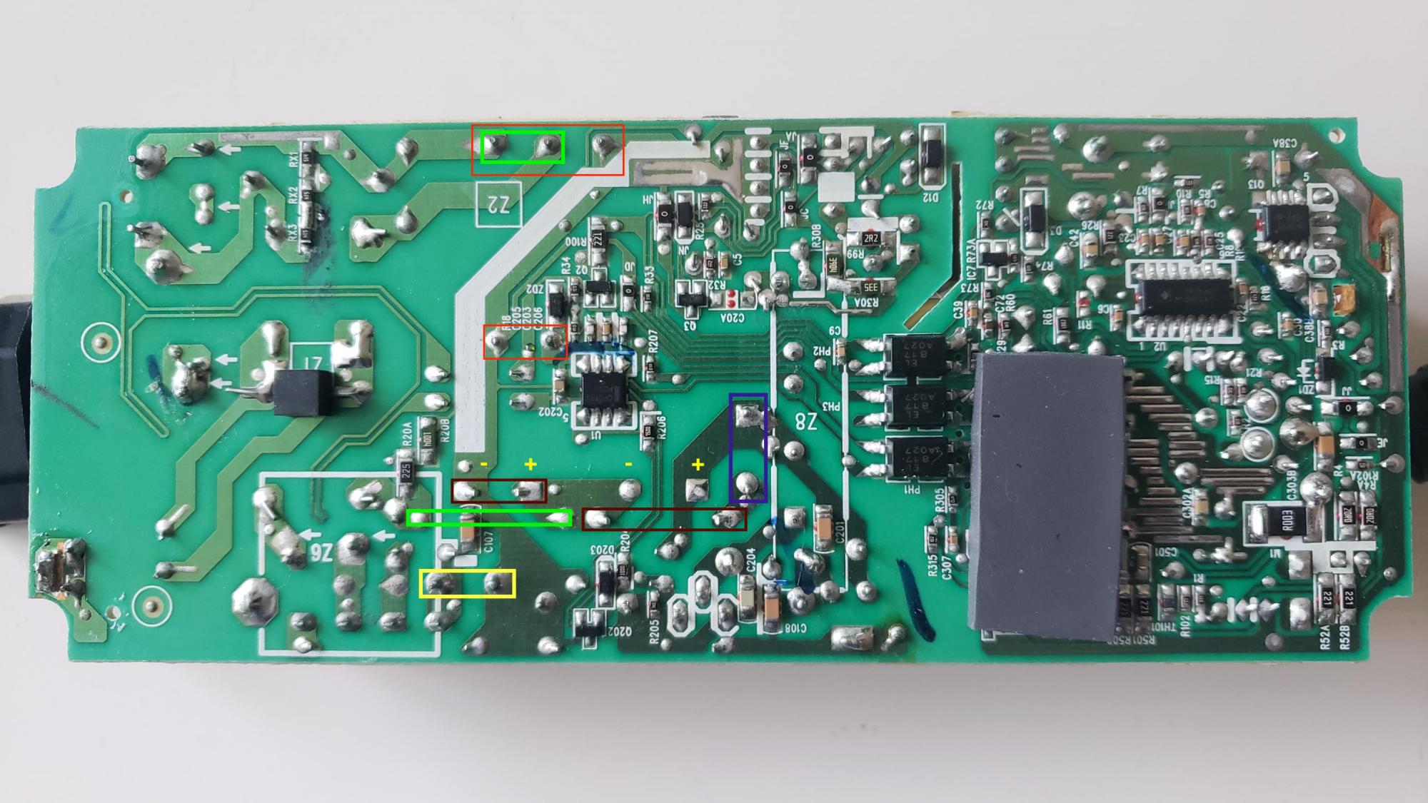

    Thanks all for replying on this. Looks like ENABLE/UNDER-VOLTAGE (EN/UV) Pin on TNY276PN IC detects the under voltage condition. However as per the paragraph on page 3, this can be disabled using this pin. Note sure how this can be done, would need your expertise to throw some light on this
    Update : Could this be achieved by removing the component (jumper) marked with red color in this picture, which is connected to high DCV.

      You could try that but it would greatly surprise me if they decided to make two different versions of this PSU for no real reason.

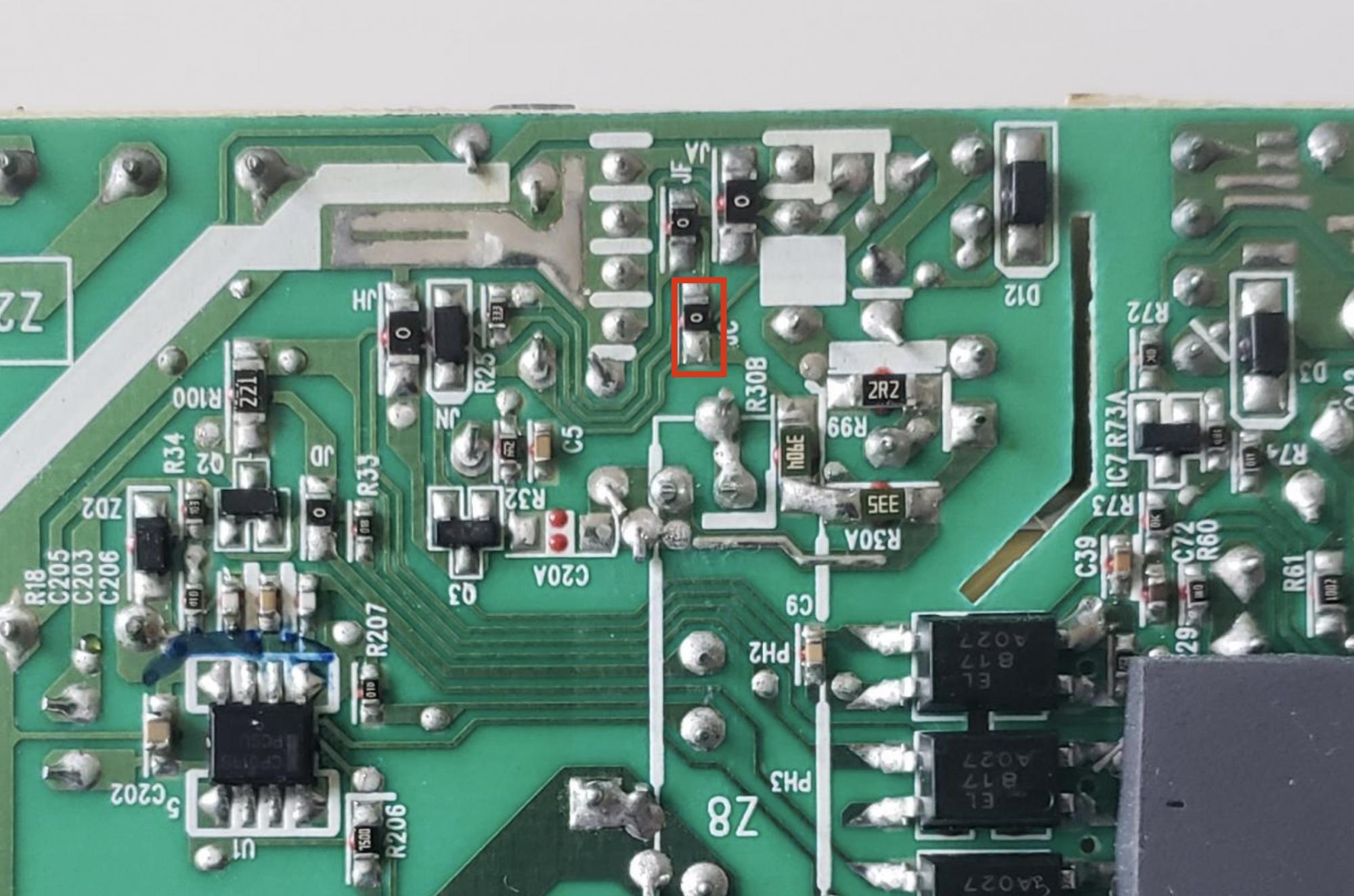

        I did remove the jumper in order to disable under voltage condition for TNY276PN IC, now I could see stb 5v on secondary is jumping from 1.2v to 5v and the led indicator of STB voltage on secondary is also blinking and not steady. These is fluctuation on main caps also from 171v to 173v. Looks like it's trying to start but something else is suppressing it and shutting it down. Any guess?

          Re: xbox 360 adapter - 240v to 110v
          There is a control IC on the back of the board: U1, I can't read its markings though, so post a better picture of that.
          Also measure the voltage on the primary bulk capacitor when running from your 240v transformer but with the unit in standby mode.
          Next start the main power supply and measure the voltage on the primary bulk capacitor again.
            U1 IC is CP0I9B (CP019BDR2G) however I couldn’t find a datasheet for it. I don't have 240V source to plug in.

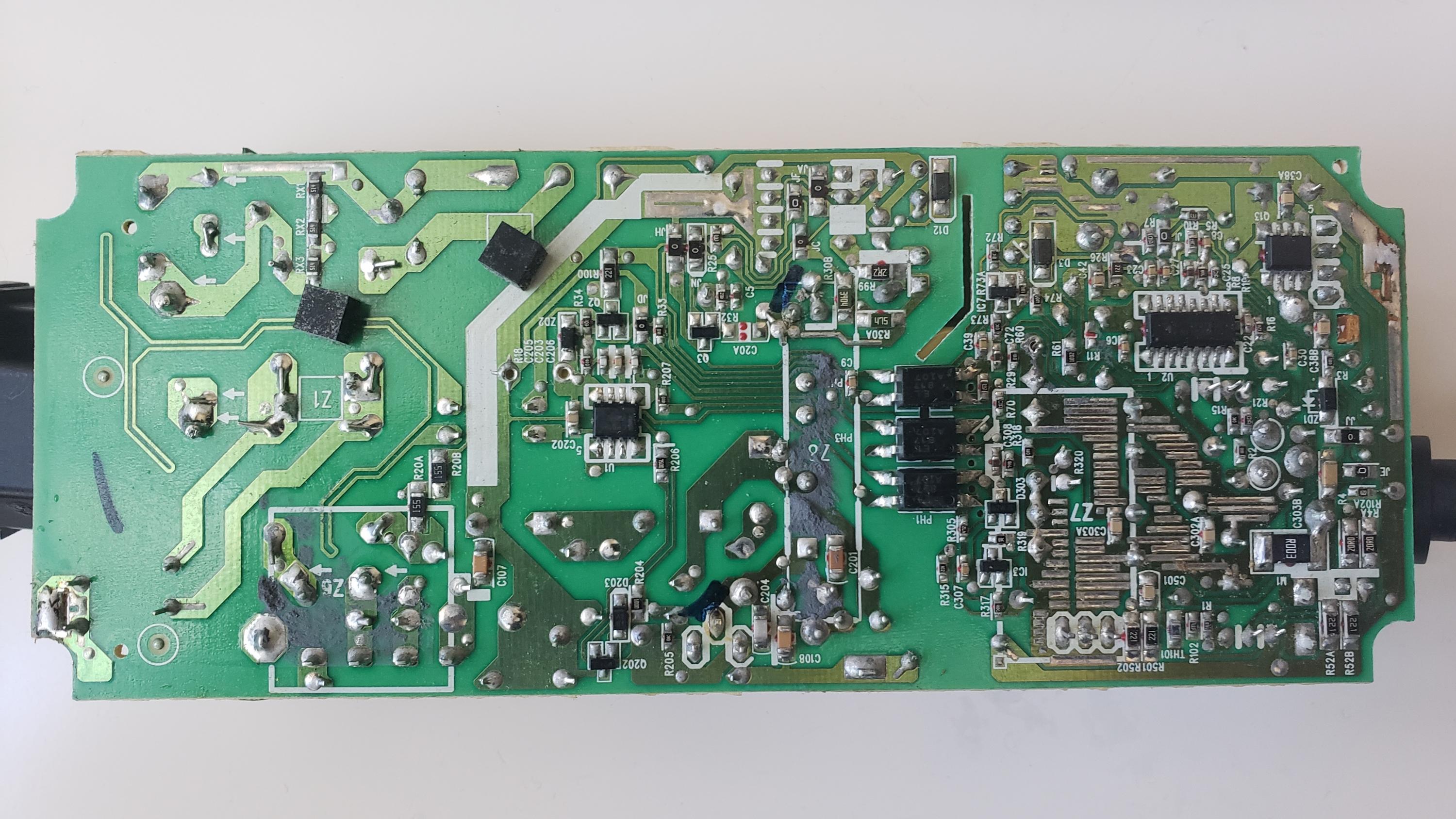

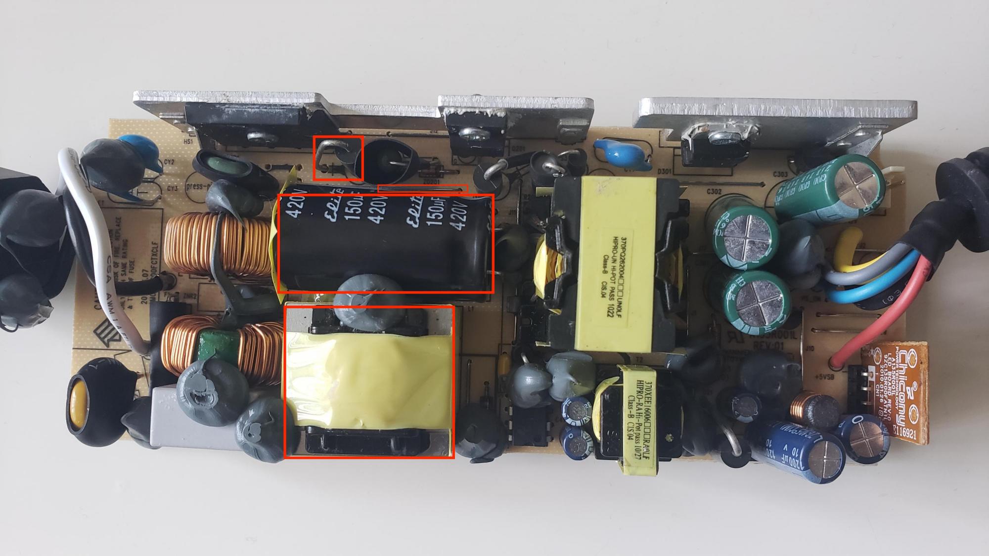

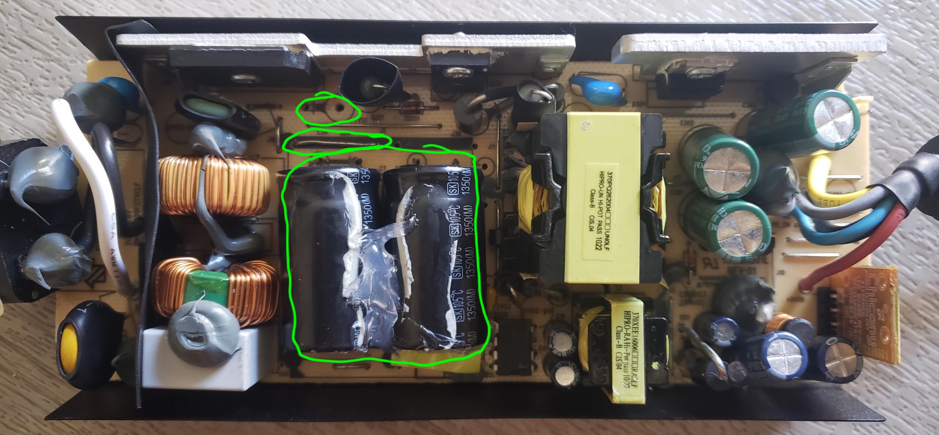

                    Thanks everyone for your replies. Finally I was able to make this modification in order to make it working with 120v by following other 120v power adapter circuit. As @Per Hansson mentioned in post #26, I have added two 200V capacitors in order to make a voltage doubler circuit and removed 420V capacitor. I have attached the pictures of the components removed and replaced with the steps below -
                    1. Removed PFC choke marked in RED color
                    2. Removed two jumpers marked in BROWN color
                    3. Removed 420V cap marked in BLUE color
                    4. Removed diode marked in YELLOW color (not sure if this was required)
                    5. Added two 200V caps in place where + and - marked with YELLOW color
                    6. Added two jumper in place marked with GREEN color
                    ** No modifications on Secondary **

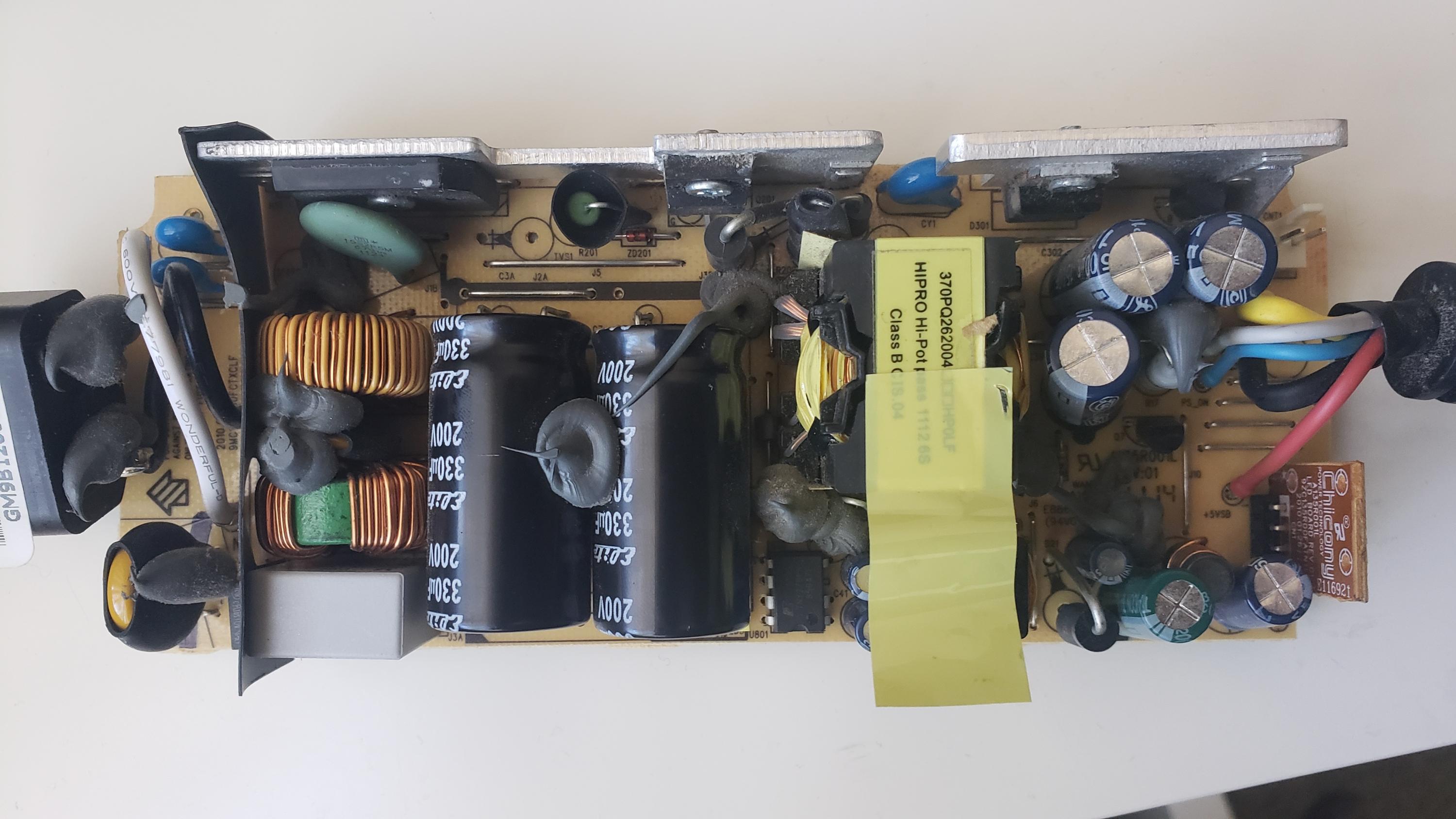

                      #30
                      Attaching photos of 120v power adapter circuit.

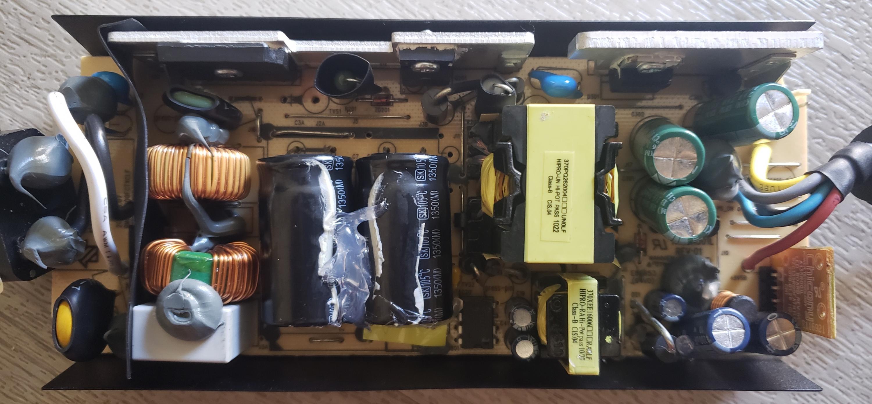

                          Please find the 240v adapter with all components replaced, now it works with 120v.
