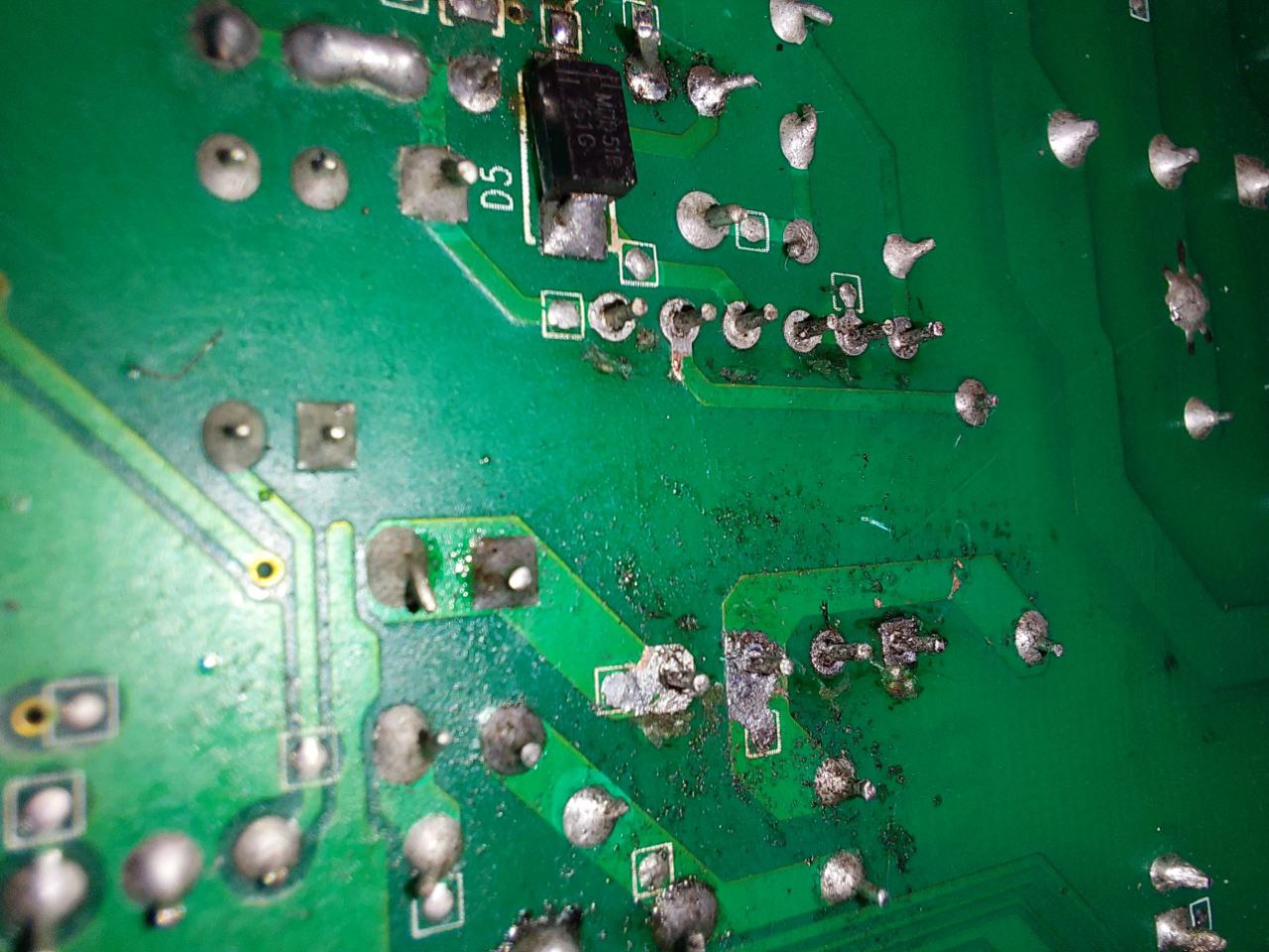

    Re: Cyberpower CP900EPFCLCD - F03 Error
    From the photo it looks like you are soldering with soldering acid, and it conducts electricity, you need to use rosin or acid-free flux.
    • Shinjinkun
      • Mar 2022
      • 35
      • Spain
      #42
      I am using this flux: https://www.jbctools.com/fl-15-flux-...oduct-150.html
      Not sure if it has acid or whatnot.
