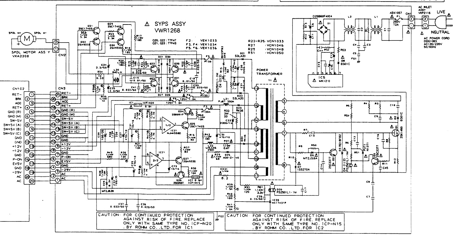

MK1210 chip SMPS based supply - can I fire this up?
  • dkneyle
    • Dec 2013
    • 445
    Power supply used in an Onkyo laser disc player, circa 1995?
    Came into the Repair Cafe after another tech had a go and gave up. Only evidence I could see of a repair was C22 (2200uF) cap had been changed and D25 was missing. The power plug had been left disconnected so I figured I wasn't going to apply power until I'd checked everything out. I replaced the usual suspects: the SMPS chip ML1210, all the electros except the main charge caps, the 33V zener, replaced the missing high-frequency rectifying diode. I meticulously checked over remaining components with my meter and all seem to look to be correct for their job.
    I reinstalled and put a dim-bulb tester in series. Initially the bulb glowed for a moment as the caps charged, then went out, but after about a second it came back on again. I didn't muck around in removing power just in case, but therefore didn't see if I had any life from the player. I've removed most components to see if the situation changes such as the MOSFET Q1, even pulled those charge caps (which appear perfect). There's almost nothing left in the circuit except MK1210. I did pull the bridge rectifier and there is no glowing bulb when that is out of circuit; I've since put a bridge rectifier back in circuit and the bulb glows.
    Now the dim-bulb test lamp is not glowing at 100% - I'd say about 75% and there is some flickering in it.
    My question is, am I perhaps being gun-shy? Is the dim-bulb tester preventing the SMPS from starting properly? I've had this before with a TV I was repairing. I took the risk with the TV, and without the DBT it started perfectly. The fact the bulb is not at full brilliance suggests it's not a short (and I don't measure any shorts either). [Why am I gun shy? Couple of weeks ago I was repairing a SMPS in an audio unit. DBT in series lit up, but I risked plugging it directly into mains. I was greeted with a very large bang as the encapsulated fuse blew its top off. But that turned out to be a crook bridge rectifier. In this case I've changed out the bridge rectifier just to be sure.]
    I've never come across a SMPS circuit quite like this one.
    Would you risk plugging straight into the mains?

    How many Watts is your bulb rated for? 40W? If so, that may be the reason why. Try 100W if you have one... or several 40W bulbs in parallel (3-4x). If not, step up to a 200-300 Watt Halogen tube lamp (I forgot the socket was called for that one.) If bulb still glows with that: STOP and re-check the PSU. But if PSU works with higher power bulbs, then you're good to plug it in directly.
    DBT can only be used to test PSUs with no load or very very light load. A rule of thumb I made up and follow is that the load on the PSU cannot exceed 10-15% of the bulb's power rating - i.e. for a 40W bulb, don't expect to pull more than 5-6 Watts from the PSU. And for a 100W bulb, 10-15 Watts would be about the max you can do. Of course, some PSUs may be able to provide more. And it also depends if the PSU is rated for wide-voltage range (100-240V) or standard 120/240V. The former typically uses flyback topology and is more forgiving with low input voltages (which is what happens when you have the DBT in series and apply a load on the PSU.) But standard voltage input SMPS tend to be somewhat more strict about what voltage range they will work in... so with a DBT, if the input AC voltage falls below 10-15%, the SMPS may cut out or act erratic.

      OK, I'd led myself up a dry gulch. After working my way backwards and removing lots of components I realised the substitute bridge rectifier I'd dropped in had blown (or might have already been defective?) Anyway, I dropped the original bridge rectifier back in and started slowly rebuilding the circuit. I got as far as replacing the MOSFET Q1 when I had full illumination of the DBT and an audible noise coming from the circuit. (Very glad now I have that DBT in circuit!) Suspecting a crook MOSFET I replaced it with a 700V 12A version, but no difference. I pulled Q2 and Q3 plus the PUT but no difference; still in overload mode.
      Trying to understand how this circuit actually works is doing my head in! Tomorrow I'll test those transistors and substitute/changeover the PUT and see how that goes?
      By the way, there is still no load on the output. The diodes on the cold side have all been lifted. There's not much left to check. Any thoughts/ideas greatly appreciated.

        I'm running a halogen 70W 230V globe - which is as close as I can get to a 100W incandescent. You can't actually buy incandescent globes in Oz any longer due to environmental initiatives. As per my most recent post, the DBT seems to be doing its job in saving circuit.
        I've repaired many SMPS. This one just seems weird. It appears as if the MOSFET is switched hard on. So what would be causing that? The two transistors check out OK on my transistor tester. I've pretty much manually checked everything else on the hot side. The PUT is about the only thing I don't know how to test so I'll substitute with a known good one.

            Well, I got the SMPS going (well, sort of...)
            So after spending many hours on it, even changed out the PUT with no different result, I got to the point of replacing all the secondary output rectifying diodes. And that seemed to be it!? It would appear (??) that in this design, if the secondary is not providing the necessary feedback via the optocouplers, then the big FET goes short circuit, and the power supply kills itself (not if you have a DBT in line though).
            So figuring I had this sorted I put it back into the Laser Disc Player (which also reads CDs). Initially I got no joy reading discs, but suddenly the CD was turning and appears to be working in that mode. However when launching a laser disc (these are actually quite heavy - never handled one before) the moment the motor starts up it causes the SMPS to shat itself again. Full brilliance on the DBT lamp and buzzing sound from the SMPS. Remove power, and we are back in business again. I assume if I had it directly connected to the mains it would have blown the input fuse each time it seem to go into this overload mode. What a strange design of SMPS; if something goes wrong on the secondary the primary goes into short mode and destroys itself!?
            I've noticed the fluro display is also non operational. Can't help but wonder if there has been a significant incident with this unit, such as a power surge??
            I'm going to start another thread elsewhere on the forum to see if anyone else has any ideas.
            • dkneyle
              • Dec 2013
              • 445
              Re: MK1210 chip SMPS based supply - can I fire this up?
              UPDATE: So after going around in circles I questioned whether the DBT in-line was preventing the SMPS from providing enough initial oomph to get the heavy laser disc turning. I figured I only had a 2 amp fuse to replace (hopefully).
              Well, it worked! Plugged directly into 230VAC. Laser disc spins up. But the player still has a couple of other issues for me to sort through. No fluro display and this problem where the discs won't initially load; the sled motor makes noises and it doesn't move into position.
              I still think this is a very strange design of SMPS. If something goes wrong on the secondary side the primary MOSFET goes fully short and would blow the fuse. Hence when it couldn't draw enough current to start the spindle motor (with DBT in-line) ii detected that as a fault and would have blown the fuse in normal situation.
                Yup, that's a classic 2-transistor self-oscillating circuit right there. They are brilliantly simple in that they don't need any specialty ICs. But that simplicity also comes at the cost of having almost no protections. Technically speaking, a 2-transistor self-osc. design can be made to have short-circuit / crowbar protection, and most should also incorporate self-limiting / over-power protection. In practice, however, very few of these circuits have these protections.
                Yours does seem to have both crowbar protection (via optocoupler D4 and Q3 circuit) as well as possibly self-limit / over-power protection (via Zener diode D5 and Q2, along with Q3 with resistors R11 and R12.) But just because the components are there doesn't mean that it will work. 2-transistor circuits are a bit tricky to design... and if one thing goes wrong in them, they often blow up.
                Which leads me to this...
                Yeah, you should NEVER do this (remove diodes on the secondary side and try to test the PSU without them.) All of the diodes on the secondary side need to be installed (or at least all the ones that generate voltage rails that provide feedback to the primary side), or else you may blow up the primary.
                And this doesn't just go for 2-transistor circuits. You can blow up / damage even PSUs with a PWM IC. Generally speaking, current-mode PWM ICs like UC384x series and similar would be pretty good at catching an open feedback signal. But again, if the circuit wasn't designed properly (and sometimes it isn't - go figure ) you will do (more) damage to the PSU.
                Well, it shouldn't... but in this case it does, probably because the over-power protection limit is set too high... or not at all?
                There are different ways to implement it for these 2-transistor circuits. Here is what a 2-transistor circuit for the 5VSB section of an ATX PSU (HEC Orion PD585d) looks like:
                https://www.badcaps.net/forum/showth...85d#post935081
                ^ On the schematic of that circuit, the 34.7-Ohm resistor (lower-left side of the circuit) gets feedback voltage from the two Source current-sensing resistors (2.7 Ohms and 2.2 Ohms in parallel.) When the current across them exceeds a certain threshold so that they generate about 0.65V or more, this voltage will then go through the 34.7-Ohm resistor and turn-On the small PN2222A transistor, which in turn would pull the Gate of the MOSFET (2N60) low and turn the MOSFET Off. The MOSFET won't stay off however, because of the 1-MOhm pull-up resistor on its Gate. Therefore, in the event of open feedback or short-circuit on the secondary side, this 2-transistor circuit will rely solely on the Gate current-sense resistors and the 34.7-Ohm resistor for limiting power.
                Now on your circuit, this appears to be done through resistors R11, R12, and Q3. Increasing the resistance of R12 will lower the over-power limit... but may also have other implications in the circuit. So overall, it's better not to experiment with it, unless you plan to do a full set of extensive tests on the PSU to see how it because at various loads and scenarios.
                Oh, and as far as the MK1210 chip - that's just an input voltage sensing IC. It's used to automatically switch the operation of the PSU when it is used in countries with 110/115/120V AC. When it detects a 120V system, it will simply connect the "middle point" of the two big input capacitors to Neutral, essentially creating a voltage-doubler circuit. But when the IC is used in countries with 220/230/240V, it breaks that connection and imply runs the AC through the bridge rectifier and then stores it in the two big series caps.
                IMHO, that's a bit of a useless feature, since I don't imagine you would bring this player to another country with 120V AC.
                  Thanks Momaka for such a comprehensive explanation of how this particular circuit works. Very comprehensive explanation for what I was observing. Answered so many questions, like what that MK1210 was doing there?
                  On your advice I'll ALWAYS make sure I have everything on the secondary side of a SMPS operational before attempting to fire it up.
                  Finally spoke to the (actual) owner to get an idea of what had actually occurred. They suffered a "brown out" event and it took out various other HiFi appliances at the same time. I'm assuming when the mains voltage came back there was a surge down the line.
                  On this SMPS I believe the only component that had failed was D23 (or it could have been D24). Part number described it as a 60V 2A Fast Switching diode. The original repair shop appeared to know nothing about SMPSs. Yes, the faulty diode had been identified, but in the bag of parts left behind inside the unit, I found a new pack of regular rectifying diodes (IN4004 or something similar) and I assume the tech working on it had discovered they didn't work, and he gave up in frustration. The unit was returned to the customer with the comment "it's too old and we can't get the parts". I'm only a hobbyist running the Repair Cafe as a volunteer service to save electronics from entering landfill. But pretty sad to think this is how "professional service centre" staff are with their level of training and knowledge of electronics repair.
                  Sadly I think the fluro display is kaput. It picks up the AC to drive it from the SMPS transformer. I'm assuming the overvoltage surge translated to an overvoltage on the AC line for the display and took it out. Fairly unique part - doubt I'll be able to get another one.
                    Yes, that could indeed be what happened.
                    Or it could be that the extensive brown-out just blew the 2-transistor circuit. These 2-transistor self-oscillating circuits may not always deal well with low-line AC voltage. Another possibility is that the MK1210 chip got confused from the brown-out and tried switching to 110/120V AC mode for a bit, possibly causing an over-voltage on the primary side, which eventually made the diode on the secondary go bad? Well, hard to say exactly what happened... but in any case, glad to see you got to the bottom of it.

                                      Well, disregard most of what I said in Post #18. After quite a few hours of heat soaking the problem returned. Some careful application of heat from a hairdryer and cooling with freezing spray would seem to indicate R33 (which coincidentally in 33 ohms) is the culprit. It actually reads as 27.5 ohms, which is outside the expected 5% tolerance. When I can get my hands on a proper high wattage resistor I'll change it out and confirm if it the source of the problem. Interestingly, it is connected to D23, which was the original rectifying diode that failed.
                                      I'm not quite sure of the job of R33? Any hints are appreciated. Momaka?
