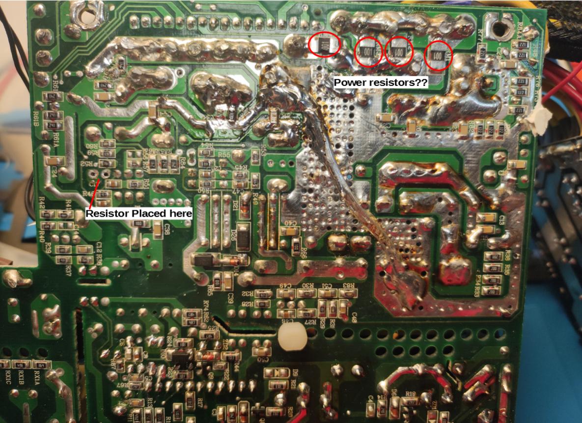

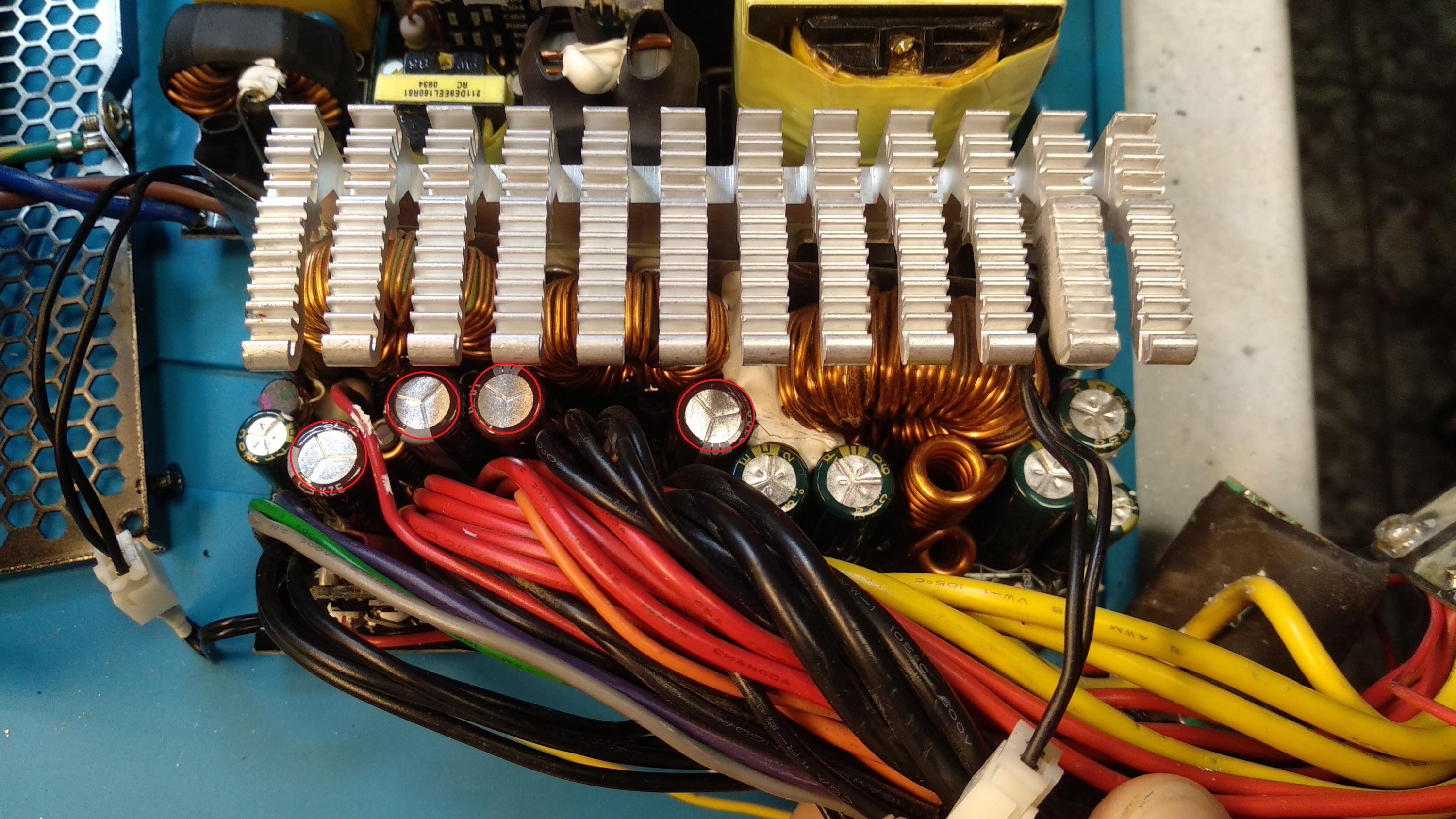

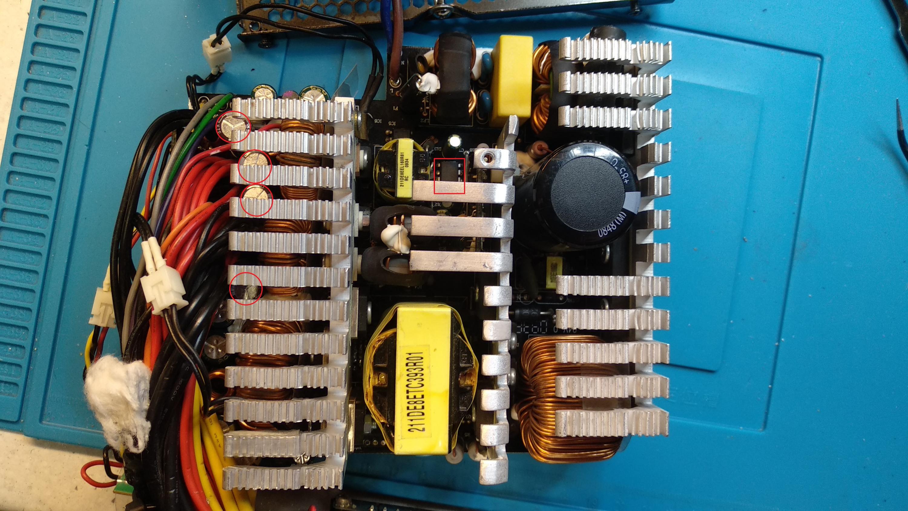

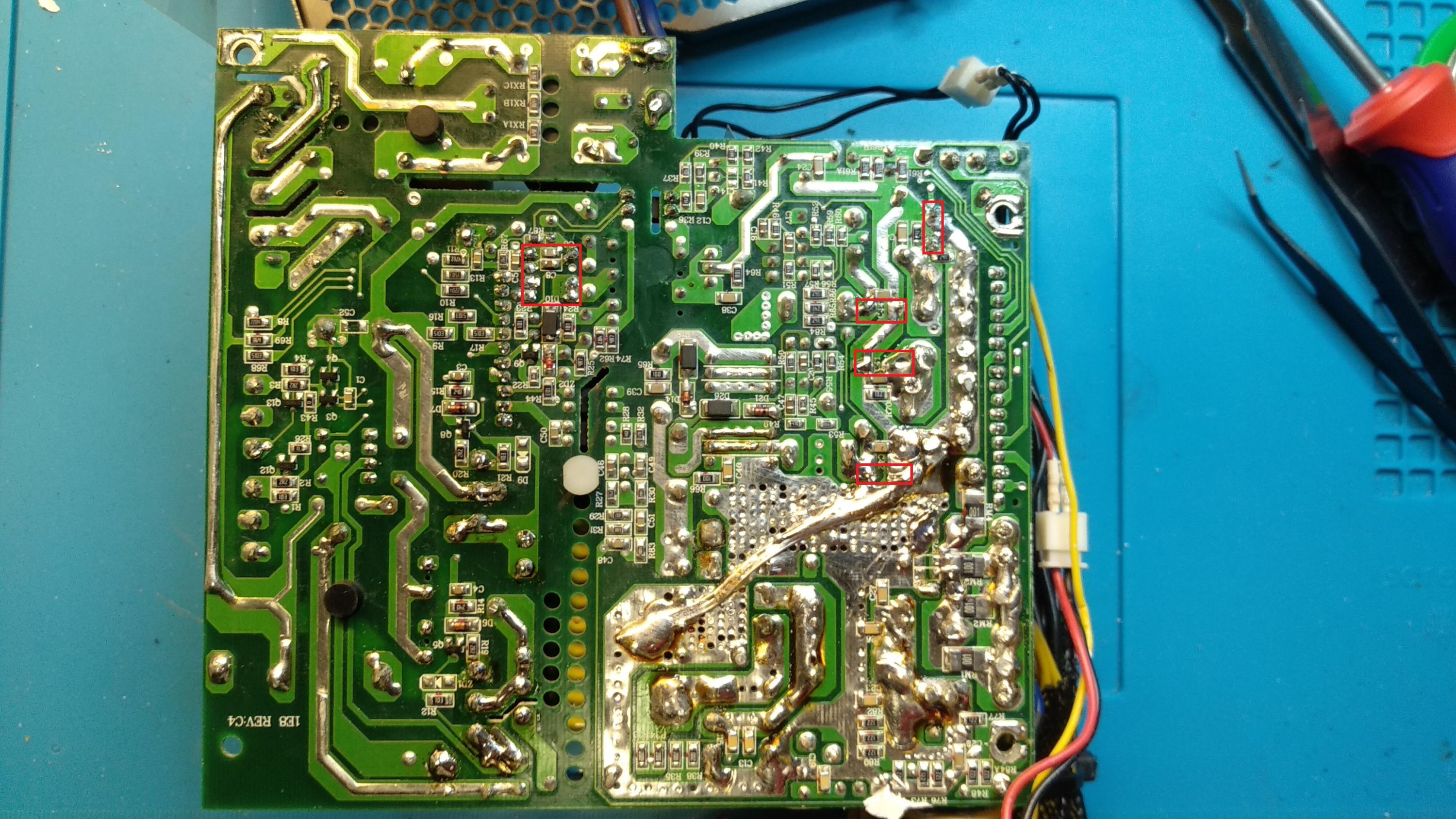

    I have repaired a few PC PSUs before, but the problem has always been a broken Mosfet and blown capacitors fails. Now I am facing a PSU problem that I haven't seen before.
    I have a Xilence 1200 PSU that had 4 broken capacitors on the 5V and 3,3V lines, and a faulty mosfet driver (A6069H). After replacing these components, the PSU starts up and turns on the fan providing all the correct voltages at the output, but shuts down after a second. when the output is low again (capacitor discharge, I guess), the PSU starts up again and repeats the whole process.
    I think it has to be with some kind of overvoltage or overcurrent sensor, but I can't find the faulty component. I have also tried connecting a small 12V motor to the 12V output and I see that it keeps restarting but the motor turns (I guess I shouldn't try to connect an inductive load, but that's what I have...).
    I uploaded some pics with a red circle/square over the replaced components.
    I have no idea how to proceed. Any advice or hints would be appreciated. Thanks in advance!

    Re: Xilence 1200W. Keeps restarting
    Look for a capacitor that is around 10 to 50uf or could be a little higher than that is close to the switching power supply regulator ic chip ( that you have replaced already A6069H) and replace it even if looks ok and see if it makes a difference or not
    There are some ATX switching power supply that require a load on either the 5 or 12 volt rail to work correctly so be aware of this as well use some automotive type head light bulbs would work better for this I done this myself
    Or you could have a rail that is pulling to much current
    Check with out power to board and see if you have a short on any of power supply rails with a ohm meter
    I hope this helps you

          I have tested the PSU using a motherboard and it still does the same...
          Originally posted by sam_sam_sam
          Do the power supply rails have a power resistors on them because your ohm reading are a little low

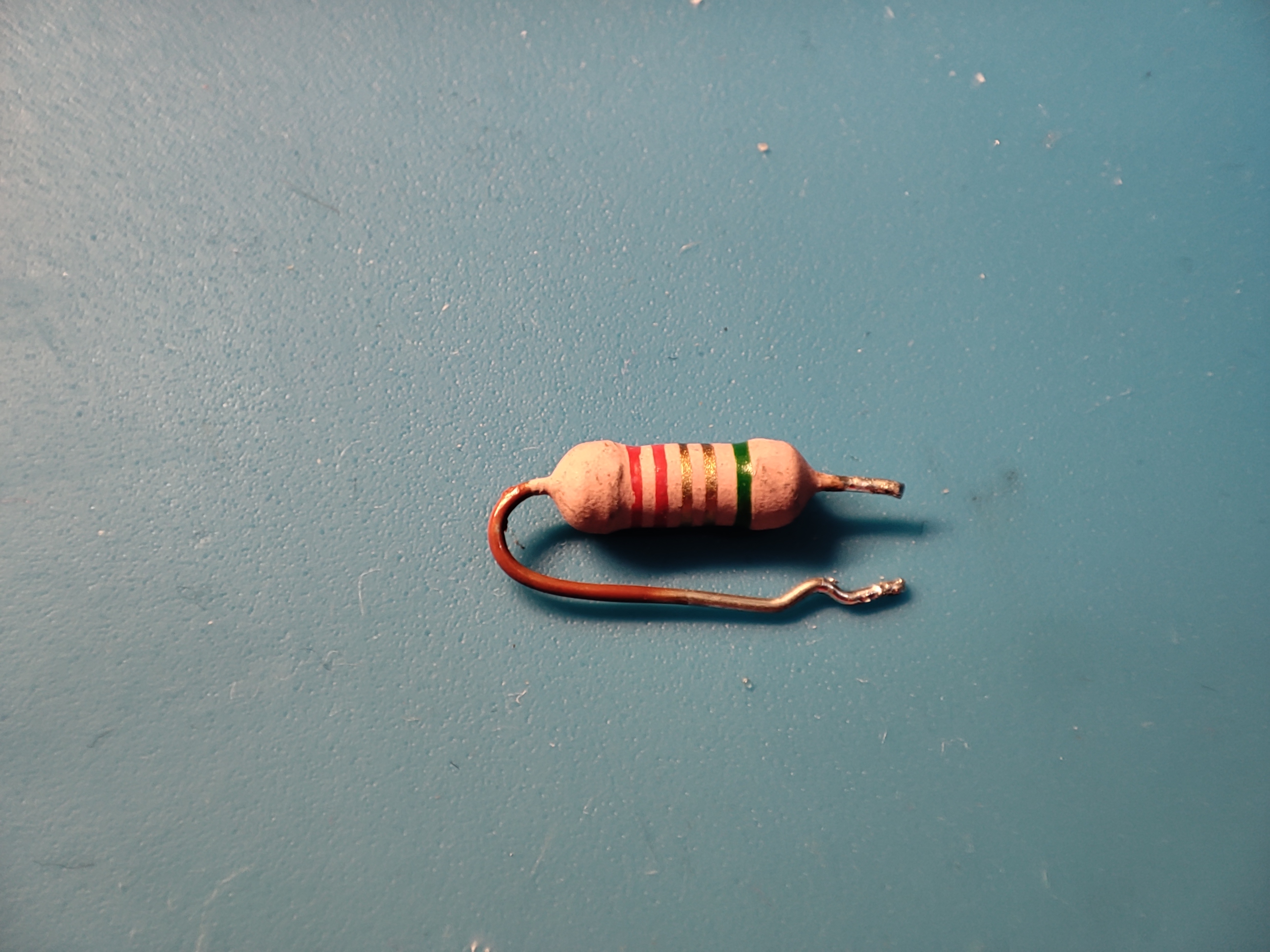

          Yes, it looks like it has SMD power resistors. I don't know their value because the "001" code doesn't seem to follow the standard (I'm confused). If I measure the resistance there, the multimeter shows 0.1 Ohms (the minimum resolution of my multimeter is 0.1 Ohms).
          There is also a through-hole resistor near the rails that is very odd... I haven't seen a resistor with 2 gold bands in the 3rd and 4th position (photo attached). The value read with the multimeter is 2.2 Ohms. I guess it is ok.
          I don't see any other power resistors near the rails.

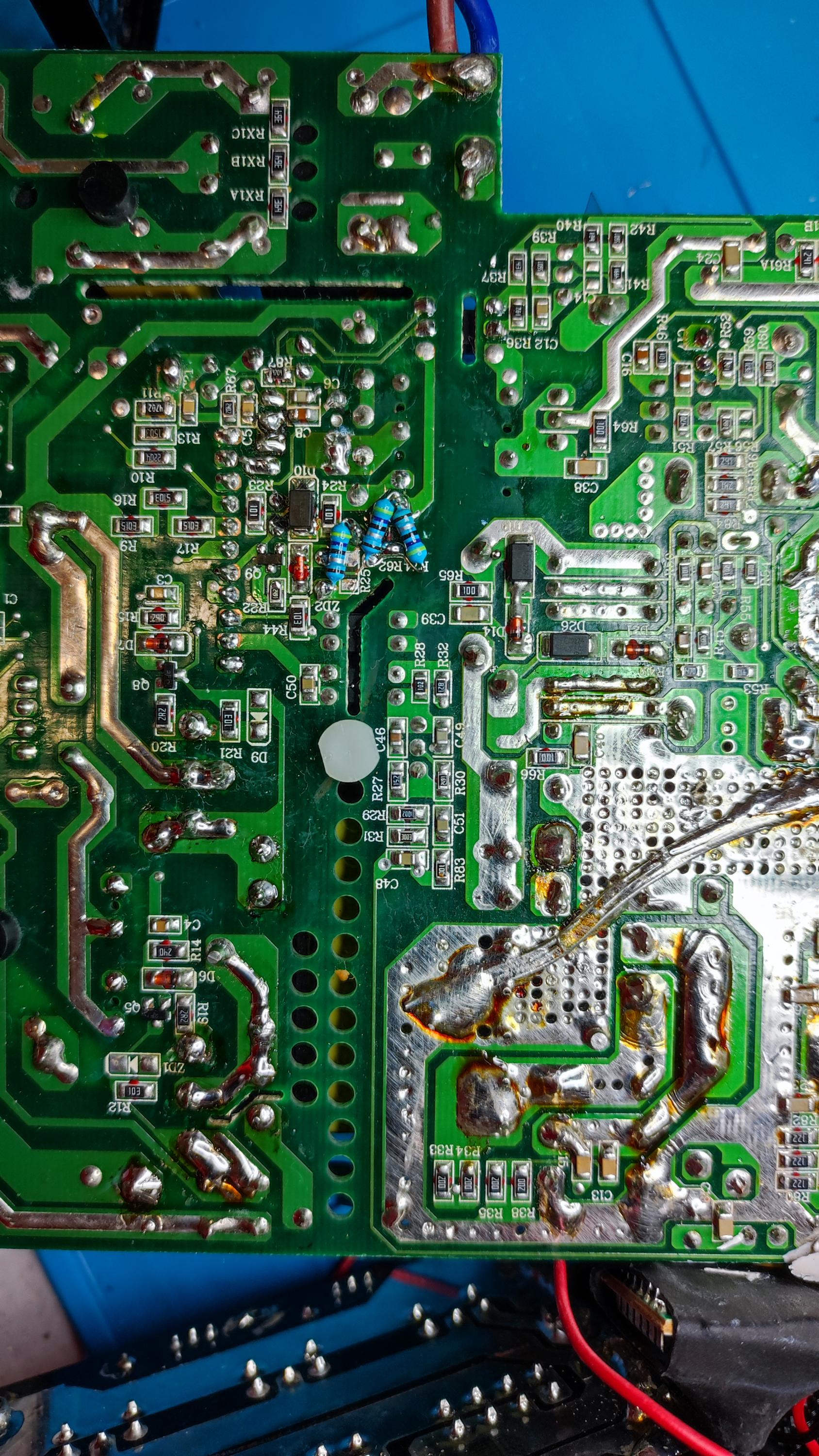

              After some tests the power supply stopped working definitely. I checked the board again and noticed that 3 resistors were broken (R62, R74, R25), so I replaced them with 4.7 Ohm resistors (I didn't have SMD resistors of that size).After that, when I plugged in the power supply and turned it on, I heard a clicking sound and nothing .... After that, when I plugged in the power supply and turned it on, I heard a clicking sound and nothing .... I have not heard that clicking sound again.
              I checked the diodes again but I don't see anything bad. I'm about to give up on this one.... I'm starting to think this PSU has more than one thing broken. I'm not sure if I broke something while checking it, but I don't think so.....
