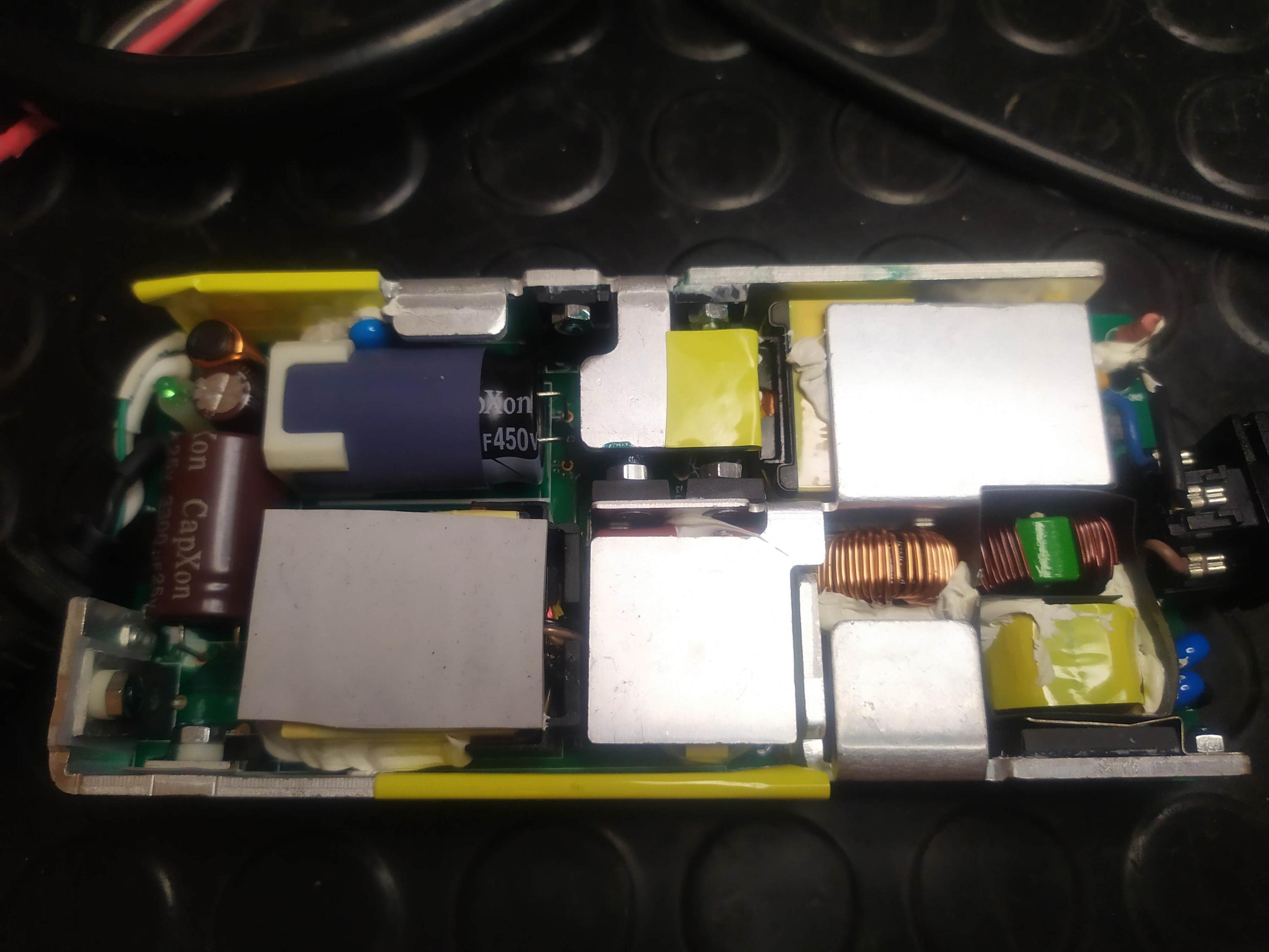

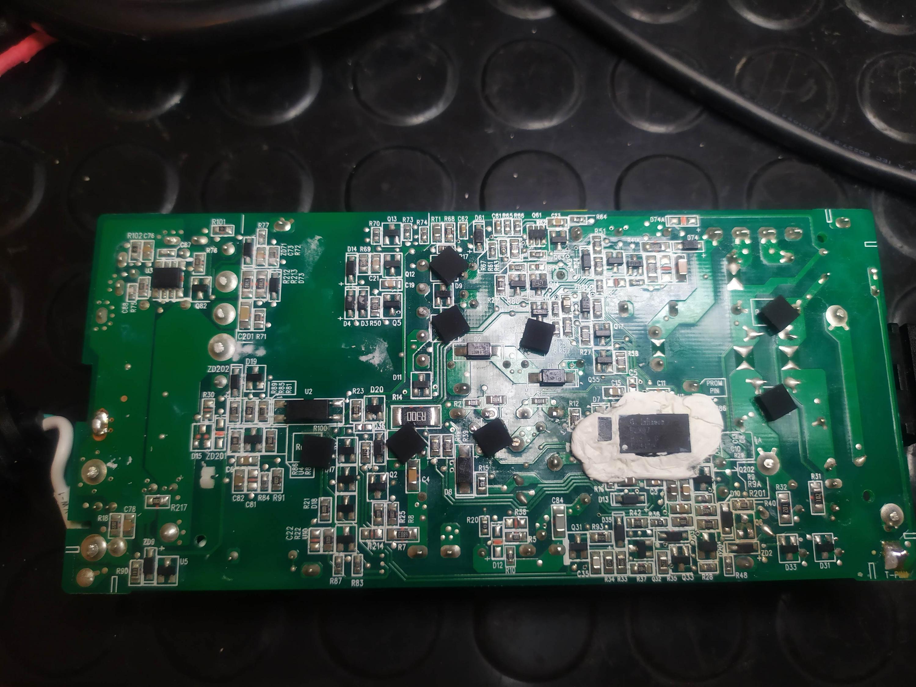

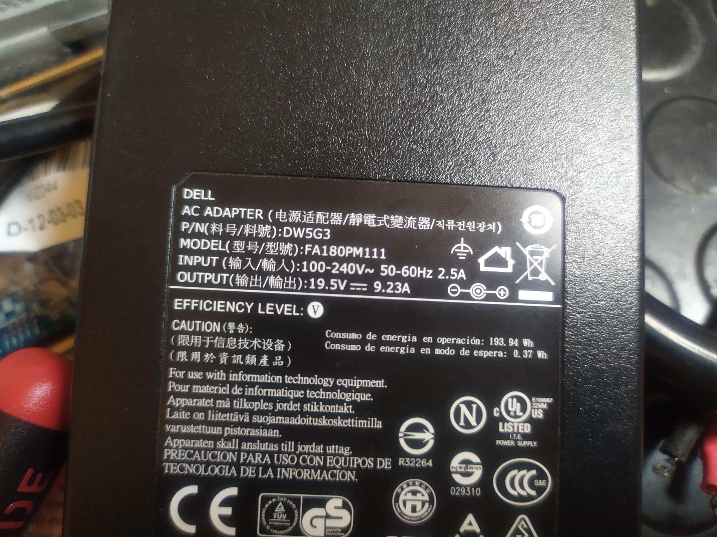

    I have a broken FA180PM111 / DW5G3 DELL PSU which has no output.

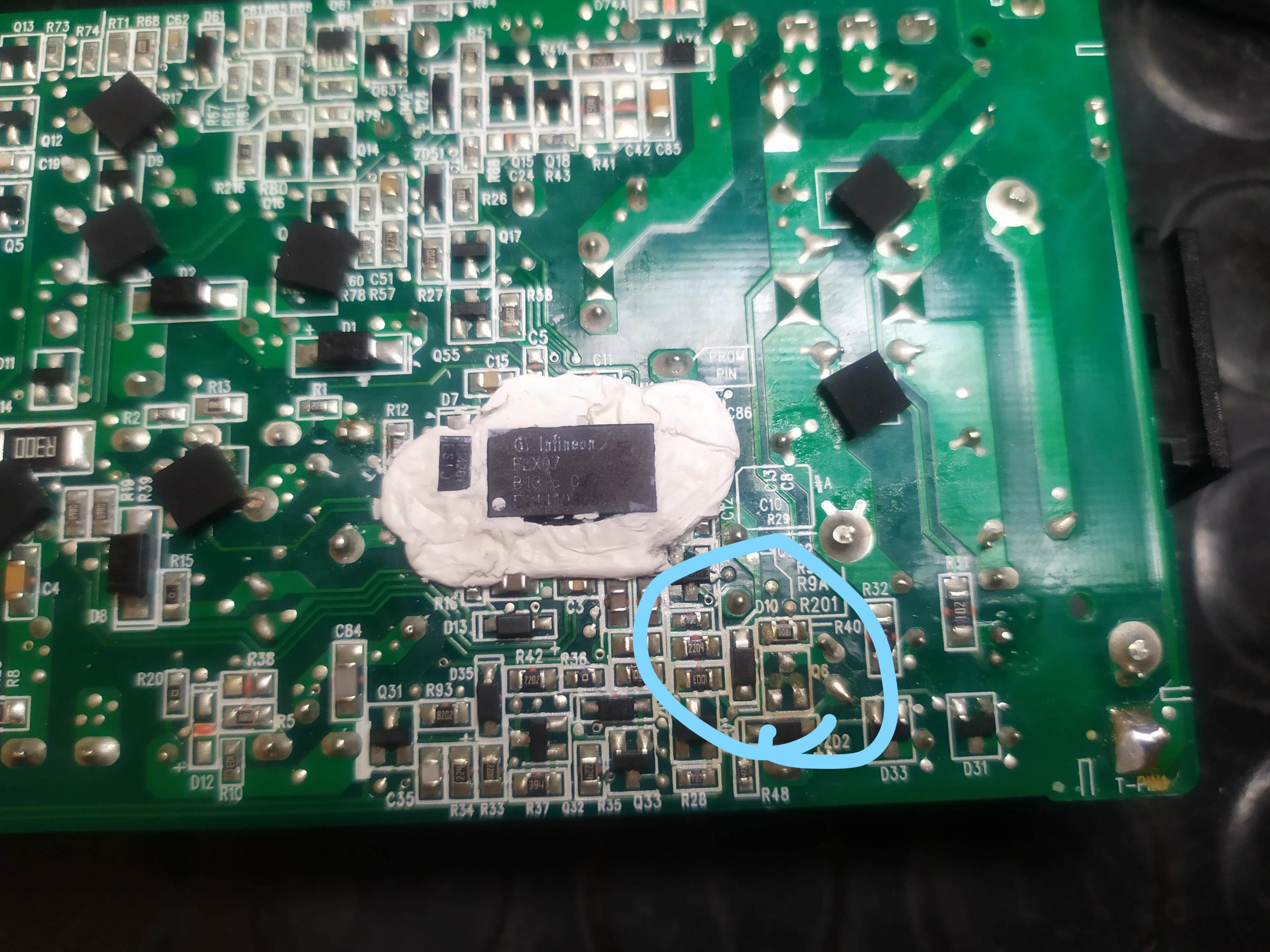

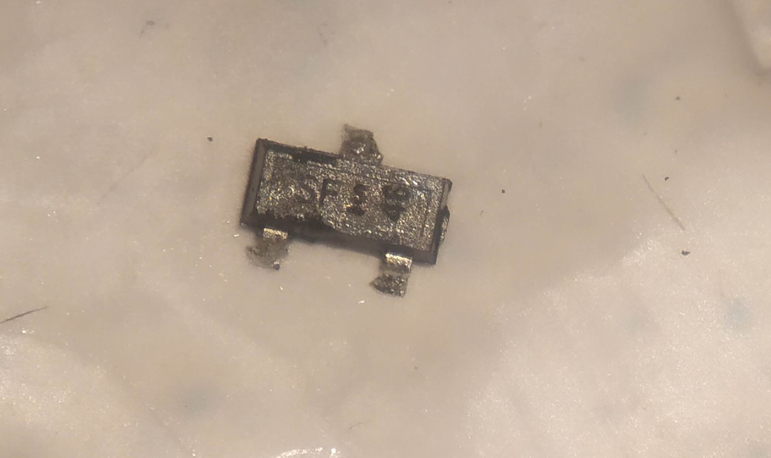

    While checking several components, I found out that Q6 has 2 shorted pins, so at least this component needs replacement.
    The problem is that I can't find any schematic/service manual of the psu, neither of the component.
    I can barely see (with a microscope) that the marking is something like SF546, but cannot find any smd relative to this.
    I attach photos of the psu and the component as well, so any help would be greatly apreciated.
    Thank you in advance!

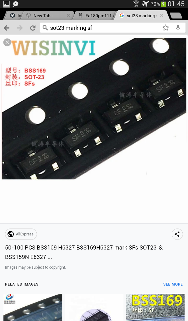

      BSS169
      But... have you check after desoldering... is short is gone?
      I see some traces accross pins and 1R near by...

        There was no short, but the resistor was at a sensor trace, so i just have to replace it and it worked.
