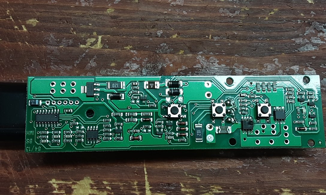

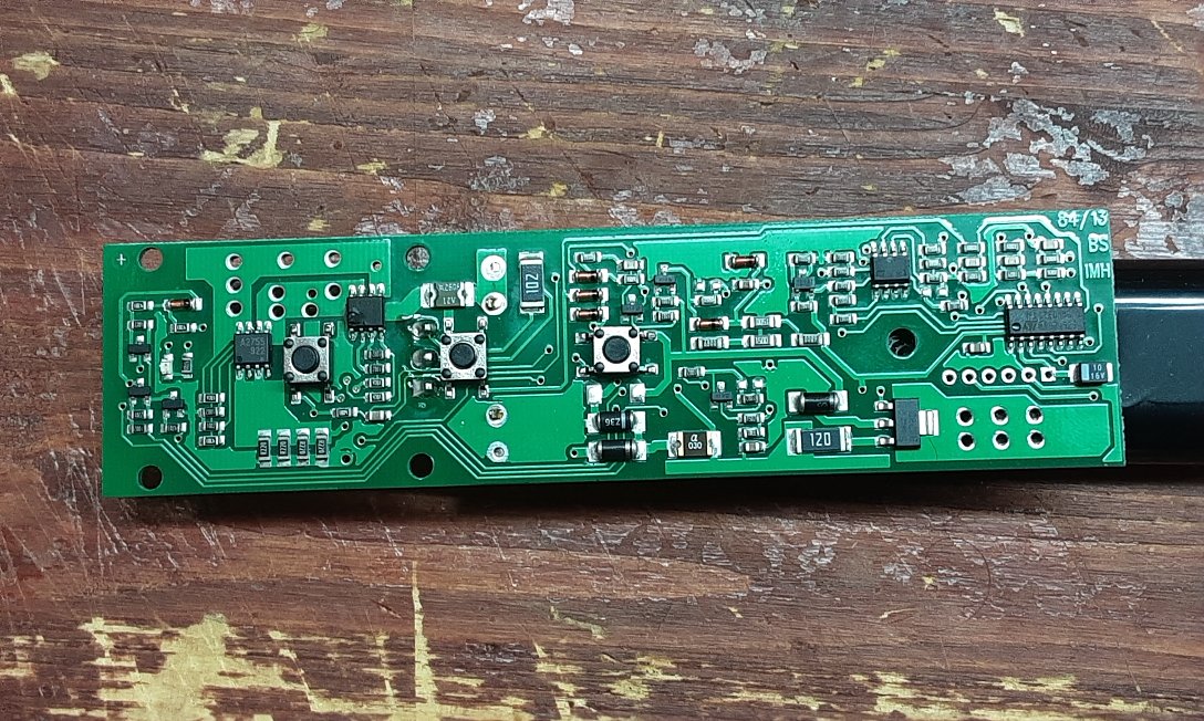

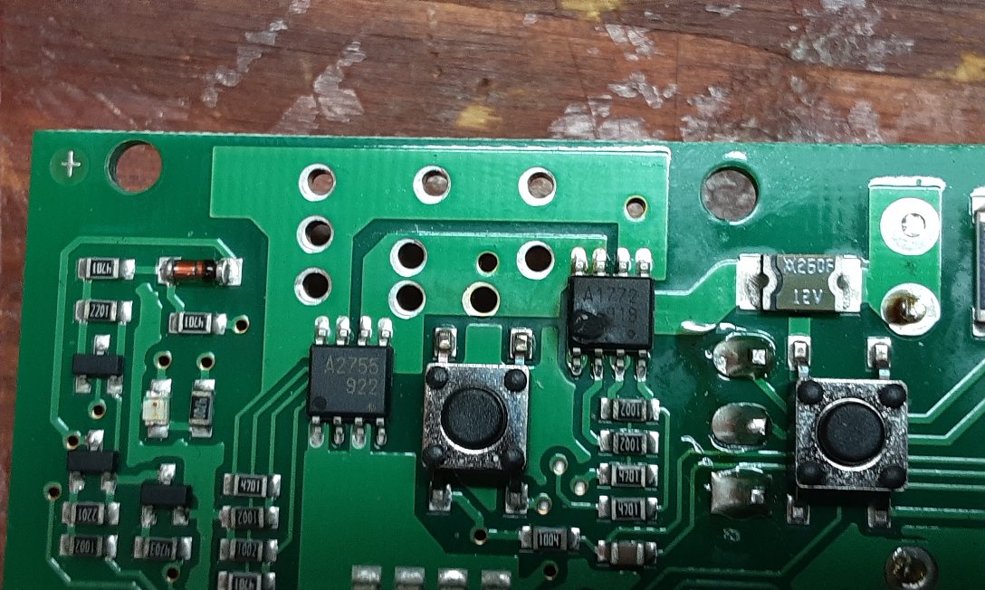

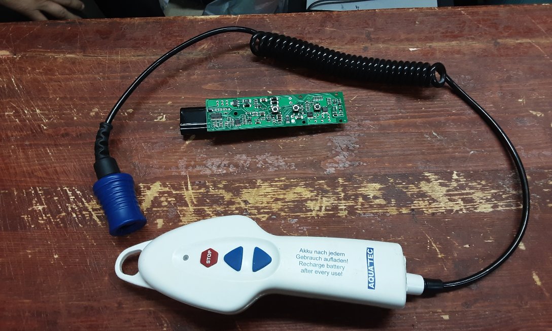

    hi guys,i been looking around to find this part number but find diferent info and kind of getting confuse....can you tell me exactly what part it is and with what can i replace it with.(a1772) on 1st photo you see the burn part that seem to be a power mosfet.

    Re: need info on this part
    I suspect it is a Renesas µPA1772
