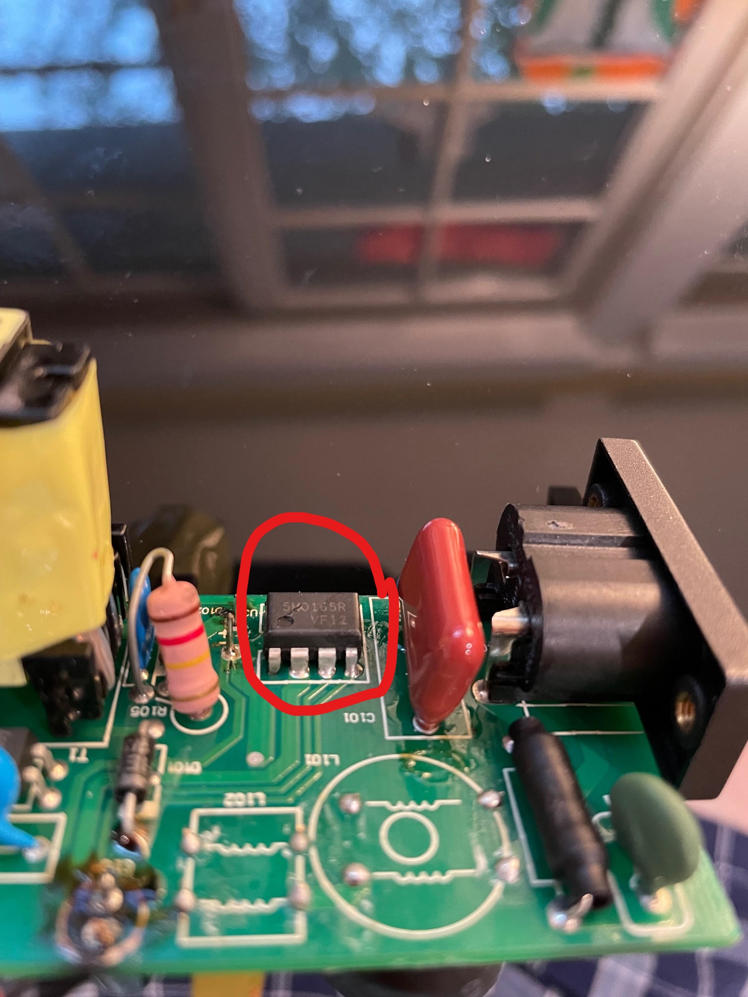

    Hi, I am trying to revive a Sonos Connect power supply (currently totally dead). No obvious damage to the eye, so I just decided to simply replaced all the Caps first. Unfortunately, that did not fix it.

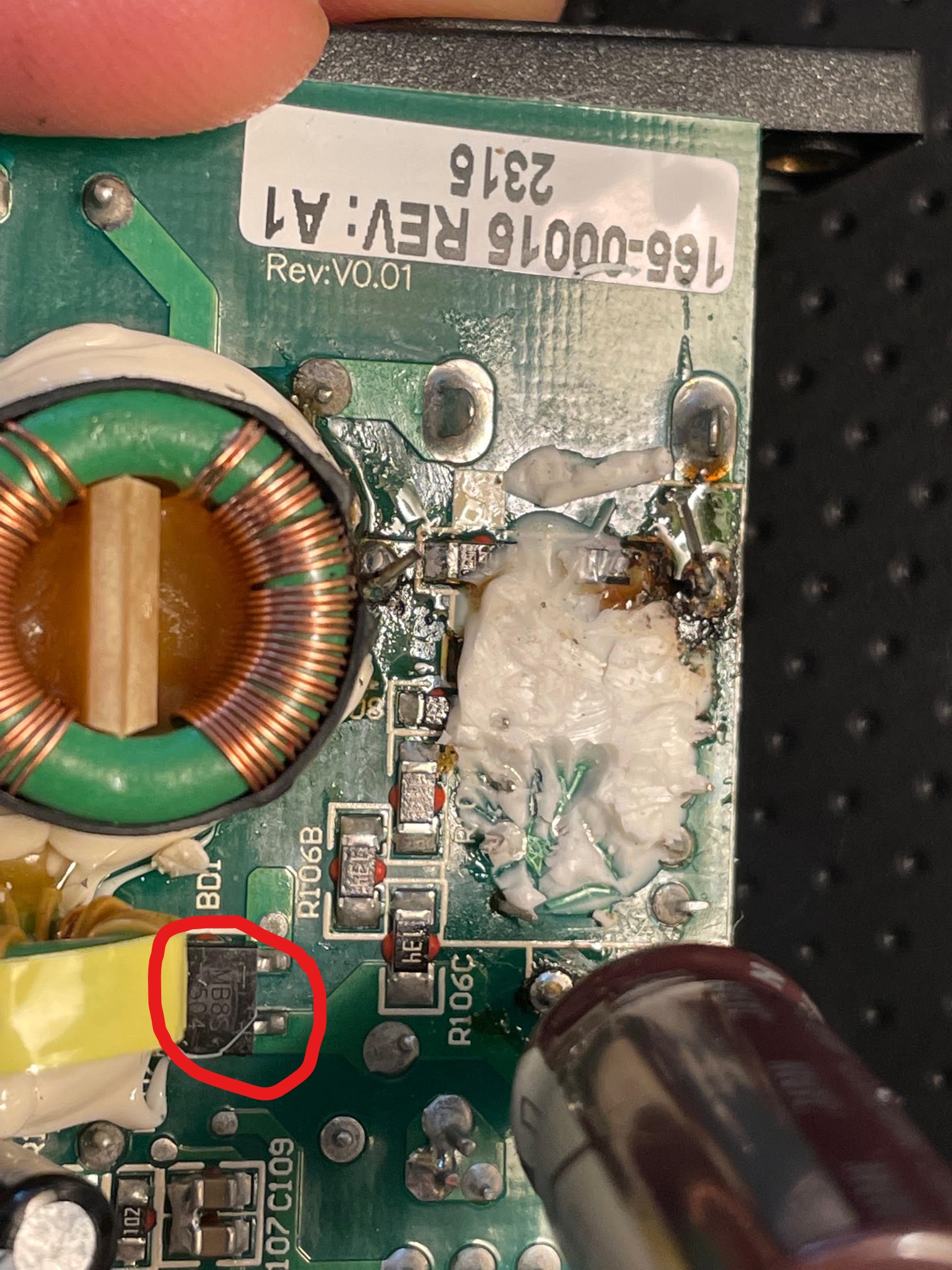

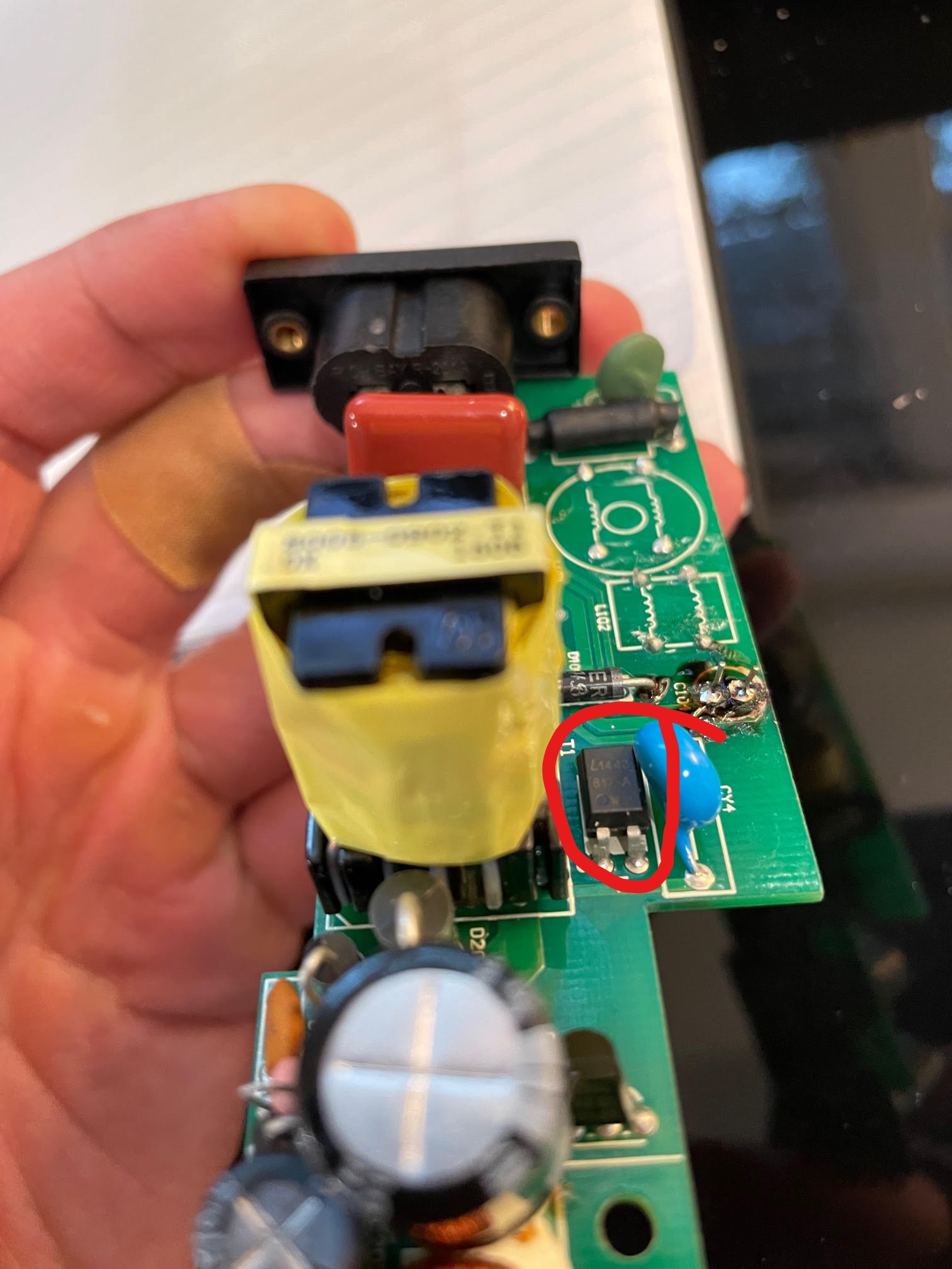

    Next, I'm thinking it could be one of the surface mounted chips. Particularly, one four pronged chip label says L 14 43 817 A W has no continuity (1st picture). I'm assuming this means it is bad? (But not sure.) Can anyone confirm if lack of continuity with this chip means it is bad? If so, can you suggest what this part is and what a replacement would be?? I am including pictures offending chip and the others on the board as well. Help identifying the other chips as well would be good.
    All surface labels are as follows:
    chip 1 four prong: L 14 43 817 A W
    chip 2 eight prong: 5M0165R VF12
    chip 3 4 prong: M685 Y504
    Many thanks in advance for the help.

    The 4-pin chip is an optoisolator and it is supposed to not have continuity as it bridges the feedback loop across from the secondary to the primary side where the control chip is, the 8-pin one. That is what you should replace.

      Thank you very helpful information. Would you have any idea how to track down a replacement for the 8 pin chip? Not sure what I should be looking for. Also any way to confirm that 8 pin controller is the problem?

        Google has your answer, as usual: https://datasheetspdf.com/pdf/548565...hild/5M0165R/1
        In the data sheet you will find the testing procedure as well.

          Thanks.. I ordered a replacement. I hope to attempt the repair as soon as I receive it. Will let you know the outcome,

            I replaced the controller chip that arrived yesterday. I am back up and running!!! Thank you very much for your guidance, it saved me buying a new unit or doing a more crude workaround with using 2 separate power supplies!
