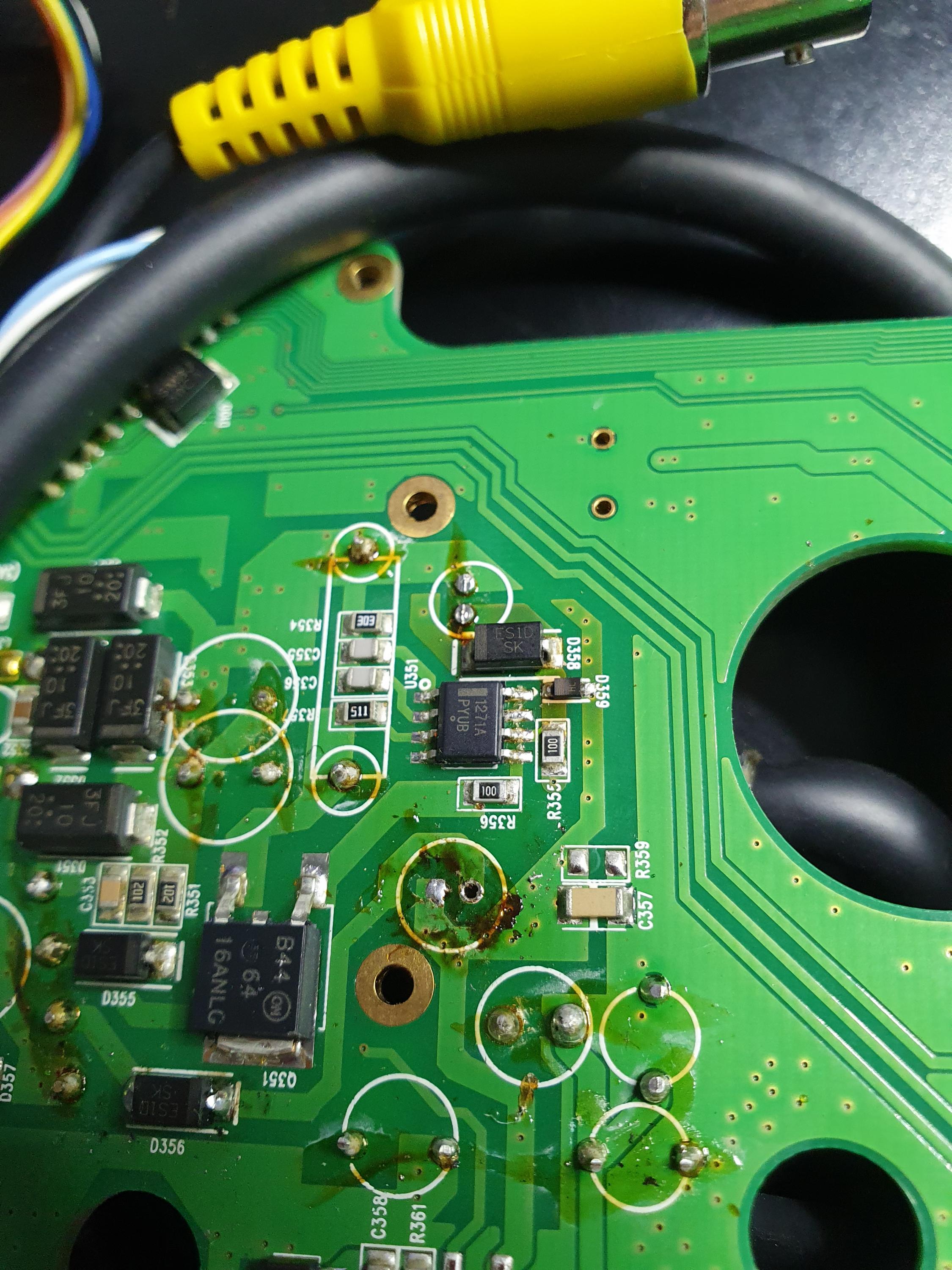

    Good day folks. Bit of a dilemma here and I'd like some help so as not to spend too much time and resources on something that may be either really easy to fix or a rabbit hole.
    I pulled out an old Bosch analog PTZ CCTV camera from one of our sites. The camera was dead - no power and no signal at all. I took it apart and after some tinkering I found it's not getting any power to its "brains". It takes a 24Vac input which is then rectified and dropped down to 12v (I think) by a small power supply based around an NCP1271. When I first got it, there was absolutely no power on the output of this internal PSU at all. I managed to get it going to a degree, but it's still not enough: initially, I found a short on the VCC pin of the IC (D359 - sorry I don't have a pic of the whole board and it's pretty messy on there). Based on how it was installed (anode to GND and cathode to VCC) I figured it's a protection diode and after removing it, I tried to fire it up without it, since I don't have a similar one. I now get 17v on the VCC pin of the IC and 12v on the output caps, which is fine, but when I connect the head of the camera, it shuts down and power cycles every 5s or so. I though the head itself may have some bugs of its own, like a short, so I tried a small 12v fan on that 12v output, but got the same result - the output shuts down and begins to power cycle. It's worth noting the the VCC pin of the IC ALSO drops down to almost nothing with each cycle. It then SLOWLY goes back up again and once it reaches around 12v, the output goes high again, before immediately shutting down. This makes perfect sense, since the datasheet clearly tells us UVLO is 12.6v.

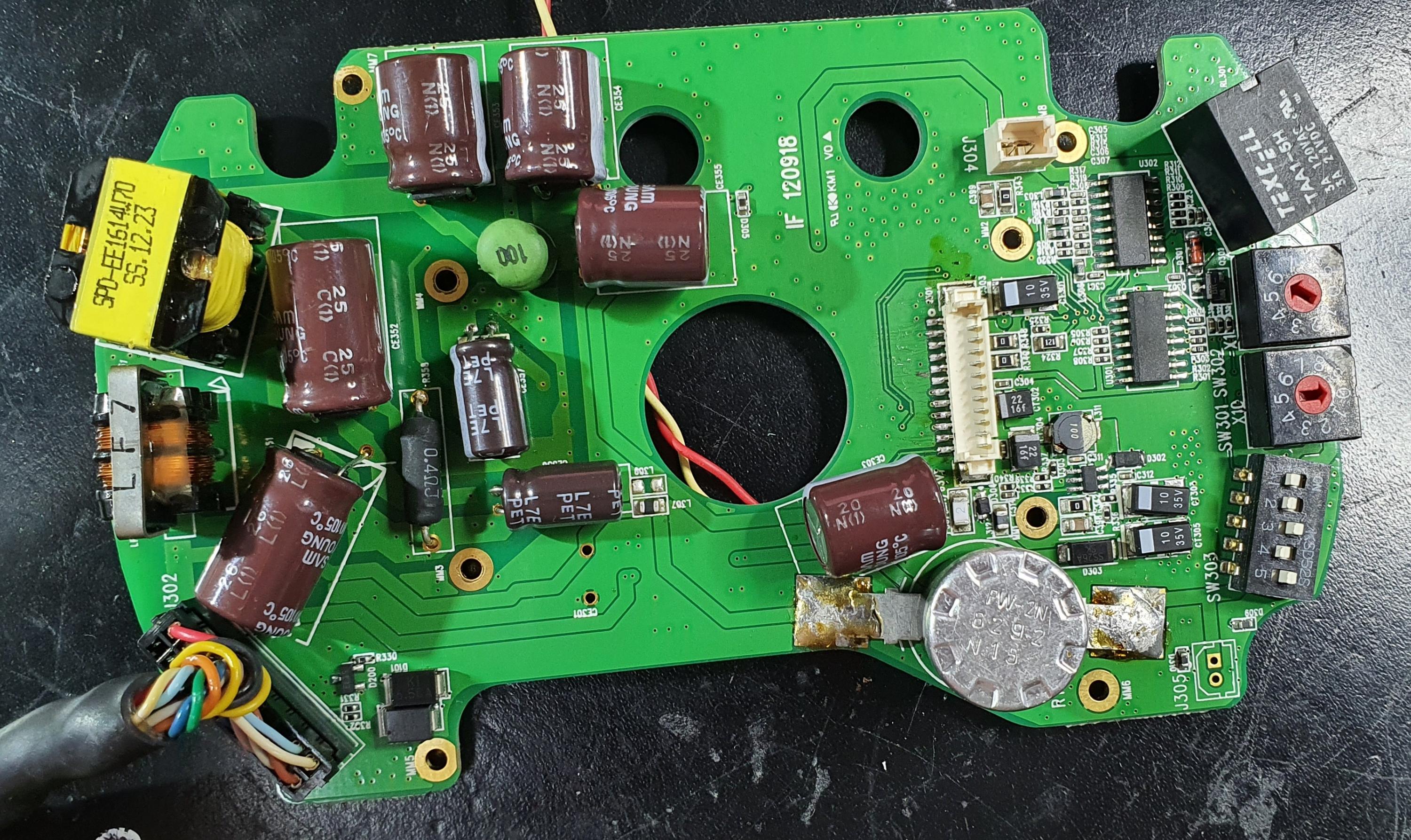

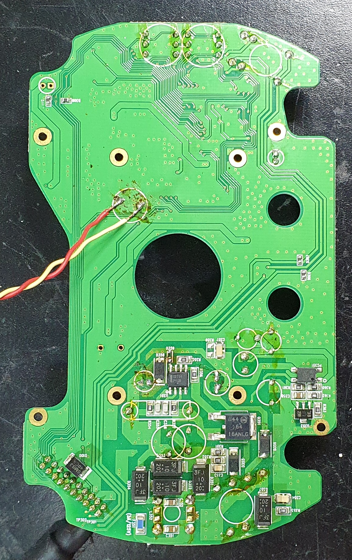

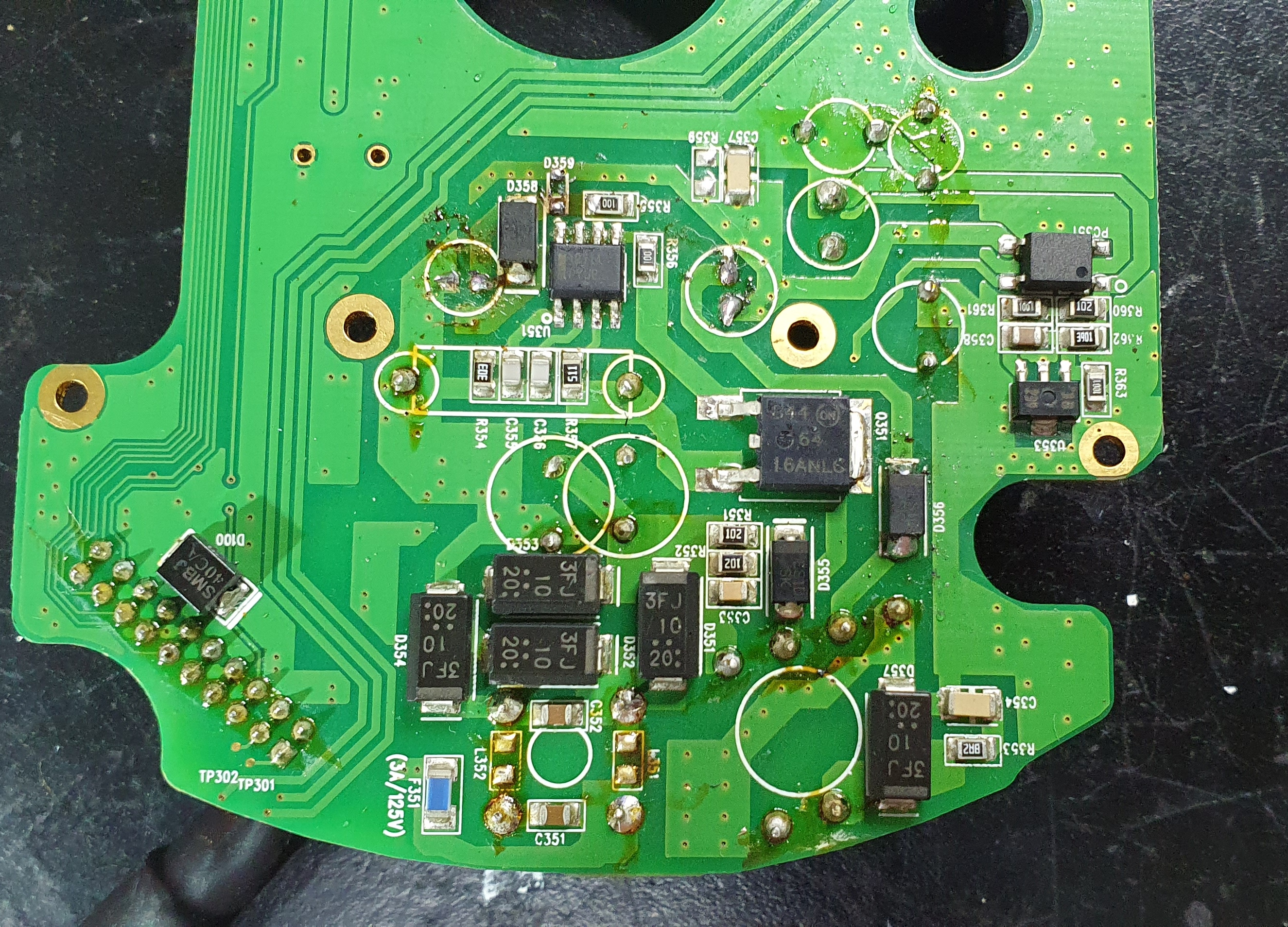

            Here's a follow-up with some pic of the whole board. There's not too much going on. Power supply is on one end, while the stuff at the opposite end most likely has to do with RS232, as I spot some trimmers which probably set the address.
            The CS resistor is the black thru-hole 0.4ohm one and it reads almost a dead-short, so it's probably fine. I'll try swapping the 6 remaining caps. The two on the left are in parallel and are for the HV DC input and the 4 on the right and top are also in parallel and are the output. You also see two wires soldered on there: I used them to place a load on the output and also to test if the PTZ head still works by sending 12v from an external supply straight into the output of the internal supply, so as not to make this whole attempt pointless in the end. Cheers and thanks.

              Re: NCP1271 power supply not working under load
              Update: camera is now working. Turns out it was a combination of missing zener diode AND bad caps. I installed the missing 18v zener diode and replaced all the caps, both for the input and output sides. I just replaced them all in one go, so I'm not entirely sure which ones were at fault, especially since they appeared to be within spec on my ESR meter. Cheers and thanks for the input
