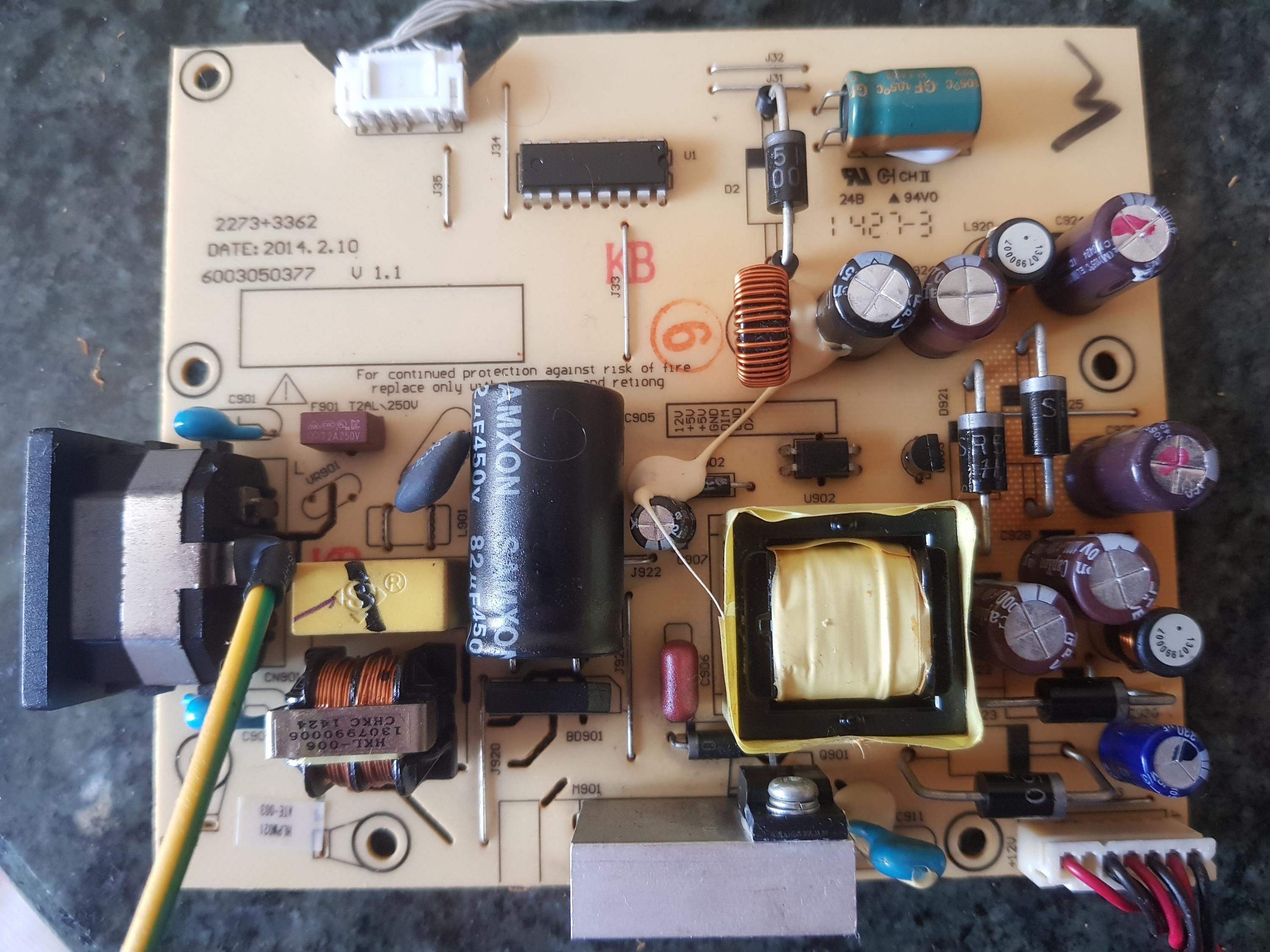

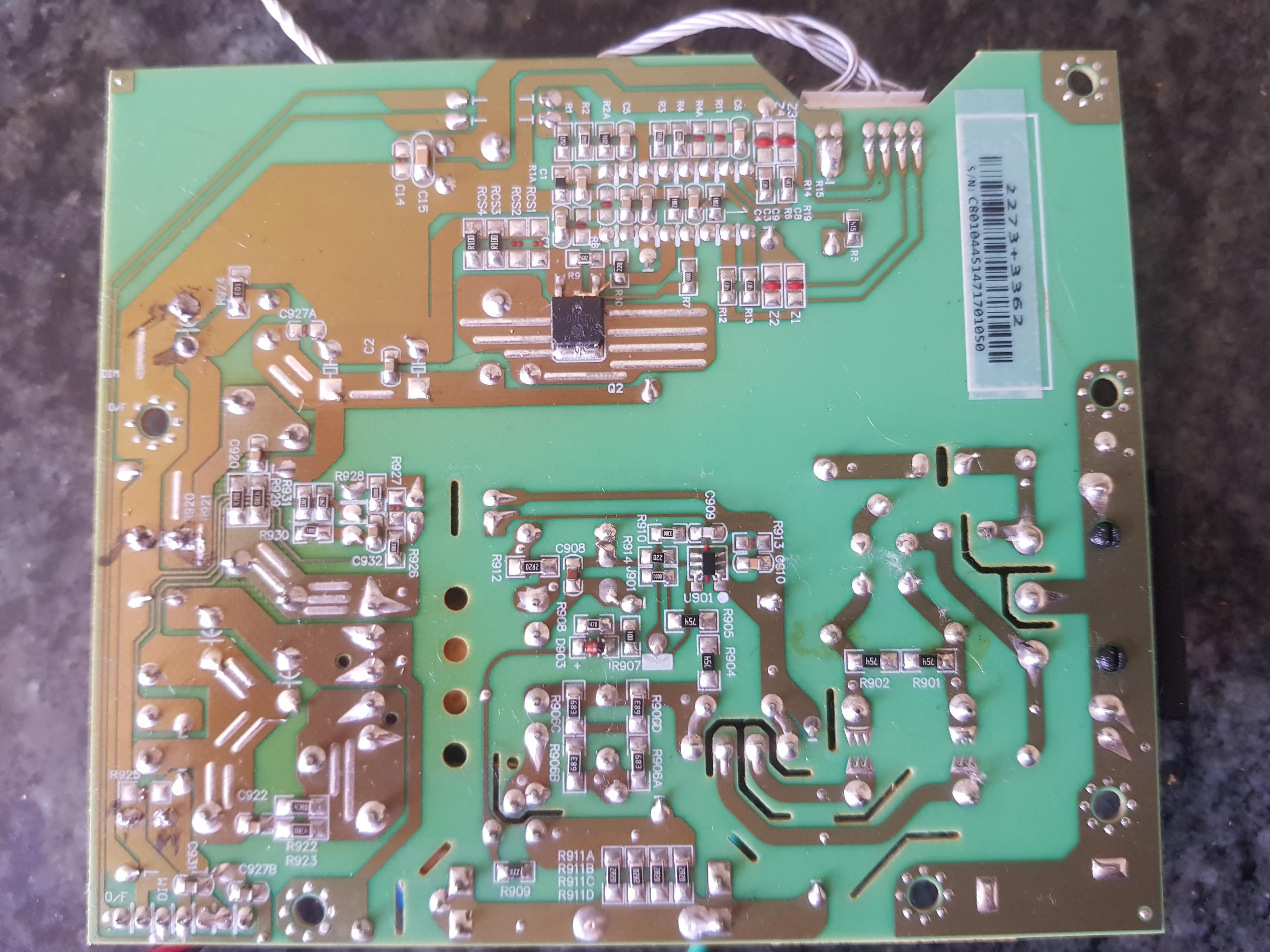

Power Supply 2273+3362 PSU in STBY
  • rigeback
    • Mar 2011
    • 421
    • Malta
    Power Supply 2273+3362 PSU in STBY
    Got a PSU that I can't seem to find a manual for "Power Supply 2273+3362".
    5V and 12V is present and I PS/On bridged turned on the backlights although the led were flickering and could be culprit as the monitor has been idle for some time.
    D2 Diode has 12V on both sides which seems a bit strange?
    Last edited by SMDFlea; 06-09-2021, 06:07 AM.
    • 21029
    Re: PSU in STBY
    C910 and R901 solder joints look a little suspect. If you have an ESR meter check all the electrolytics
    • re-atari
      • Oct 2010
      • 136
      Re: Power Supply 2273+3362 PSU in STBY
      As do both solder joints on R930.
      • rigeback
        • Mar 2011
        • 421
        • Malta
        Re: PSU in STBY
        Originally posted by SMDFlea
        C910 and R901 solder joints look a little suspect. If you have an ESR meter check all the electrolytics
        I don't have an ESR meter but I already changed out 3 caps that were swollen, I think the problem is in the low voltage switching or the led
        • R_J
          • Jun 2012
          • 9551
          Re: Power Supply 2273+3362 PSU in STBY
          If D2 voltage is 12v on both sides it because the led boost circuit is not working, likely cause is an open led in the backlight circuit. If the backlight is open, the circuit will go into over voltage protection and shut down.
          • rigeback
            • Mar 2011
            • 421
            • Malta
            Re: Power Supply 2273+3362 PSU in STBY
            Originally posted by R_J
            If D2 voltage is 12v on both sides it because the led boost circuit is not working, likely cause is an open led in the backlight circuit. If the backlight is open, the circuit will go into over voltage protection and shut down.
            Correct, bridging PS/ON indicates a power loss when the led strip is connected and will put the rest of the system in protection.
            I've removed the led strip and will consider ordering it.
            Thanks you all for the input.
