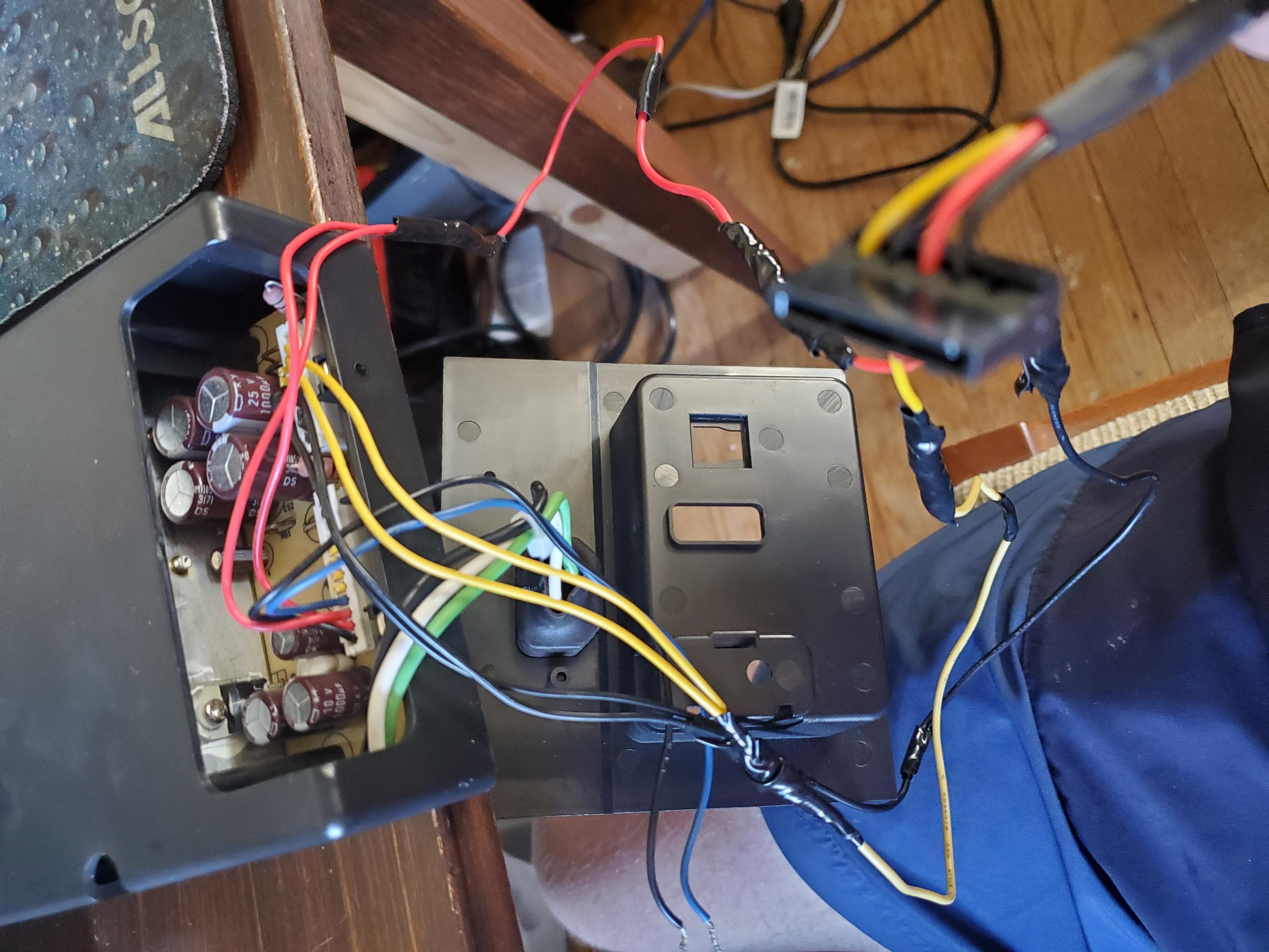

    Hey everyone, been a while. Anyway I took this PSU out of a used RAID enclosure and wish to use it to power some hard drives independent of that system. When I plug it in to power, the 5V rail works perfectly (so if I connect a laptop drive it spins up) but the 12V rail doesn't work (so a desktop drive doesn't spin up). I sort of guessed that the blue wire is some sort of control, but grounding it makes no difference. At least before I took it apart, I know the PSU did work, as when I inserted a desktop hard drive enclosure into the RAID enclosure it did spin up. Now that I've chopped all the wiring I can't exactly test it again, but I'm making the assumption I didn't short anything to destroy the 12V rail. Any help appreciated!
    TLDR: As soon as I plug it in to power the 5V rail puts out 5V but no matter whether blue wire is grounded or not the 12V rail never works.

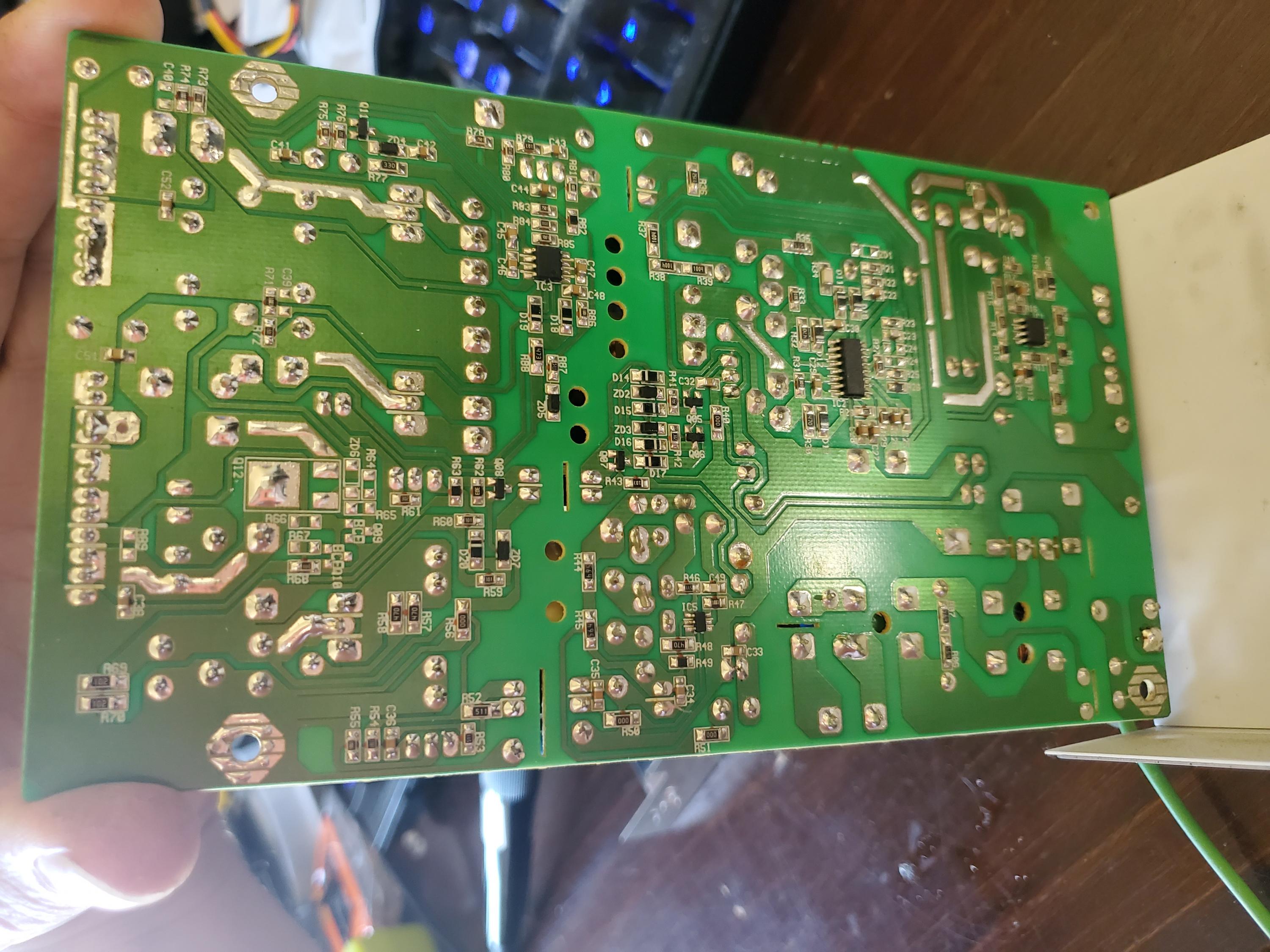

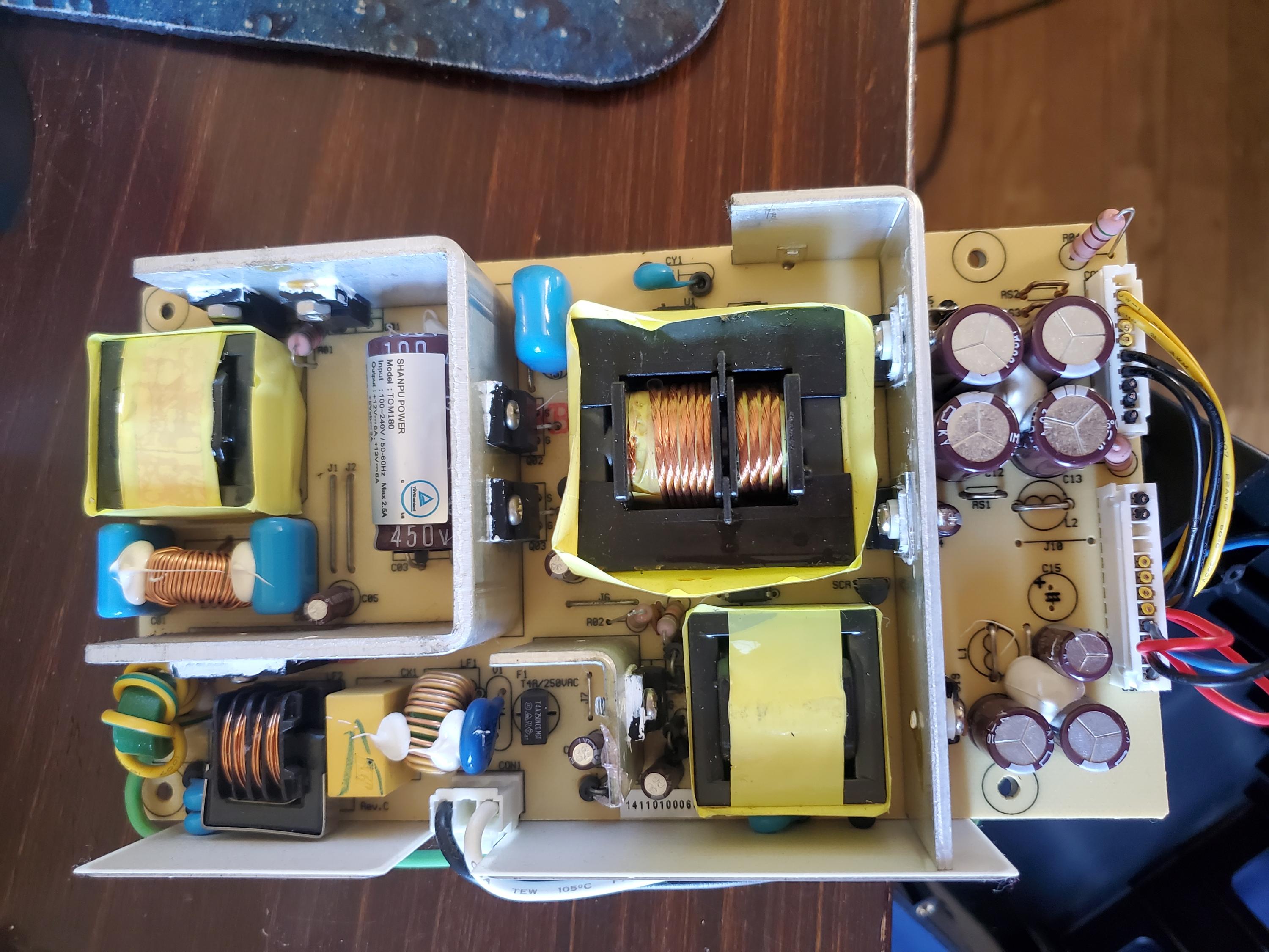

    Hmmm, it looks like it has active PFC and two separate inverters, one for each output. If they are two inverters, they are also flyback type, based on the lack of output inductors. And if two inverters, one evidently works, while the other, possibly the one with the larger transformer, is not. If one works that suggests the active PFC does also. If there are two inverters, one working, the other might be as "simple" as a shorted output cap or rectifier.
    I hope at least some of this thinking out loud is helpful.

      I appreciate your reply, I mean it's helpful in that I understand more about the power supply. However, I figured out the problem. If I put the blue wire to 5V the 12V rail starts up so that seems to be the key. All is well now.
        Yup, that looks correct to me. Seems the 12V rail (or actually what looks like two 12V rails) come out of the bigger transformer, and the 5V/5VSB (possibly combined into one) comes out of the smaller transformer... which is rather strange why they have it like this. I guess that means the HDDs are always fed 5V?
        Ah whatever, it works, so I guess we can let it be.
