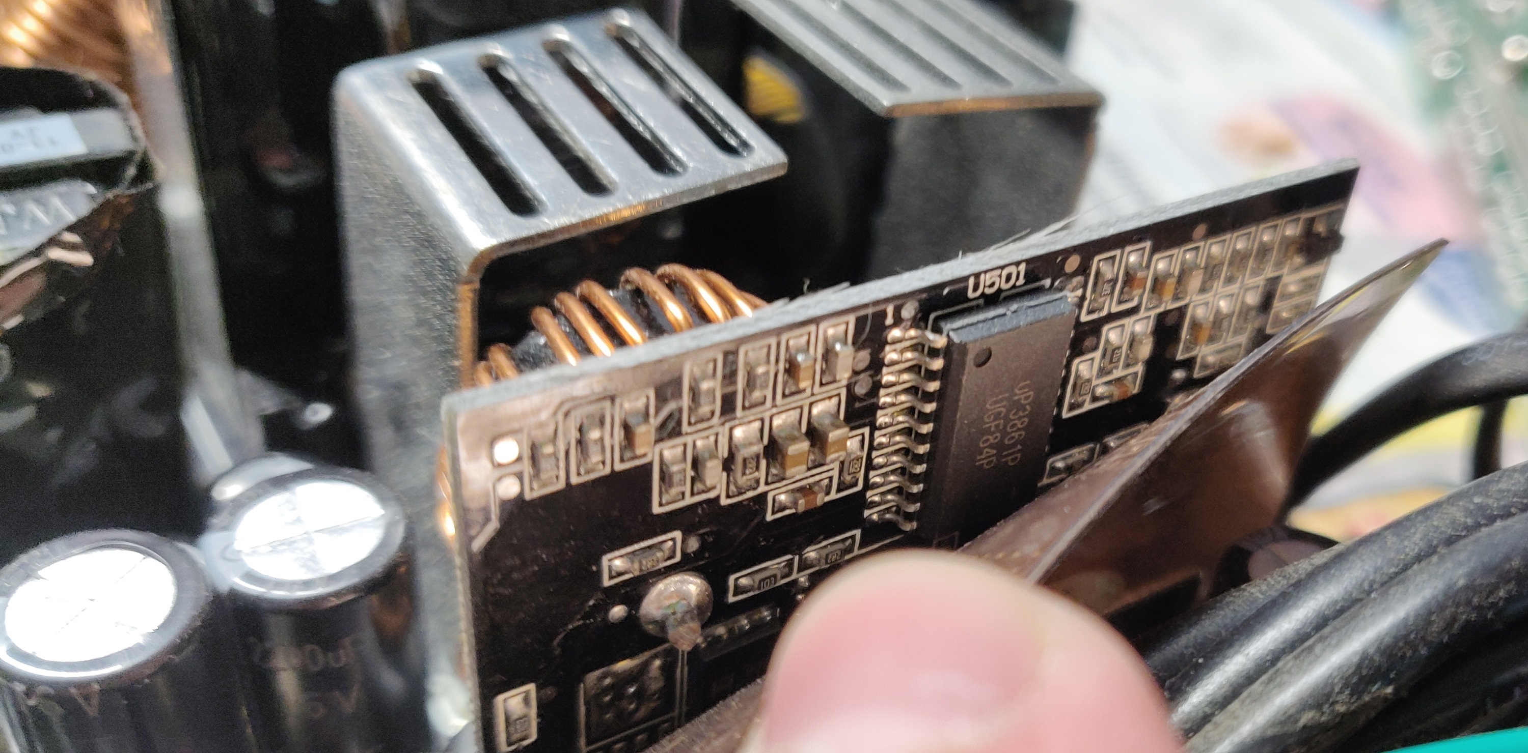

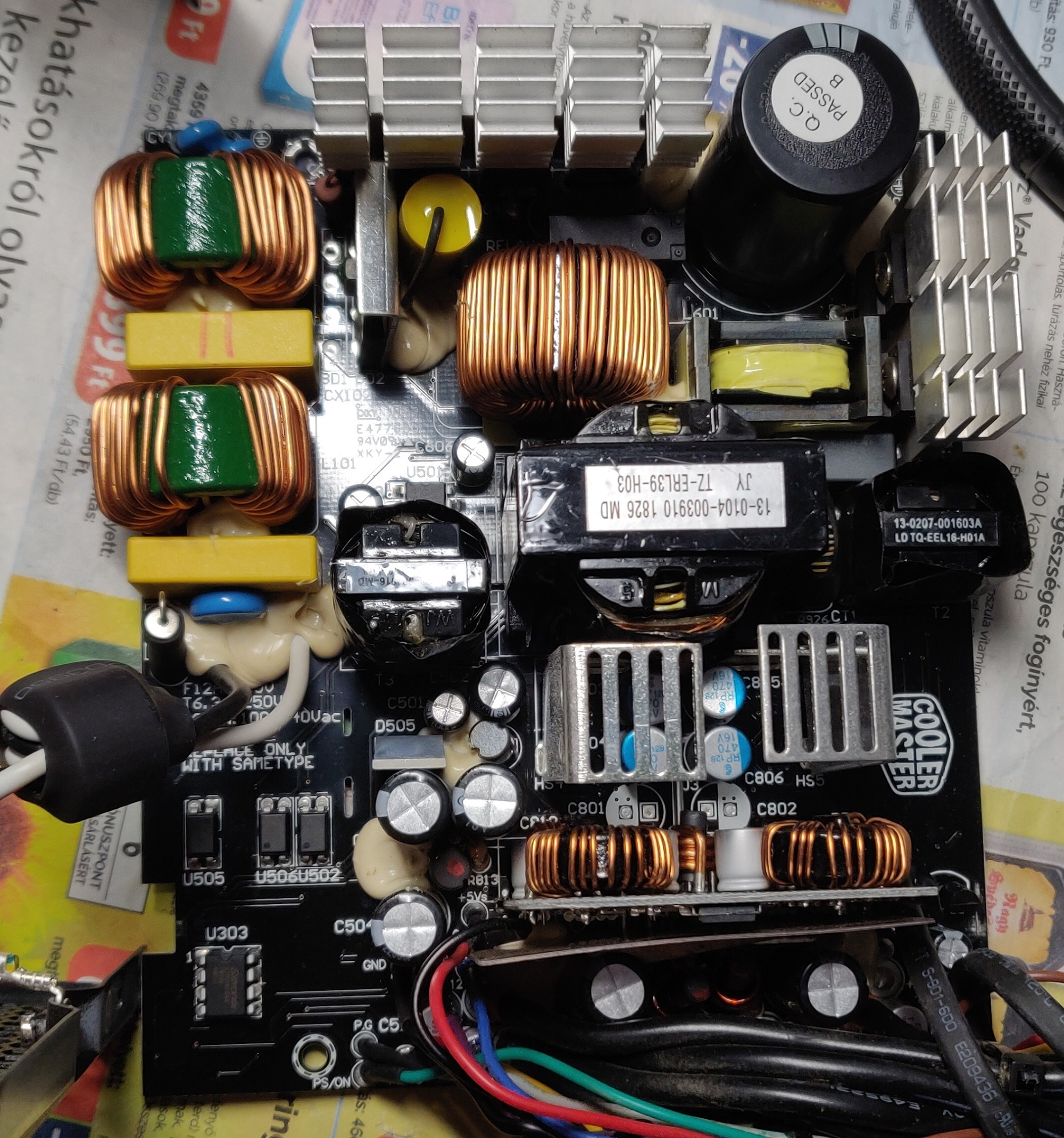

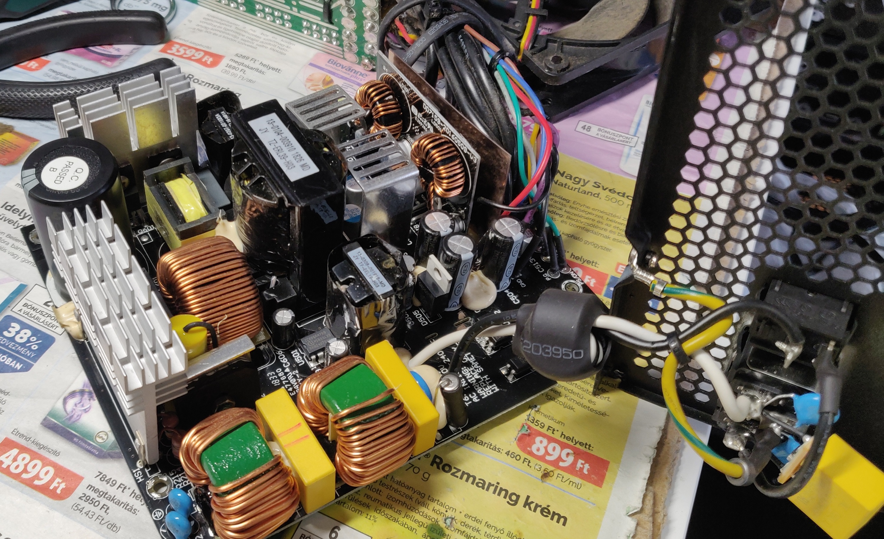

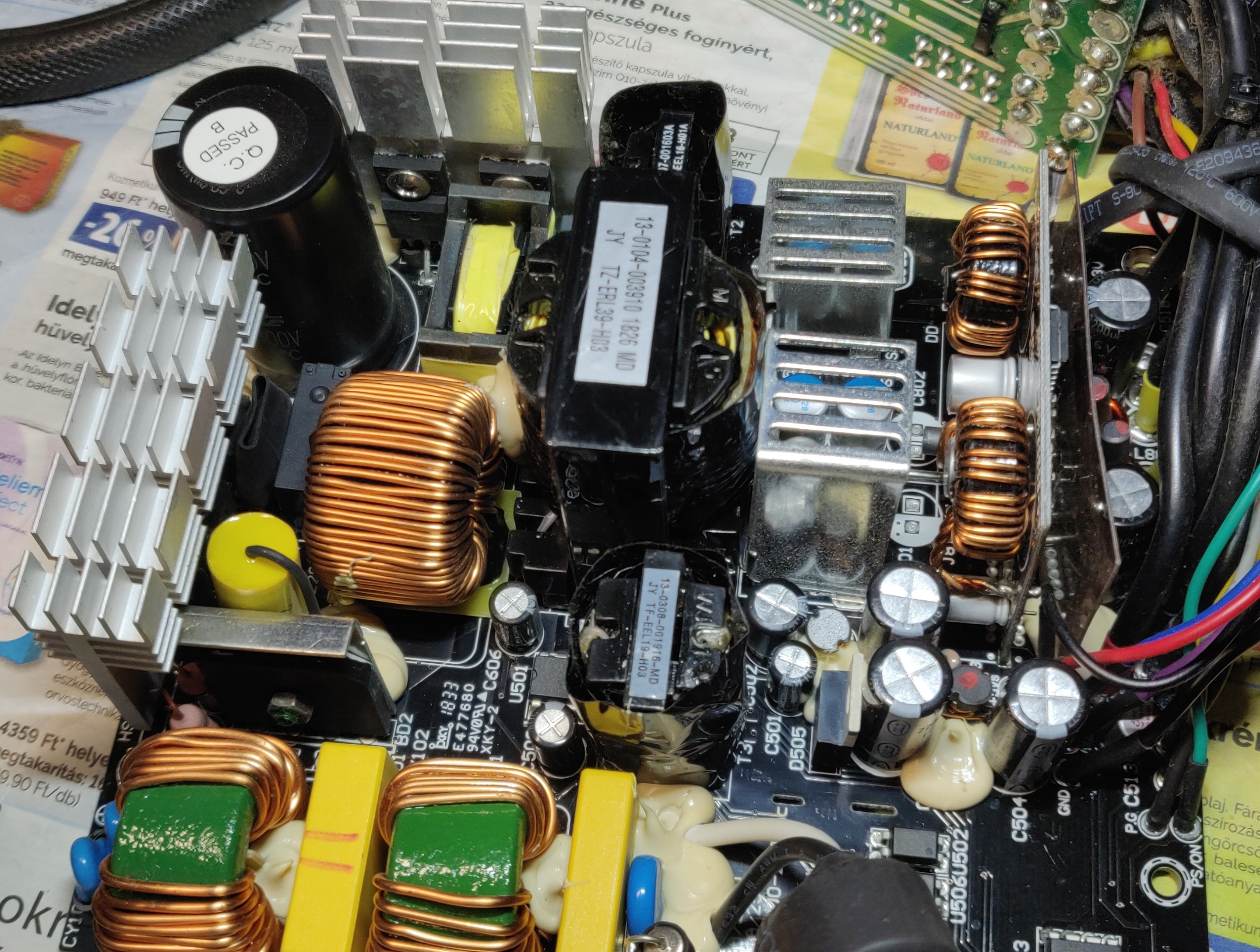

    Hello guys,
    I have a problem with this PSU and need your help and knowledge. The unit will not turn on most of the time, but sometimes it does, and then it works fine. +5Vsb is always present, but grounding PS_ON nothing happens. Cycling the power switch (sometimes I can hear a spark pop from the switch) and it will start up after 3-10 cycles randomly, and then all voltages are fine. Remove PS_ON jumper and it won't turn on again until some power cycles. Sometimes it would just turn on for a sec, and then turn off immediately (relay clicks). It is the same as this video shows:
    Youtube link
    Opened up the unit and I can't see any obvious problems: no bulged caps, no burn or heatmarks, no visible cold joints, nothing. When it turns on nothing seems to be overheating, no smell or smoke. Only the biggest transformer is getting a bit warm, but not hot.
    I am quite surprised I can't find any information on this problem, because looking at the market reviews, this whole MWE series has many issues (this one and coil whine) with almost all models. Maybe some of you have encountered this problem, or know what might cause it?
    Thanks,
    David

      I've tried to replace them (1pc 47uf and 3pcs 100uf electrolytics) but with no luck :/
      However I have observed an interesting "habit": When plugged in for the first time after a considerable amount of time (5-10 minutes at least) spent unplugged, it would work perfectly almost every time (turn on and off as supposed to, as many times as I try). But once I unplug it again, the same erratic behaviour again (no turn on at all, or turns on once but no more). Also, I observed that 2 or 3 times when i unplugged (or switched off at the back of unit) it turned on for a moment!
      Maybe for someone who is expert in PSUs this is an obvious fault, but for me it just makes less sense...

            Hmm, so I guess it is not something we can fix easily...

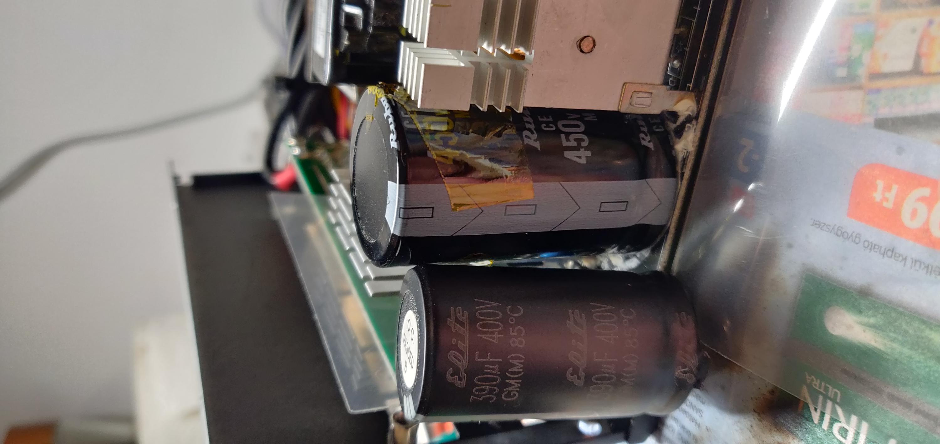

            Main cap is 390uF 400V Elite GM series (85C 2000hrs general purpose). When turned on, voltage is around 340V on it.
            All other caps are Elite brand too, mostly EY series (105C 4-10000hrs "Low impedance, High ripple current"). From what I have read on forums, Elite is not very high quality, but not total garbage either. I have measured a few of them (with my cheap chinese LCR meter) and all of them seemed quite good, nothing suspicious.

              i bet that 400v cap is trashed.
              i say that simply because 85' temp rating means it's not a low-esr type.
              so the pfc circuit will beat the hell out of it!
              a dirty test for marginal caps - heat it up with a hair dryer and see if the unit works when it's hot.

                Okay it is just getting more confusing. I did what you suggested: heated up the main cap to about 70C (guesstimate, I could touch it but it was hot). After that, the PSU works just fine. No matter how many times I switch it off or on at the back, it just works as it should.
                I say, okay let it cool down and check again to see if it really is the cap. But no. Since that, the unit works just fine. It's the next day, I have switched it on-off about a hundred times and not once it produced the fault.
                  • 31015
                  Re: Cooler Master MWE Gold 650W (MPY-6501-AFAAG) randomly won't turn on
                  the heat spread the liquid that had not dried or crystalized so the cap was more "even"
                  it still has to go.

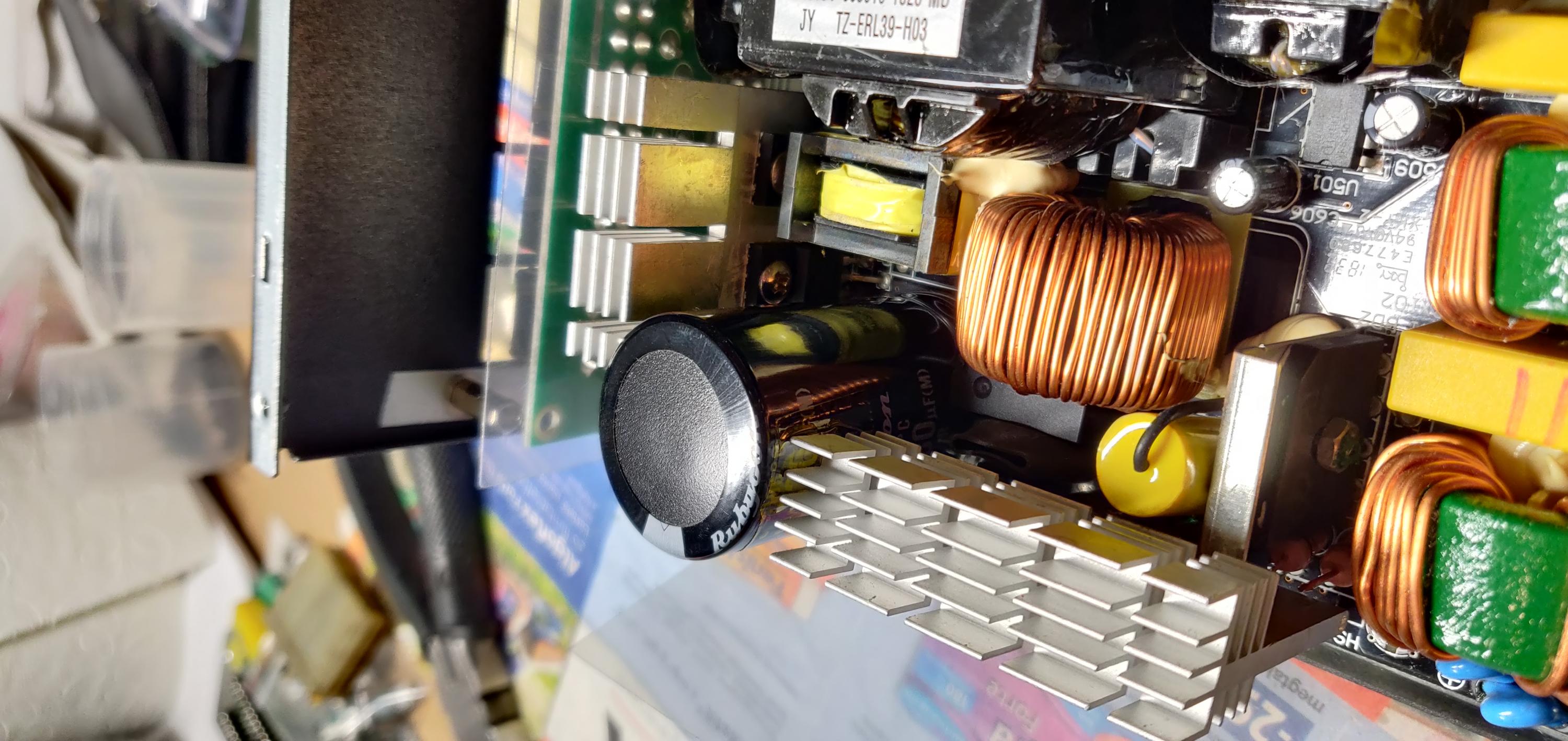

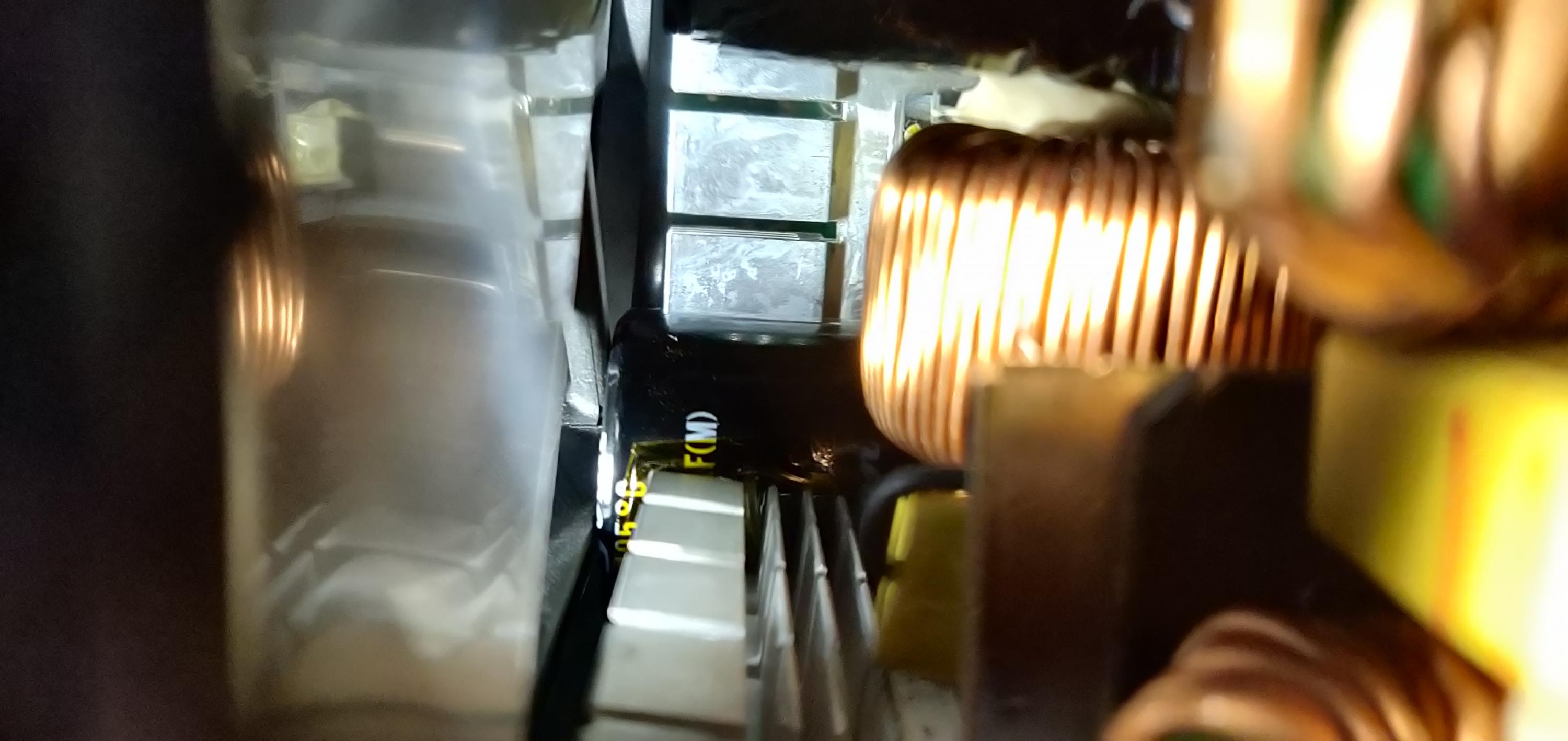

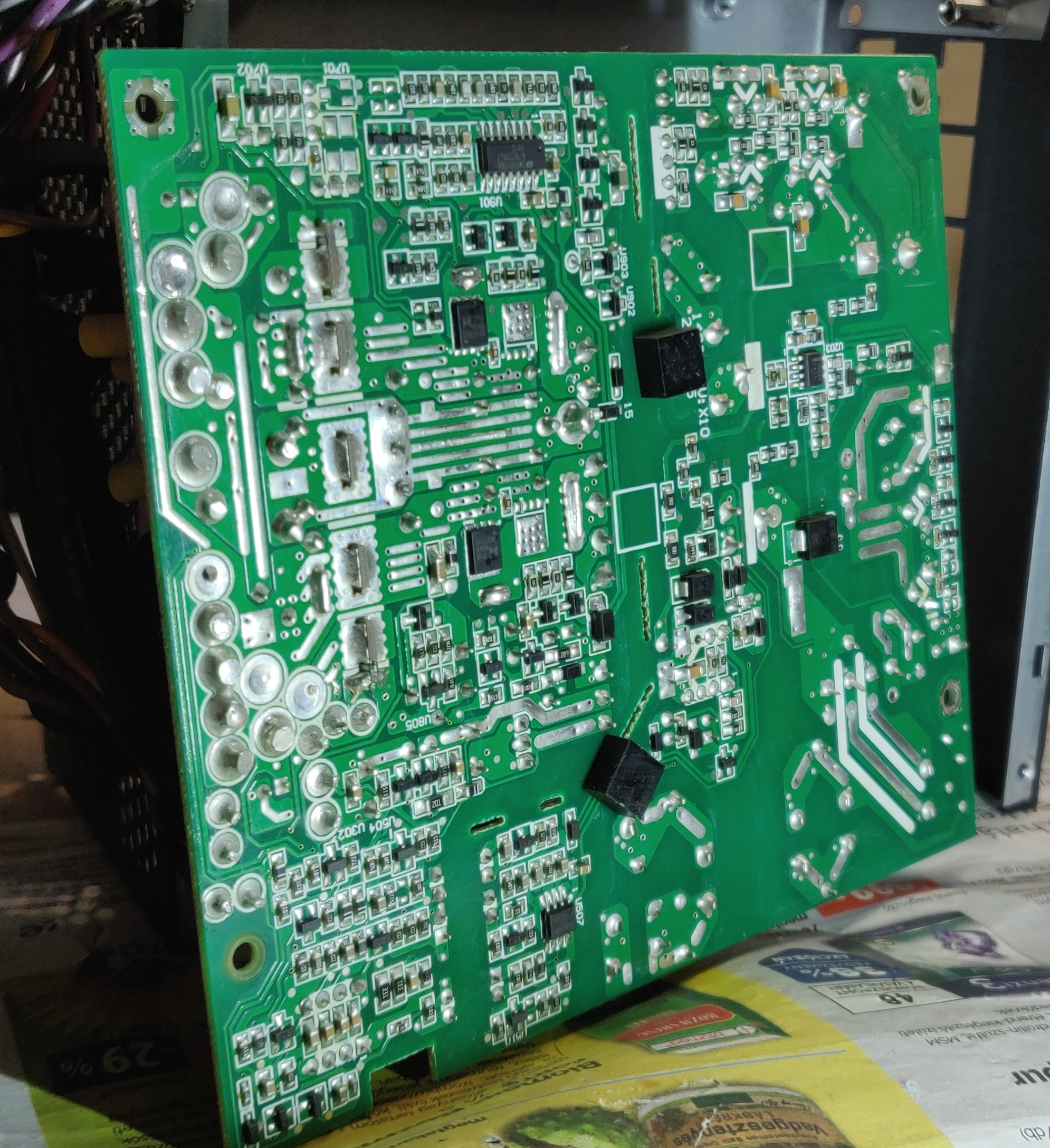

                            It took some time, but I have finally replaced the main cap. I could not find 420V high quality ones anywhere near me, so I went with a 450V 330uF Rubycon (105C of course). The size is 30x50 which fits just perfectly in every dimension, it seems the PSU was designed for this size but they cheaped out on it later...
                            So after replacing it, the PSU seems to work fine, it fired right up and seems stable under load (90W CPU + 180W GPU both under stress test). I have to knock on wood, but if only this was the issue, then I am quite relieved
                            Interestingly, I measured the old cap after taking it out and it seems to be almost perfectly okay: ~350uF and 0.5ohm ESR (chinese LCR meter)...
                            But never mind, I hope it will continue to work for a few years with this Rubycon. Thank you all for the hep guys!

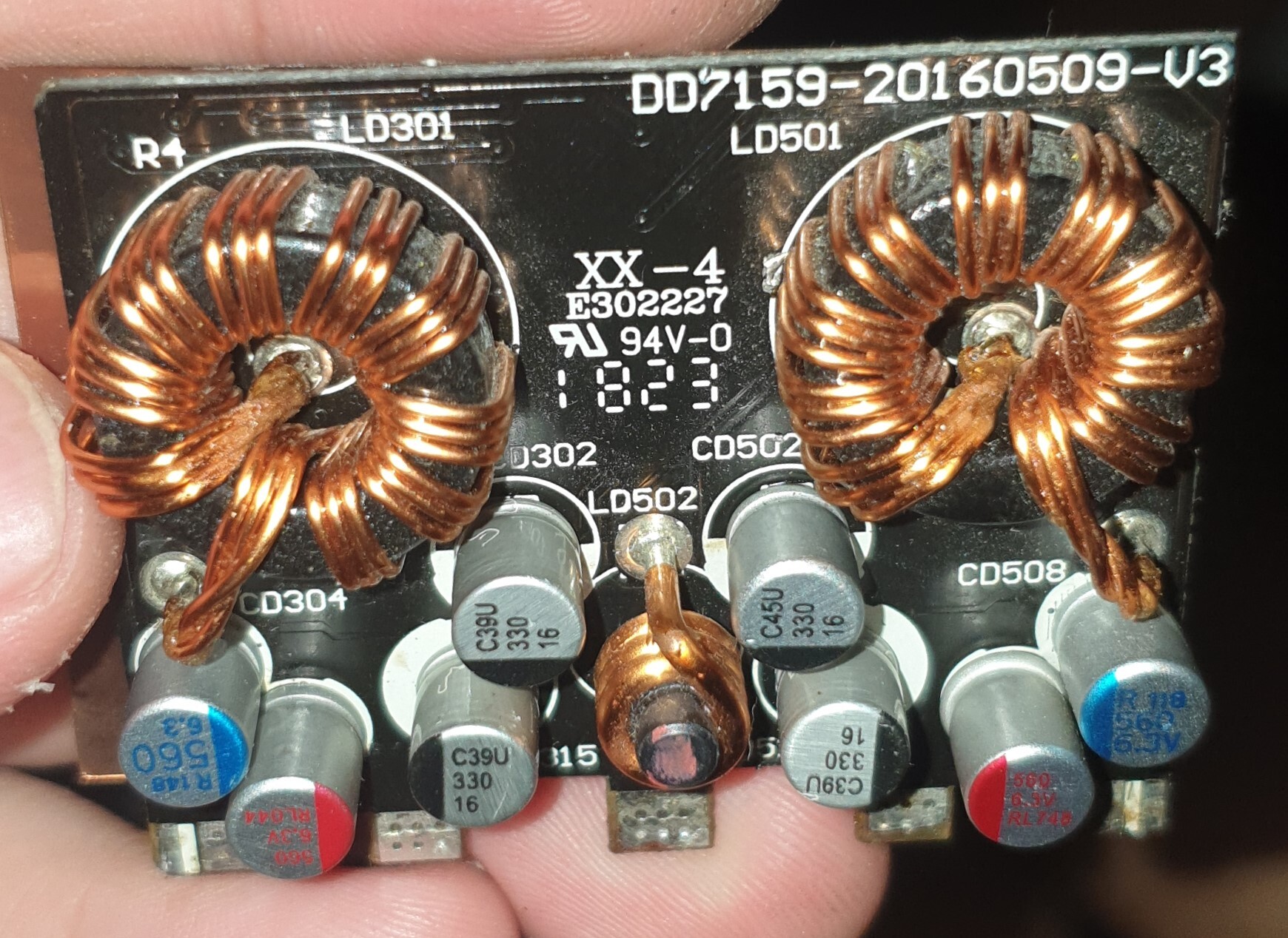

                                      An actual fix story:
                                      Hello everyone, I have a MWE 750 Gold mpy-7501-acaag that uses the exact same PCB as this 650w model, I was having issues where as soon as I press the power button it would turn off when the 24 pin was connected to certain motherboards, I narrowed it down to a problem with the 5v rail by depinning every rail from the 24 pin and adding one rail at a time until the problem came back. Initially I tried replacing the main cap but that did not help.
                                      what fixed it was replacing 2 input filter caps and adding 2 more input filter caps and 2 output filter caps to the 3.3v and 5v dc-dc module, I'm sure I could've gotten away with just replacing the 2 12v input filter caps but I figured I might as well improve it while I've got the pain in the ass to desolder module out
                                      Click image for larger version  Name:	a.jpg Views:	0 Size:	556.5 KB ID:	3487539
                                      Only weird thing is it pulls 11-10watts when I short PS_ON# with nothing connected, I feel like that's a bit high even for no load but it seems to be ok
                                      Anyways here's an imgur link with random pictures I took in case anyone needs them:
                                      https://imgur.com/a/oxkbhci
