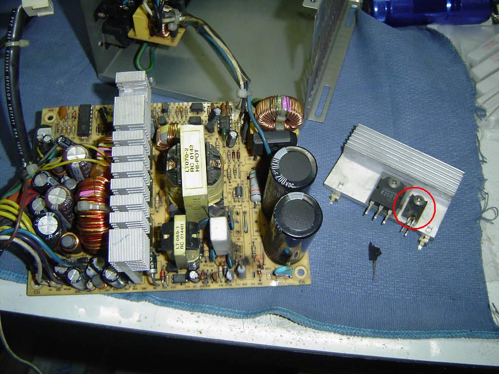

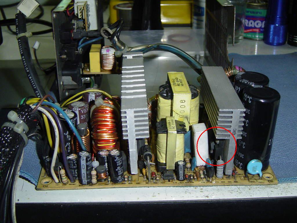

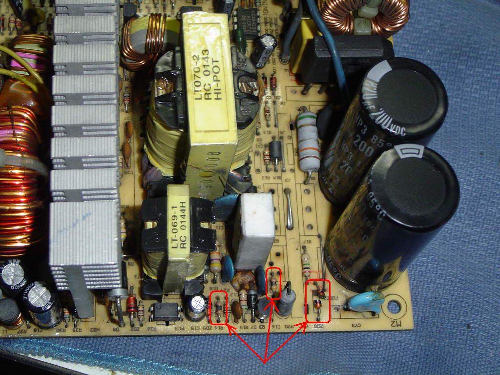

    I've got an Enermax EG365P-VE that had damaged in 5VSB circuit.
    1. 5VSB switcher mosfet was broken, can not read part number clearly.
    preced by K3, missing 2 number and last one is 7 (K3??7)
    2. two resistors was burned and a diode was broken, red circled them.
    Please help me identify there part.
    Thankyou in advance.

    You can start searching HERE . At most, 100 part numbers to check out (missing numbers from 00 to 99).
    Good luck!

      HA HA! don't need to play lotto.
      I found the small missing piece of the mosfet drop on the floor, It is K3067.
      and from this thread by I4004 => https://www.badcaps.net/forum/showth...hlight=enermax
      5VSB pictures store on picasaweb => http://picasaweb.google.hr/i4004b3/E...55vStbySection
      R16 is 620ohm, another one is 39ohm
      Thanks to i4004
      from many schematic around here, the diode might be Zener diode 18V.
