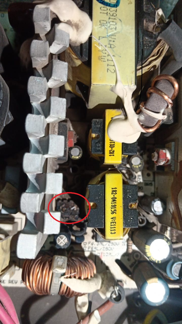

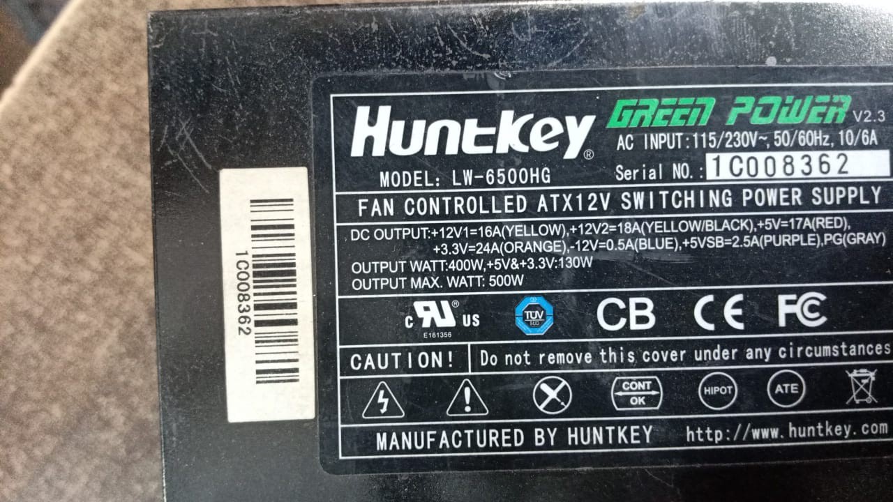

Pcb: Lw6550se rev p
can someone identify the burned ic

If it's similar to
this PSU
, then that IC should be the 5V standby generator... So perhaps it's a "DM0265r" (or also look up under "FSDM0265RNB").
