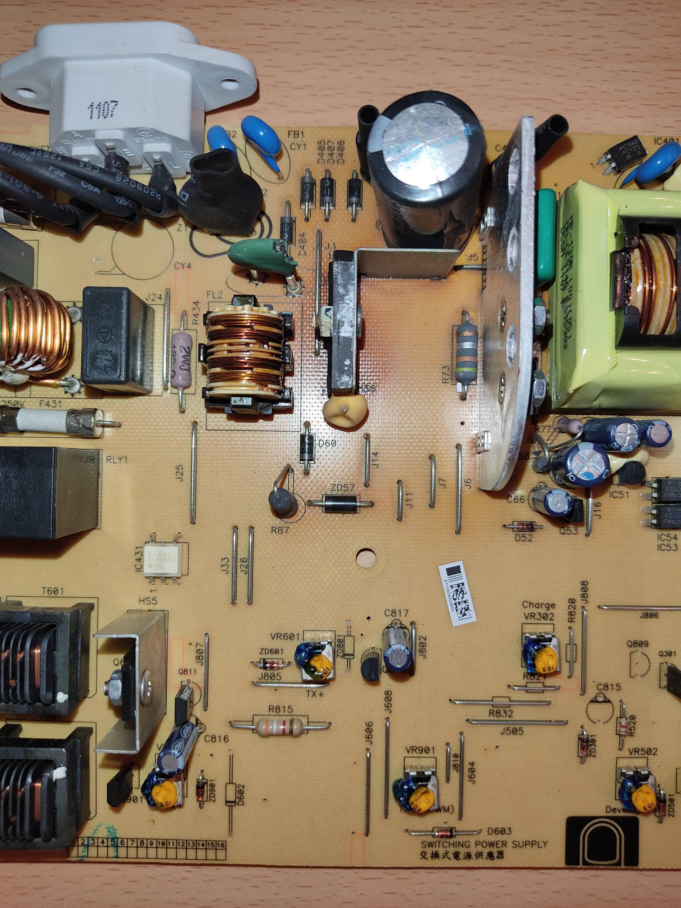

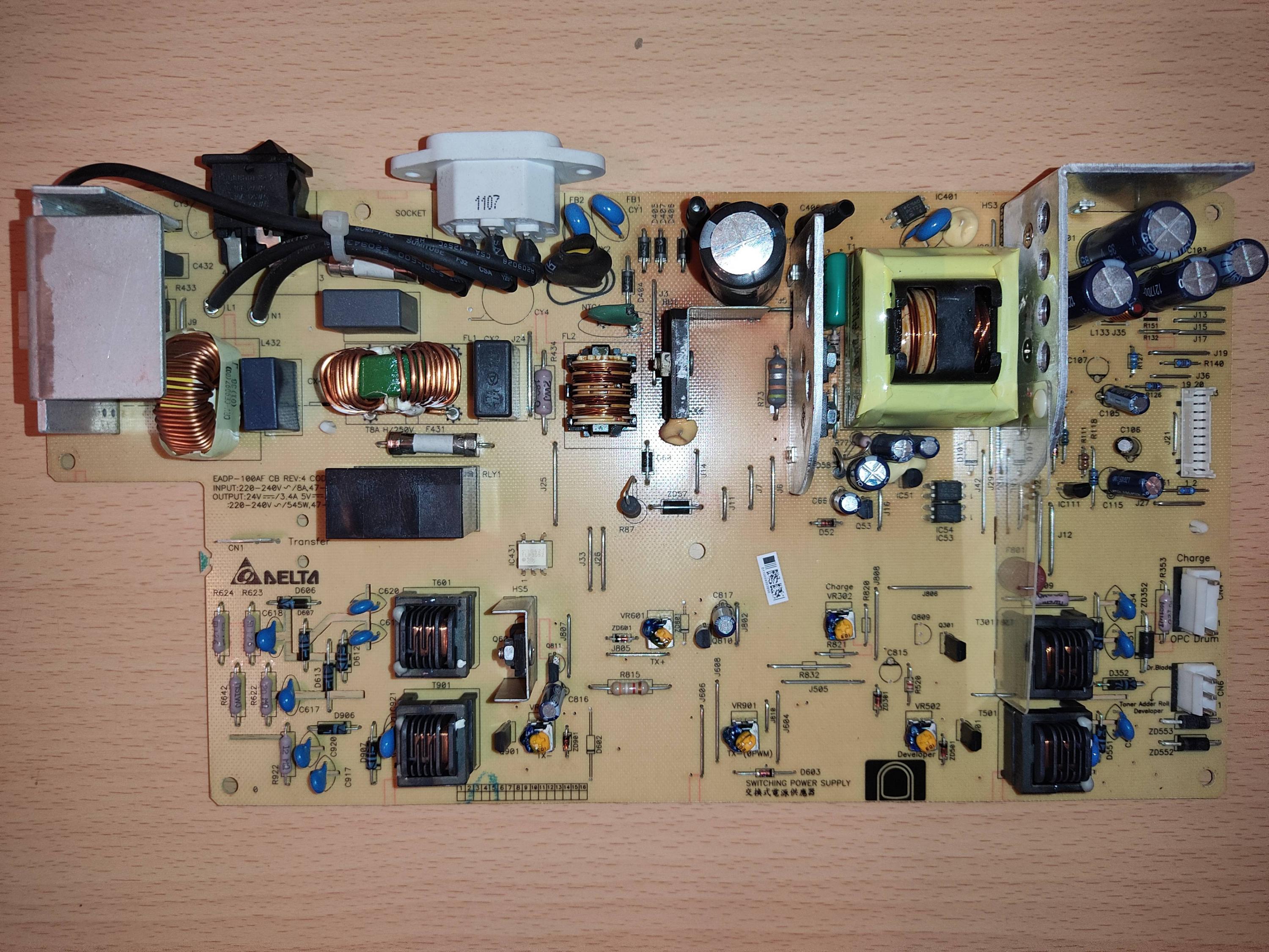

    Hello I need some help for a Lexmark x264dn Laser Printer. I Plugged it in the mains and immediately the fuse flew at once.

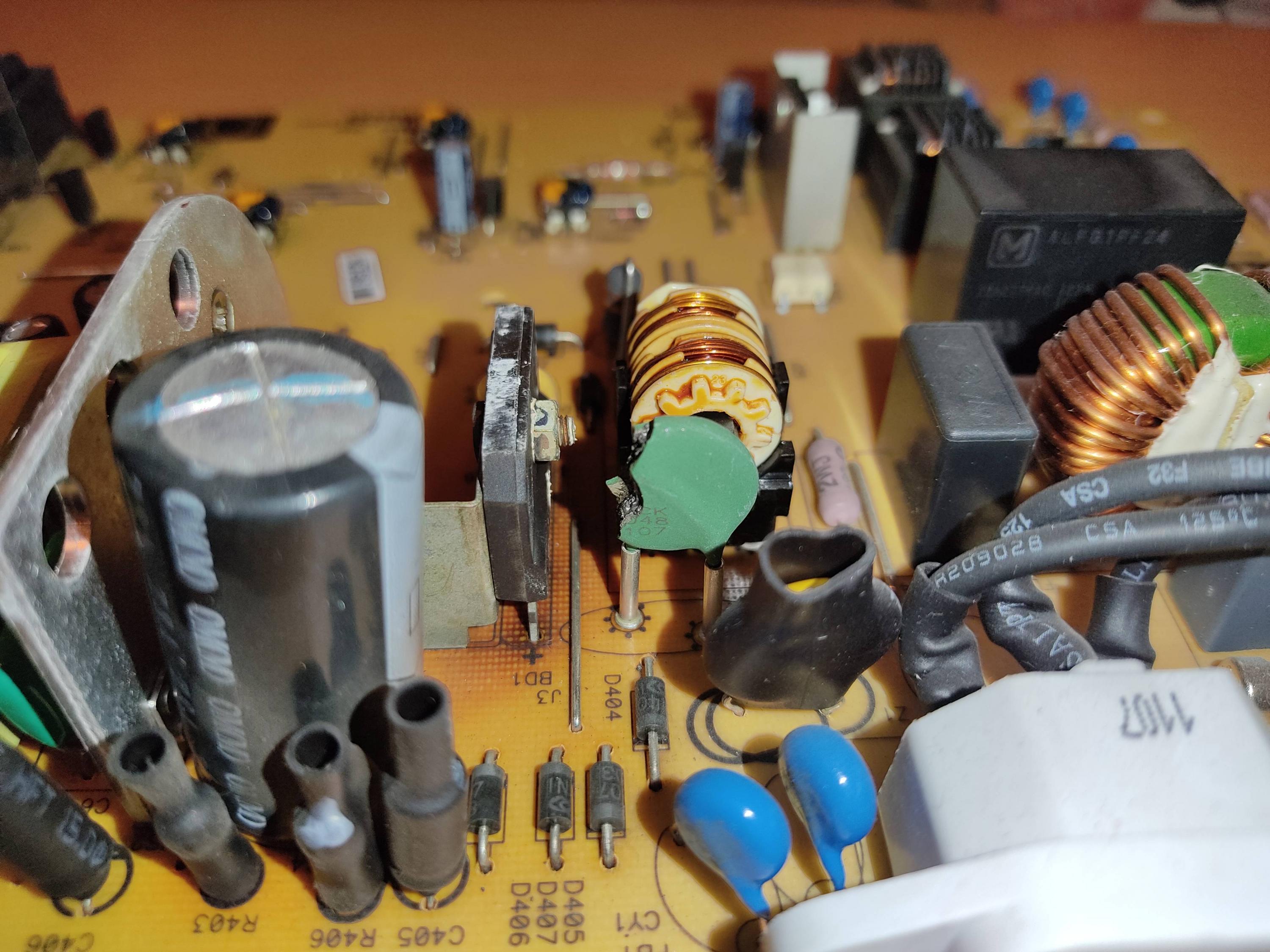

    Then I took it apart, i discovered two swollen caps and some burning marks below the bridge rectifier on both sides.
    There is also a blown/broken part. It seems to be a tantalum capacitor?
    Does someone have have a service manual for this board, or some similar boards. What should I replace besides the swollen caps and broken one. The fuses are intact and I don't see other broken parts.
    What is needed to be replaced besides the two caps and the blown part?
    What caused the defect of this power supply? Was it the capacitors or what do you suspect?
    Thanks for your help.
    *Attachments are missing- just a second...
    ** Attachments added - sorry.

    well hopefully the rectifier shorted and killed the cap, or the cap was leaky internally and overloaded the rectifier.
    the green thing is an NTC thermister, it limits the current - or it tries till it gets F'd
    what's printed on the ntc?

      The NTC1 could be a SCK084. Along with the main filter cap I would replace all 4 small caps in the primary (ie: C66) and the ones around it along with the small swollen one.

        Concur with stj. Either a leg of the bridge rectifier shorted, killing the cap and blowing the thermistor and fuse, or the cap started going bad, drew excessive current, overheating the bridge rectifier, and blowing the thermistor and fuse.
        While you are checking the bridge rectifier and replacing bad parts, check to see if the MOSFET mounted on the heatsink is shorted.
        More generally, the power supply appears to be a flyback (or as Delta engineers called it, "ring choke") design in which the "transformer" is a coupled inductor. The "transformer" primary is the filter inductor, hence no filter inductor on the output side. This topology is pretty stressful on output capacitors.
