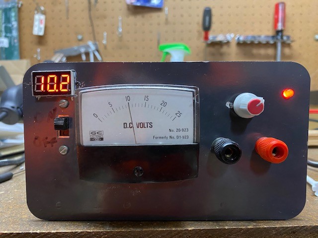

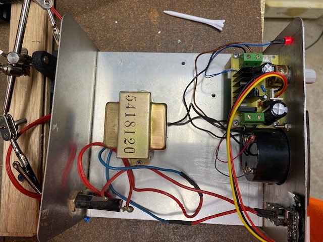

                  Well the parts arrived from China and are now installed into the modified unit.
                  Attached are the photos - First is from the Top View displaying the incredible complexity of the modification. It was rather straight forward and I followed the advice given on how to keep the analog needle meter. I did pull the LED off the board and ran a jumper wire to the front panel.
                  The second photo shows the front view. It was just a matter of using a drill, Dremmel tool and file to make the modifications to the panel.
                  I agree the unit was some sort of kit/home brew as the PCB board has professional markings. Regardless I have an operational unit now and the cost was under $15.00 with shipping, including a spare module.
                  Thanks to all.
