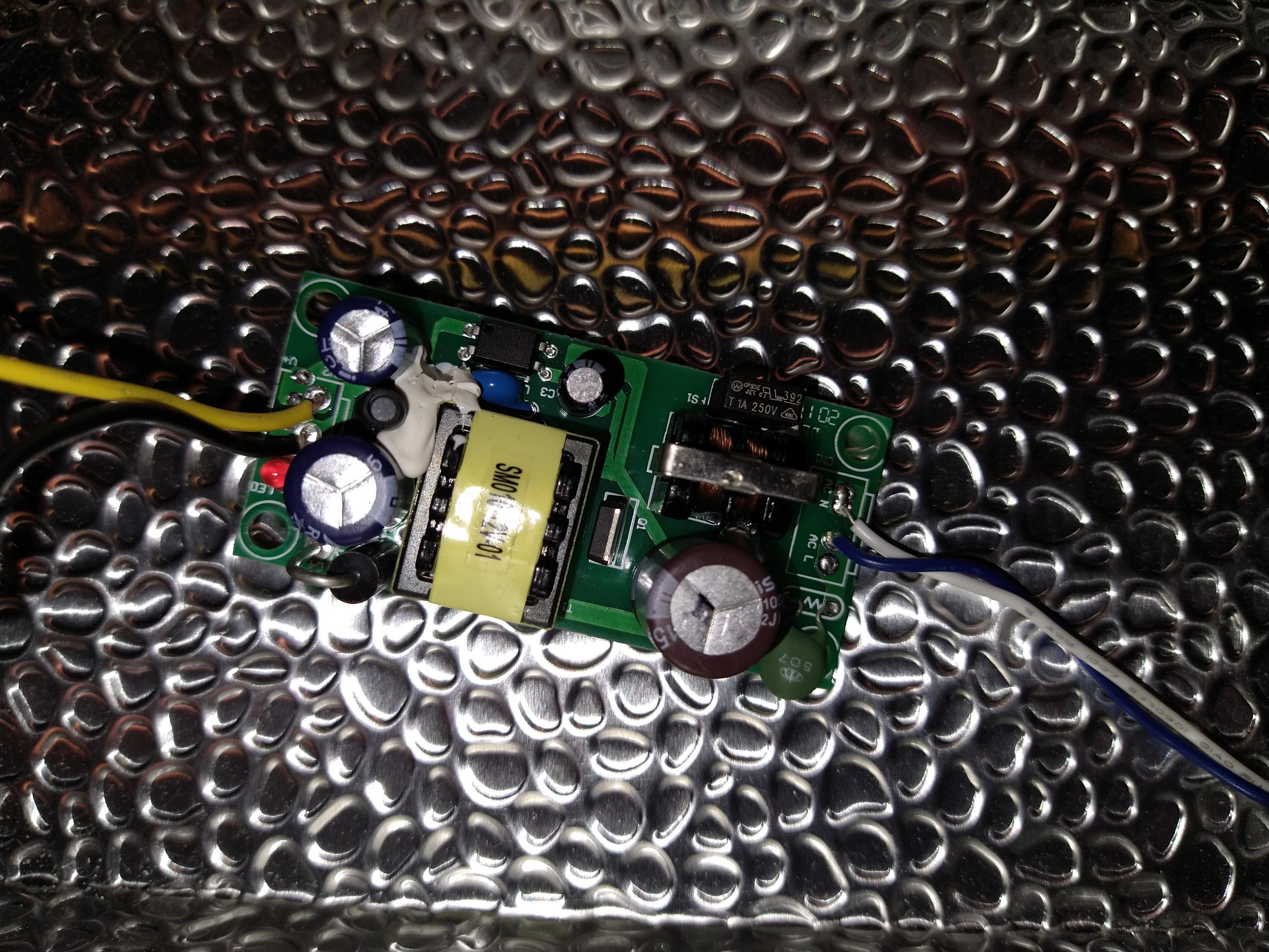

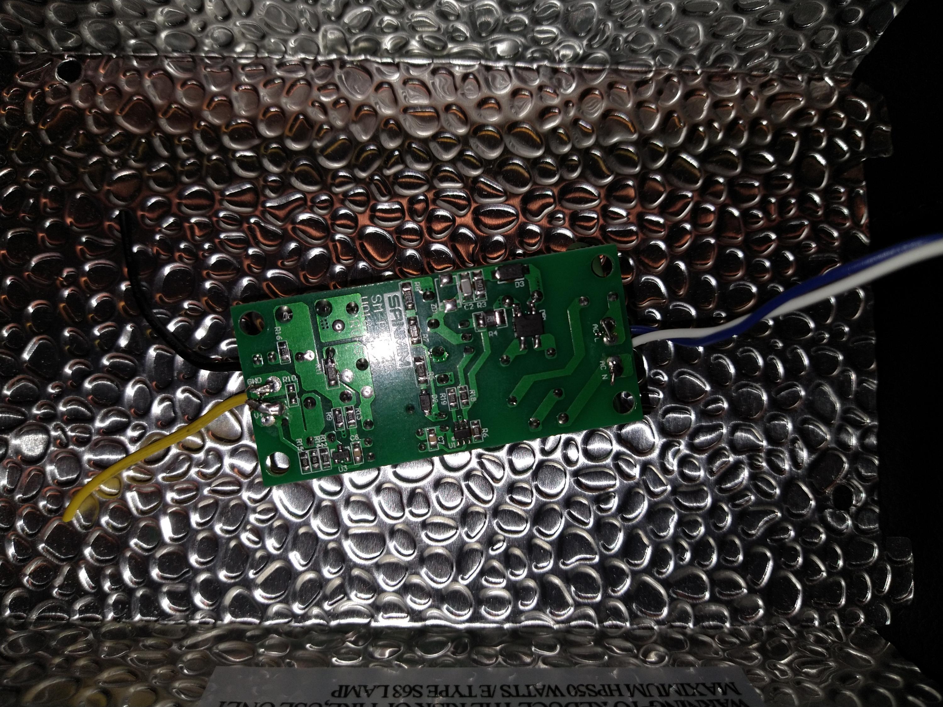

    Hello Again, I'm back with a small power supply that failed after a whopping 1500 hours of service (impressive, eh?). Now this repair isn't urgent as i do have a few extra units on hand, so i'm mostly doing this to work on my skills. Anyway, i've done a bit of probing around on the PCB, testing components, and have found nothing that seems to be out of the ordinary, but here are the components i've probed.
    D2 (F7)
    R5 (3.3Ω)
    R6 (100K)
    R4 (1.2Ω)
    R11 (2K)
    R18 (10K)
    R19 (22Ω)
    FS1
    RT1
    C1 (Aishi HS 15uf 400V)
    C3 (Aishi WH 22uf 35V)
    I've also probed the bootstrap winding of the transformer and compared that to a working unit, and they both matched. So i'm inclined to believe that there's something wrong with the driver IC. The part number on the IC appears to be 63L20, but after a lot of searching, i could not find anything about the IC.
    So now what do i do? Did i miss anything? Any help will be appreciated.

    The ic is a On-Bright OB2263, Check that the secondary/output diode is ok and not shorted, Check the dc voltage ACROSS C3 Post the voltage. It could also be a bad optocoupler.
    Is the output voltage pulsing under load? Is it stable without load?
    You can always buy another one for $1.93 + $2.03 shipping https://www.aliexpress.com/item/3281...archweb201603_

      i dont like the look of where the output cable is soldered .

        Checked the diode, and it appears to be fine, i have not tested the C3 voltage yet as i need to replace the replacement power supply that replaced this one because get this, it just failed the exact same way as this one (it's the same brand & model as this one, just with way fewer hours (roughly 12 hours)).
        Guess what power supply brand i won't be using in the future.
        Don't worry about those, i checked them, and they are not shorted, however, i do agree that they look like crap.

                  Don't be sorry, it is not a waste of time. It could be that the supply is shutting down when the relay gets energized, Is the relay board near the power supply? if not, try adding a 1000µf/25v across the relay board 12 volt input. Due to the ic's load monitoring, it might not be the best choice for this application, but I'm sure ther is a way to make it work.

                    Anyway, i was doing some more testing on the supply and now i'm 99% certain the power supply(ies) are defective. But first, i should clear a few things up:
                    I thought something was wrong with the OCP of the PSU, turns out it might be fine, if kicking it at 1.5x the power supplies rated current is normal.
                    The relay board i was talking about actually draws closer to 300mA when all the relays are on.
                    • Extended Burst Mode Operation...
                    This could be the reason for this fault especially since it seems to start strobing if the board has been idle for a few hours with all the relays off (where the power draw is closer to 10mA), but, this is not the only relay board that uses this brand & model power supply, and as far as i know, the power supplies in those have not had the same faults.
                    Now this might be a stupid question, but should i try warming up the board while it's running? As i suspect something (the chip, or a diode) might be working fine at room temperature, but stop working when it warms up to a temperature it should still work at. I understand i might be wrong about this, so i'm asking just in case.

                                That's what i did, but before doing so, i ran a little test to see how the PSU behaved with one side of the optocoupler disconnected, and the results of that are:
                                Primary side disconnected: No output.
                                Secondary side disconnected: Pulsing output.
                                So now knowing that, i went to grab one on a scrap PSU (since i had no loose ones on hand), installed it, and so far it works, but i'll have to see how well it works in the long run.
                                By any chance did you replace the 22uf capacitor if you have I would recommend this first if you have a a capacitor rated for 50 volts I would use it instead of the 35 ones
                                I was about to do that, only to realize that i goofed on the voltage, because the cap on the board was already a 50v cap.
                                I'll update this thread if anything happens, but i really think it will work this time.
