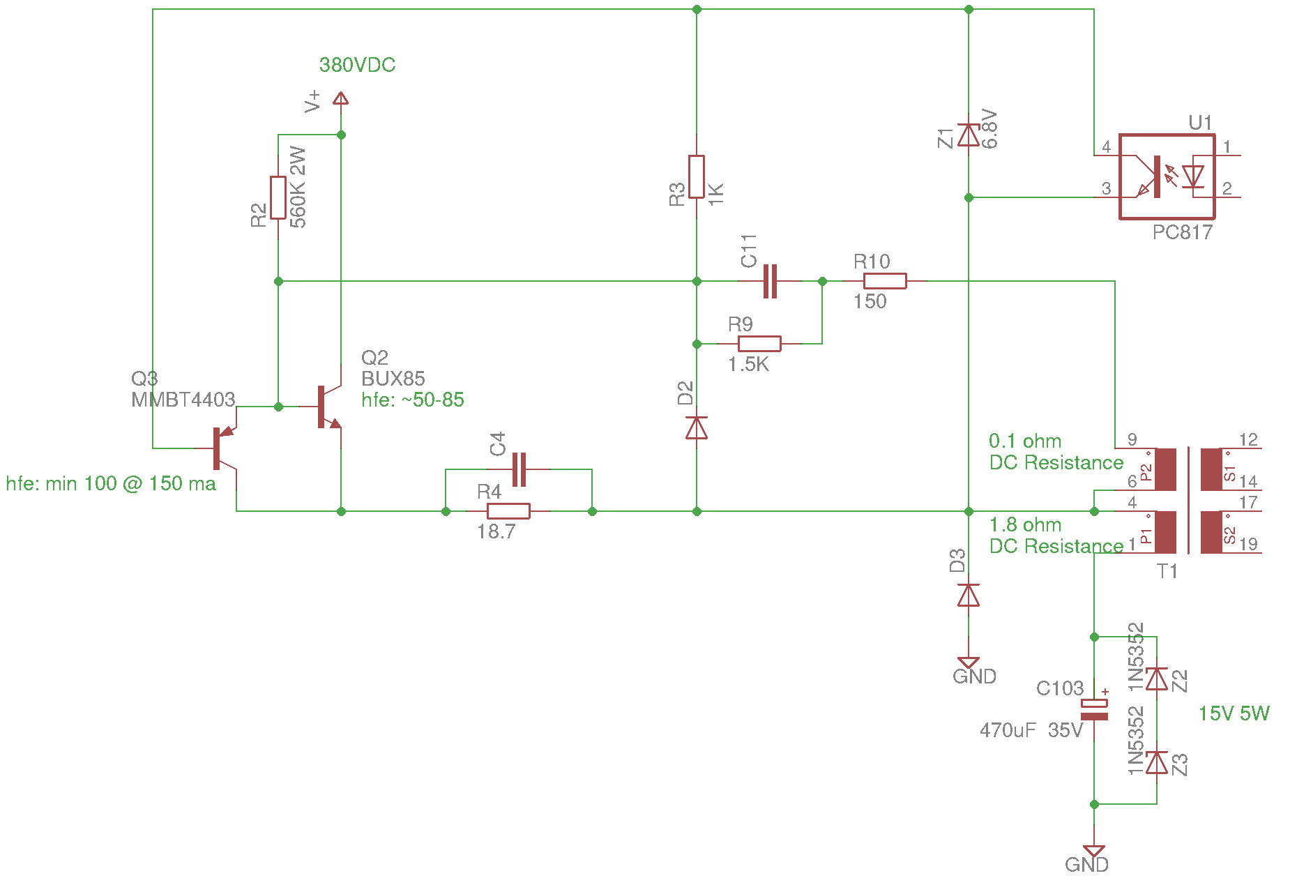

The attached snippet is from a AC Technology Corp M1230B MC Adjustable AC Drive 3 HP low voltage supply. Link voltage is good at 380VDC. The converter won't start. I'm trying to figure out what you would call this topology so I can search for some theory on how it works. I'm guessing that it's some kind of resonant converter but I haven't been able to find anything like it. Seems like there are not enough parts on the primary side...

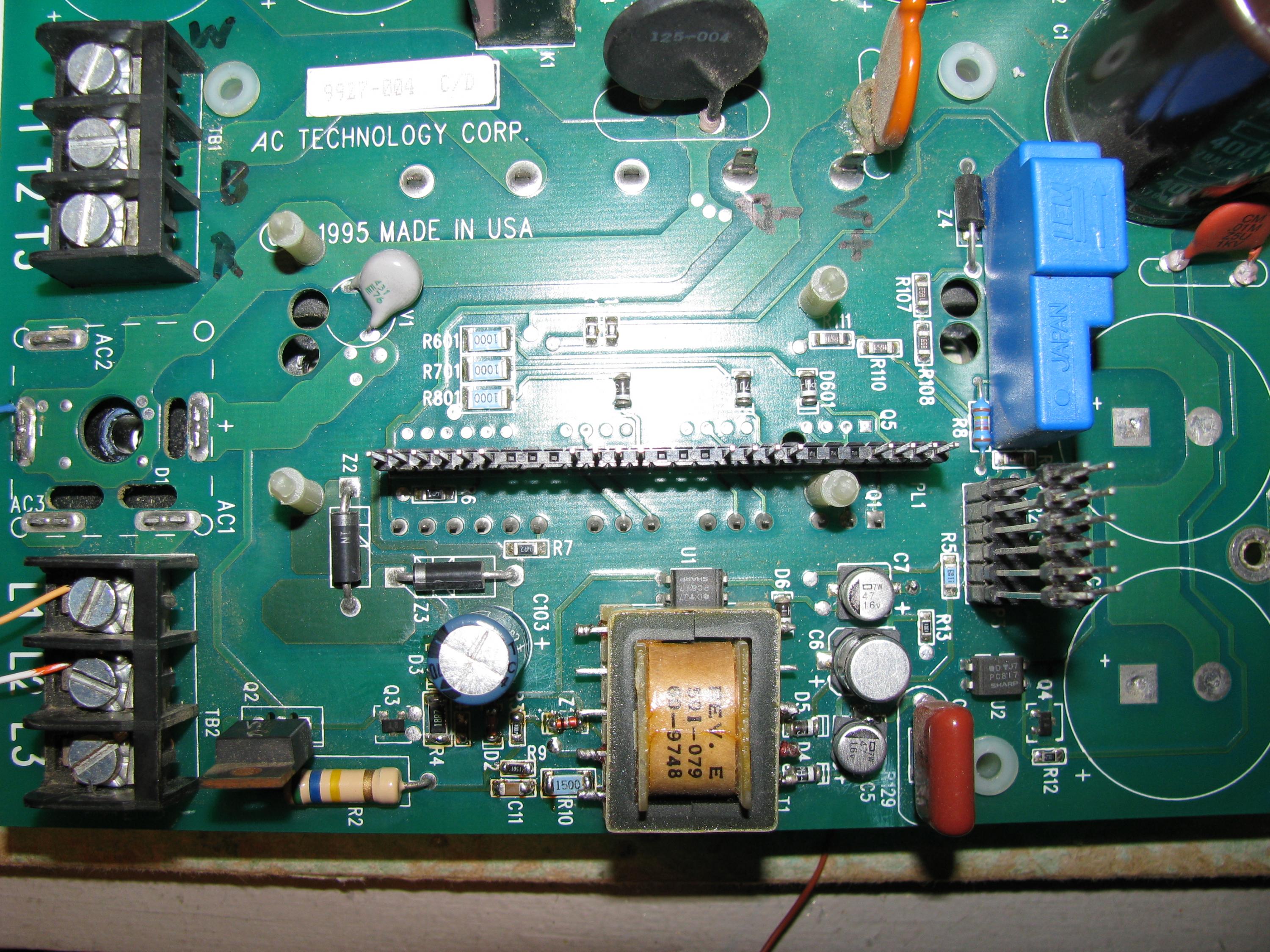

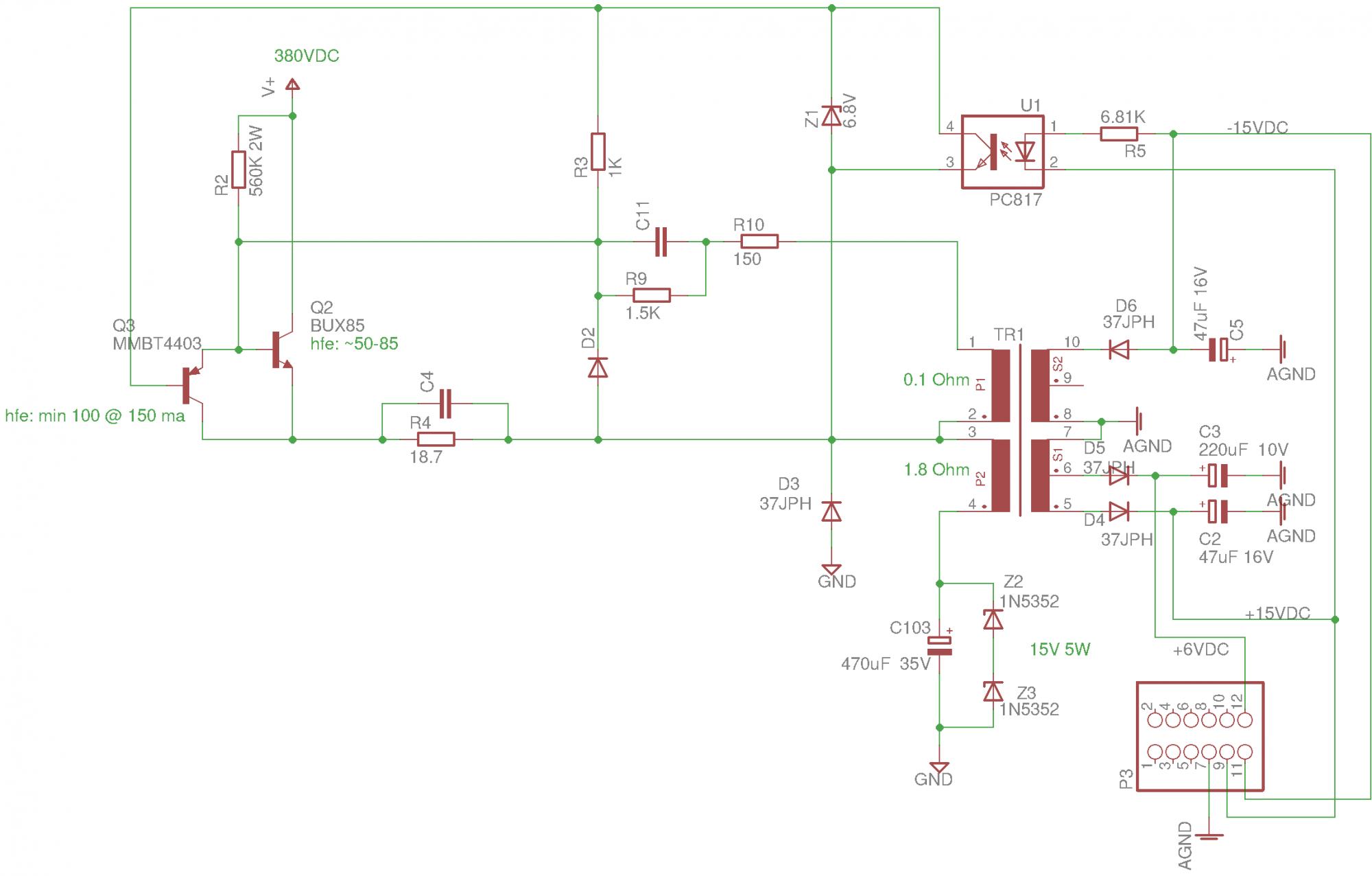

A bit more context. Dates at ~1995. I've tested the transistors and diodes in circuit. All seem fine. I've checked the ESR of C103, it's showing .11 (good). D3-D6 are labeled "37JPH-". I haven't been able to figure out what they are, but they all have a forward voltage of 0.52V. Outputs are something like 6V@100ma, +15V@20ma, -15V@10ma so I'm guessing total output is under 1W. One interesting point is that a couple of the SMD components have come loose from the PCB and had to be resoldered, so I touched up all the SMD parts. I know the unit worked as recently as four days ago. I've updated the schematic and attached a top view of the board. There are no components on the bottom side except for the bridge rectifier and intelligent IGBT bridge, both fine.Comment

the lower winding gets powered, the upper winding then energises and cancels the supply to the lower winding.
atleast it looks that way!
go watch some "diode gone wild" video's on utube - he does a lot of psu reverse engineering with deep explanations.Comment

@stj: Thanks for the link to "diode gone wild". He provides the name of the topology (self oscillating flyback converter) and a good explanation for how it should work.
@sam: I've checked C103 again and got the following:
C103, Spec: 470uF 35V, measured 450uf and ESR .17 ohms (in circuit)
I'm going to try replacing it since it does seem to be on the borderline.
