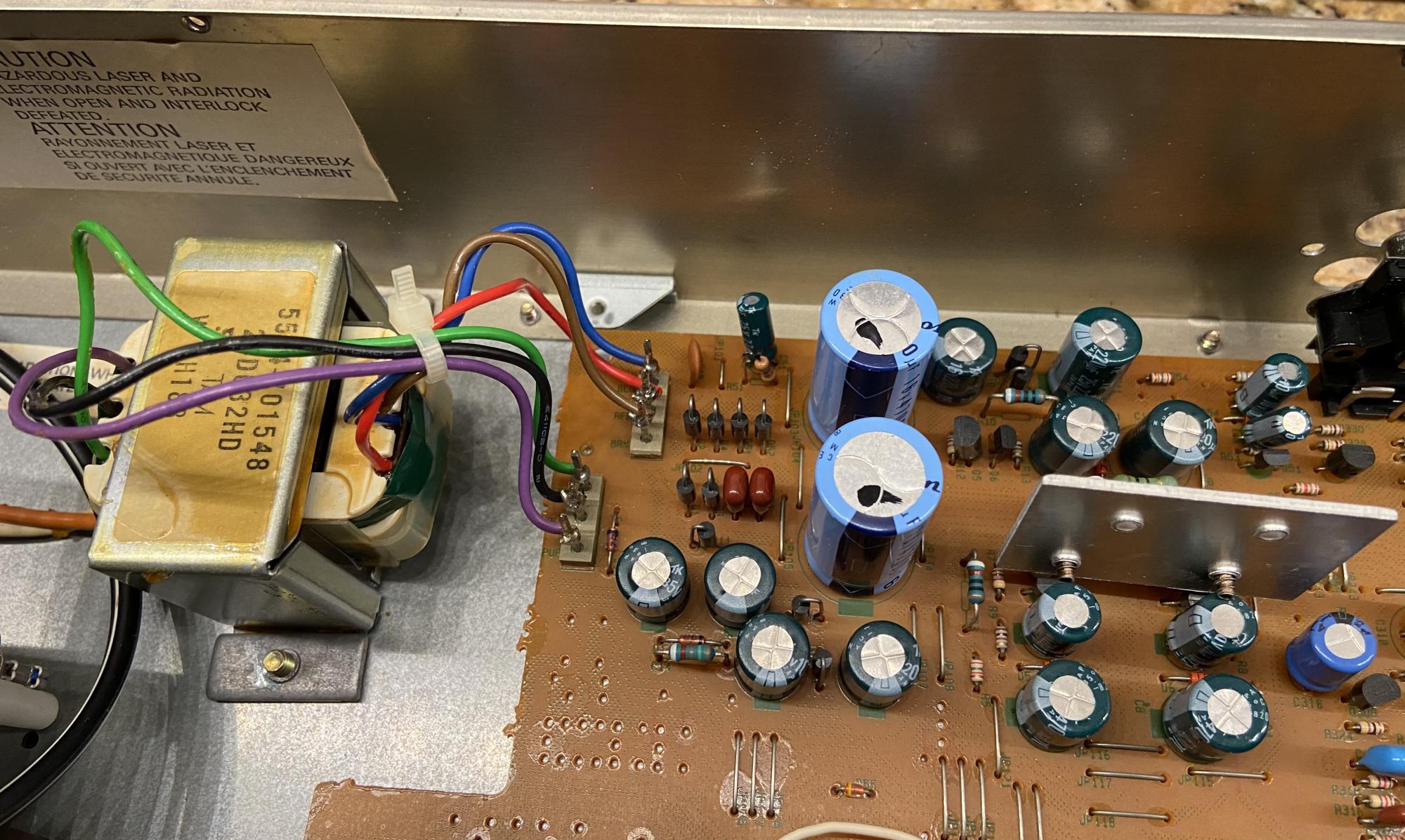

    Can someone please look at this photo and tell me how I would test the voltage of the 6 wires coming out of this ac transformer? Thanks!!

    The black should be the center tap of the purple and green wires, so you can check the voltage between the purple and green for the full secondary voltage or check between black and either purple or green.
    I would need to see the bottom of the pc board to be sure that the black is the center tap. The other set of wires should be checked the same way (Red center tap?)
    I said this before I saw the circuit board, so this is not correct in this case.
    The Blue wire is the center tap and the Red and Brown feed the diodes.
    The Black feeds a diode for a negative voltage so it is likely that either Green or Purple goes to ground and the other feeds another diode somewhere?

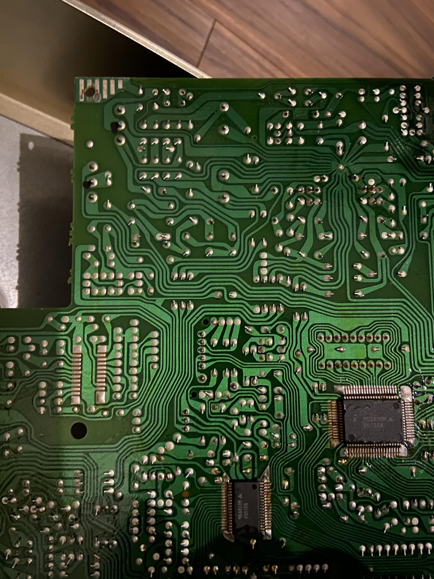

      Thanks! This picture should be a mirror image of the top of the board...

        Looks like the Blue wire is the center tap and the Red and Brown feed the diodes.
        What is it you are trying to do? just check if the transformer is working?

          Yes...the CD player won't power on. Power switch works and I have 120v ac at the output of the power switch pcb. I figured checking the output of the transformer was the next logical step.
          My main concern is damaging something by testing voltages between any of these 6 wires. Is that a concern? Thanks for the help

            Here's the service manual ...
