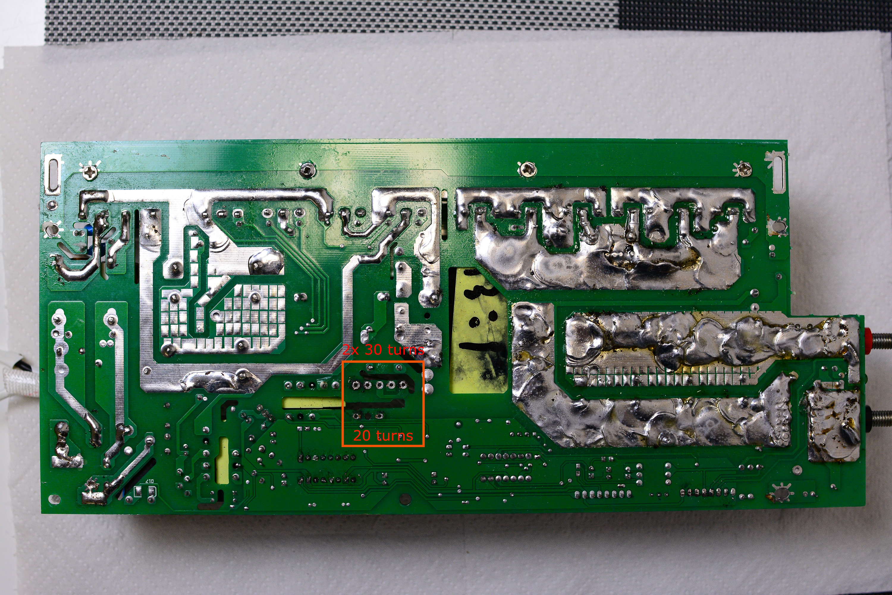

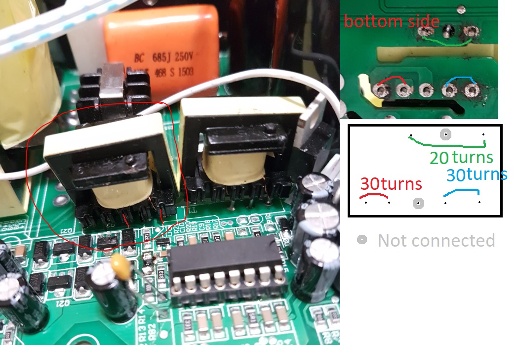

    Hi!
    I interested in trasformer on attach image. It's used on power supply. What keywords should I use to each for replacement on sites like aliexpress?
    I tried to search for "high frequency transformer" but I didnt seem to find this one. It seems to have two 30 turn output side and one 20 turn winding on input side.
    Any ideas what the use of 2 outputs if both have same number of turns?

    There are probably millions of different transformers out there for many different uses. You need to understand what the circuit does to know how that transformer is used.
    To me, this looks like a driver transformer of some sort and not a power transformer, but I really couldn't say more without at least some detailed pictures of the device.
      Re: What's this transformer for and how to find in on aliexpress?
      1) Is the transformer bad? In which way?
      2) How about providing straight shots pictures of the whole top and bottom side of the board.
      3) That transformer does look like for Gate drive transformer.
      4) Did you unwind the windings to get the turn count?

          This transformer seems more like gate driver transformer for powerful converter IGBTs or FETs.
          If this device where this transformer is, is known manufacturer product then you may find replacement transformer but if not then you can make it yourself if you know how to make it.
          But if this smps operate 70 or more kHz then you need take very special care. If you want only replicate - exactly same wire and turns of windings exactly same direction, core must be same shape and material N87, N97, 3C94, 3C95 or better (power ferrite) leads you the target if the controller IC is not any exotic.

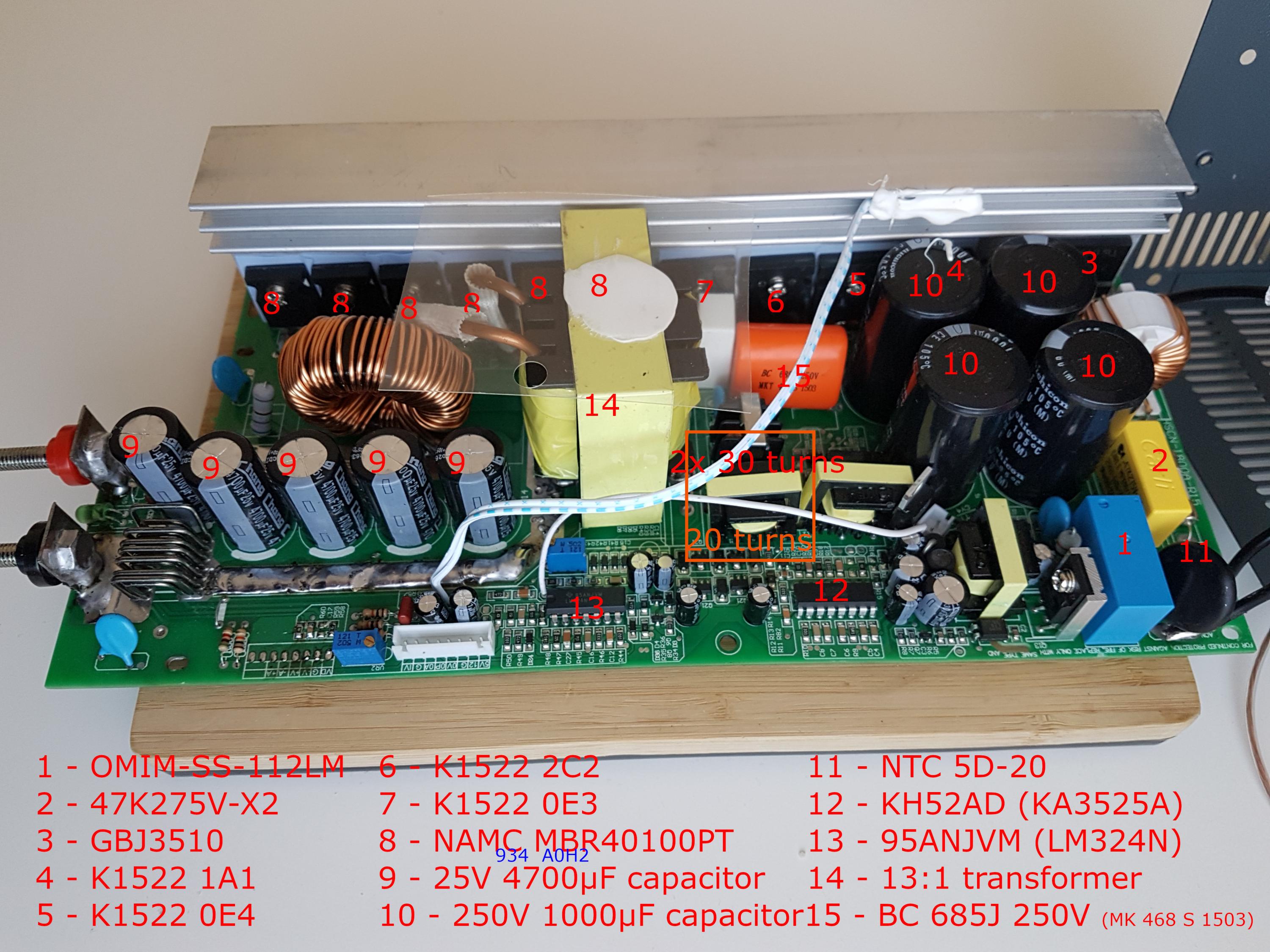

            Yes counted the number of turns. Originally I had to unsolder this transformer to get access to components that I could not otherwise. But then later I accidentally dropped it on floor and the plastic structure that was holding the pins broke. At first I thought that it's no big problem, that I could easily find the replacement once I know turn ratio and since it was already broken I simply counted the winding. Well it turned out it that finding replacement was not easy task.
            Here is image about this transformer:
            And here is bottom side:
            Yes, it can go upto 100 kHz. Why is it so important? So far I only knew that DC cares about direction, never knew that AC also wants right direction. Tell me more about it. And why is it not important for lower frequencies?
            I was actually about to ask about creating it on my own. Like 3D printing new plastic part and then winding it again. Sadly I did not memorize winding direction because it never occurred to me that it could be important.
            As for re-creating it my self, does anyone know what happens when I dont get exactly the same wire? For example what happens if I use larger diameter wire instead? Does it simply increase the maximum allowed current or what would happen?
            Yes, i still have the metal core and plastic part is good enough that I can take measurements from it and 3D print it.
            You seem to know more about it. Do you know what's that transformer could be used for? I mean 2:3 ratio doesn't seem to increase voltage that much. Is it for some kind of isolation?
              So much to learn.
              Just do a search on 'how to design Gate drive transformer'
              https://talema.com/gate-drive-transf...n-methodology/
              https://talema.com/gate-drive-transf...onsiderations/
              https://www.coilcraft.com/en-us/edu/...-transformers/
              https://cdn.badcaps-static.com/pdfs/...6f10bae659.pdf
              https://www.powerelectronics.com/tec...e-transformers

                        I read these but I still did not find out what happens when I use larger diameter wire than I have to (in case I cant use original wire for some reason)? I mean normally I would expect that nothing bad happens from choosing to too large wire but since it is high frequency I am not 100% sure anymore.
                          master hoarder
                          • May 2008
                          • 12175
                          • Bulgaria
                          ^ Larger wire is OK - if you can make it all fit.
                          Smaller wire... will probably work too, but may not be a good idea.
                          Since this is not a power transformer but rather just a signal/driver transformer, smaller wire will probably work without any adverse affects. Nevertheless, try to stick close to what the original wire size was, or use thicker wire if needed... and if really not possible, then go with thinner wire as last choice.
