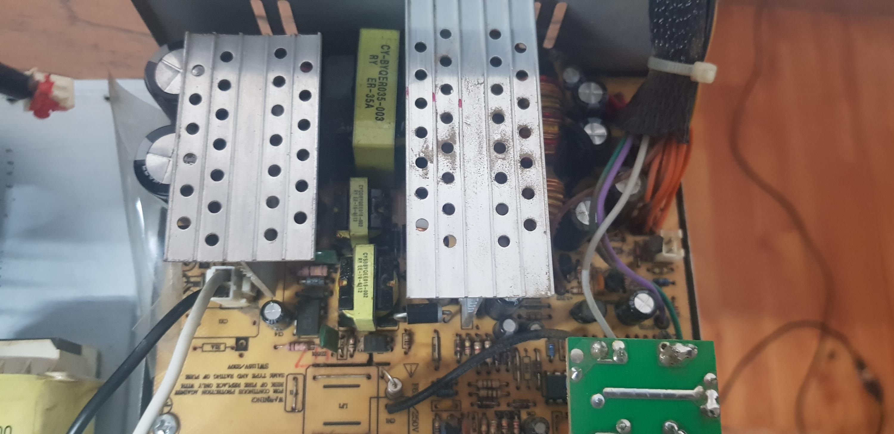

    The fuse isn't blown - probably my photo is a bit unclear but the fuse is intact, actually.
    Again, I have high doubts this will even attain 150W without self immolating. Scratch that, anything past 50W looks like a incendiary event for it.
    250W.. never ever.
    The Husk "450W" unit I also got along this one isn't much different, except for a PFC coil (which to my surprise, is actually real) and that one does allow for some improvements.
    EDIT - here's the Husk unit. This one might be a good candidate for some modifications as it feels slightly less cheaper than the Spacer posted earlier - that one is so cheap even the Molex pins come undone from the plastics themselves. I have a feeling XHY did the Husk, but not sure. The transformer markings seem familiar for XHY to me, yet not the rest of the design.

      Spacer PSU that's sold in Auchan Romania. Claims "250W for 500W Desktop PC"... whatever they wanted to say with that.
      I guess they mean to say it's an underpowered POT (piece of trash) for your PC.
      And with a name like that... just overload and send it into space!
      Originally posted by Dan81 View Post
      I barely doubt it does a single watt in spec without self immolating on power on.
      Single output cap per rail. Yeah...
      Anytime I see those cheap thin "T" style heatsinks on a unit, I know it's not worth my time to repair/upgrade for PC use. I still might use it for a bench PSU - particularly for experiments where I don't necessarily care about blowing up the load or where the load just doesn't care about ripple (DC motors, heater coils, large Nickel-based batteries, and etc.)
      I find it ironic that the manufacturer bothered to put good line filtering on this unit, though. I guess that makes it this better for harvesting parts from it.
      Needs fixing then?
      Oh, it will do 50W... but even with that, the ripple output will be terrible.
      Personally, I'd be scared to put it past 100-120 Watts. Up to that, it might just barely hold onto dear life. Those thin T heatsinks are really too wimpy to transfer heat from the parts on them to their larger surface area on top.

        Nah, the Spacer one is really right about itself - No user serviceable parts inside. Well, maybe the fan, lol.
        Again, compared to the Spacer, the Husk unit does at least have spaces for a few PI coils (jumpered, of course - but hey, they exist at the very least!!), and does use a IC for the 5vSB, so this would be a redeeming quality. Oh, and unlike the Spacer oe LC-Power, this one does allow for a TO-3P 13009/D209x part to be used on it - ironically, Stinkworlds should have these plenty.
        Finally, sleeved main cable - the Spacer isn't even sleeved. And did I mention the Spacer has even thinner wire harness than any unit I have? It feels like it's nearing 30AWG - free Kynar knockoff I guess?
        As for the Spacer, it truly has no redeeming qualities whatsoever - for Christ's sake, the output torroid is as big enough as the mag-amp torroid of my Raidmax RX-500! You're expecting anywhere past 50W with that? No way. Attaining 100-120W as you suggested - impossible.
        For the PFC coil, unfortunately I won't crack it open. What I can say though, is they don't seem much different than the ones I'd find on Deers (and mind you - Deer never used fake PFC coils - if anything, it would either be installed or completely absent - unlike Kissquiet and their fake PFC coil that was just a jumper wire.), and my easiest giveaway that it is indeed real - I am fairly sure that if they were to fake coils, they wouldn't go as far as adding polypropylene caps (which this one does have) to the jumper wire - so, it surprises me that the chinese finally started doing real PFC - even if it probably sucks bigtime in terms of efficiency.
        All things considered - the Husk unit would make a safer 250W unit than the Spacer. It's truly sad when a usual overrated unit manages to outperform something that was actually rated to do 250W.

                                        Amazing to think it has been over a year since the last post here, so in an attempt to end the dry spell, here's an overview of a GameMax GM-400M "400W" SFX PSU. One of over a dozen I recovered from the trash. As to why, well, that's something you'll have to figure out.
                                        First and foremost, the label:
                                        Not a lot to say here, other than it being mostly in Chinese and the input voltage only being 200-240AVC, despite the PSU having a voltage selector switch.
                                        Board Overview:
                                        Now we're starting to see some of the shortcomings of this power supply, which I'll be going into in a bit. The soldering looks pretty decent for the most part, and the lack of SMD parts for such a modern unit (manufactured in July 2018) is intriguing.
                                        Primary Side:
                                        Input filtering consists of two 1nf 1Kv ceramic caps between line/neutral and ground, a tiny 5A fast blow fuse, and a 5D-9 NTC thermistor, with positions left for an X2 capacitor and common mode choke, both of which have been omitted, with no room left for any PFC or surge protection components.
                                        The bridge rectifier is a GBU406 4A 600v rectifier, which feeds right into a pair of Cheng KM 560uf, 200v capacitors, both of which test right around 330uf.
                                        The main switchers are a pair of D304X (400v, 12A) transistors in a half-bridge configuration, with one end of the primary coil tied between the two capacitors, and the other end being switched between the positive and negative rails.
                                        The 5VSB is switched by a HS606P, which appears to be an all-in-one switch mode controller IC, but I couldn't find any info about it.
                                        The main transformer is 35mm wide by 30mm tall, and the 5VSB transformer is 19mm wide by 16mm tall,
                                        Secondary Side:
                                        The filtering for each rail is as follows (and every capacitor is a Samwei SRL unless stated otherwise):
                                        5vSB: SB360 (3A, 60v) schottky diode, 2x 1000uf 10v with PI coil between them.
                                        3.3v: MBR2045 (20A, 45v) schottky bridge, 2x 1000uf 10v with PI coil between them (~18AWG, 6 turns, 5mm core).
                                        5v: MBR2045 schottky bridge, 2x 1000uf 10v with no PI coil.
                                        12v: MBR20100 (20A, 100v) schottky bridge, 2x Chengx GR 1000uf 16v with no PI coil.
                                        -12v: 3x? FR104 (1A, 400v) fast recovery diodes, Chengx GR 220uf 16v with no PI coil.
                                        As noted above, the only rails with PI coils are the 5vSB and 3.3v rails.
                                        A weird thing I noticed about the Chengx capacitors, is that, despite all being the same series, almost no sizes have matching color sleeves (browns are all 10uf, blue is 2.2uf, and green-gold is 1000uf, only exception is black-gold), which makes no sense to me.
                                        Both toroids are both -26 type, with the main one being roughly 1" diameter, and the 3.3v one roughly 3/4" diameter.
                                        The controller chip is a HS8018B.
                                        The cables on this thing consist of 1x 20+4 pin motherboard connector (20AWG for all wires except for PG, PS-ON, and 3V3S, which are all 22AWG). 1x 4-pin 12v motherboard cable (20AWG), and 2x Molex/SATA cables (1x Molex & 1x SATA per cable, 20AWG).
                                        One weird thing to note about this unit, is that the fan controller's PTC is located right next to the main toroid rather than next to/in the secondary heatsink, I guess they're expecting that toroid to run hot, though I'm not sure how well silicone glue conducts heat.
                                        Speaking of which, here's the fan:
                                        Don't know the make (gotta love obscure manufacturers who only use their logo on their products), but judging by the low current draw, I'm guessing this isn't a powerful fan at all.
                                        I'm not a expert, I'm just doing my best.
                                          It might do 200W continuous without launching. Efficiency will probably be in the 70% range, maybe 75%. If those output inductor cores get hot they will degrade pretty fast.
