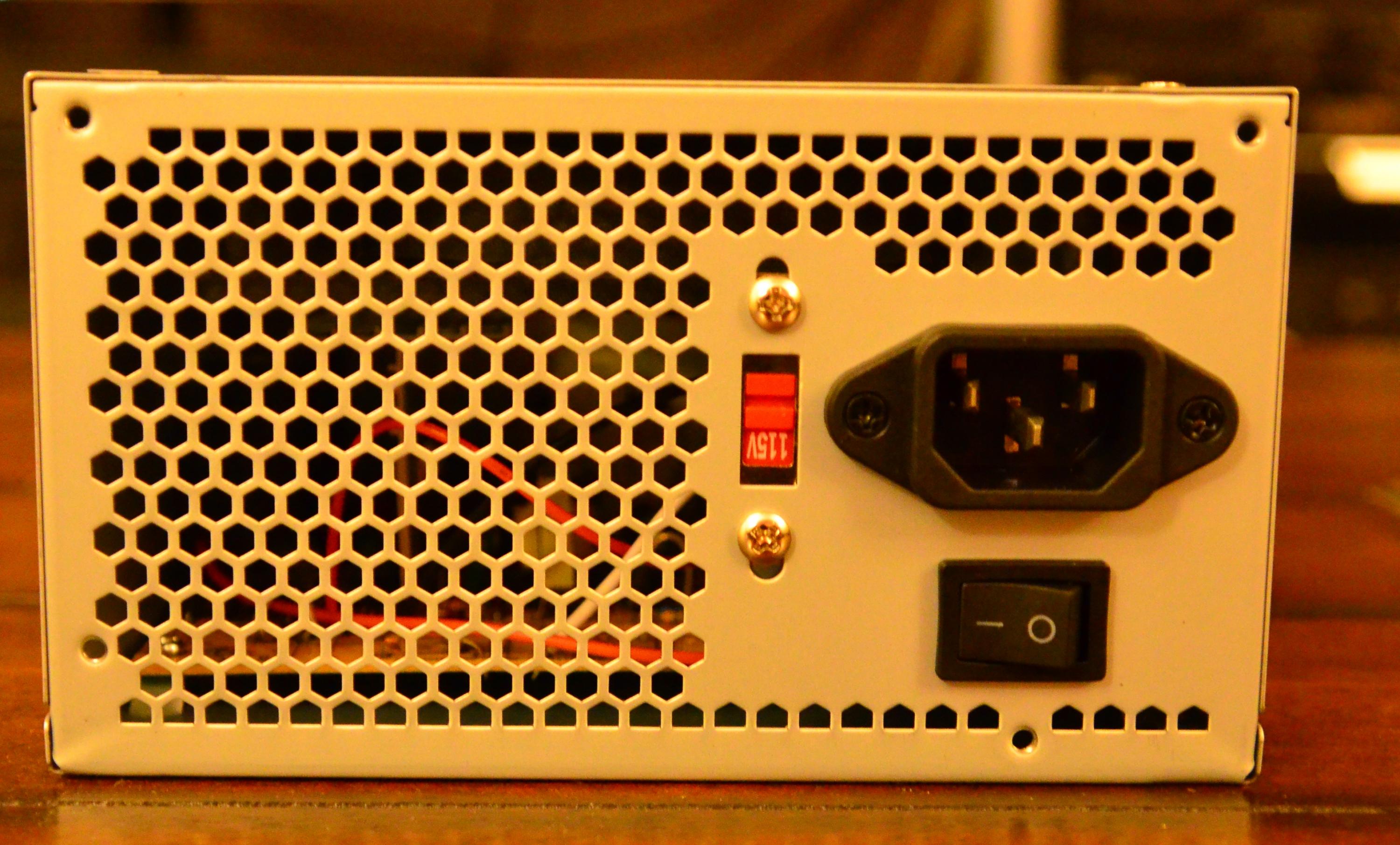

$20 "500W" PSU From MicroCenter, how bad can it be?
  • dmill89
    replied
    Re: $20 "500W" PSU From MicroCenter, how bad can it be?
    Originally posted by eccerr0r
    looks like 200W... if that much...
    It couldn't even do the lower 137W in spec (granted that is an ancient PSU tester so it was very 3.3V/5V heavy, but that is also an ancient PSU design so it should actually handle that better than a 12V heavy load of a modern system), so as far as meeting ATX specs it looks like a <100W unit, granted it could probably handle 200W without blowing up, but it would be feeding your components a ton of ripple that would slowly destroy them.
    At the higher 257W load (the built in 137W from the PSU tester + 2 60W electronic loads on the 12V rail) it really did feel like it was on the verge of blowing up with the smell it was making and the amount of hot air coming off the exhaust.
    Leave a comment:
  • cashkennedy
    replied
    Re: $20 "500W" PSU From MicroCenter, how bad can it be?
    I don't blame them with all the idiots I hear still insisting on 750-850w power supplies for systems with midrange processors (ryzen 3600x), and upper mid video cards (gtx 1660). Those idiots (which seem to be the majority of people building computers) usually think 500w wouldn't be enough for any system with a discrete video card.
    Leave a comment:
  • dmill89
    replied
    Re: $20 "500W" PSU From MicroCenter, how bad can it be?
    Originally posted by eccerr0r
    Keep on seeing that silly skinny extruded T heatsink... powmax?
    looks like 200W... if that much...
    KA7500/TL494 or what custom chip does it use?
    UTC7520D (looks like a knock off of a Weltrend WT7520):
    Leave a comment:
  • eccerr0r
    replied
    Re: $20 "500W" PSU From MicroCenter, how bad can it be?
    Keep on seeing that silly skinny extruded T heatsink... powmax?
    looks like 200W... if that much...
    KA7500/TL494 or what custom chip does it use?
    Leave a comment:
  • $20 "500W" PSU From MicroCenter, how bad can it be?
    Here we have the Solid Gear (MicroCenter House Brand) Basix SDGR-500BX "500W" PSU, one of their cheapest ATX power supplies selling for a whopping $19.99,
    lets take a look at how good/bad it is:
    Box, pretty basic packaging:
    It claims 26A on the 12V rail and 22A ea. on the 3.3V and 5V rail.
    The unit itself is a pretty basic grey box as expected at this price point:
    No APFC (not surprising at this price point):
    Label claims the same as the box (at least the lies are consistent).
    Lets take a look inside. Oh boy, this isn't good:
    Primary has 2X "Rubycon" PX 220uf 250v caps (these caps look really old and dirty so they may be "recycled"), a pair of 13007 (8A 400V) transistors for the primary and a C3150 (50W 800V) on the standby. The input "filtering" (if you could call it that) consists of 1 x-cap and 2 y-caps directly on the mains connector. It is also using the 4 diodes treatment for the bridge rectifier.
    On the secondary side we have a Mospec F16C20C (16A 200V) ultra-fast diode on the 12V rail (hmm didn't the label claim 26A??), and MCC MBR2045CT (20A 45V) Schottky diodes for the 5V and 3.3V rails (and the label claimed 22A for these).
    Secondary Caps as follows:
    3x Jayi 1000uf 16v
    2x ZTLCon 1000uf 10v
    2x Jwco 470uf 16v
    Bottom of the board, not terrible for a cheap unit:
    Lets see how it handles some load:
    Starting with the 137.6W load from my Seasonic power supply tester
    Note: the oscilloscope is set to the 100mV per division scale
    12V:
    Voltage at 12.586V which is in spec, but the 250mV ripple isn't, so this thing fails even with a fairly light load.
    5V:
    5.0335V, but 225 mV ripple again out of spec.
    3.3V
    3.1099V and 200 mV ripple out of spec on both counts here.
    Power draw:
    178W for a 77% efficiency.
    Now lets add an additional 10A on the 12V rail to bump it up to 257.6W:
    12V:
    12.363V and over 300 mV ripple (and look at how ugly the ripple in the +/-100mV range is ).
    5V:
    5.082V with around 275 mV ripple
    3.3V
    3.1206V with around 225 mV ripple
    Power draw:
    338W for a 76% efficiency.
    Well, it didn't blow up, though it did start to smell "bad" (like hot melt glue) in the second test so I doubt it would last very long under that load. The ripple is downright ugly though even under the lighter load so I wouldn't use this thing on any PC I cared about (or any PC for that matter).
    Last edited by dmill89; 07-05-2020, 04:52 PM.
  • chth96
    Is it no harm to replace with capacitor without ripple current rating?
    by chth96
    When I tried to repair LG 29 inch CRT TV, I found that the ESR value of samyoung SMS capacitor(160v 2.2uf), which is very close to D1879 transistor, is 6 ohm.
    Judging from above ESR Meter Table,I think It is necessary to replace this sms capacitor.So I visited local electronics shop,and I purchased 160v 2.2uf rubycon YK capacitor.
    But when I browse through rubycon YK datasheet,I found that there is no ripple current rating for 160v 2.2uf specification. But On the contrary, I found 39 mA ripple current rating for 160v 2.2uf SMS capacitor.
    Rubycon YK DataSheet (b...
    04-19-2024, 05:19 AM
  • Antonynl
    What are typical ripple voltages on a laptop motherboard?
    by Antonynl
    I have here a HP pavilion hp 15-cs2975nd with a 1.095v power supply that is driven by a FDMF3035. I do see about 80mV of ripple on my scope. I searched through the datasheet to find possible values of the ripple but I don't understand the datasheet well enough.
    So I have two questions:
    1) what is the typical ripple voltages of gpu/cpu on a laptop or pc mobo?
    2) what would be the max ripple of a FDMF3035 that drives an output of 1.095V?
    Would be nice to have a rule of thumb of say a percentage of the supply voltage to be an acceptable ripple voltage....
    12-09-2022, 06:51 AM
  • Ady2017
    Is there a manufacturers tolerance for ripple?
    by Ady2017
    Hi all
    I need to replace a 680uF 35V SamYoung NXB cap which has got a ripple of 1820. Whilst passing my local little electronics shop I picked up what they had in stock which was a 680uF 35V Panasonic FC with a ripple of 1655.
    As the ripple rating is only 9% below what the original was I am wondering whether to risk it and fit it.
    The catalogues specify a capacitance tolerance of +/-20% but state nothing about the ripple. If there is a similar tolerance for ripple then I might be worrying about nothing. Does anybody know?
    11-13-2021, 11:46 AM
  • Antonynl
    Lenovo 530 Vcore : what is the maximum ripple?
    by Antonynl
    Hi
    I have a Lenovo 530 14ikb i5 8th gen motherboard and it fails to start Windows: it normally dies after I try to load Windows. Getting into bios screen works fine.
    Made some measurements and I suspect that there is to much ripple on the 2 Vcore coils.
    What is normally the maximum ripple allowed on say any of the power supplies? A few %??
    The ripple is on both Vcore as outlined in red in attached photos.
    Could be a bad driver?
    Cheers...
    04-29-2023, 04:59 AM
  • sumilumi
    700mv ripple on Akai Sampler linear supply
    by sumilumi
    Hi fellow troubleshooters. This is my first post on badcaps. I've recently setup an electronics workbench. i'm also building a studio with old equipment bought faulty at low cost.
    I've been into electronics since the mid 80's and particularly in the last few years though only getting hands on with repairs now. My knowledge gaps are significant so I'll be posting here to seek guidance advice and general practical applied learning.
    On my bench today is an old ca. 1993-95 Akai hardware sampler. This runs on both a linear and Smps supply. Both are getting on in age and ripple...
    01-02-2022, 10:12 AM
