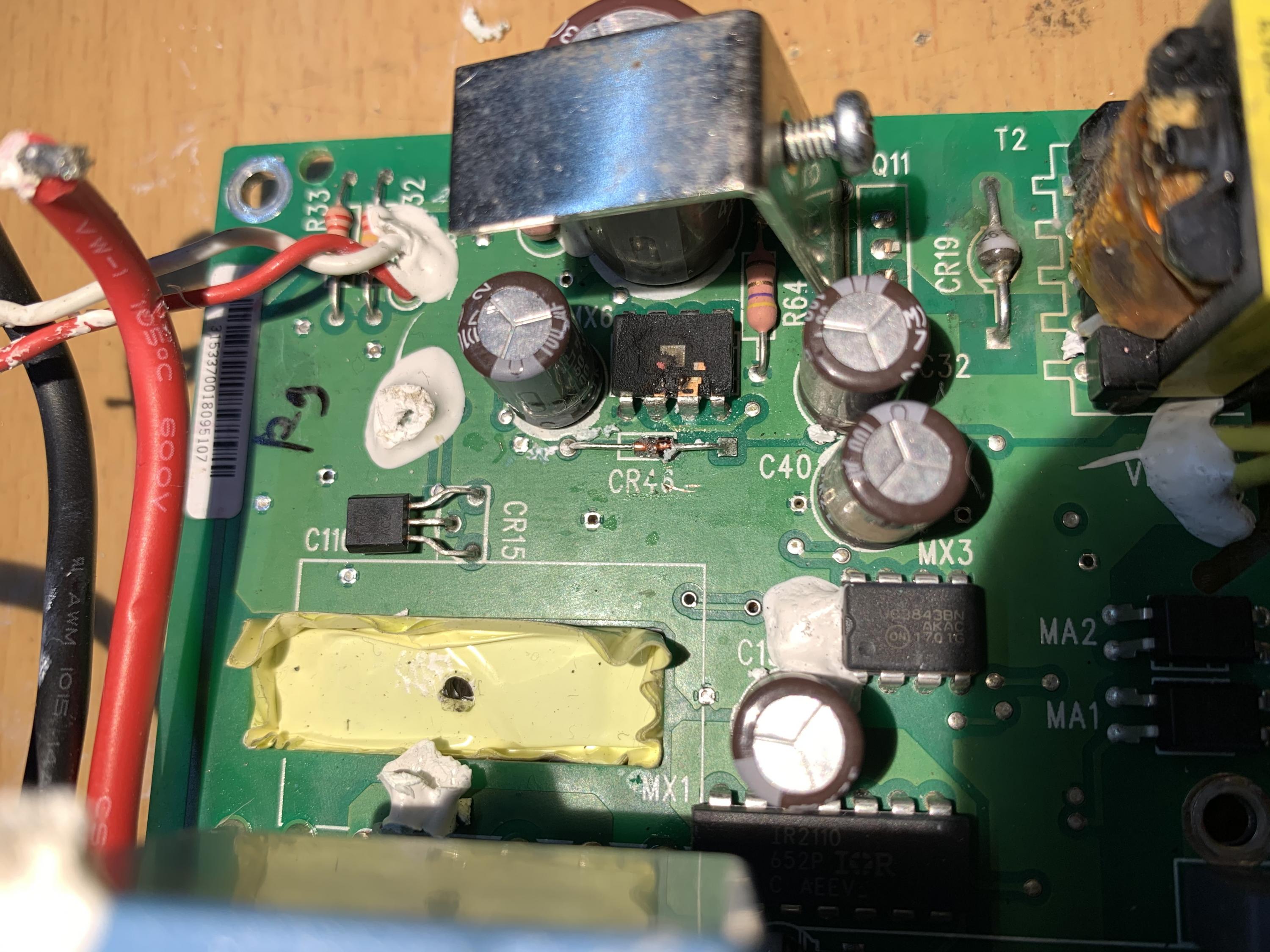

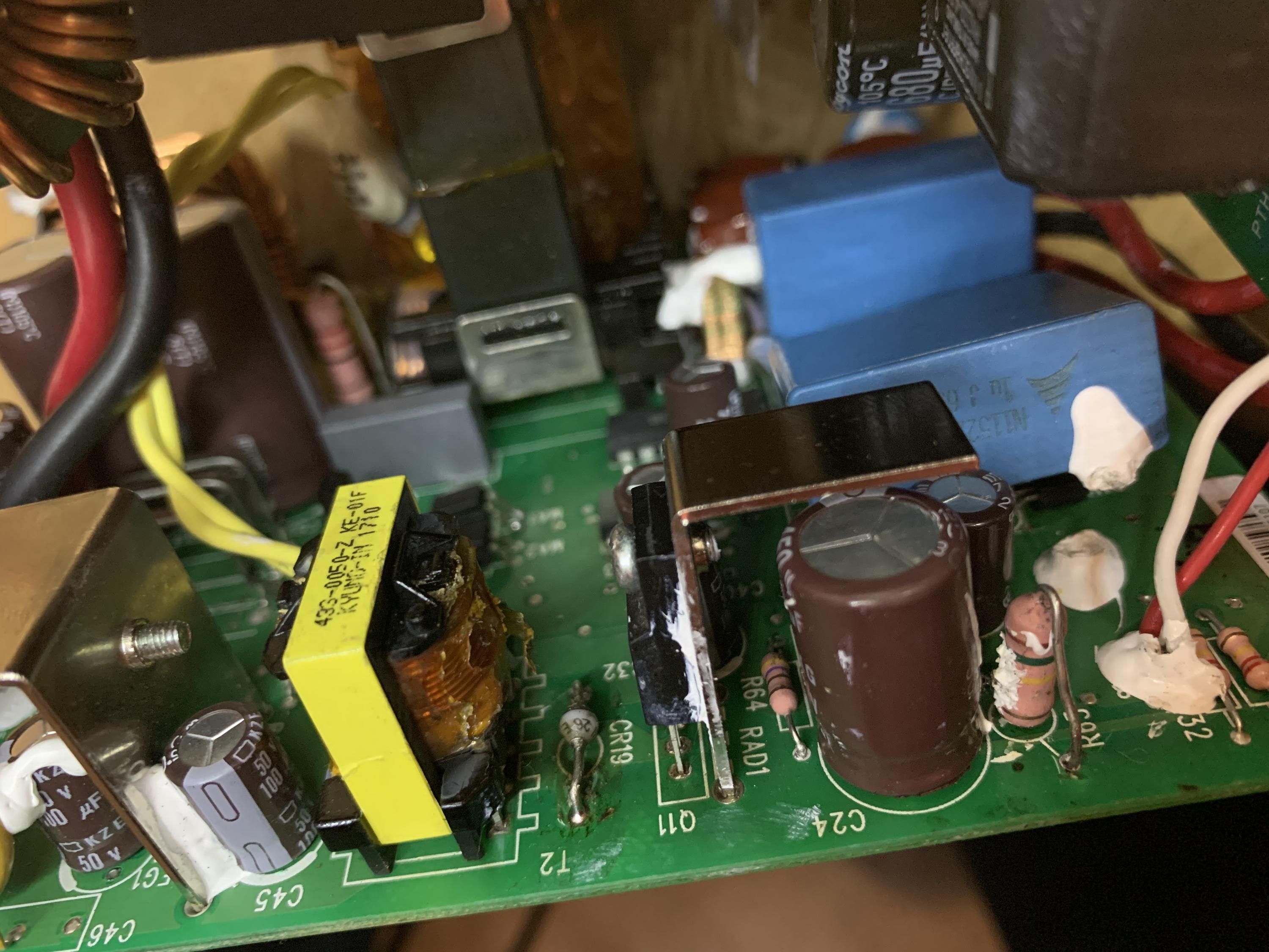

    Hi guys
    I got this power supply that is damaged. No history behind it. Power supply has two separate inputs, 110V and 230V, could be that somebody connected it to the wrong input.
    Upon opening i could see that Q11 5N80 is blown, and also MX6 UC3843 blown. On further checking diodes CR11 and CR12 (both U1D) are shorted, also diode CR19 BYV26E. Also the fuse from the DC line that is coming to this part of power supply.
    Unfortunately when i was taking out the white glue from PCB i damaged diode CR46. Well i am not sure which one is it. It's connected between VCC and GND on UC3843. I installed there 1N4148, hopefully that's ok?
    I have disconnected primary part of the power supply that it seems that is working properly without rest of circuits, It's giving out 332V and 166V between GND and 2 positive DC lines.
    This 332V is going to the second part of the circuit, and among the other things is going through the 150k resistor to the VCC for UC3843. I am getting 8V after that resistor.
    After all those parts are replaced and when i connect it to mains (230V) the FET 5N80 starts to heat a lot, so i have to unplug mains immediately.
    Output of power supply tested by regulated power supply, connected 24V and current draw was around 40mA.
    So i assume something around this PWM circuit is not working properly, but have no idea what, FET not driven properly? What it could be?
      I suspect the diode between VCC and ground is a zener diode NOT a regular diode Likely around 18v zener. for external protection
      Are you sure CR46 connects to ground? or does it connect to the transformer?
      Are you sure that is the correct number for the ic, as it's top is blown off

        I wonder if there is still a marking on the diode? Having a signal diode there doesn’t make any sense to me. A zener diode, as RJ said, has my vote too. Probably one side of the diode goes to ground. Question is now what voltage the zener needs to be?
        UC3843 has a Vcc of like 8V or so.

            Assumed it should be zener, but had no idea which value, but still installed 4148
            Now i have installed 18V zener there. So as soon as PSU is connected to mains, FET starts to heat up.
            Tried with 7.5V zener, nothing happens because the voltage is 7.5V with that one so it does not turn on UC3843. And i am quite confident that it should be 3843 because i found blown top from ic, and could read most of the numbers. And also voltage of 8V is suggesting that it should be UC3843. But please correct me if i'm wrong.
            On the Vref to GND - 0.5V
            Vcc to GND - 7.9V (from 330Vdc line after a 150k resistor, checked that one out and is measuring fine)
            Vout to GND - 0V
            Tried with new UC3843 - no changes.

                        Did you replace CR11,CR12 & CR19 with the same part numbers? When you checked them did you check them out of circuit? CR11 & CR12 are across R64 which is 4.7Ω
                        CR46 is very likely a 18 volt zener diode, if you only get 7.5v then the uc3843 could be bad or something that is connected to CR21 anode side could be loading it down.
                        Also that VCC line should connect to CR22 cathode, this is the voltage that keeps the ic running once it starts. The transformer has a secondary winding that likely connects to R83/R84 that then connects to CR22 anode. This is where the ic gets the vcc from once the circuit starts running.

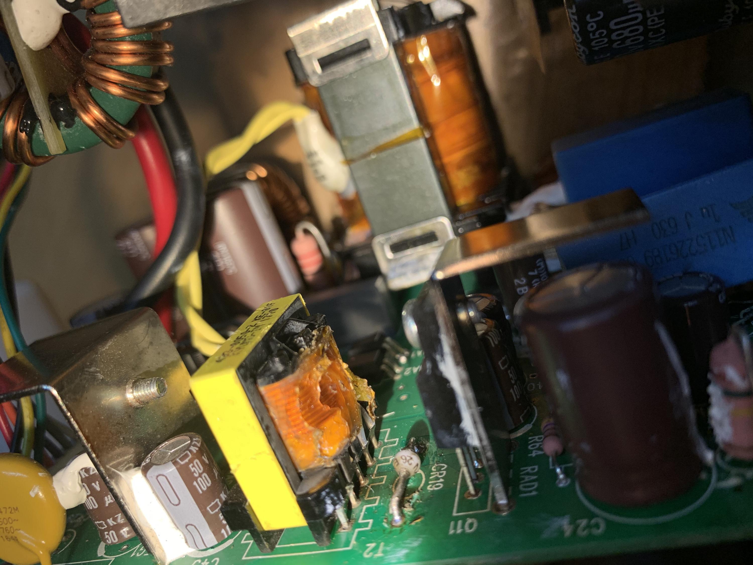

                                  How do you know the ic is working? did you connect a scope and look at the output? The ic has an internal protection zener diode of 36v so the only other form of regulation on that line will be the external zener diode (18v) with the 18v zener in place and the ic removed you should have 18v on the vcc line. (don't connect the ac without at least the 18v zener in place)
                                  The vcc will not likely get higher than 8 volts untill the circuit works and the transformer supplies the run vcc of around 18v
                                  Is that 100µf 50v capacitor on that vcc line ok?
                                  If the ic is working and outputing a prober drive signal to the fet, it is possible the transformer has a shorted winding, this would cause the fet to get hot.
                                  That transformer does look a bit burnt, or is it just from residue from the blown fet. Although rare, it is possible it is bad.

                                    Well, as i don't have scope my only option is multimeter and lab supply. So with 8.4V the output activates and it's active until voltage drops under7.6V. so based only on that fact i was sure that IC is good, and also changed 3 of them, could be that all 3 are f up but...
                                    So, I did a test that you suggested, took out IC and the voltage is 18.3V, regulated by CR46, 18V zener.
                                    Cap also tested, it is ok, same happening with the new one.
                                    Yes, transformer indeed looks burnt but it is mostly only the top protective layer, when i peel it a bit it does look clean. Although it is just across of the fet that blown, so as you said there is a chance that transformer is shorted . I can't test it with anything else than multimeter unfortunately, and i can tell you only that all 3 windings are not open. Shorted, maybe, but hard to know without some proper instruments.
                                    Damaged transformer is the worst outcome i would say because of transformer availability on the market and also unknown exact spec of the transformer.
                                    But i have found one that could work as a almost direct replacement - attached pdf (74202).
                                    Secondary is going to LM317 which is then powering LM224. When i connect 24V to the output of the PSU there is 6V on Vcc pin of LM224. (7.7V on input pin of LM317).
                                    To be honest i have no idea what else to test except the transformer, and that one is not that easy to test, unfortunately.
