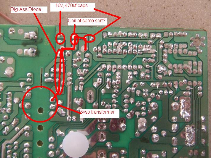

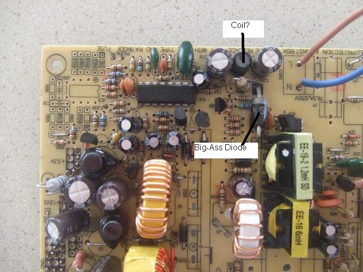

    Can't tell if this unit has it or not. The 5vsb circuit doesn't have the usual signs of being two transistor.
    The only IC on the board is a EST7502B except for a octocoupler next to the 5vsb transformer labeled "CC807 EL817 Everlight"

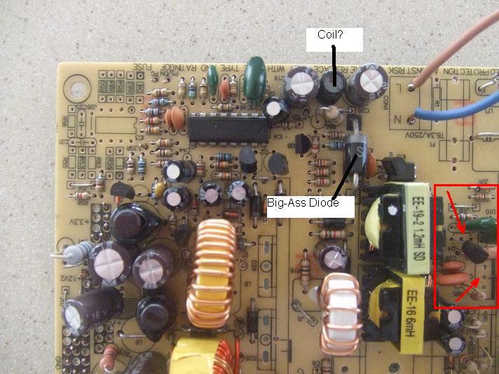

          Need that top down shot to be a bit more to the right to see better. Where is the "failure prone" cap and the anti-frost resistor?
          The "Coil?" is indeed one and along with the 2 - 470uf caps makes a pi filter for the 5vsb.

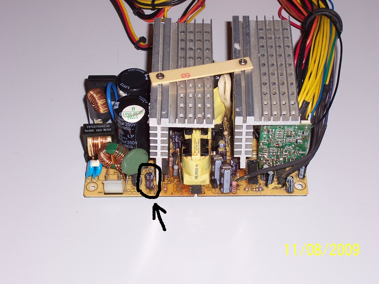

                  I have been troubleshooting the 5vsb circuit on this Antec Smart Power SP350. The pc board showed signs of heat burn around the opto isolator, so I decided to start there, replacing the optoisolator and also the AZ431 regulator chip. The 5vsb went from 12.13 volts to 12.83 volts. Whoa .... going the wrong way!!! So I started tracing the entire circuit - just another typical 2 transistor 5vsb circuit much like the Bestec. All resistors measured OK. I thought I had changed out all of the electrolytic capacitors ... but oops, missed one. And it just had to be the critical one in the 5vsb, but in a location on the pc board that was unexpected. So changed that capacitor and 5vsb came up measuring 5.03 volts.
                  From this I am slowly learning ... ALWAYS check 5vsb circuit first to be sure you have 5 volts. If not, change the critical capacitor.
                  Why should this capacitor fail more often than capacitors on the output rails? The capacitor value is typically in the range of 10 uF to 220 uF, usually about 22 uF. Capacitors on the output rails have a much higher capacitance value, therefore typically have a much lower esr. So if the 5vsb critical capacitor has a higher esr value and is filtering the same switching frequency, a failure should be expected sooner. This would explain why Wizard recommends increasing the value of the capacitor in this critical location. Also, the 5vsb circuit is ON when the computer is turned OFF (unless unplugged from the wall). So I would expect problems with this capacitor before capacitors on the output rails because it is working harder and more often.
                  Next, none of the capacitors on the output rails failed. That includes one Teapo and all else Fuhjyyu. The 5vsb critical cap that failed was a 22 uF/50 volt Teapo. Both caps in the 5vsb output pi filter were Fuhjyyu 1000 uF/10 volt, both bulging failures. I would expect this because putting 12 volts on a cap rated for 10 volts is asking for trouble. All other failing caps were in the switching circuits which also had transistor and diode failures. They were assorted Fuhjyyu, Teapo, G-Luxon, and Koshin. They were also located in the cavity formed between the two heat sinks - which is where I would expect more heat, especially when the computer is off.
                  I am beginning to think an analysis of this failure, and the efforts of several who looked at the Bestec problems, leads me to believe that we are actually seeing more problems with bad design, placing capacitors next to heat generating resistors, and the cavity formed by the two heat sinks acting like an oven. The fan may provide cooling when power is ON, but does not do a thing for you when power is OFF.
                  At this point, I am going to challenge that blacklisting Fuhjyyu as being bad capacitors in all situations may be wrong - that they may be no worse than some of the others. This is especially true when looking at all the different brands of caps used in the critical capacitor location of the 5vsb circuit. More proof (analysis) is needed before continuing to make Fuhjyyu our scapegoat.

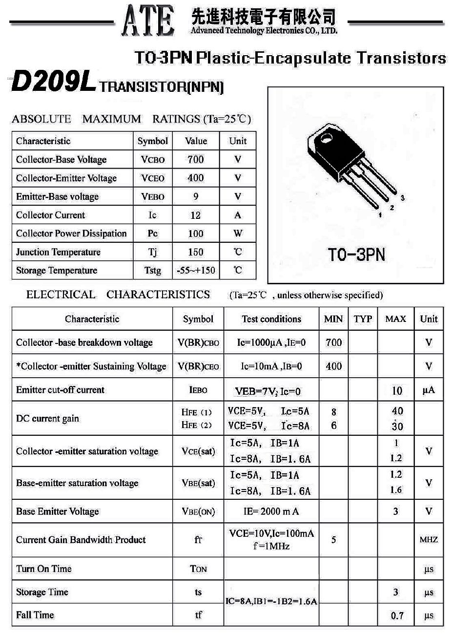

                    D209L - Datasheet converted from 600k PDF to JPG in a size that can be uploaded here. With ENGLISH specs. lol
                    Does not include the characteristics graphs page. If you want that, LMK.
                    Should help in the search.
                    Where was this critical cap found? Pics?

                      Was it one of the two small caps wedged between the primary semis and the transformers ?
                      I always had some real fun with my tweezers getting those out and replacing them. I refused to remove the transformers or the heatsink out of laziness so that was the only option.
                      Did 4 PSUs and it got easier each time.
                      My Antec TP 2.0 350W on my email server which lived it's life in my basement had Fukyuus that never failed either. Of course I replaced them immediately.

                          Toasty - I have the D209L data sheet, I just was wondering what a good replacement would be and where to get them. For this psu I had to raid my junk box - to get it working with small loading, I found one D209L and one 2sc2625. Works till I can get better parts.

                          I am attaching a photo of the critical 5vsb capacitor on the Antec Smart Power SP350

                            Could be possible to replace D209L by E13009L ==>
                            or better 2SC3320 ==>

                                  Thanks for the transistor substitute recommendations. POM MJ - both you recommended were not available from Digikey or Mouser. Toasty - the one you recommended by STM was about two bucks each. I found what appears to be a happy compromise, a Fairchild FJA13009 at 88 cents each in quantity of ten. Looks to me to be about the same as the STM 13009.
