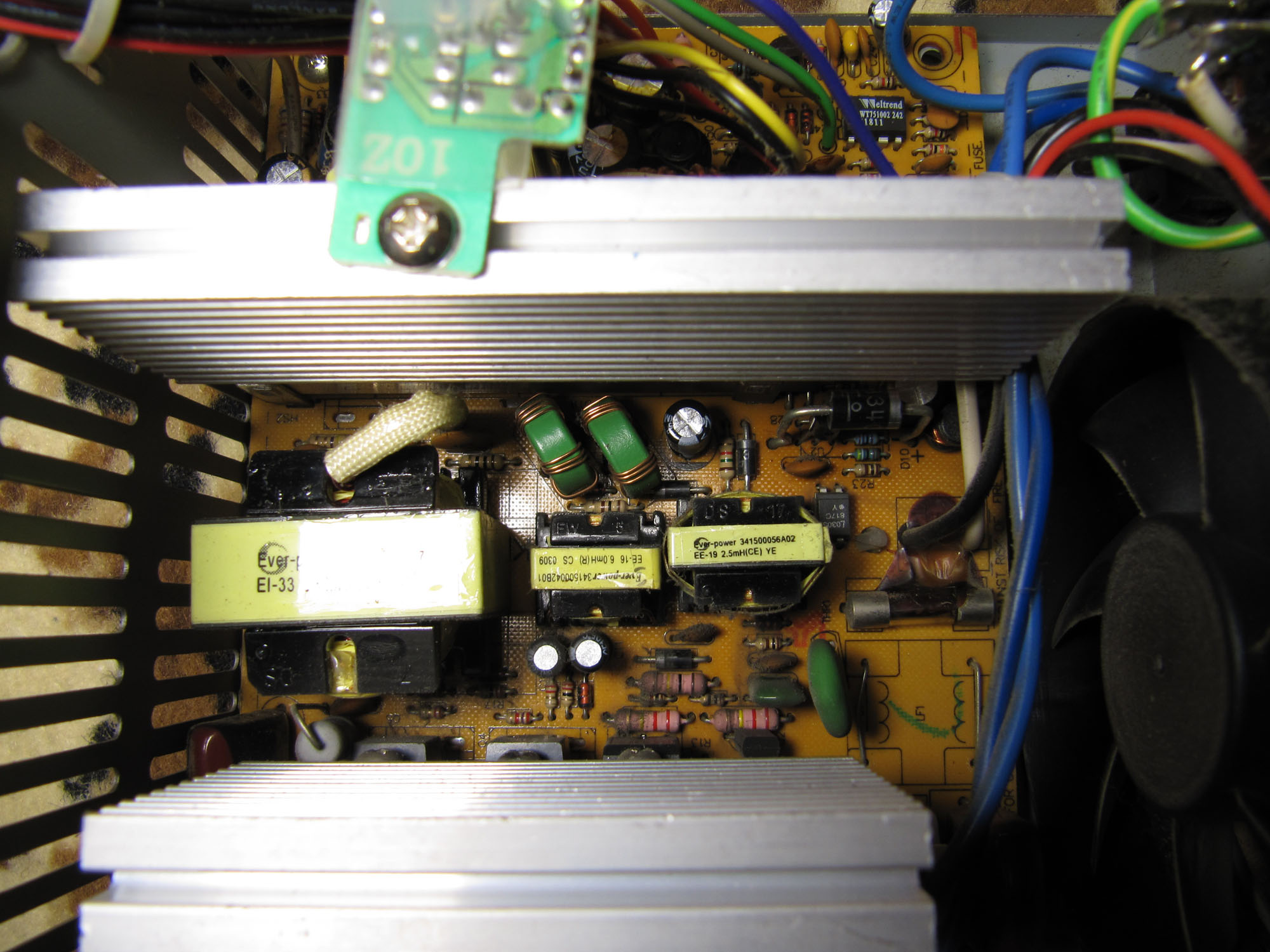

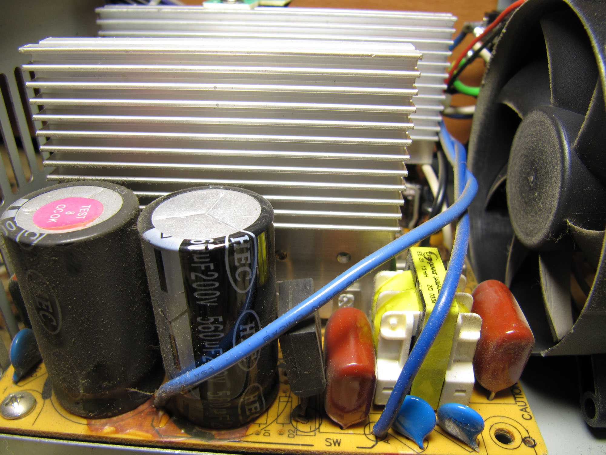

                                          while waiting to get replacement caps and recap macron power this came to me:
                                          Maxpower PL-300 300watt without pfc
                                          How do you rank it among the others?
                                          I noticed glue looking like melted. Is it bad or not?
                                          I also got a maxpower 400watt active pfc but I didn't like it, you can see it here: https://www.badcaps.net/forum/showth...7582#post87572
