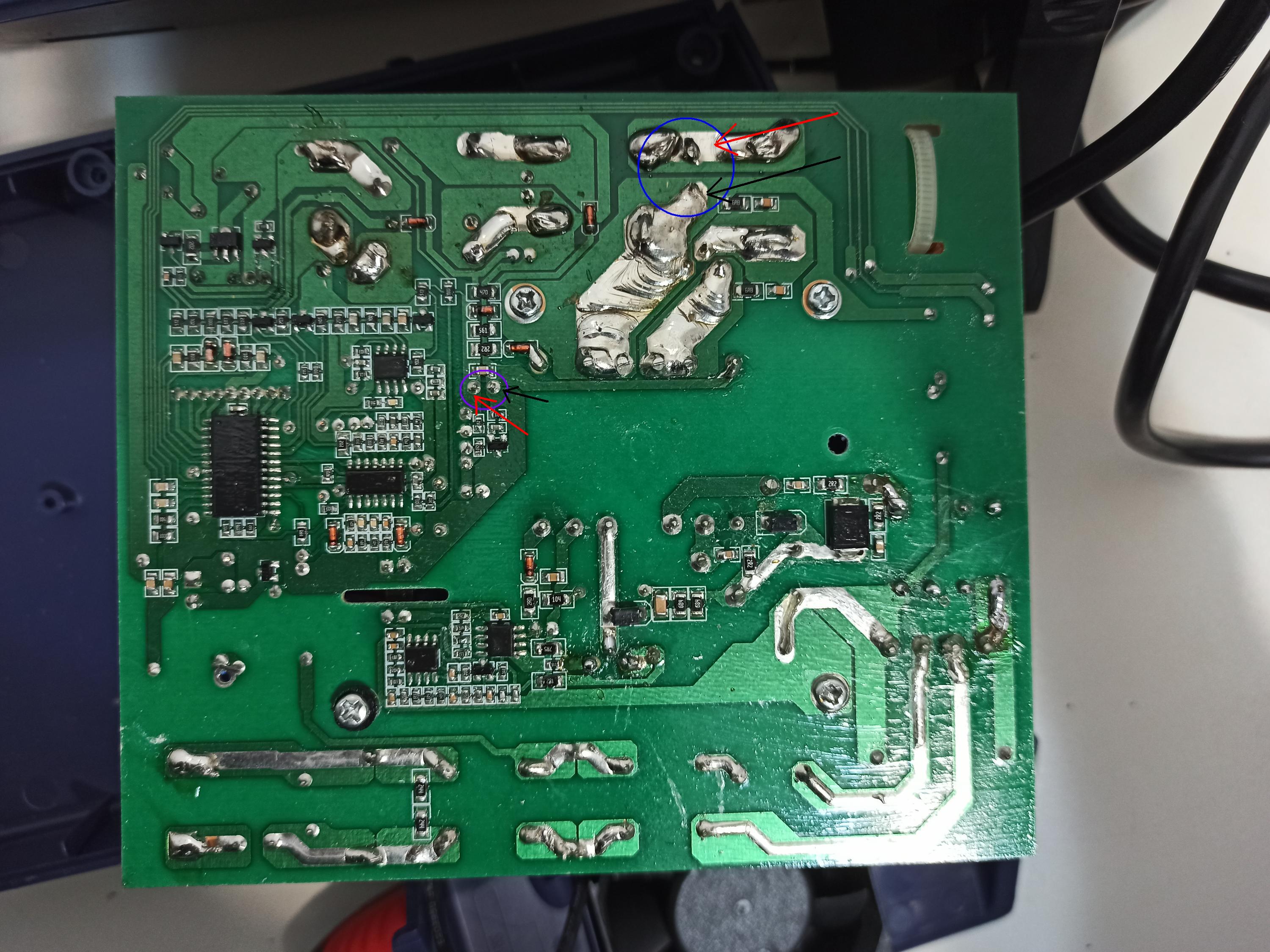

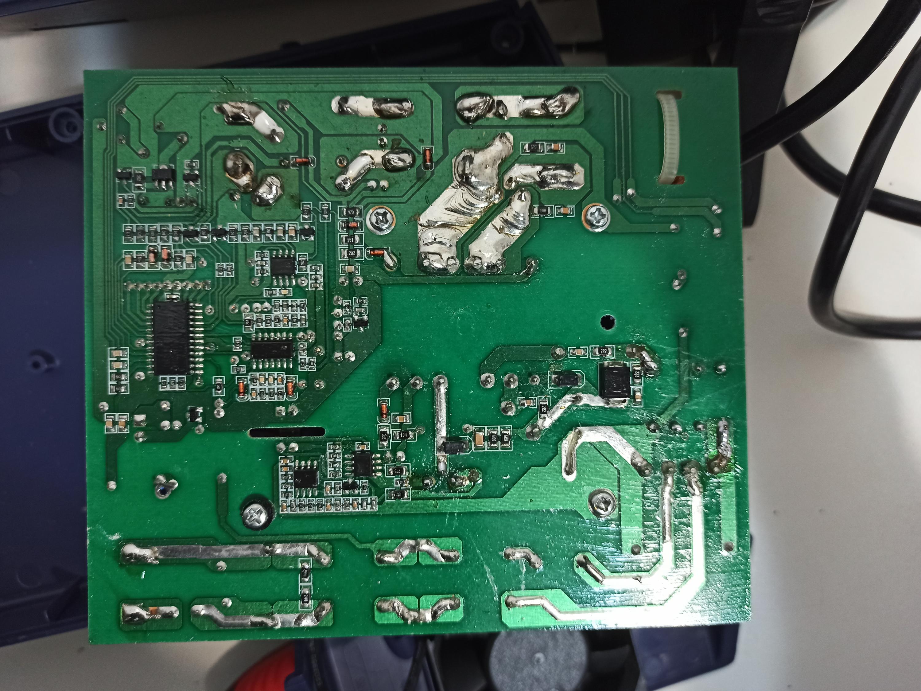

    Hi guys, I have this battery charger that stopped working meanwhile was charging the car battery, now the display didn't work and plugging the charger I only listen a low click noise, like a relay and nothing else.
    It's branded as Carrefour, but could be found also as Dunlop charger, 909, Coitech, and posibly many others. I can't find a service manual or schematic to check the board, on the board there is only a text with HRS7715 and a date.
    Any ideas?
    Thanks in advance!

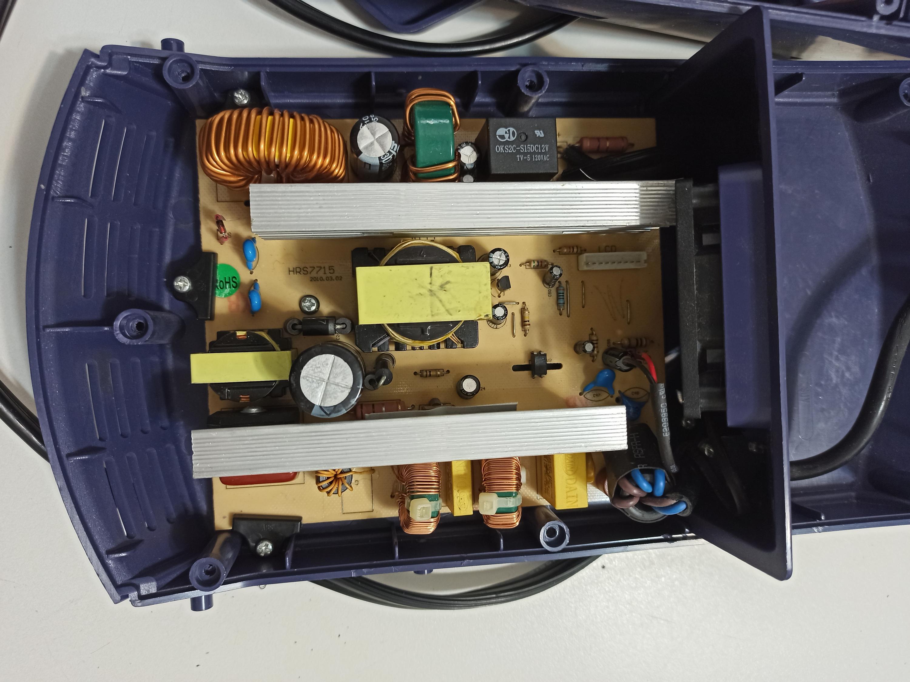

    i dont see any vents?
    probably the small caps are dried out.

        A low clicking noise might suggest the power supply is trying to start, but the startup capacitor is bad or dried out as stj suggested.
        A dried out cap won't show any obvious signs of damage.

          sorry for my ignorance, but witch one is the startup capacitor? black big one? square yellow ones at the AC side? Thanks!
            Re: Help with car battery charger HT7715
            C24 in the hot side.
            You should also check the small lytics caps in the cold side also.
            Did you already check all the diode, rectifiers?

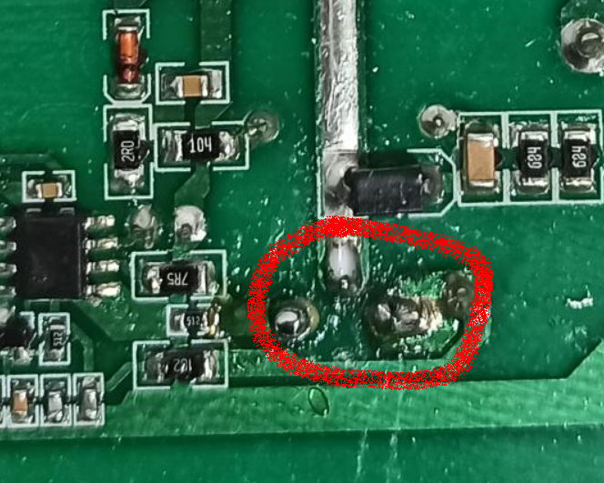

              Also, there may be some cracked or cold solder joints here? See pic.

                On the back of the PCB, one of those larger ICs should be the SMPS chip.
                If you look at its part number and find the datasheet, it will tell you what the typical VCC startup voltage should be.
                Then check C24, the startup cap to see if it is present.

                    I would check the voltage on these two capacitors, and see if it is stable, that could provide some information as to how the primary is operating.
                      That one was me after unsoldering the mosfet to check , seemed ok for me. The board is covered with a poor? varnish coat, I don't know how to remove it without damaging nothing, makes readings with the meter be tricky.

                        0V on the top and 0,001V on the botton one

                          Unsolded the C24 and reads 43uF on my tester, is a 47uf35v one, not a enought bad reading to prevent starting, not?

                              If you are getting 0 volts on the large cap I asked about, then the primary is not operating, The bridge rectifier is easy to check in diode mode, it is just 4 seperate diodes in one case. I suspect it is ok, if it was shorted the main fuse would have blown.
                              As for C24, replace it, I have seen the capacity check ok but they can be bad. The ticking you here is the power supply trying to start but shuts down, this can be caused by a bad C24 startup capacitor, it needs to charge up to sustain the VCC voltage for the pwm ic.
                              You could also have a short in the secondary, so check the dual diode (below the large cap I had circled)

                                While it may be okay with respect to uF, it may not meet it's ESR specifications.

                                  both big diodes seem to be ok on test, 0,6xx readings and nothing on reverse. Will try with one new cap to see what happens.
                                  The tick is only one time when plugged, not repeated until I disconect and conect again on the AC plug.

                                    Well, the click may be from the black relay you have on that board, which means there is power from some where to power the relay.

                                      Not seems from there, but I can see if there is any values at the relay pins.

                                        Nothing relevant on the relay, residual values of 0,002v, the brigge reads 140v in one pair and 132 on the other (230v AC at plug)
