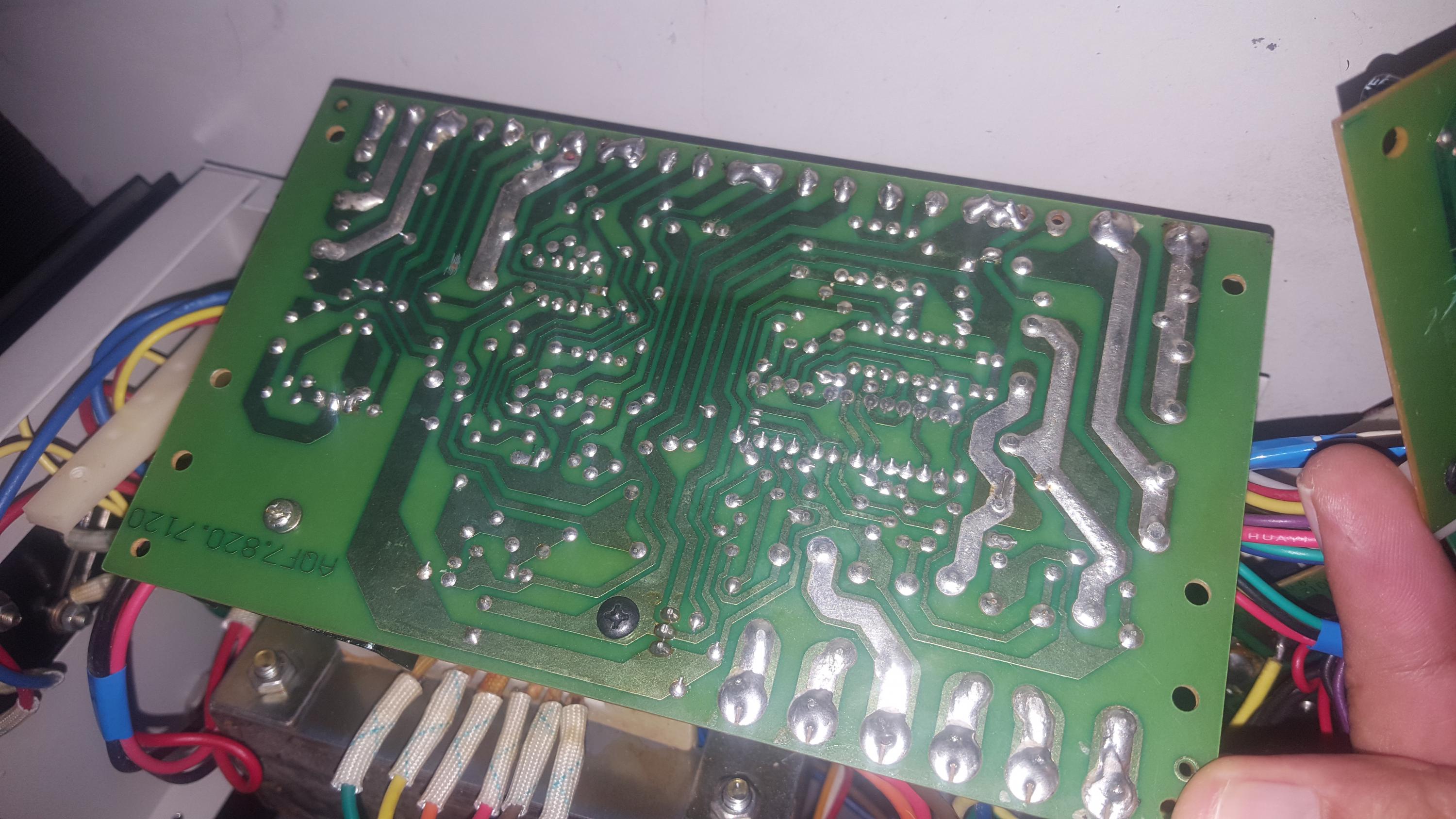

        Do you have a picture of the back of that AQF7 board?
        That input on that (AQF7) board shows +12 volts and you measure 9.6 volts, That white wire seems to go over to the power supply board which is also labeled +12 volts, I found another picure of the rear of this power supply board and that+12 volt line seems to come from that TO220 (N3) mounted on the black heatsink, Is it a 7812 by chance?

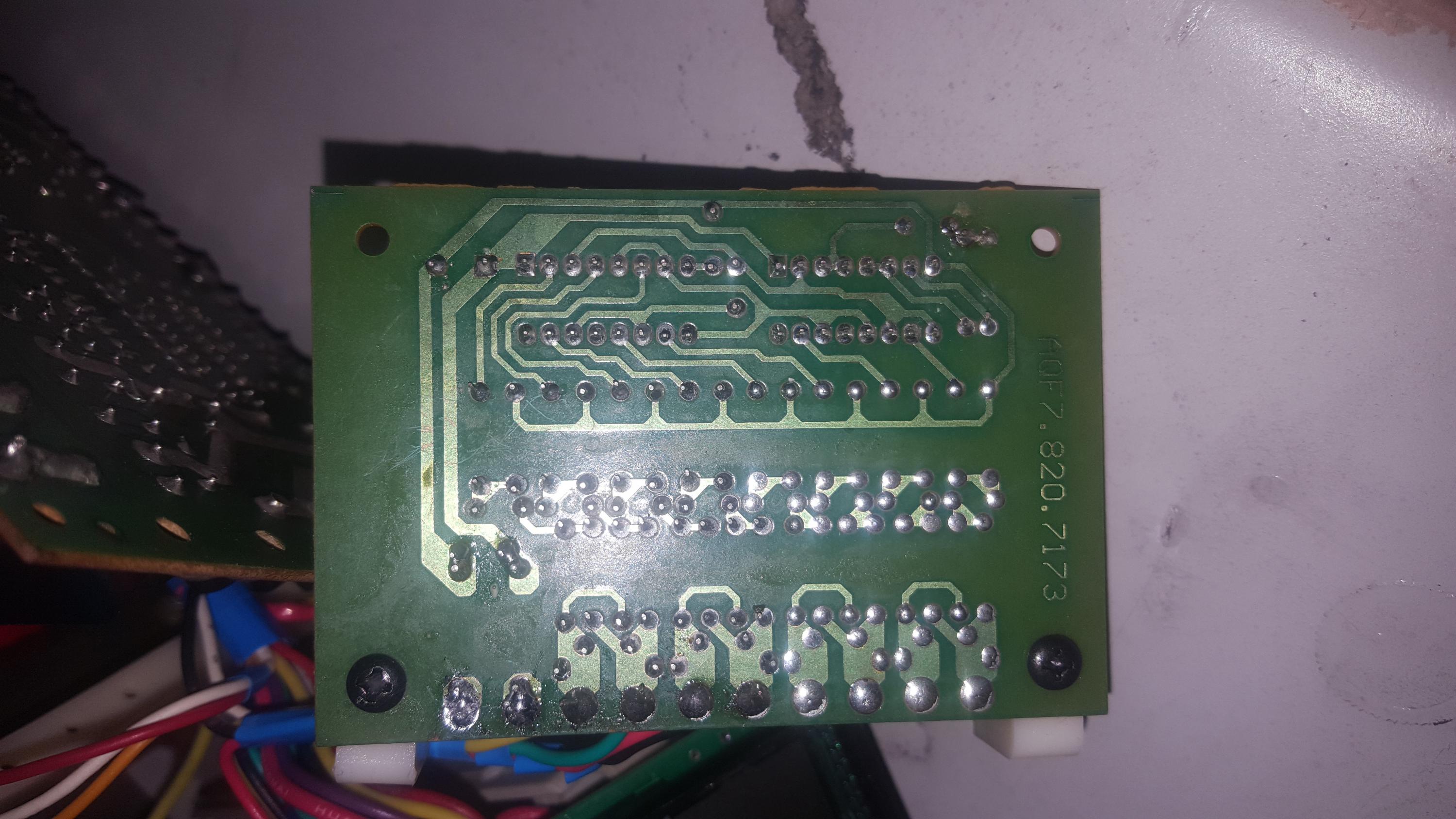

            @R_J no that 12V line come from Main board AQF7.820.7120 ,
            enclosed both board back side pics, i hook 12V external on AQF7.820.7173 and then it transfer 9V to LCD board and LCD IC show 9V also on pin-1 & pin-26 but it still show same error on LCD and seems this issue is not related to 9V, issue might be some where else,
            @sam Pin 37 have nothing connected, look at attached pic

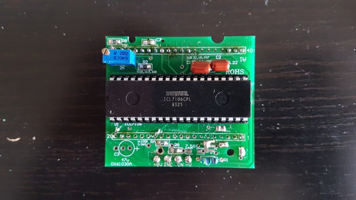

                        Can you remove the solder from PIN number ( # 37 ) and make sure that it is not touching copper trace and see what happens when you do this
                        IC is soldered inside of display board, mean in order to remove solder of IC i have to first remove LCD from board,
                              Thanks.
                              Those ic's are mounted in sockets, there is no need to unsolder them, they are likely just harder to remove due to the white stuff that was on the controls. You just need to pry them up slightly from each end.

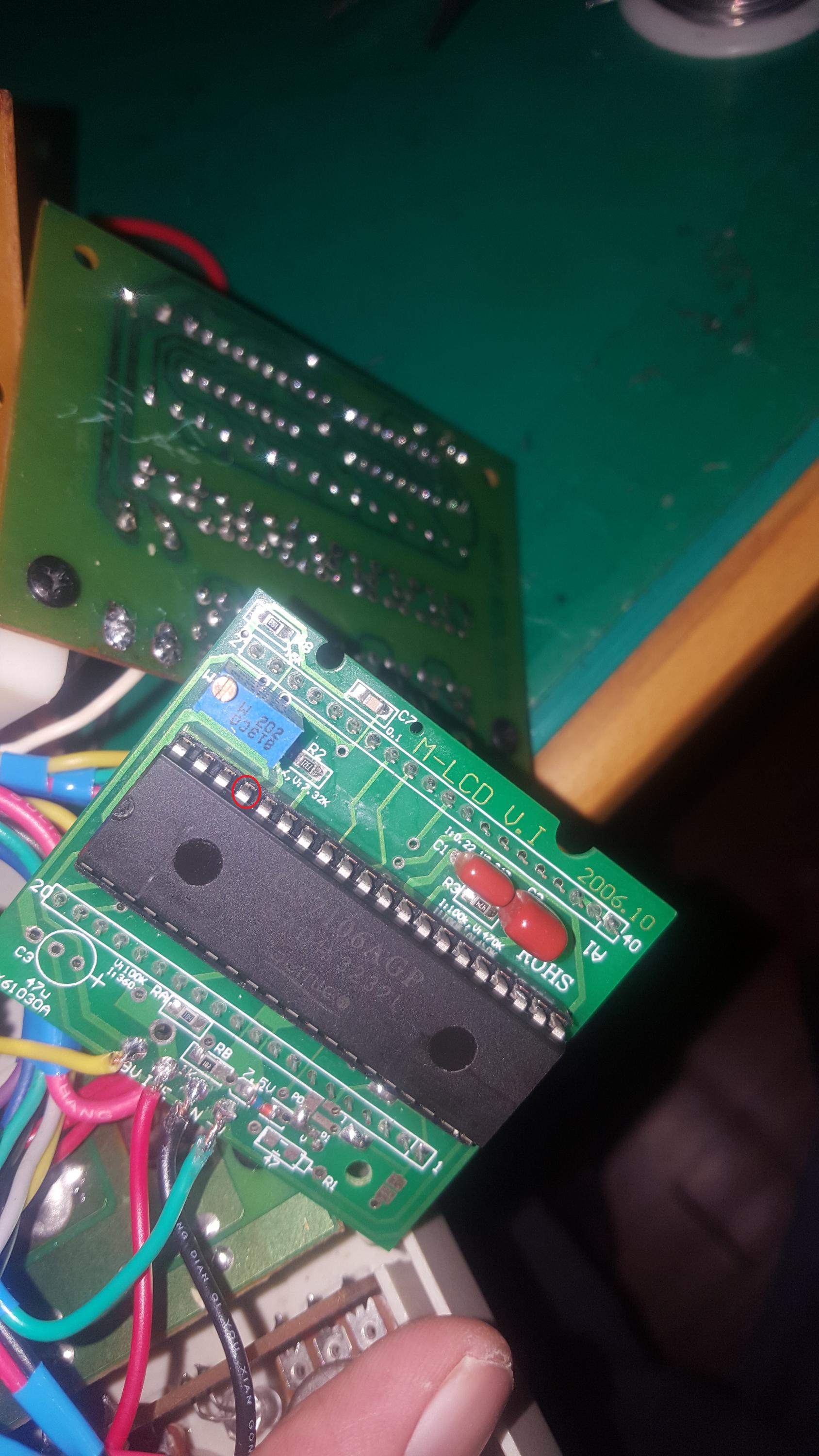

                                    @sam i had replace new Meter IC Chip on both display boards and nothing works, all same error it showing, i remove PIN number ( # 37 ) from IC and still same,
                                    i not removed LCD screen yet from board since it soldered, inside IC section is same how R_J show on Post #34 ,
                                    possible my both LCD have some problem?
                                    @eccerr0r i not remove LCD yet but my next step will be remove LCD and see if have anything backside of board,
