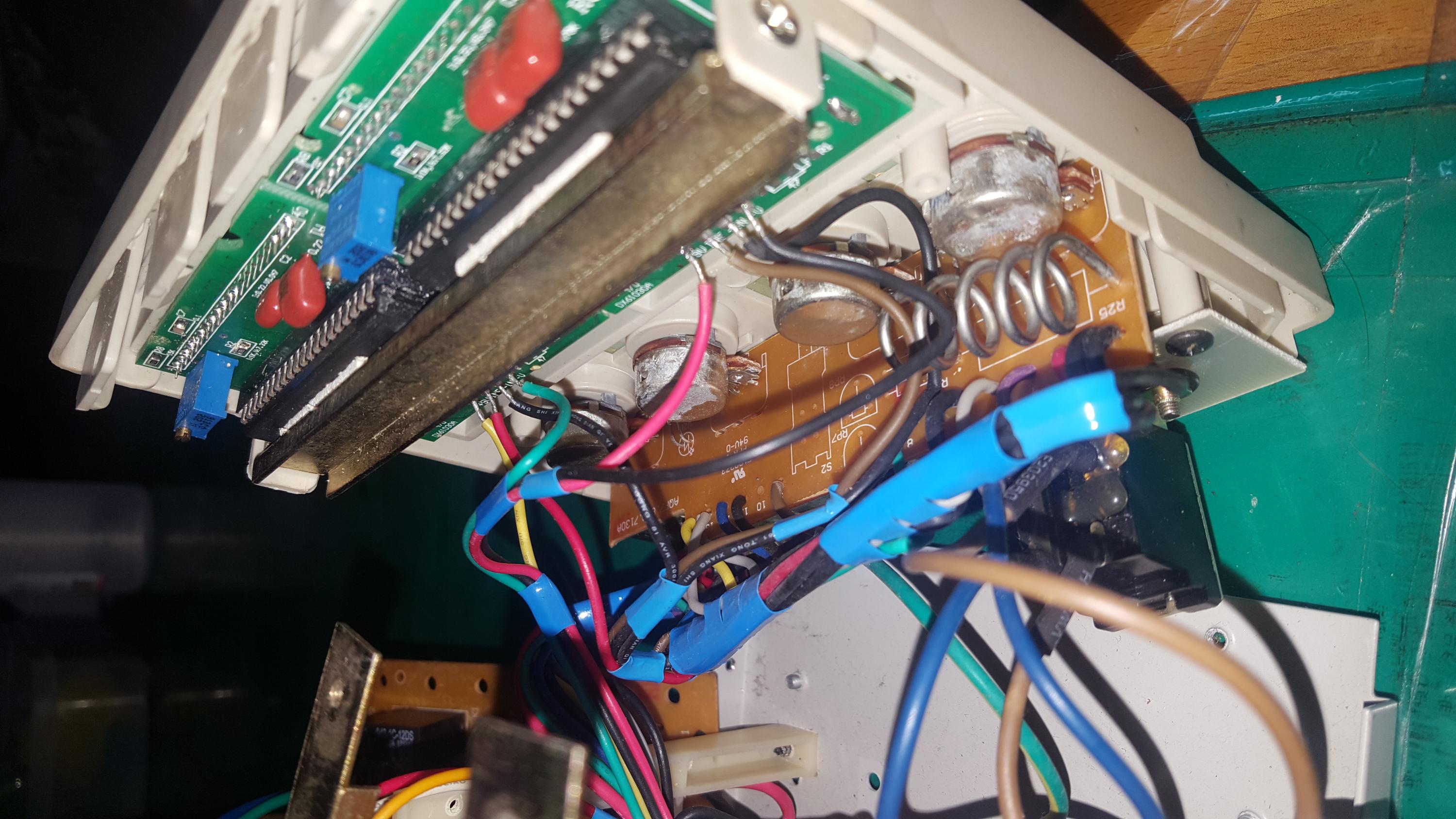

    Hello Folks,

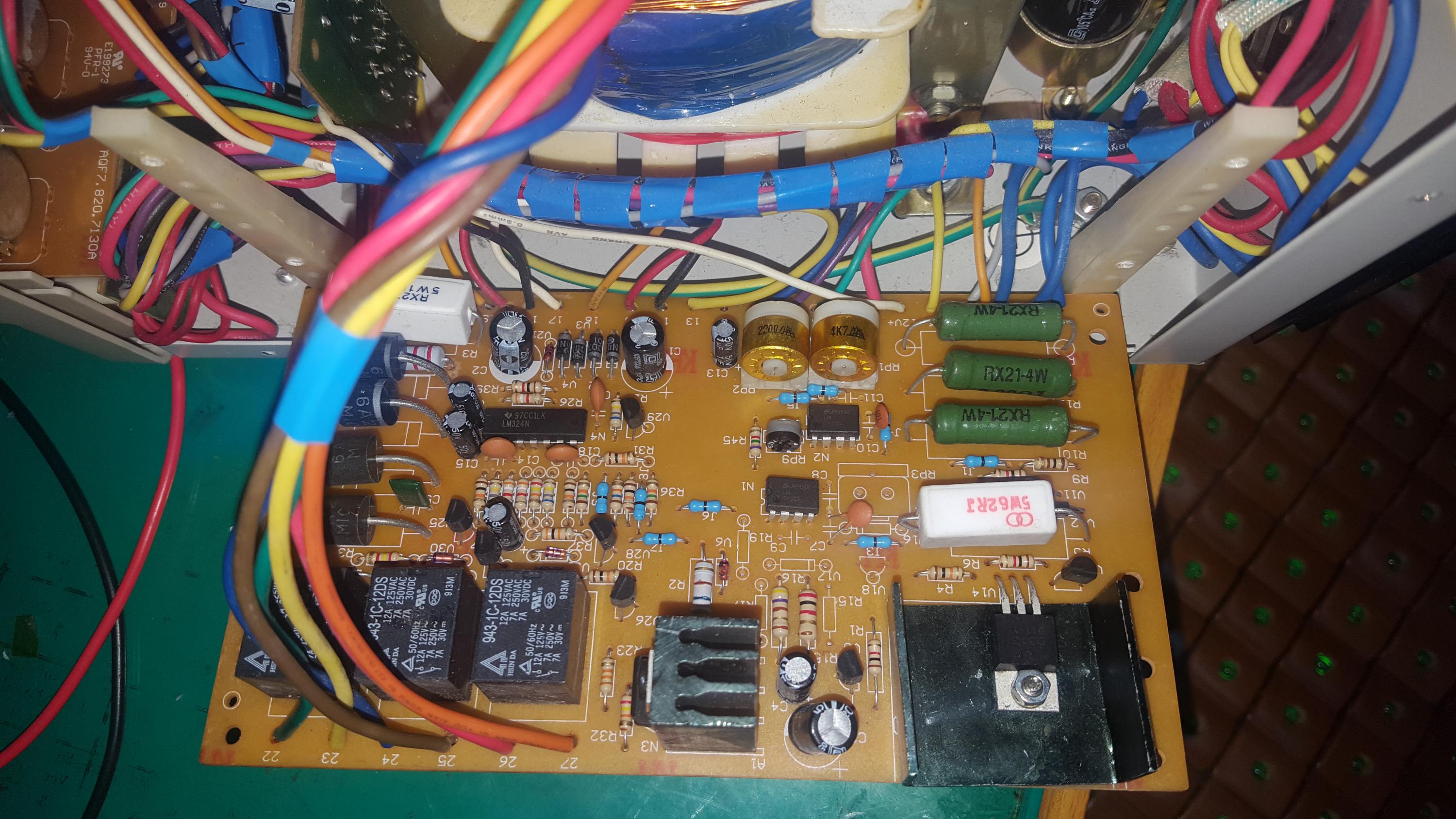

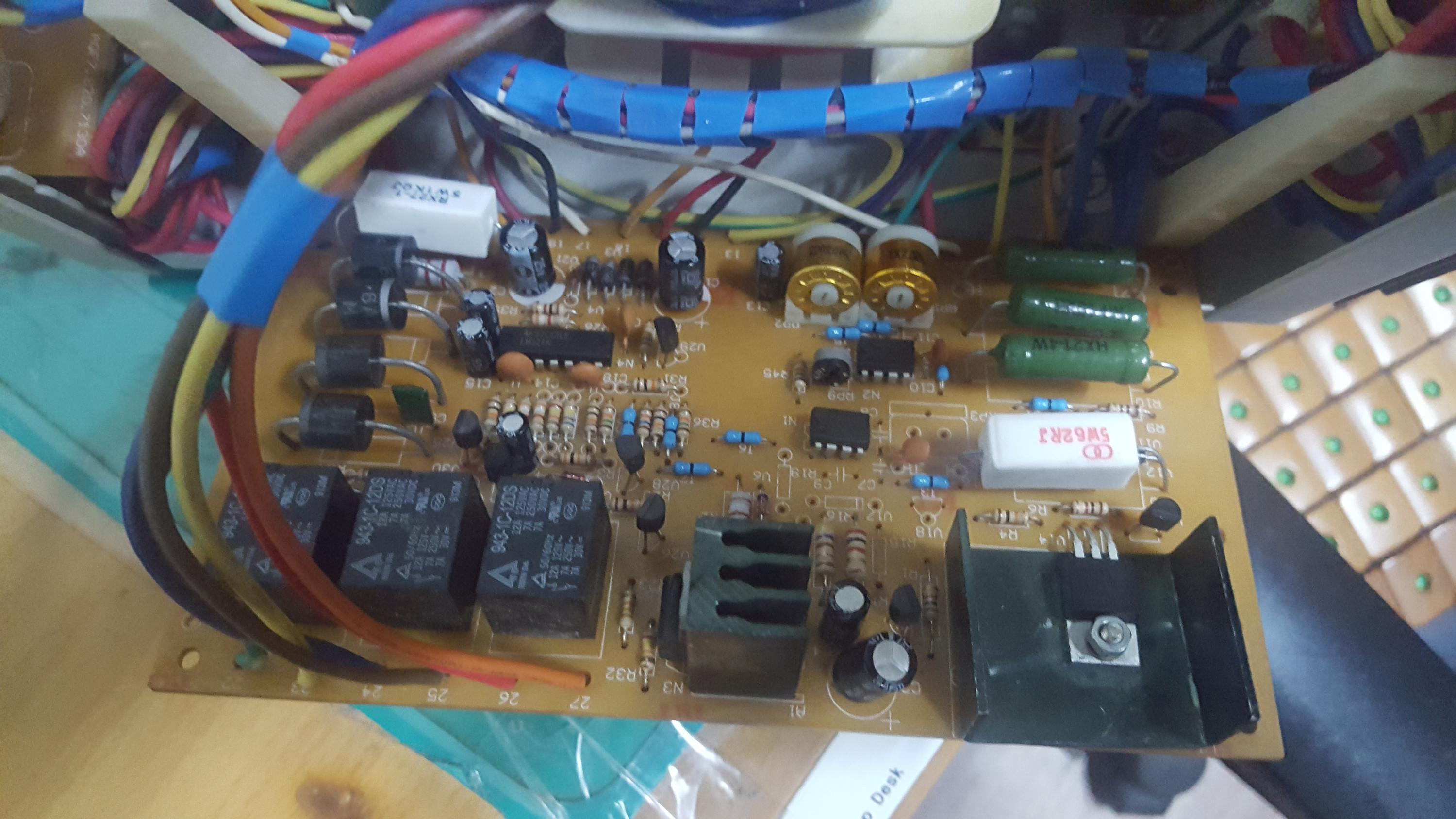

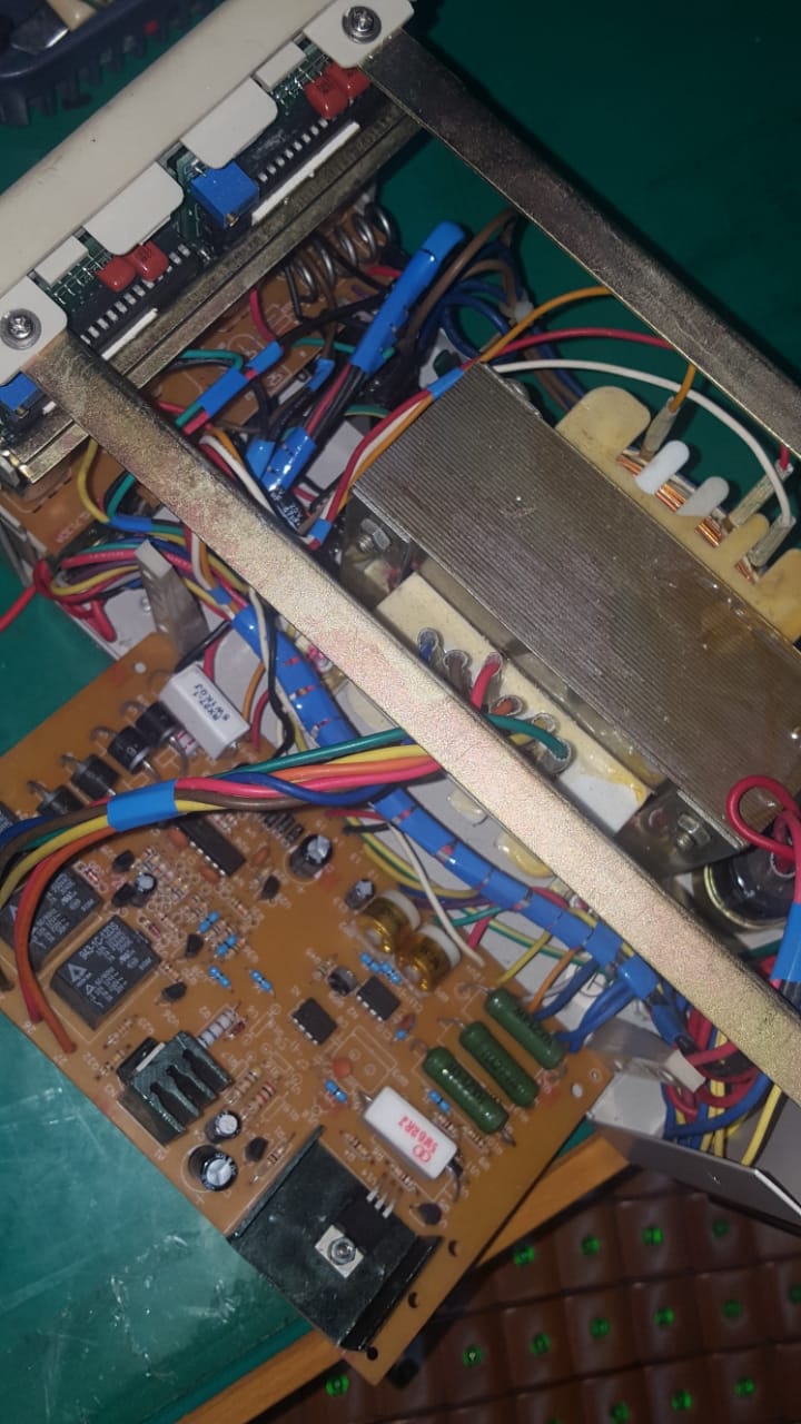

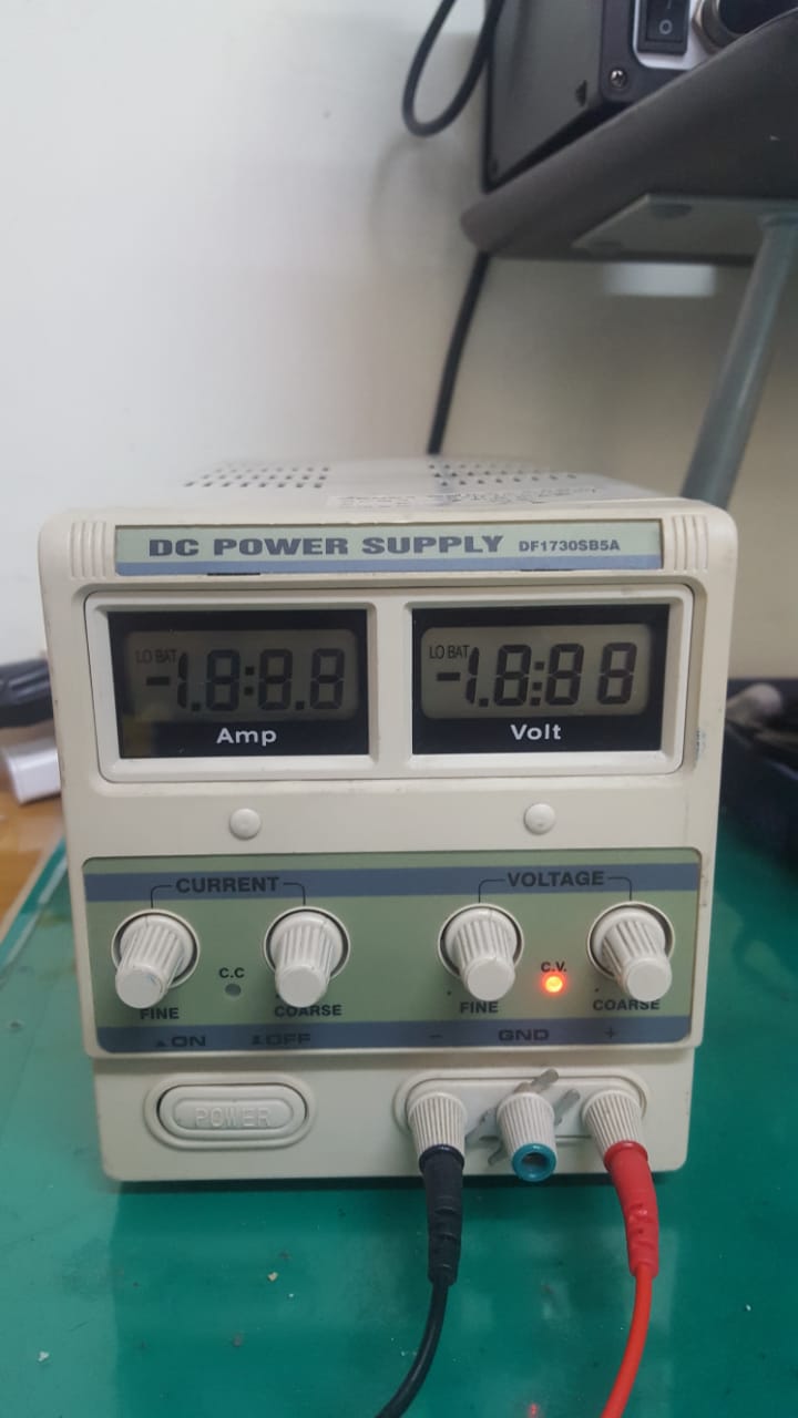

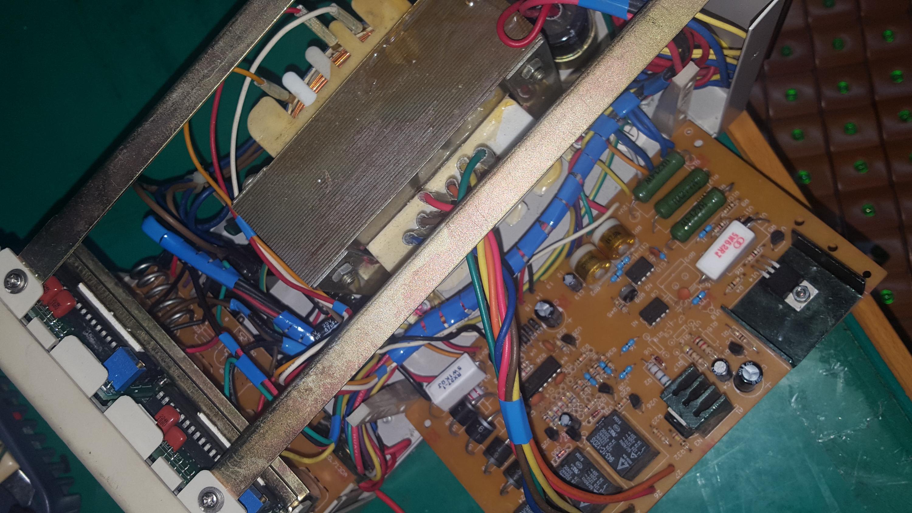

    i have one DC Power Supply (DF1730SB-5A), where power supplier is Programmable and i can adjust output voltage and it was working fine before one month, i had not use it for a while & last time when i power it on, it show on both LCD display VOLT/AMP (LO BAT -1.8:88) as show on attached pics, i can test out-put voltage with multi meter & it working fine, i can adjust volt, amp & put load and all working fine, seems like LCD display have some problem, both LCD show same error, i try to open power supply and check if any where short or any cap got shorten or burn but not found any thing with physical inspection,
    not sure where need to start to find fault & fix it, any help shall highly appreciated,

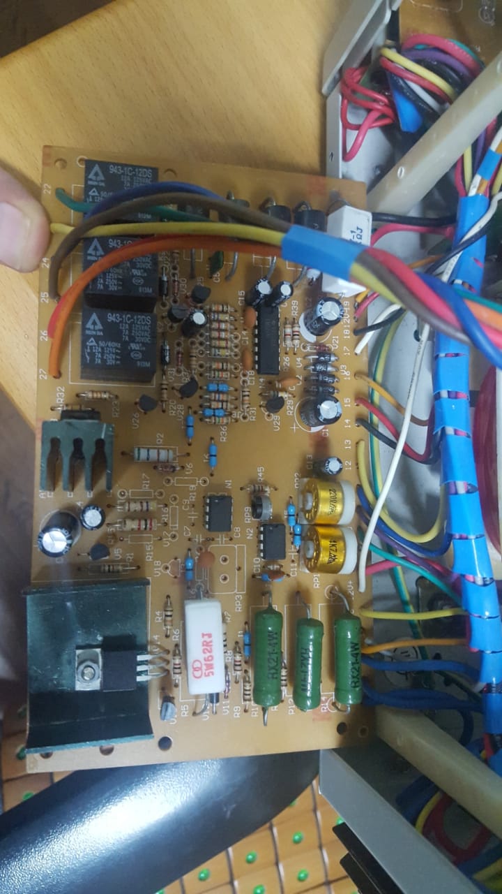

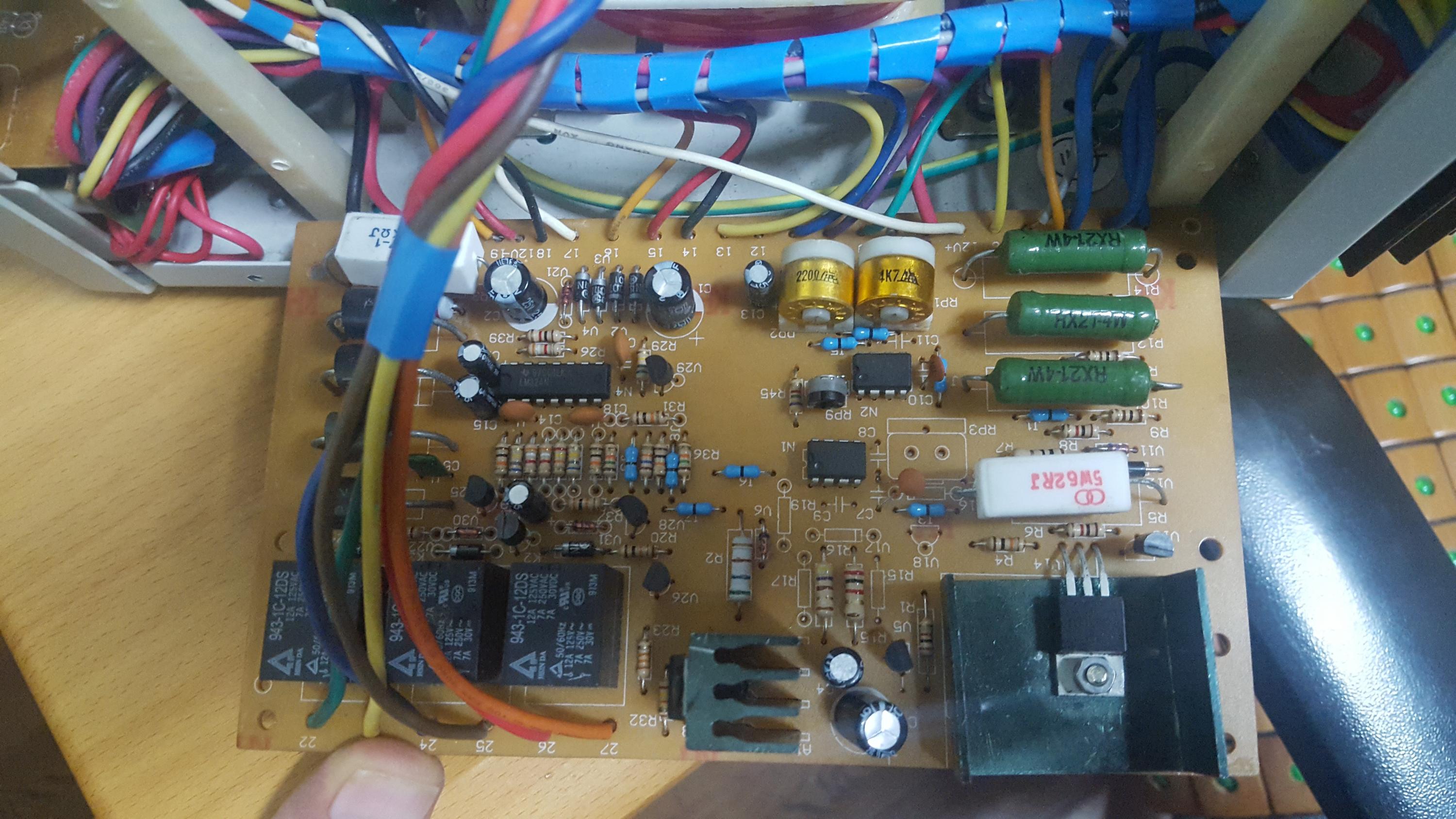

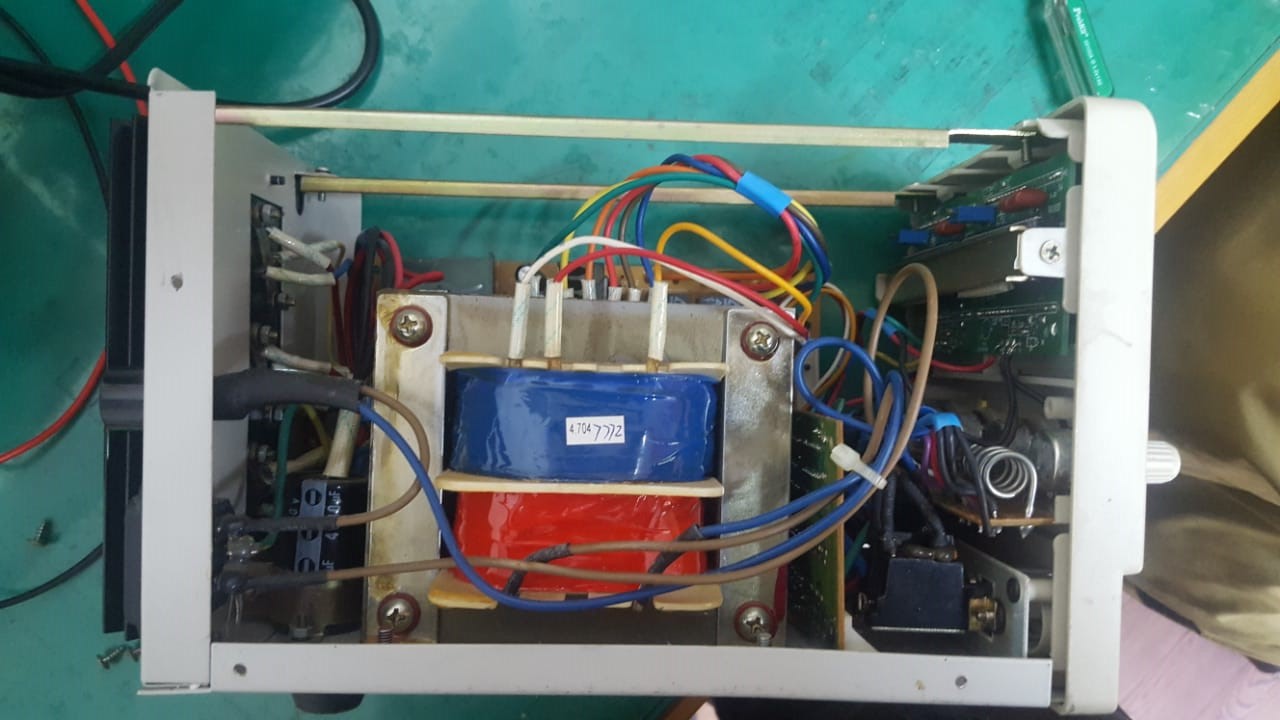

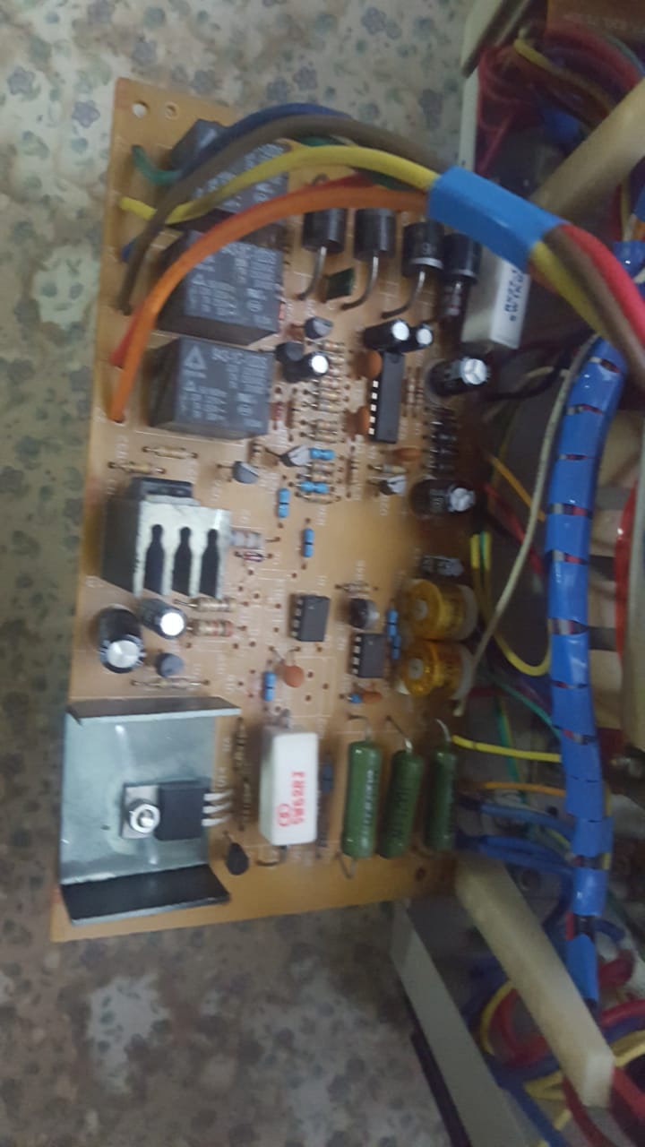

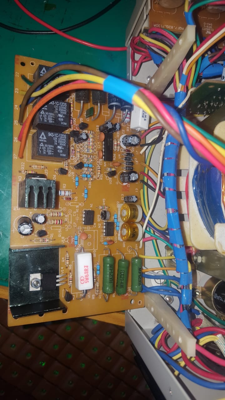

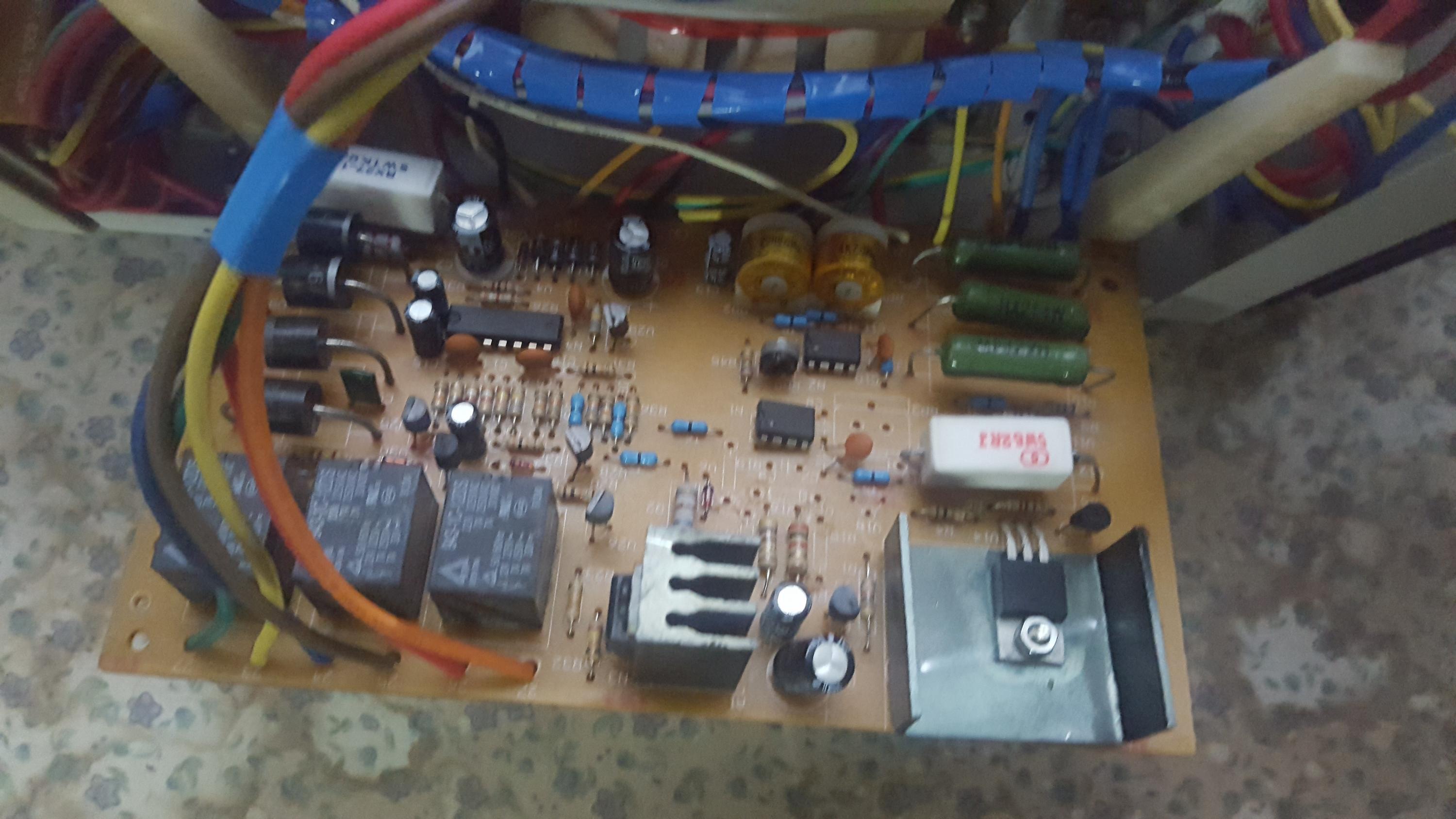

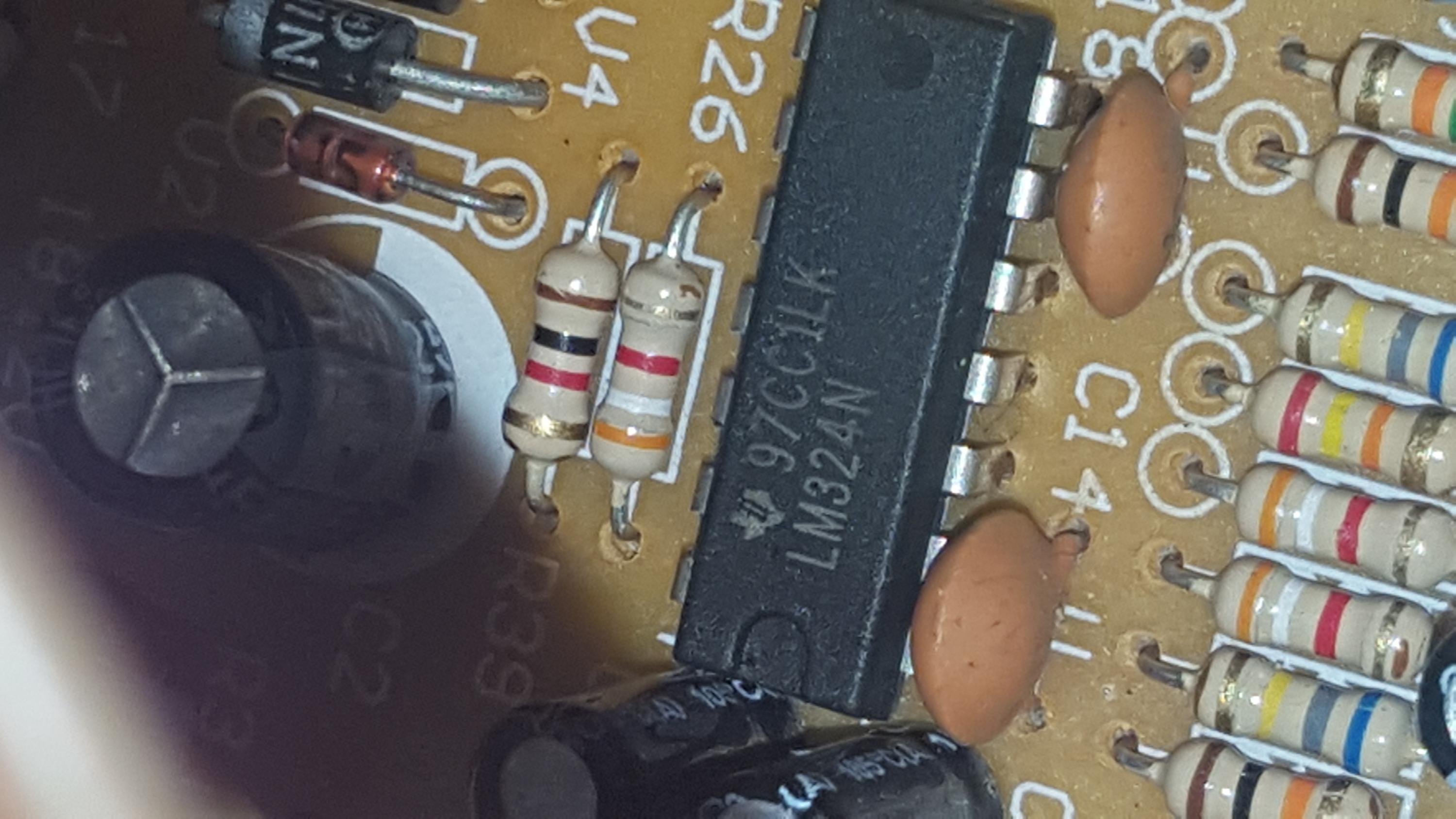

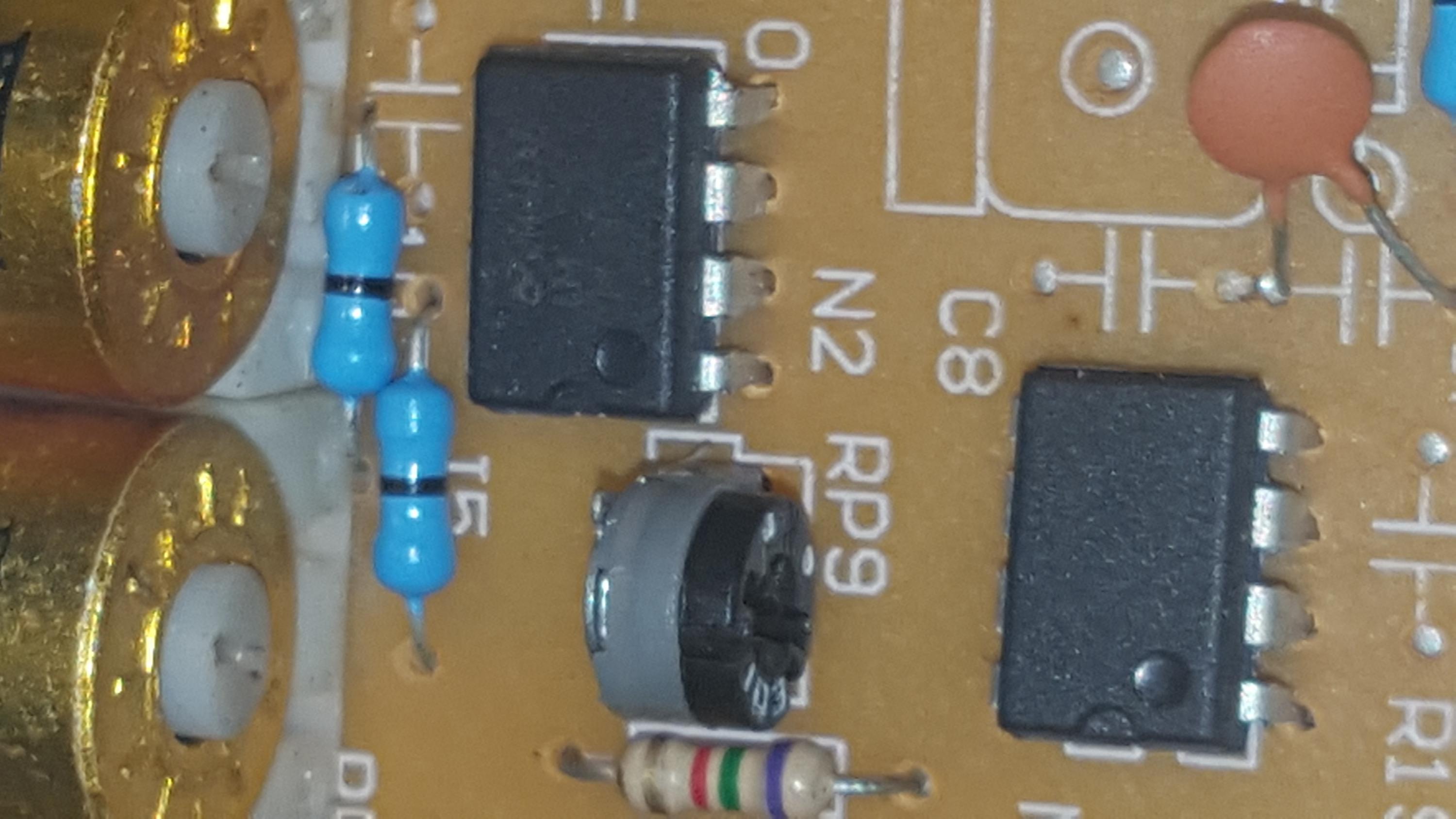

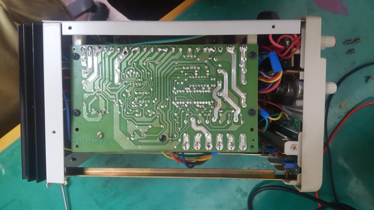

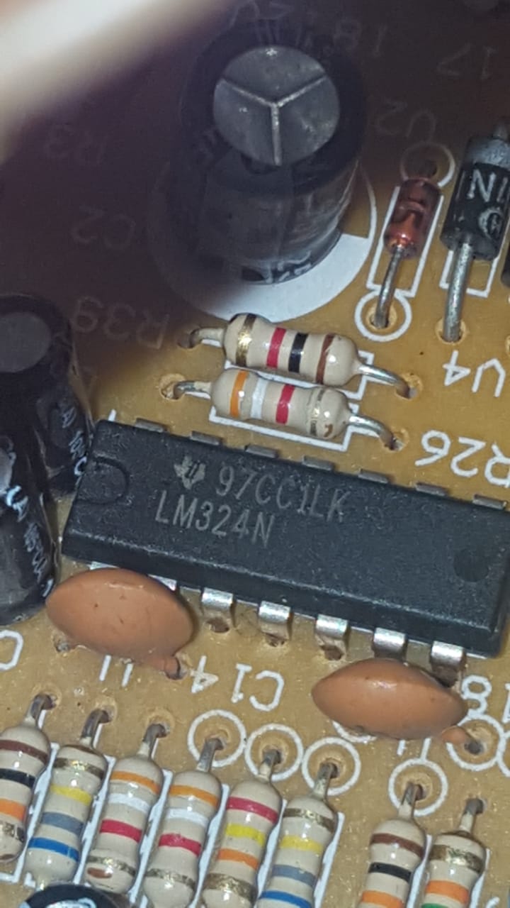

      Thank Sam for reply & help, i am not sure which ic chip that is doing the voltage and current measurements, i had take few more pictures of power supply board, seems like IC is N7CC1LK (LM324N) (Pic-6 in attachment)
      appreciated your further help to sort-out fault,

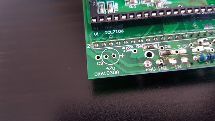

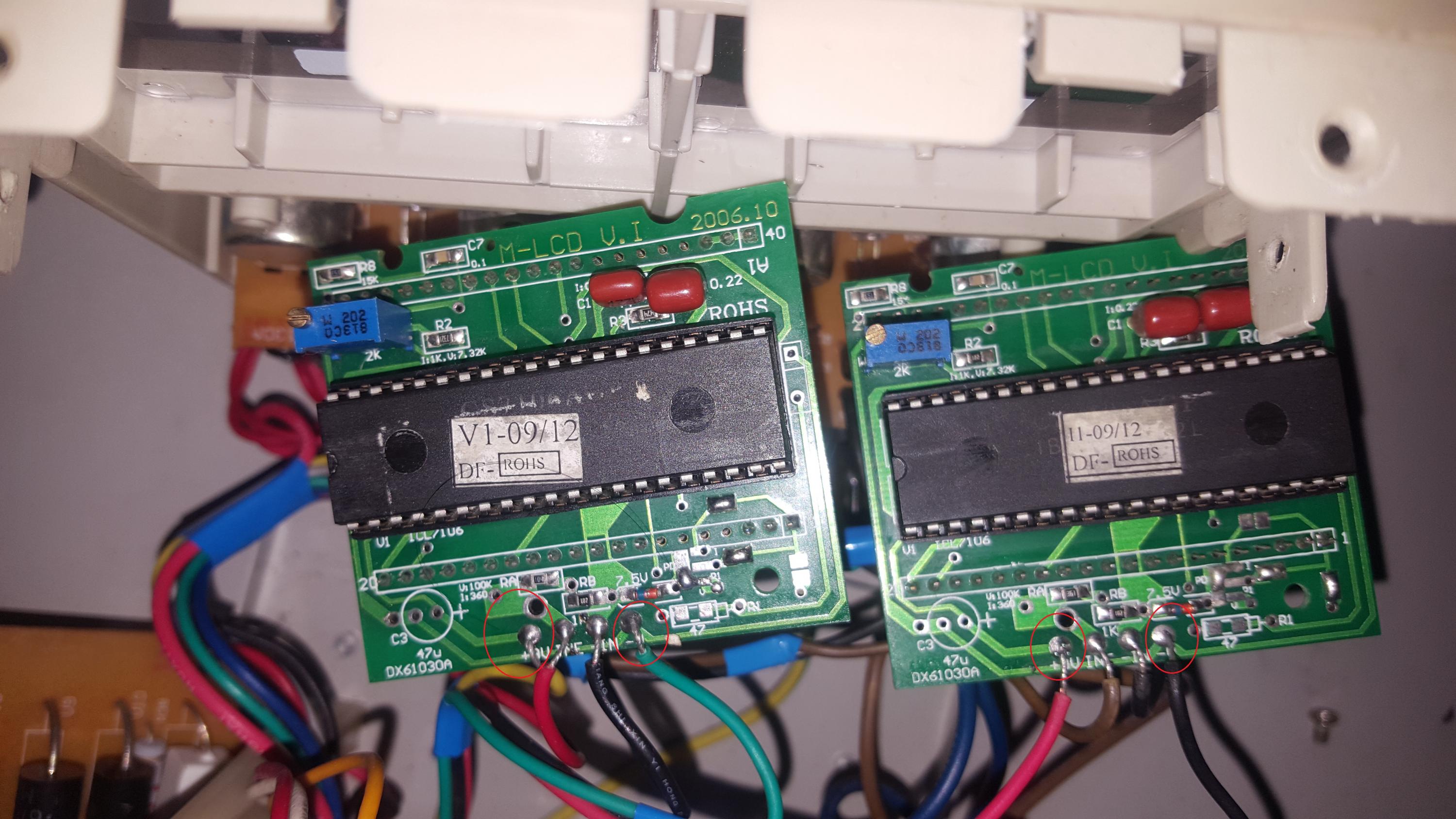

        I would think it is something that is common to both meter display boards, It looks like all segments are being turned on, including the LO BAT, Do the modules have numbers on them?

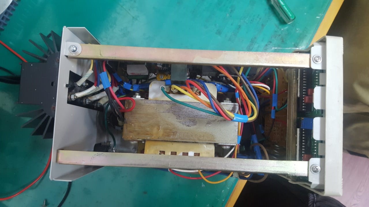

          i have update high resolution pictures in this post

            The LO BAT is just part of the display, likely not used in this case. The modules seem to be DX61030A with ICL7106 ic's?
            The power supply looks a bit water damaged (on controls) I suspect the display ic's may have some corrosion as well.

              those chipsockets are a writeoff,
              need a pair of machined-pin sockets and clean the chip legs with a small wire brush and some IPA

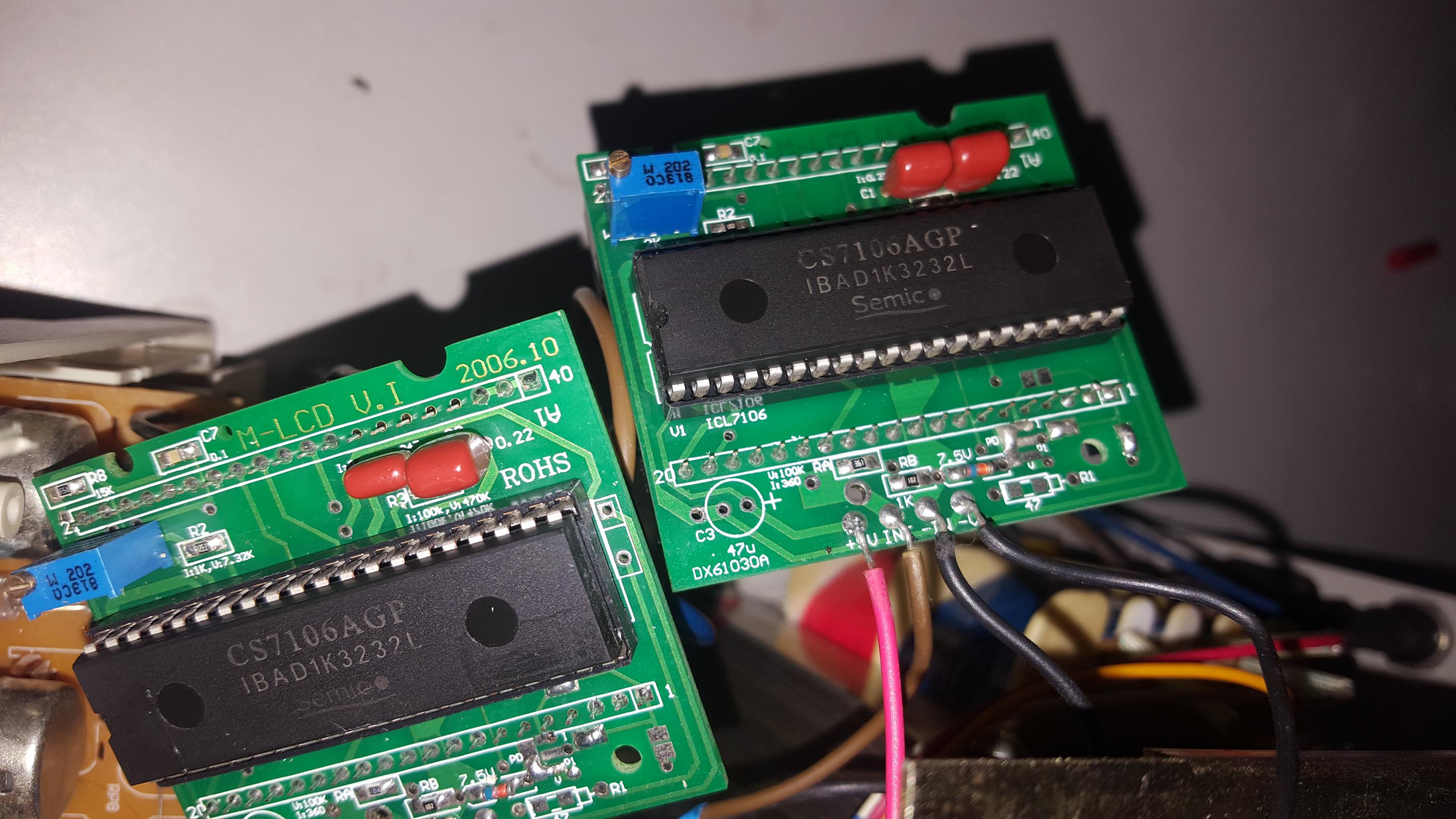

                What is the ic chip part number for meter display board there are two of them but I can read the number

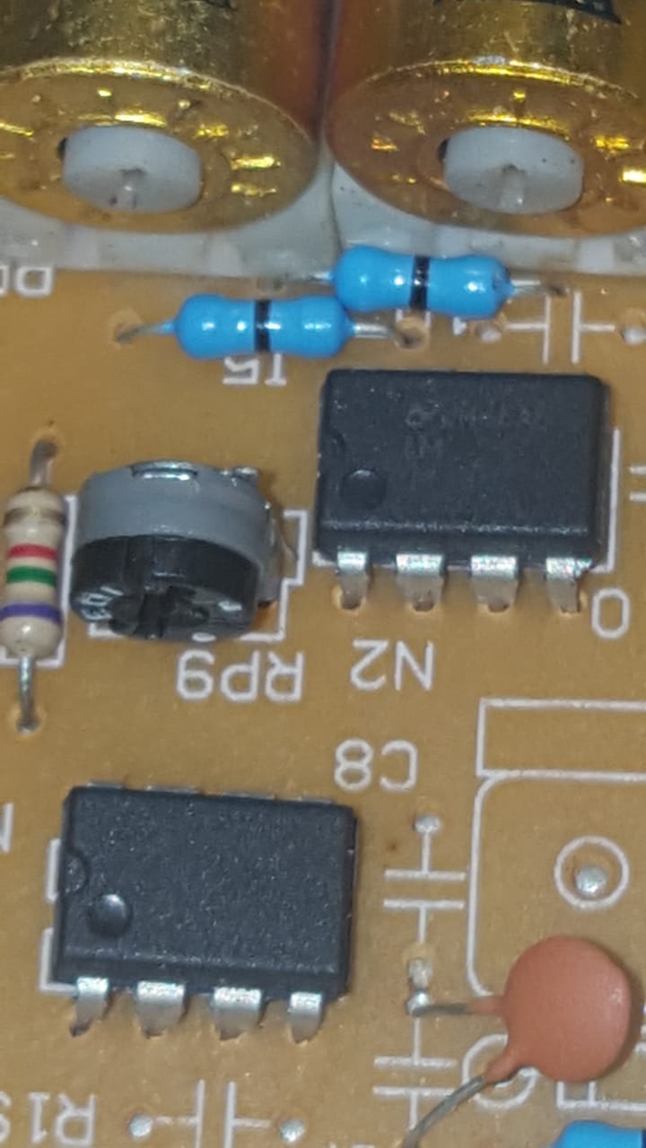

                  @R_J its not water damage, Taiwan is humidity place that's why it might looks like this but i had check all over the Power supply & it don't have any rust or corrosion included display section,
                  @stj i did clean all boards of power supply with IPA using brush but nothing seems working,
                  @sam enclosed close pic of meter display,

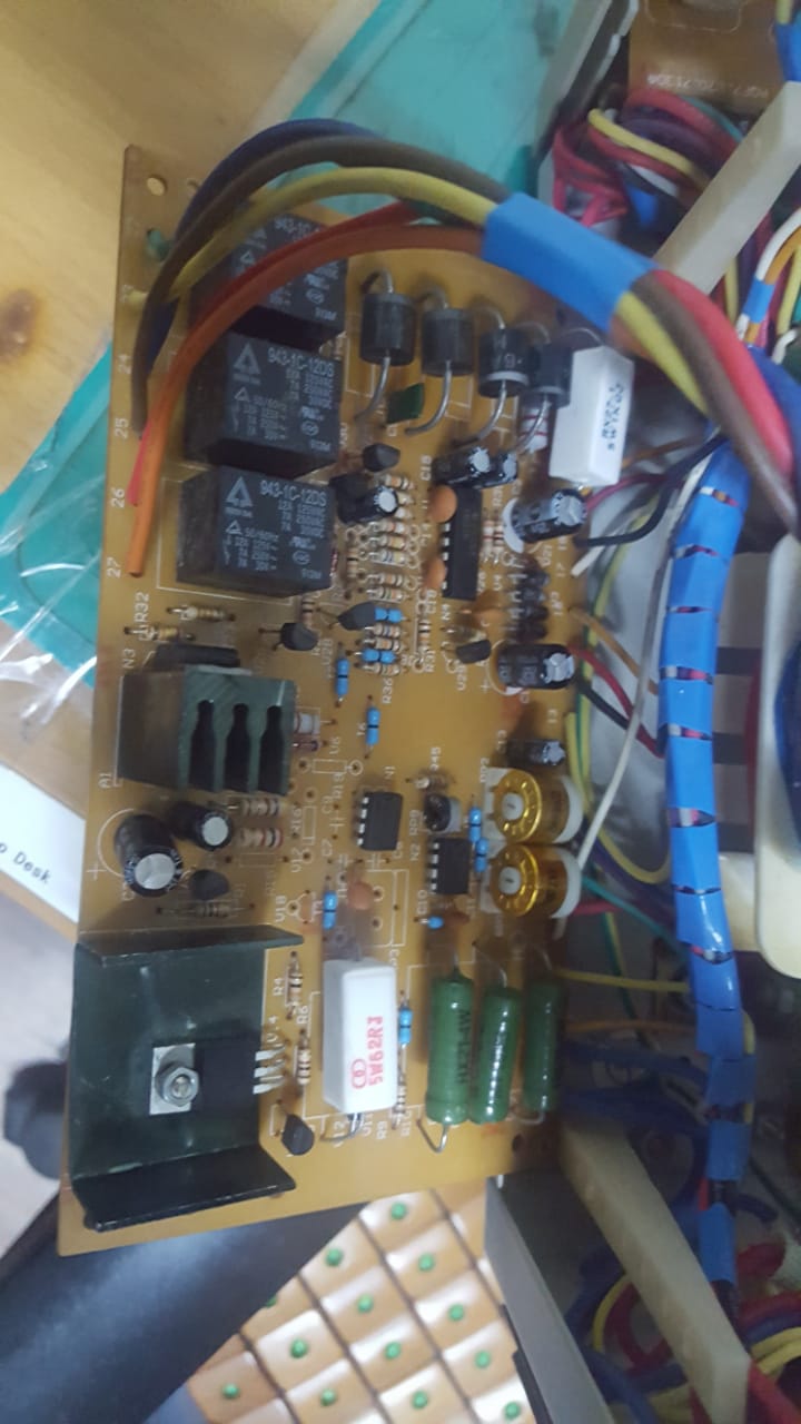

                  i suspect issue belong to 2nd enclosed pic since that board is connected to display section,
                  Display wire connected to second pic board as mark in red circle, if i disconnected any of those wires then display gone,

                    the chipsockets look like they are full of white stuff.

                      @sam IC Chip Part Number for meter display board is CS7106AGP (IBAD1K3232L) Semic
                      hope can get help from your side to sort-out issue,

                        I was just looking at this white discoloration on the pots. does'nt look normal to me.

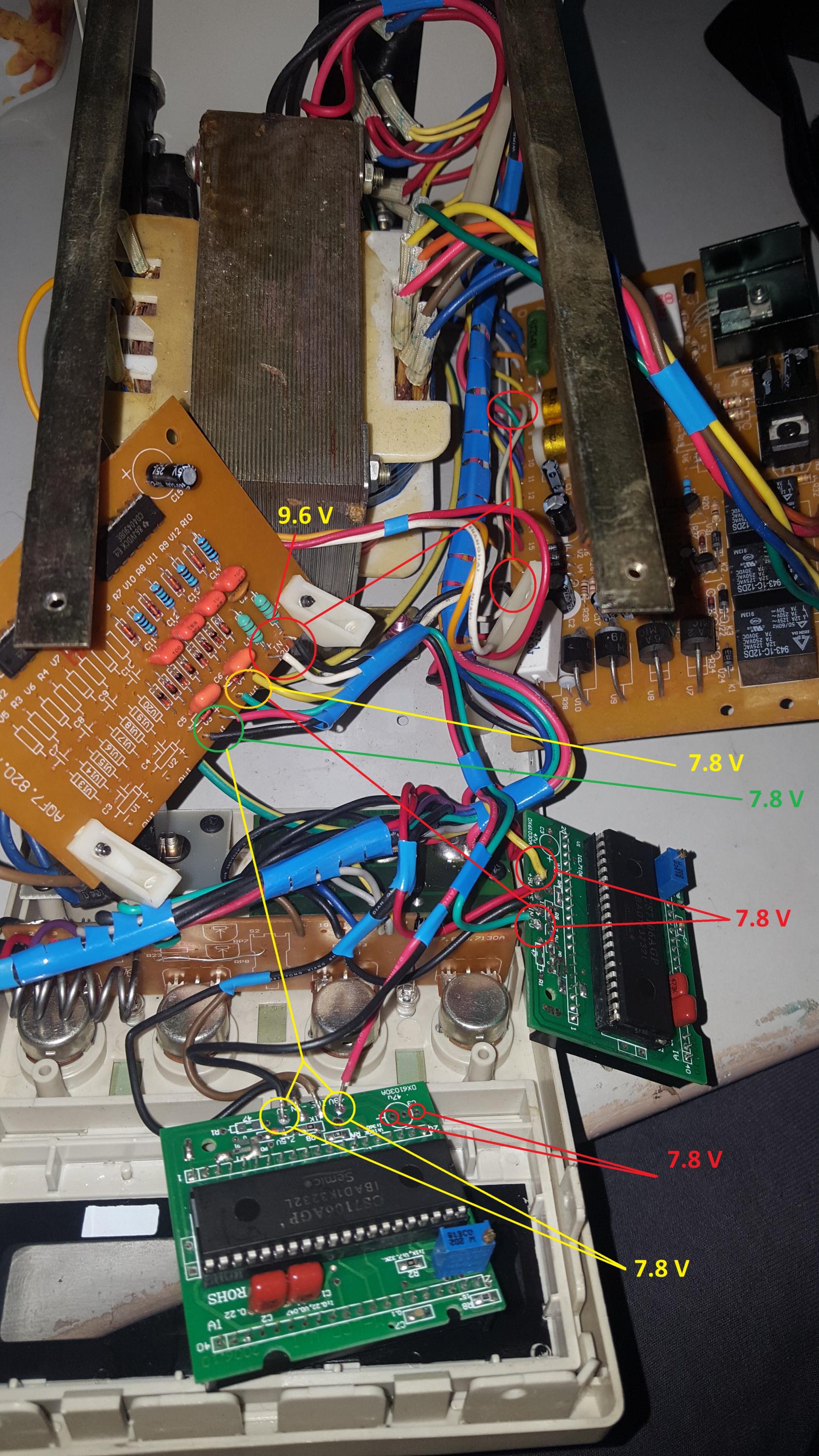

                        Did you ever check if you had proper voltage going to the lcd modules?

                            I believe it is 9 volts, It should be marked on the module (+9V) and (-) Measure it where C3 would be.

                                That voltage is on the input, There is a +9 Volt line that operates the ic

                                    Icl7106
                                    Look at section ( 5 )
                                    Some how it is in the test mode or the ic chip is damaged from something kind-a voltage spike or static electricity
                                    Look at the test pin ( 37 ) and see what it is hooked to this pin
                                    https://cdn.badcaps-static.com/pdfs/...ab8c44713c.pdf
                                    I have use these two meter module before ICL 7106 and the ICL 7107 both are covered in this data sheet
                                      Re: DC Power Supply (DF1730SB-5A) Programmable LCD Reading Problem
                                      Originally posted by Ali101 View Post
                                      on module it marked 7.5 V and i am getting around 7.6 V,
                                      No it has a 7.5 volt reference voltage for the ic chip
                                      Look at the voltage on PIN number ( 1 ) and ( 26 ) you should have 9 volts
                                      Is that Zener diode across the two pins if so then they doing it for a stable power supply
                                      This might be the low battery warning reference if you were running of a battery or used for something else
                                      ( Look at both Figure 7-1 [ A and B ] to see which set you have for the reference voltage and check to see if you have that voltage if it has a Zener diode ) if not then your voltage reference will 100 mill-volt and is adjustable ve-a trim pot

                                        @R_J it given me 7.8 V on C3 because it getting same voltages from back board,
                                        @Sam, i checked voltage on PIN number ( 1 ) and ( 26 ) and it given me same voltages, 7.8 V , Pin 35 (V Ref -) & Pin 36 (V red +) given me 0.98 V ,
                                        look at attach pic,
