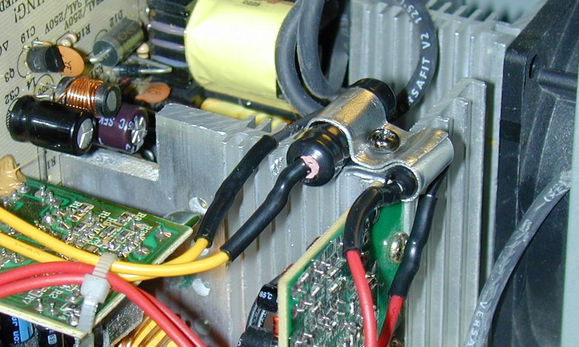

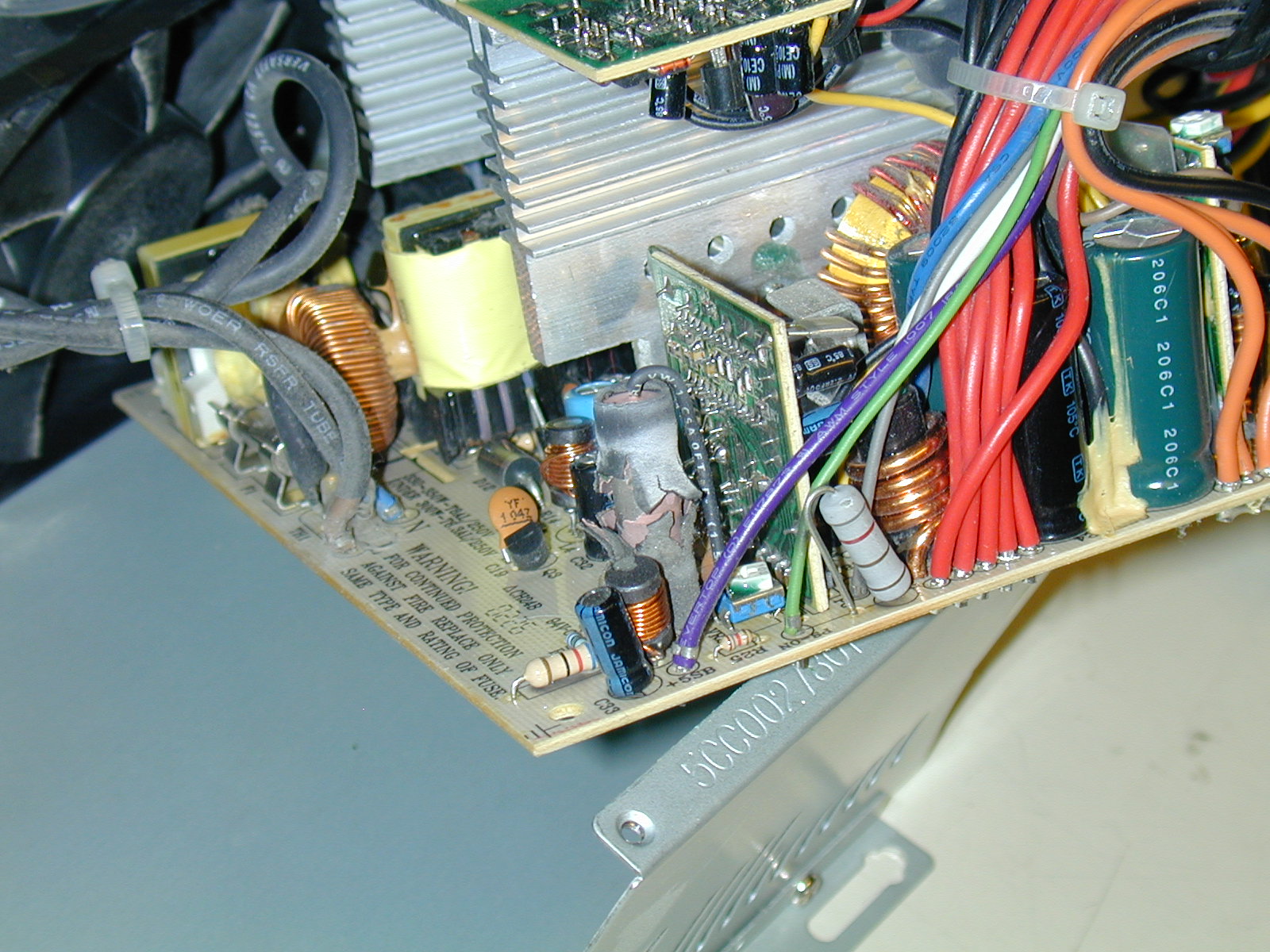

    Ran across this FSP300-60BTV. Won't always power on when connected to a mainboard (D845EBT). Replaced it and computer works fine with another PS.
    Opened the FSP and saw this (see pics). Looks like a big resistor with heat shrink on it. With age or heat or both, the tubing split and took the enamel with it. I don't know if this is the PSs problem or if it is just cosmetic. The resistor measures 7.5 Ohms. Since the enamel is gone I don't know what the value is supposed to be.
    What do you think?
    Caps look fine, BTW.

    See what it's connected to. Most likely it's a loading resistor for one of the rails.
    The resistor next to the gray (PG) wire seems to have been running hot as well. Probably another load resistor again. Make sure it's not touching the case when it's closed as the enamel seems a bit chipped on that one too.
    Perhaps if they really are load resistors, maybe they're providing some type of quick minimum load for the PSU to start. But again, see what they're connected to.
    Also, have you checked the caps? Check the 5vsb voltage too.

      maybe that just a load resistor for +5V rail. on some 300-400W FSP, i just remove them. they can be destructive to the component nearside it.
      like momaka said, recheck again. and be aware of minimum load issue if you remove it.

          Without the big resistor, voltages measure:
          12@10.9-11.0, 5@5.25, 3.3@3.47
          12 is very low, others a little high
          without the smaller resistor, won't power on. even with a load on 3.3 or 5 externally.
          WITH both resistors, power on fine, voltages better. 11.65, 5.01, 3.46
          Both get darned hot. might need to relocate them away from other parts and wires, maybe onto a heatsink.
          +5vsb runs at 3.46.
          The dummy load I have only loads +5 and +12.
          I think all my messing with it, desolder/resolder, may have taken care of the original problem. There was a questionable joint on the smaller resistor. Now I wonder about that 5vsb.

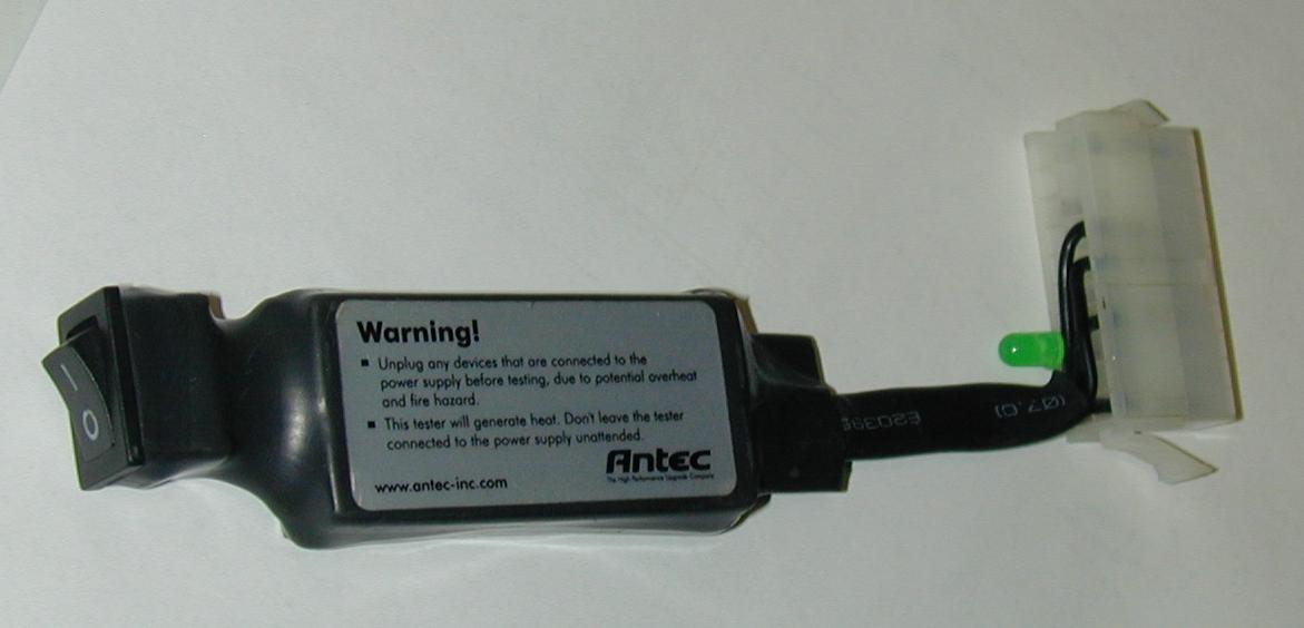

                      The dummy load is an old antec load with PG switch. It's got a couple of big resistors on +5 and +12.
                      Here's a pic...

                        We use that same psu tester in my computer tech class. It only puts like a 10W load on each rail. Not enough.

                          40 Ohm on +12, 10 Ohm on +5.
                          OK.
                          The answer is always... MORE POWER!
                          This thing has always been sufficient in the past.... why would it not be now?

                            Its really only designed to just be enough to get past any minimum load requirements on power supplies, which are typically 1A on each rail, and really only on cheaper, older psu's.
                            These older psu's are not designed to really work under anything less than about 50W.

                              On the 60GT, I plugged up 4 HDs in addition to the dummy. Voltages are pretty normal. 11.9, 5.1, 3.4, -11.8, -5, 5.02vsb
                              Thanks.
                              I'm going to explore modifying that switch with more load and on other rails.
                              Now back to the 3.45vsb on the 60BTV. Hmmm.

                                  Alrighty, then! I moved and mounted those resistors to a heatsink where the fan can cool them and are away from wires and things. (see pic)
                                  I poked around some more... following the 5vsb traces... replaced a cap that looked fine but failed ESR. <YEC> 470uF 16v SH105C
                                  5vsb is now at 5.12.
                                  I'm a little concerned that 3.3 is at 3.51 but I don't have a load on that rail.
                                  I don't need this PS. I was using it for experience. And now I have it too.
                                  This may be trivial to you guys but it's another valuable lesson and gives me a needed feel-good-satisfaction in an otherwise frustrating work day.
