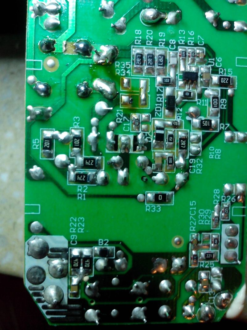

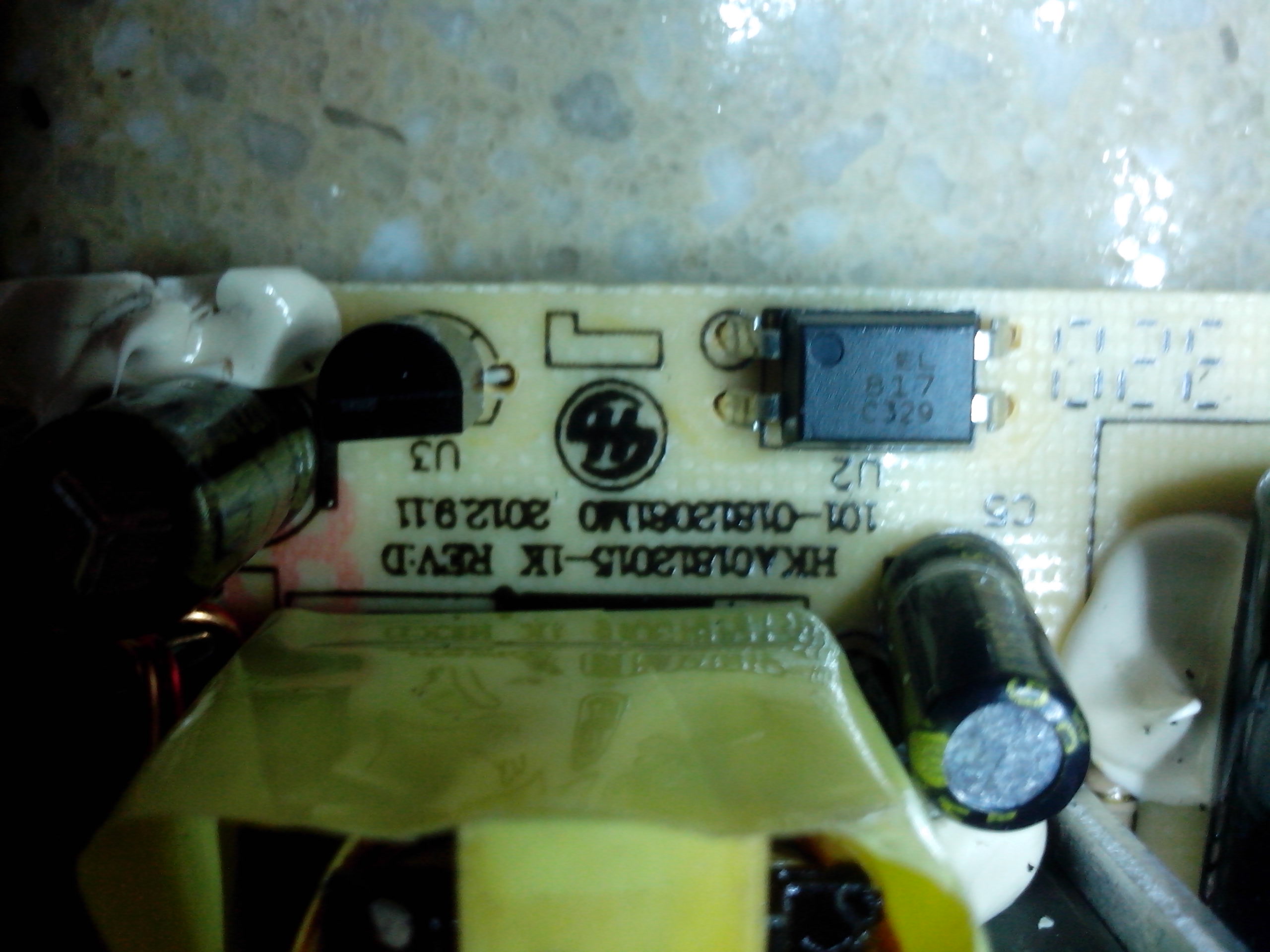

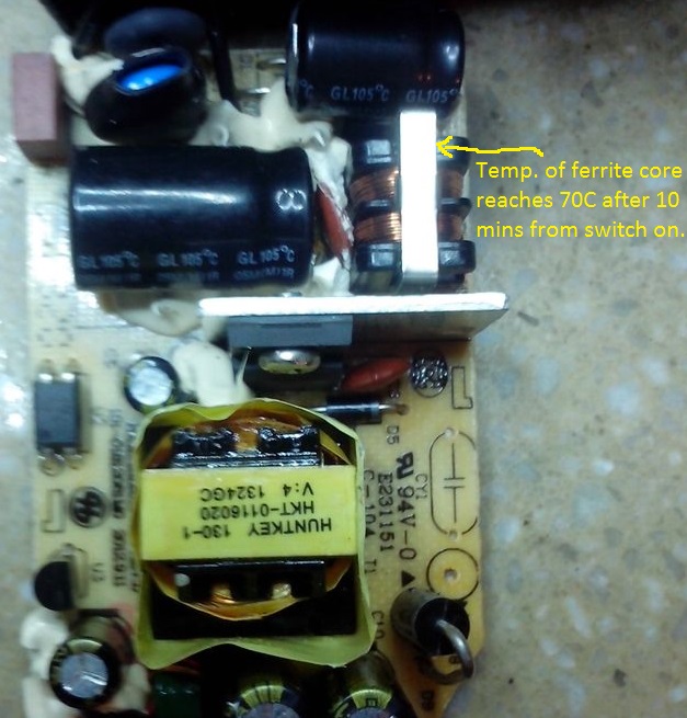

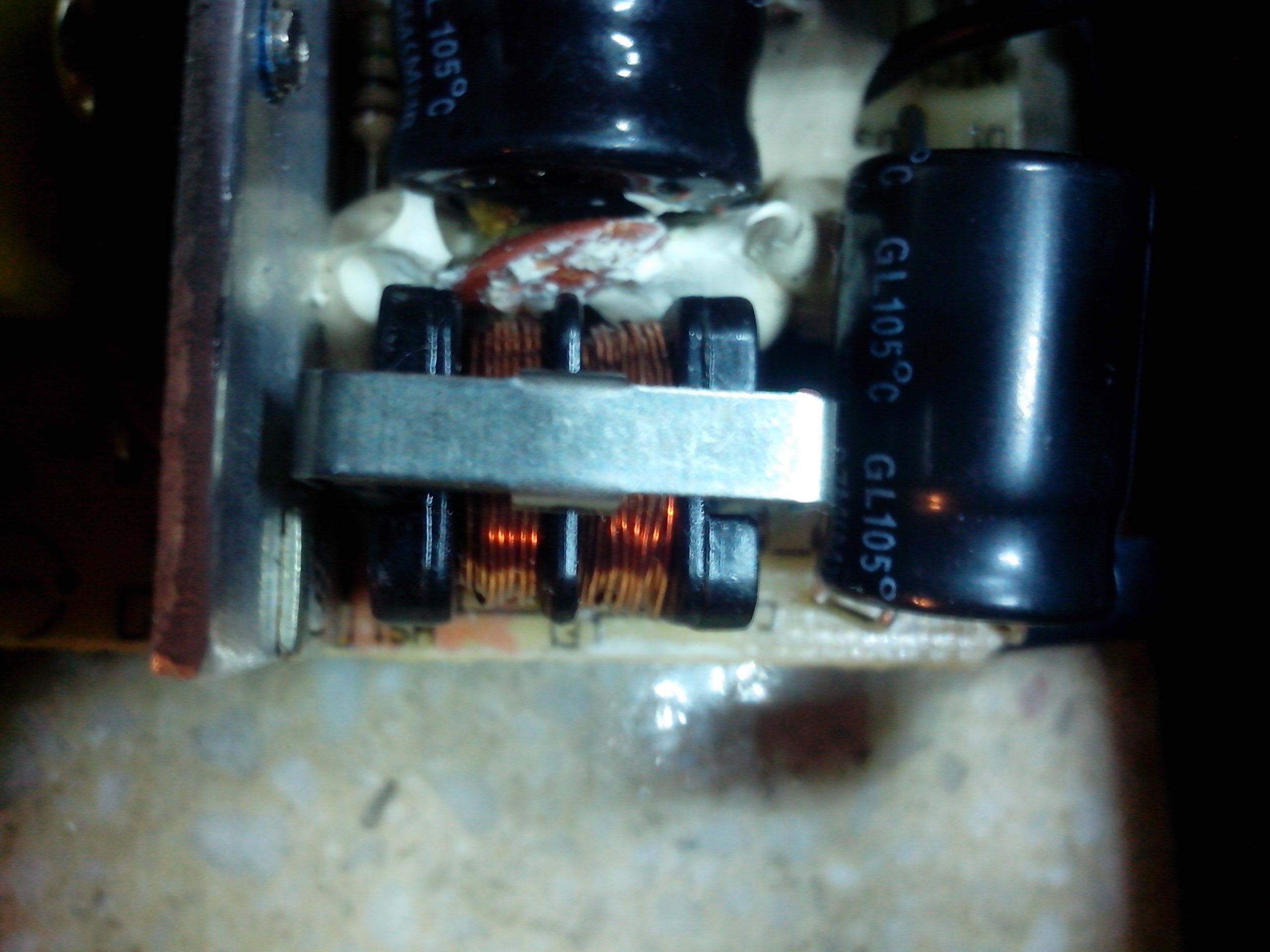

    This 12V, 1.5A 240V mains adaptor is being used to power an adsl modem router. Usually it runs quite cool when it changed and I noticed the case was getting excessively hot.
    Opening the case revealed the mains input filter inductor is getting far too hot. I replaced it. The replacement also gets hot but not as hot, it reaches 70C after being on for 10 mins supplying 0.7A (cools down off load) - this is with the case open. See attached images.
    I don't know how hot is normal for this inductor, please anyone with experience I would value your opinion.
    The mains input circuit is a bit unusual in that bridge rectifier diodes are connected directly to the mains input. Output from the rectifier feeds the inductor coils. Most PSU's I've seen have the rectifier after this inductor. There are two reservoir caps one connected to the output of the bridge rectifier the second on the output of the inductor coils.
    As I'm writing this a thought comes to mind if the bridge rectifier reservoir capacitor is open circuit then all the ripple current will be flowing through the inductor coils to the second reservoir capacitor connected to the output of the inductor coils, it might explain the heat. Anyway I'll post this to see what your thoughts are.

    Re: 12V, 1.5A PSU Adaptor Inductor Overheating
    Update:
    Replacing the reservoir cap connected to the bridge rectifier has not reduced the temperature of the inductor.
              Is the first capacitor placed before the inductor?
              The cap on the input (output of the bridge rectifier) to the inductor coils is 10uF 400V the output of the filter has a cap of 22uF 400V.
              That inductor is made for AC (230V). If it is placed after the main capacitor or after the bridge rectifier then it will work with rectified DC (400V DC).
                  Usually the choke is placed before the bridge rectifier:
                  It looks like, in your case, it is placed after the bridge rectifier. You can remove it and bypass with a pair of fuses/wires.
                  Do not worry too much about removing it: this power supply is a flyback switching power supply and the ripple on the secondary will be quite high regardless. And this design lacks some components (the blue capacitor, ceramic, at CY1).

                            The mains input current is 0.037A (not true rms meter) = ~9W.
                            The output load is 0.67A @ 11.78V = ~8W.
                            Looking at the efficeincy it appears quite good. Which makes me wonder if the circuit is funcitoning correctly now the choke is replaced.
                            How hot would you expect the choke to get given this load?

                                    If the CM choke has say 0.4V across each winding that is say 1 ohm, then it's around 0.32W it is dissipating and I would not expect it to get way hot. Manufactures will sometimes stuff in the highest value mH (but high DCR) to ensure the device passes EMC tests.
                                    But you say it's changed so the only thing left I can think of is the SMPS transformer could be saturating? It might be from mains going up from say 230VAC to 250VAC. You could try a variac with a little lower mains.
                                    edit: It's a current-mode controller after spotting R18,R19,R20 2R7.

                                      It did significantly change. On opening the case the original choke had obviously overheated and was getting hotter than 70C but I didn't measure that - I just replaced it.
                                      I'm wondering if in this design the choke always ran hot could it have broken down and seriously overheated.
                                      I don't know normally how hot the choke gets with this design, which makes me wonder if 70C is normal. That's what I was hoping someone could give an opinion on.

                                        With psu reassembled and original modem load the case temperature is warm but not hot. The CM choke must have always been running hot and with time destroyed itself.
                                        To minimise this recurring I shall unwind half the turns from each coil of the choke.
                                        A big thank you to every-one who contributed to this Sherlock Holmes story. I have learnt much about the switch mode psu and the willingness of others to help solve problems.
