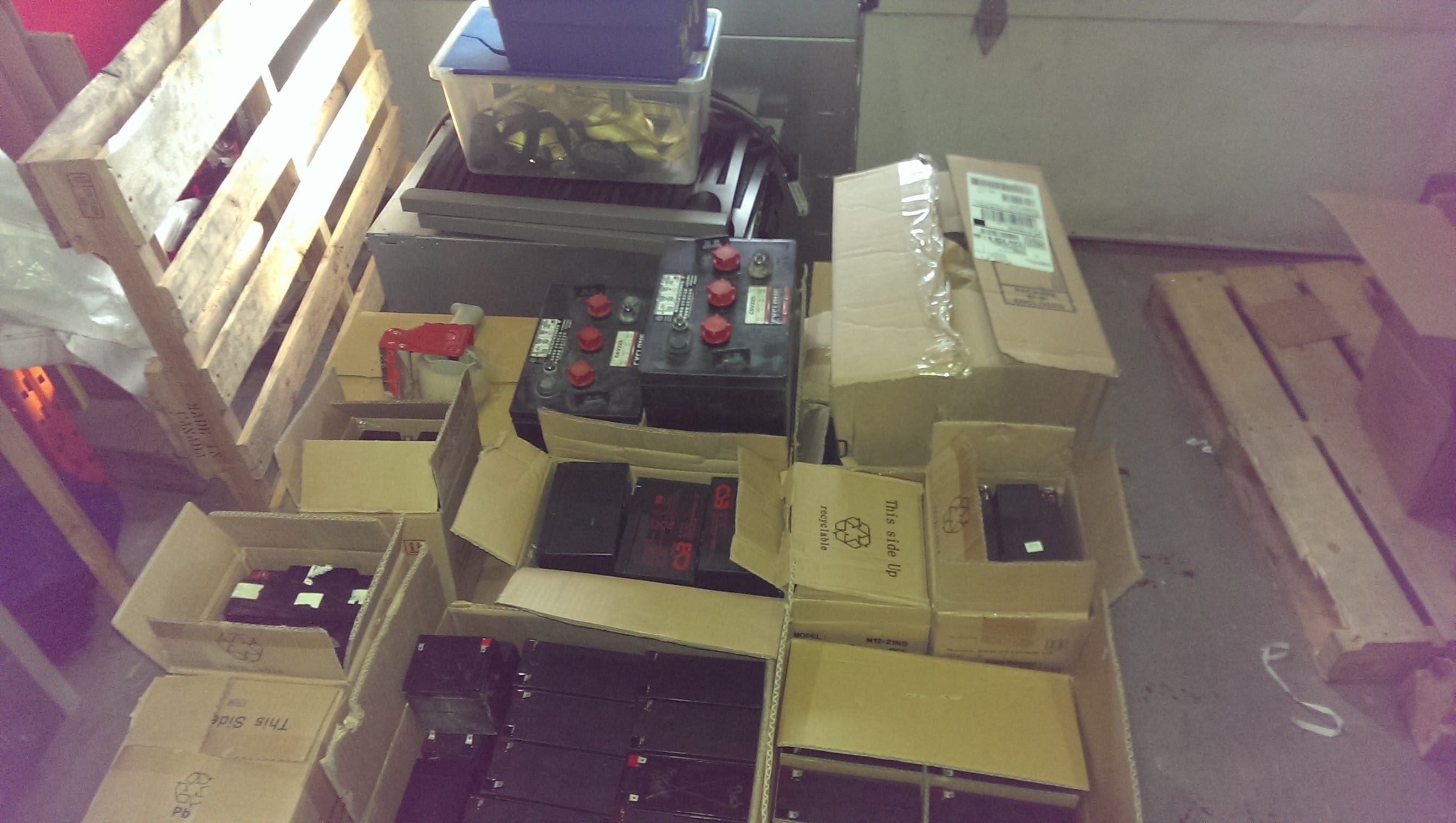

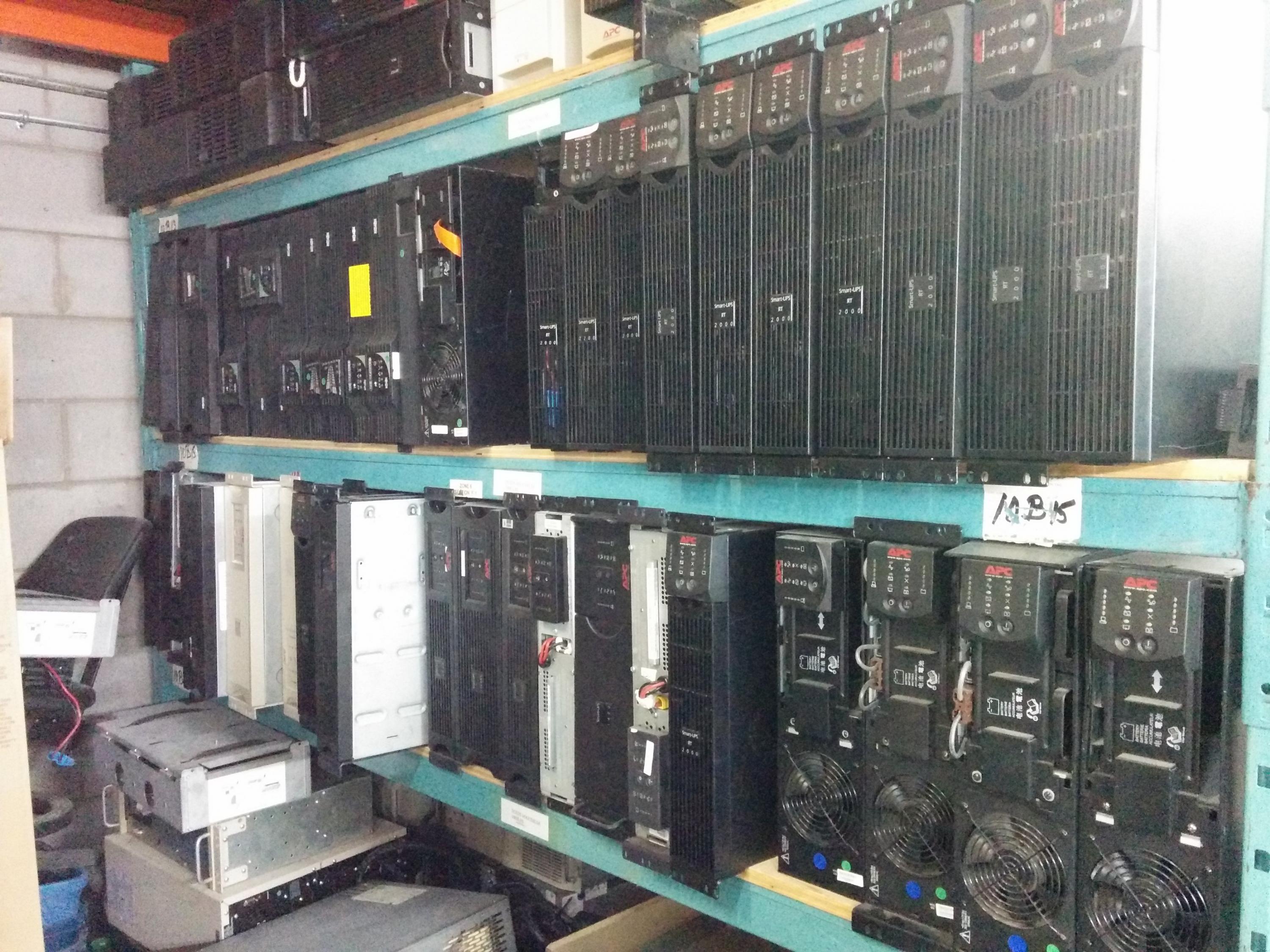

              Re: APC Smart-UPS float voltage experiment
              so you think that if i overcharge a panasonic battery for multiple years it will not becaume bulgy ? its not just about that... and soryy for the low resolution i probably made a mistake with the weird photo posting website i used. I searched for some panasonic batteries today but we don have any right now they are preatty rare but i will post some ipictures if i find some.
              • sadeoo7
                • Jul 2015
                • 13
                #47
                i will check for some dead panasonic batterie when i get some because i dont want to search in every box...
                yeah we recycle alot of dead sla batteries this pallet is about 5 feet tall.
                this is just a shelf full of ups

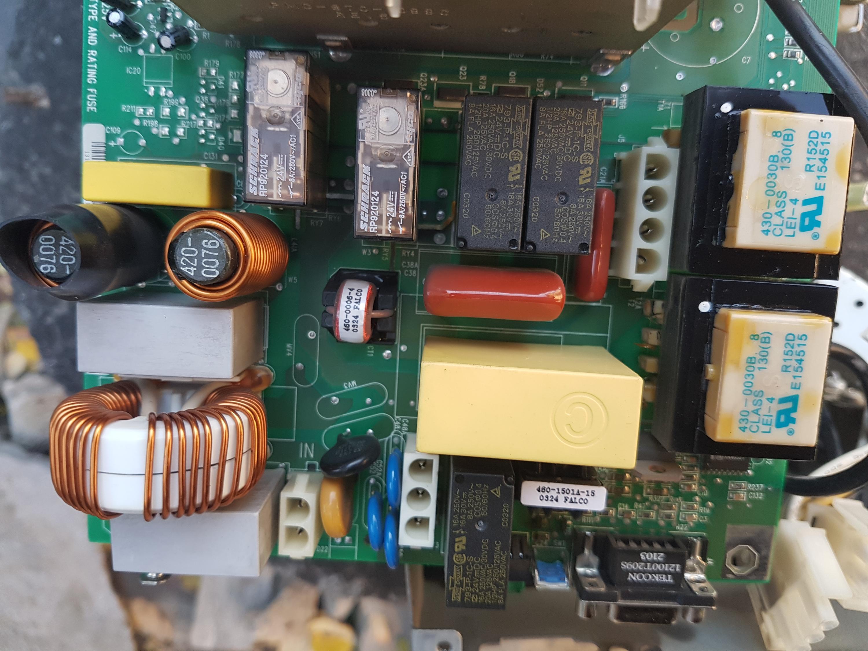

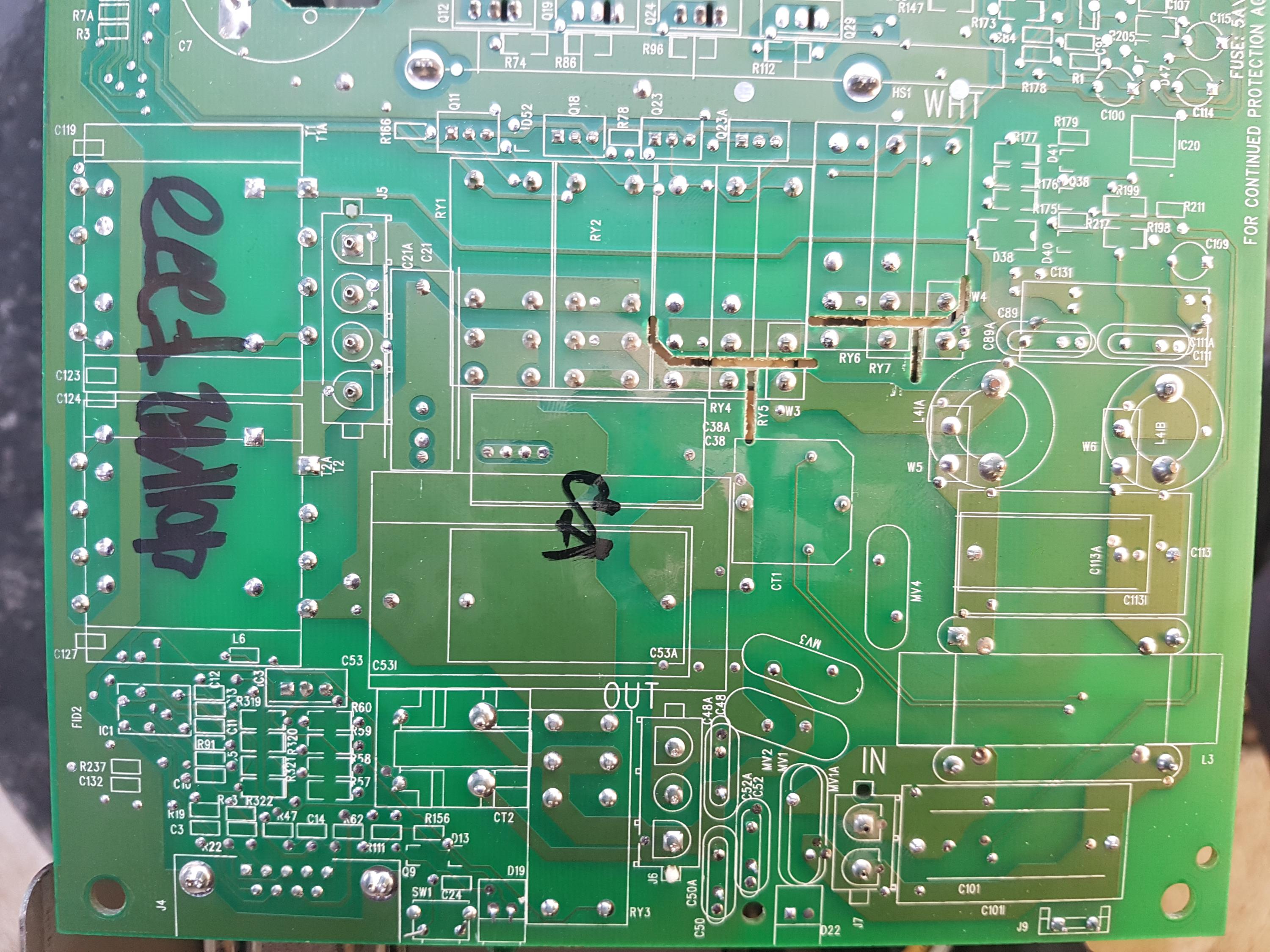

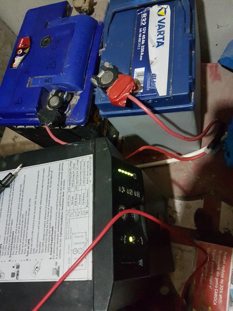

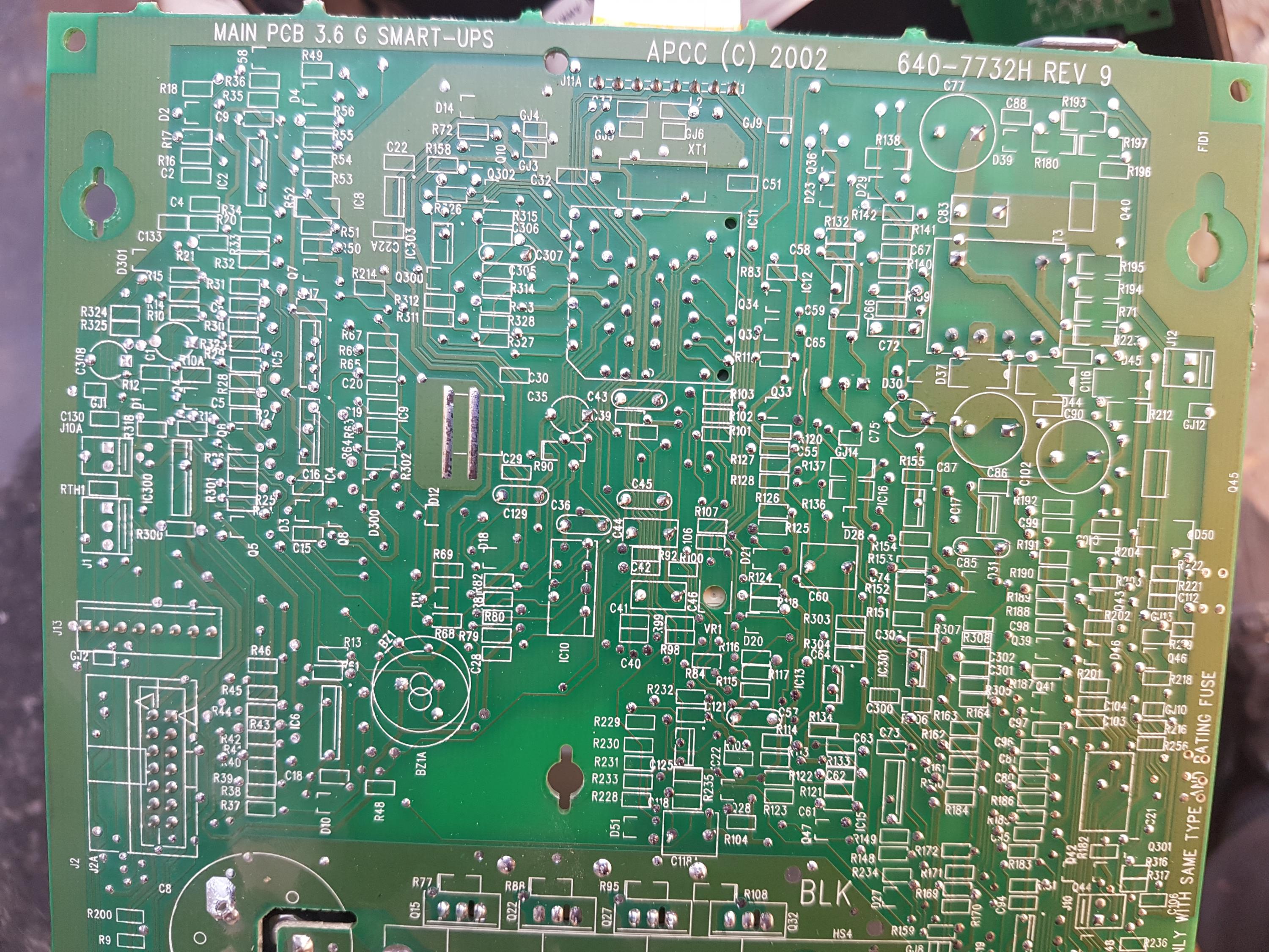

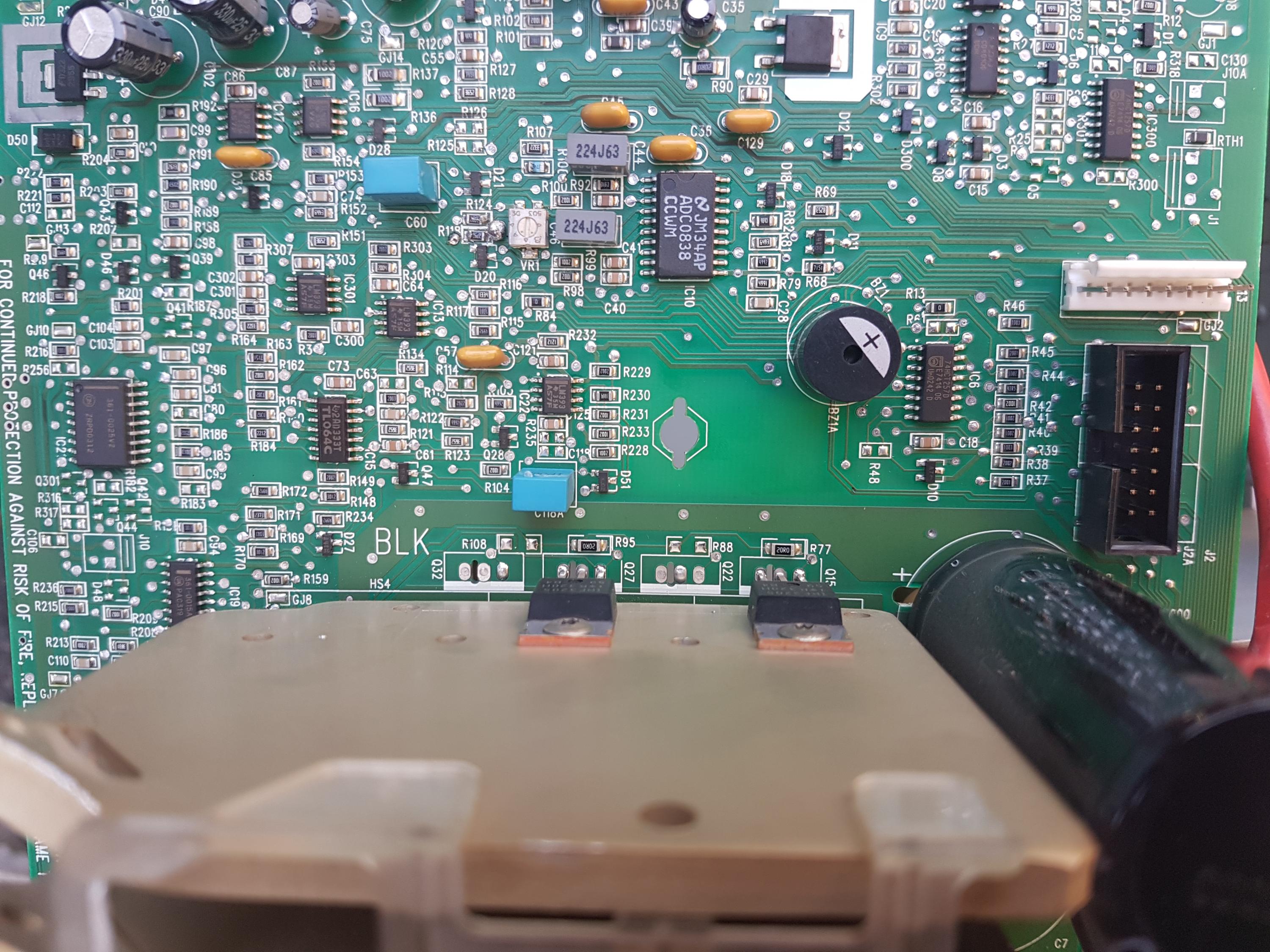

                        #51

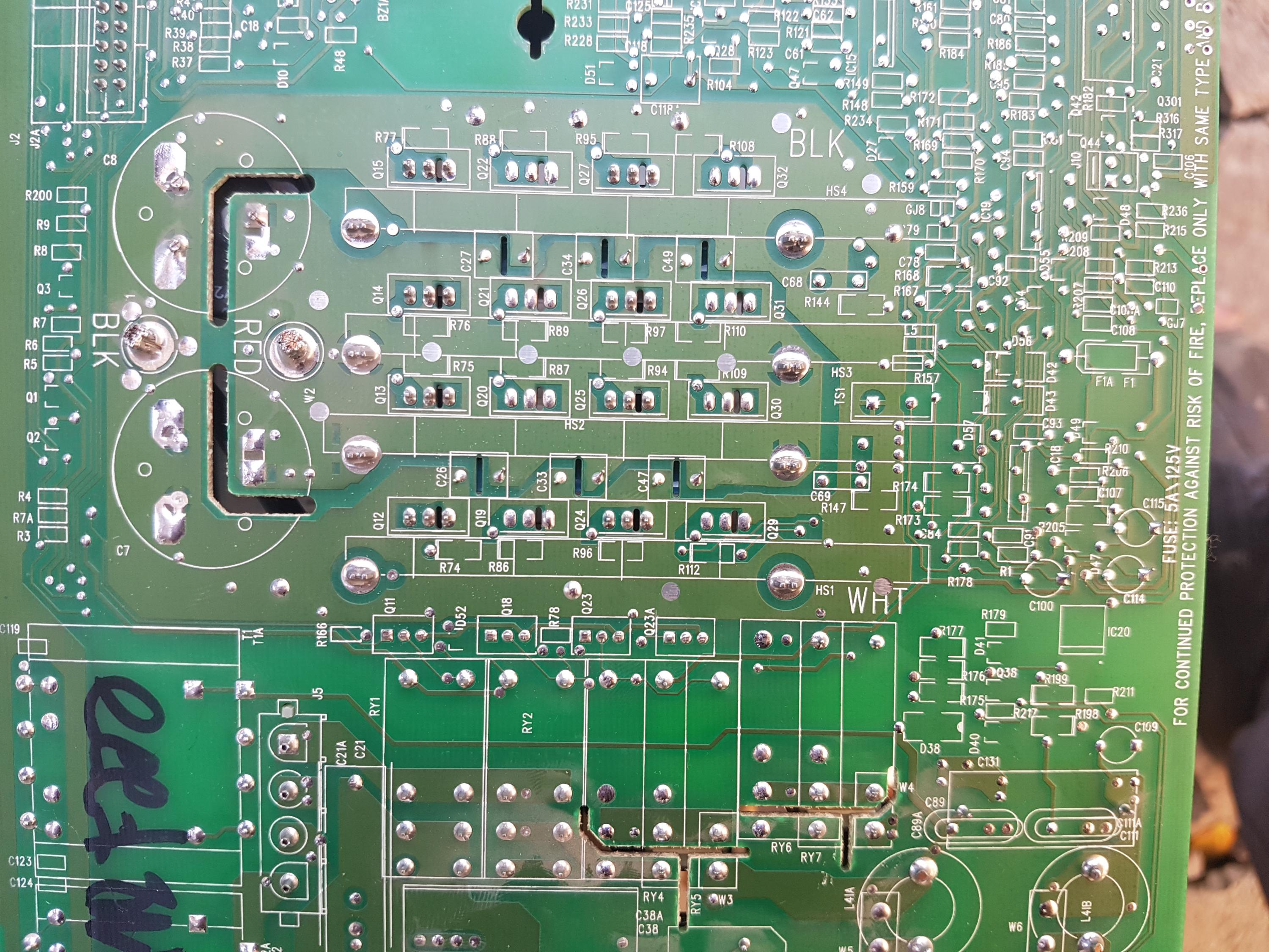

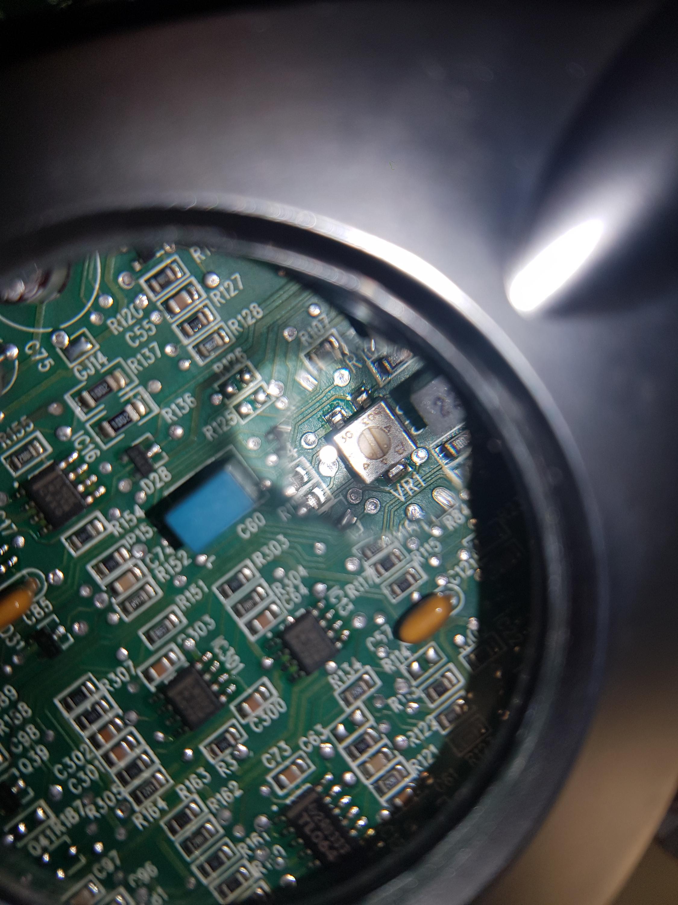

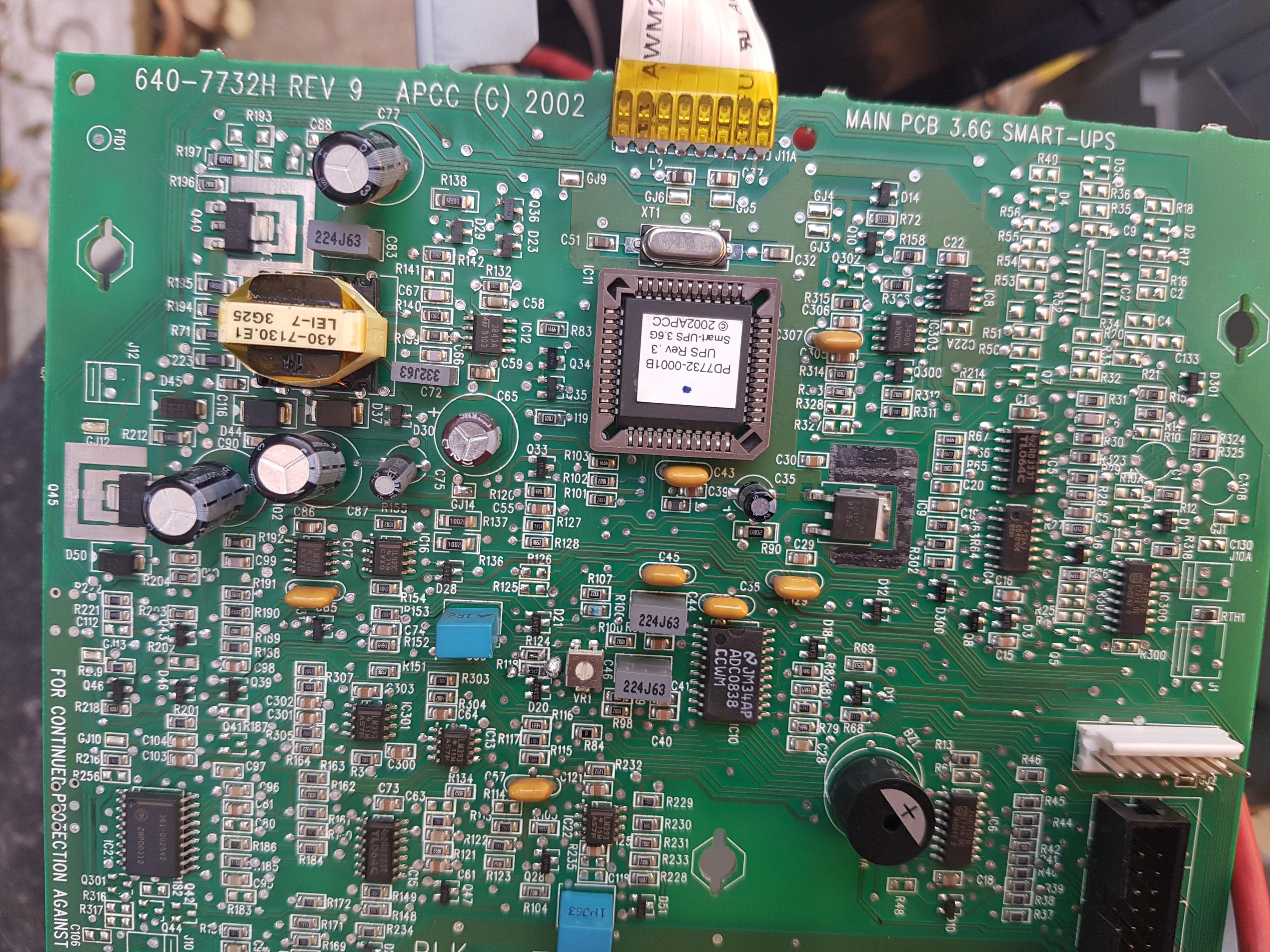

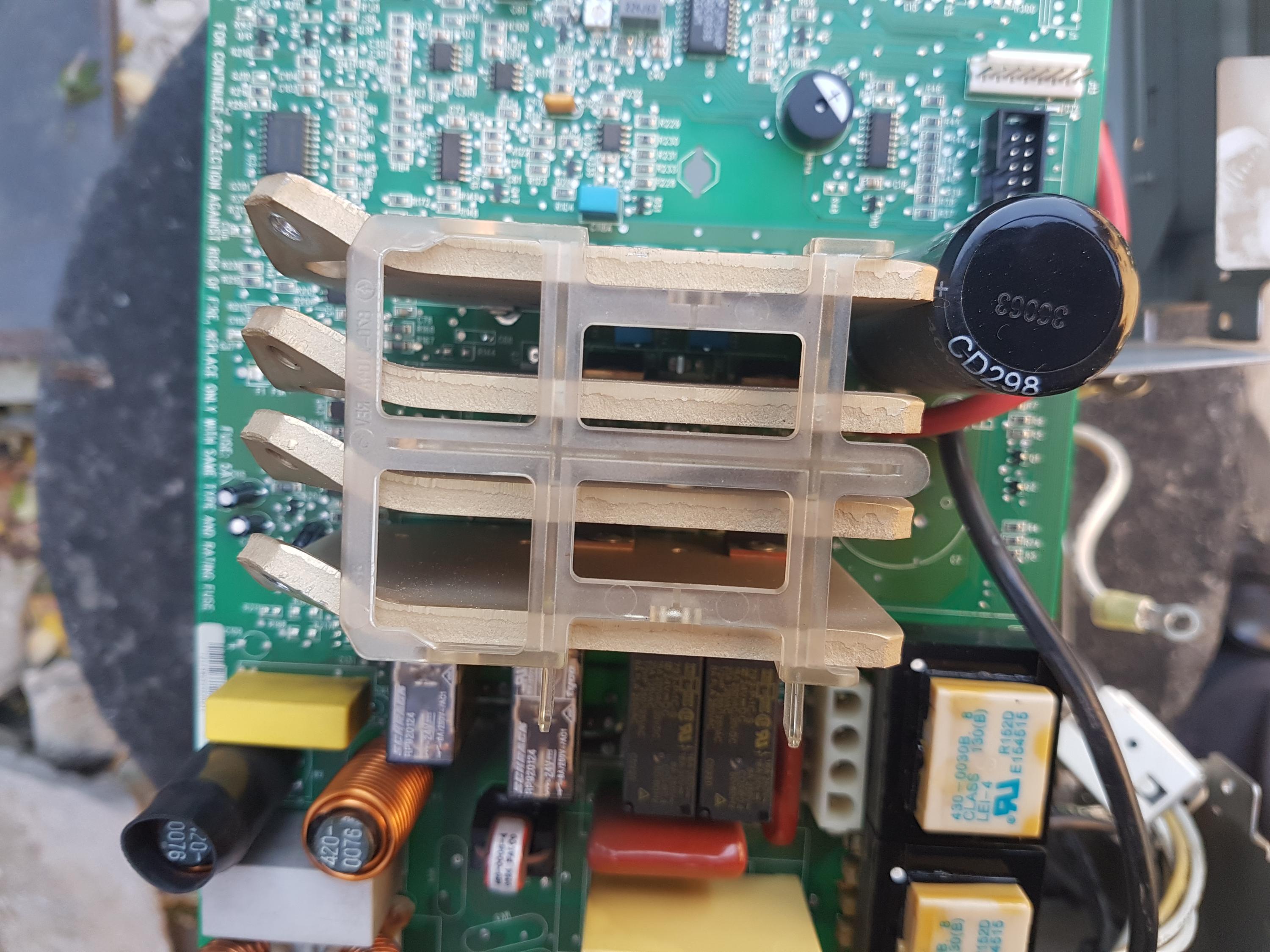

                        hello!
                        can someone help me lower my ups float voltage?
                        i have an APC smart ups 1000VA (2002 i think), it is a black one and it is modified to run on 2x12v car battery for central heating pump backup. i didn't make the modification, the guy from i have bought the ups did it.
                        i currently have 27.72v float voltage but it is boiling my car batteries, i would like to achieve 27v.
                        i have already tried to do the "r118" mod but it did not work, also, you can see that it is another model, with newer design, it does not have classic resistors. i have marked r118 from my ups with a red rectangle.
                        i also tried using the software method but with no succes, my settings are saved but with no real modification on multimeter, i still have 27.72v after.
                        another thing i want to say is that on an older smart ups 700va that i am using on my pc i have succeded the "r118" mod by using a 100k potentiometer instead of 100k resistor and i have a constant 27v float voltage. my inspiration was: http://www.jjoseph.org/notes/apc_sma..._float_voltage
                        sorry for my english, i am from romania.
                        LATER EDIT: guess what, 30 mins after this post i have tried one more time using software method and it worked, trough hyperterminal. but there is something "fishy", to actual decrease the voltage in real world you have to increase the voltage trough hyperterminal. sooo....by accident (i mean curiosity) i have increased the voltage and i noticed a voltage drop at terminals using multimeter. currently i have 27.67v/E9 on hyperterminal and a real 27.1v on battery terminal. at least for the moment, i will update if something changes.
                          This UPS is not designed to work with flooded cells and definitelly not with so high capacity. If you are willing to burn your house, continue using it.
                          I actually have couple dozen SUA750XLI which can run up to about 2x150 Ah (SLA of course) so if there is demand for such units in Romania, let me know, I can process them and drive there. Finally have a van since tuesday.
                          Although I can get ya UPS specifically modified to run with heating pumps and for use with single SLA up to 150-200 Ah. It may actually come cheaper than the APC units in the end.

                            #53
                            UPS, as i mentioned before it was modified by the seller. a few settings in powerchute, hyperterminal, 60amp fuse, bigger cables. at least this is what he told me.
                            i have 2x45ah batteries.
                            i have been using it for 3 years, 2 winters and it has done his job when i have lost electricity because of the hard winter. around 6-12 hours at a maximum 30w power consumption, only 1 pump (water pump for recirculating hot water) and the pump it was cycling "on" and "off", it is controlled by a thermostat/heat sensor.
                            so, at least in my situation....i have low power requirements, i really don't think i am in danger.
                            i can put you in contact with the person who sold me the UPS, i think he will want a few UPS units, let me know in PM if you want to discuss with him.
                              If it is in cold environment the whole time, that could help a bit, but a 1000VA variant only has passive cooling so the stand-by/charging circuit is under lot higher stress ALL THE TIME. Such high capacity accumulators have higher leaks so the current is high 24/7. That's simly not safe. If there was no cooling modification it can result in some bad things happening.
                              I've already met one of the early CyberFort units where somebody probably was doing the very same thing. It was overheating so badly that the heatsink a phase conductor was touching melt its PVC insulation, creating hard short which blasted the unit.
                              On the other hand the XLI units not only have fan, but are designed to run with high capacity external packs, so the charger is spec'ed for that. The SUA750XLI itself can run about 24 hours at 100% load (600 W) with the largest pack, according to APCs runtime chart.
                              Besides, flooded accumulators are leaking hydrogen and sulfur acid, both highly corrosive, so any space where these are placed 24/7 require venting, otherwise it will start eating everything metalic you have there. On top of that, when they are sitting without any movement, stratification and sulfation occurs, both greatly reducind their lifetime. You can prolonge it by charging it with a car battery (high voltage) charger once or twice a year. But compared to such effort, it is just better IMO to get back-up SLA. Those are more expensive, but with NO service whatsoever last 5-10 years, depending on size, temperature, quality etc. This huge material can possibly give you more information about lead-acid technology http://jgdarden.com/batteryfaq/
