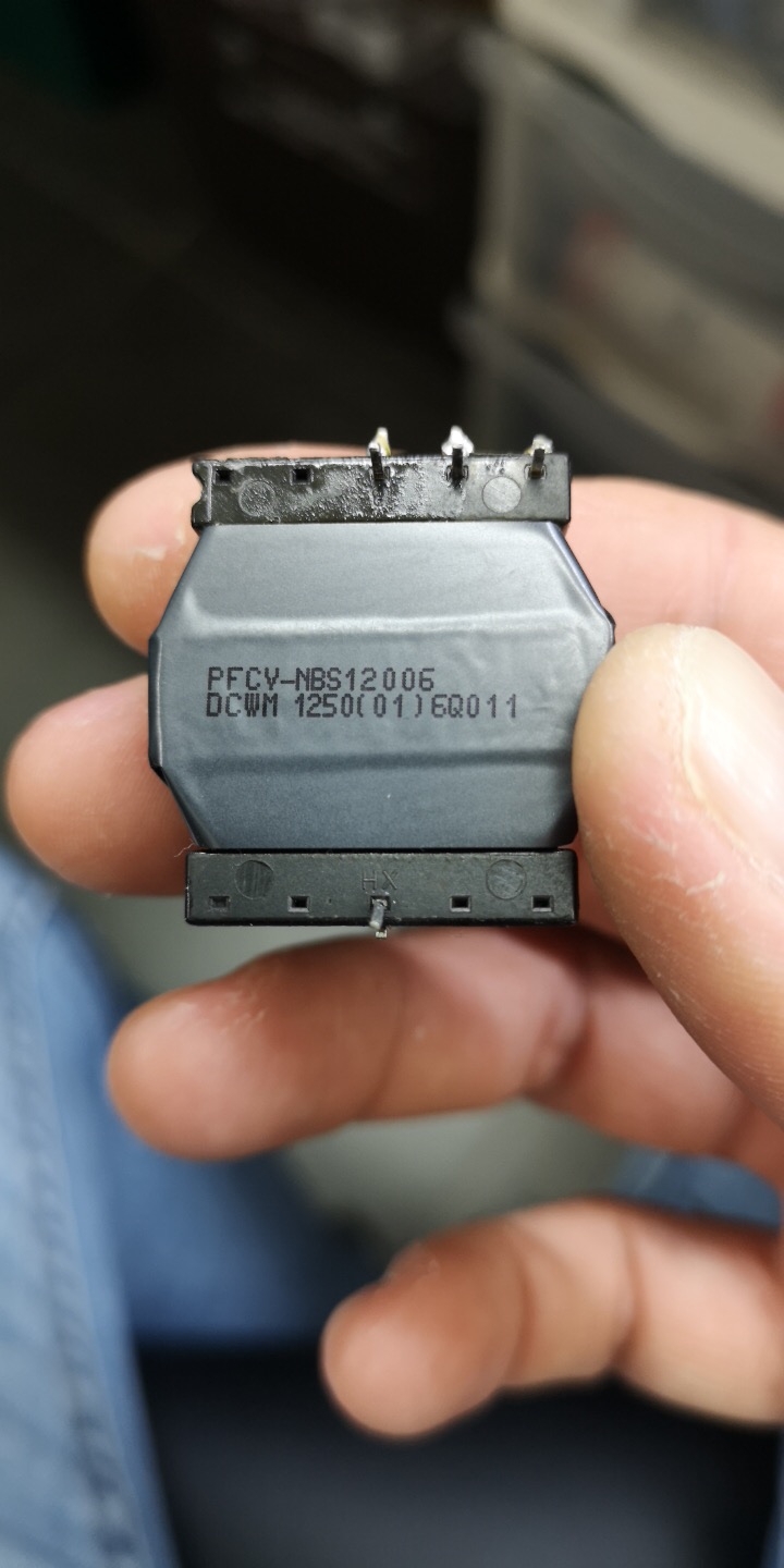

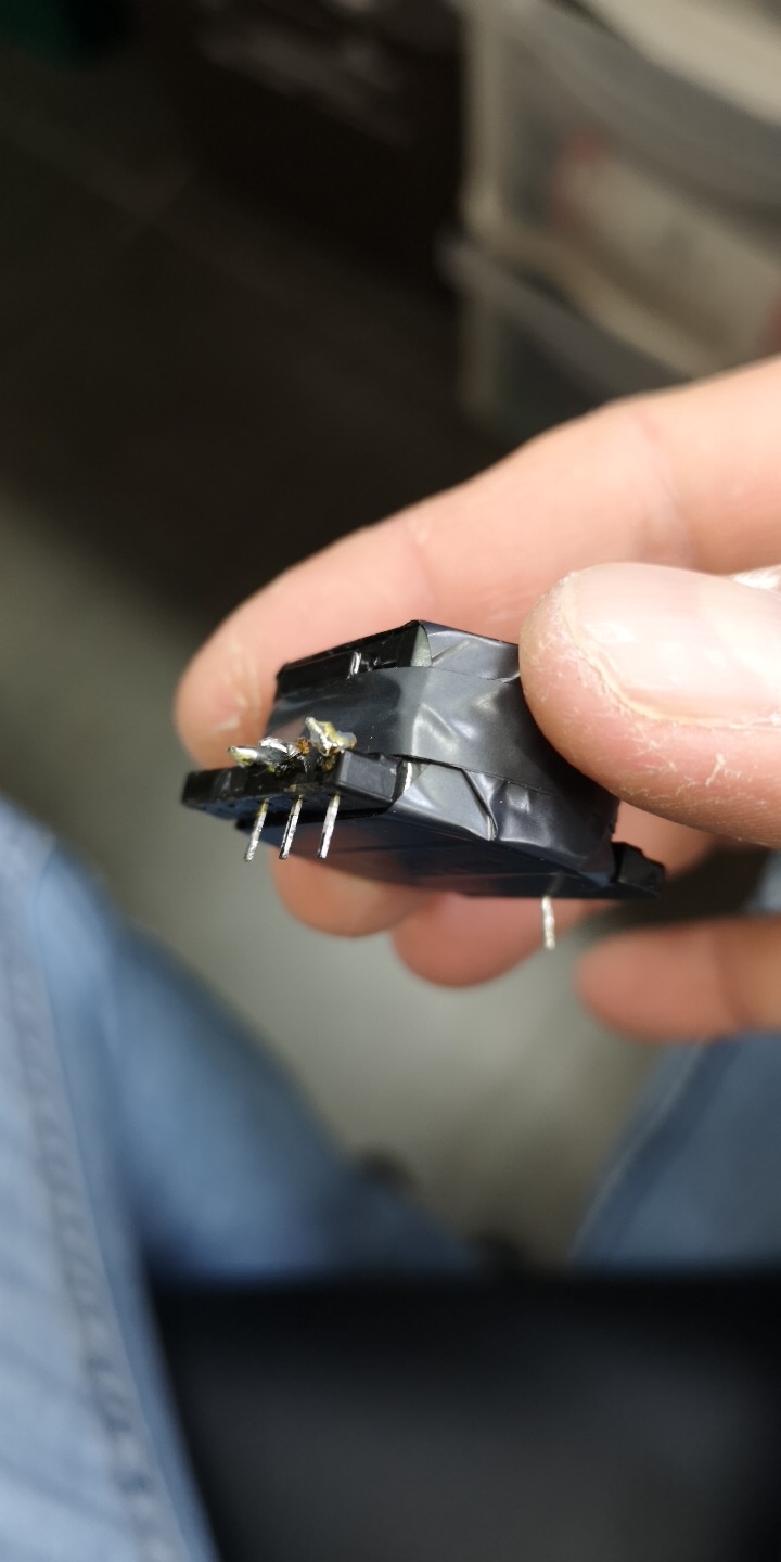

    I can't find this component in the figure ... it's the power supply circuit of an imac a1418 (ADP-185BF T).
    Do you know where to buy it?

    Looks like the PFC inductor. Hard to find separately, you can use one from a donor PSU. Why would you want to replace it though?

      Re: supply imac a1418 and component not to be found
      it is short-circuited

          Are you sure about that? It needs to have a very low resistance because it is in series with mains input.
          Measure exact resistance of the windings. I highly doubt that this is the issue.

              That is very likely the pfc inductor and it will check as a short or less than an ohm. Here is a thread about the same power supply https://www.badcaps.net/forum/showthread.php?t=69871

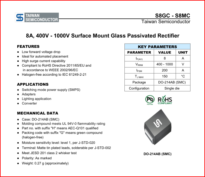

                Most probably, there are some components (power PFC mosfet and smd diode) short-circuited.
                I think the the smd diode S8GC - S8MC fails by itself, and causes PFC power mosfet to fail also, due to over-load.
