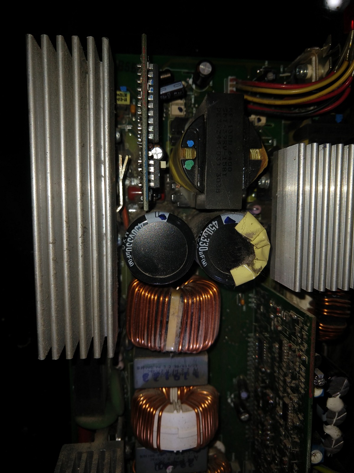

    I haven't touched this server in like 6 years and I was getting ready to throw it out but figured id make a backup of the data on it.
    It had been connected to power but not actually switched on for a few years (would have unplugged it if I had noticed). Worked last time I used it a few years ago. Im guessing the startup cap went out, and its not really worth the money or effort for me to go much further then that to fix this (why im not just buying a power supply on ebay for $40)

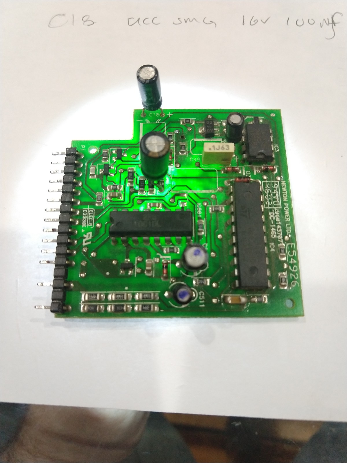

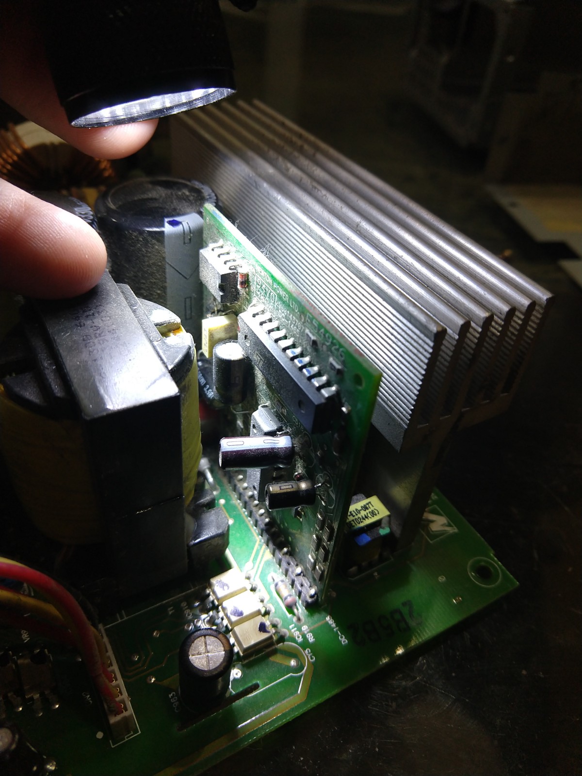

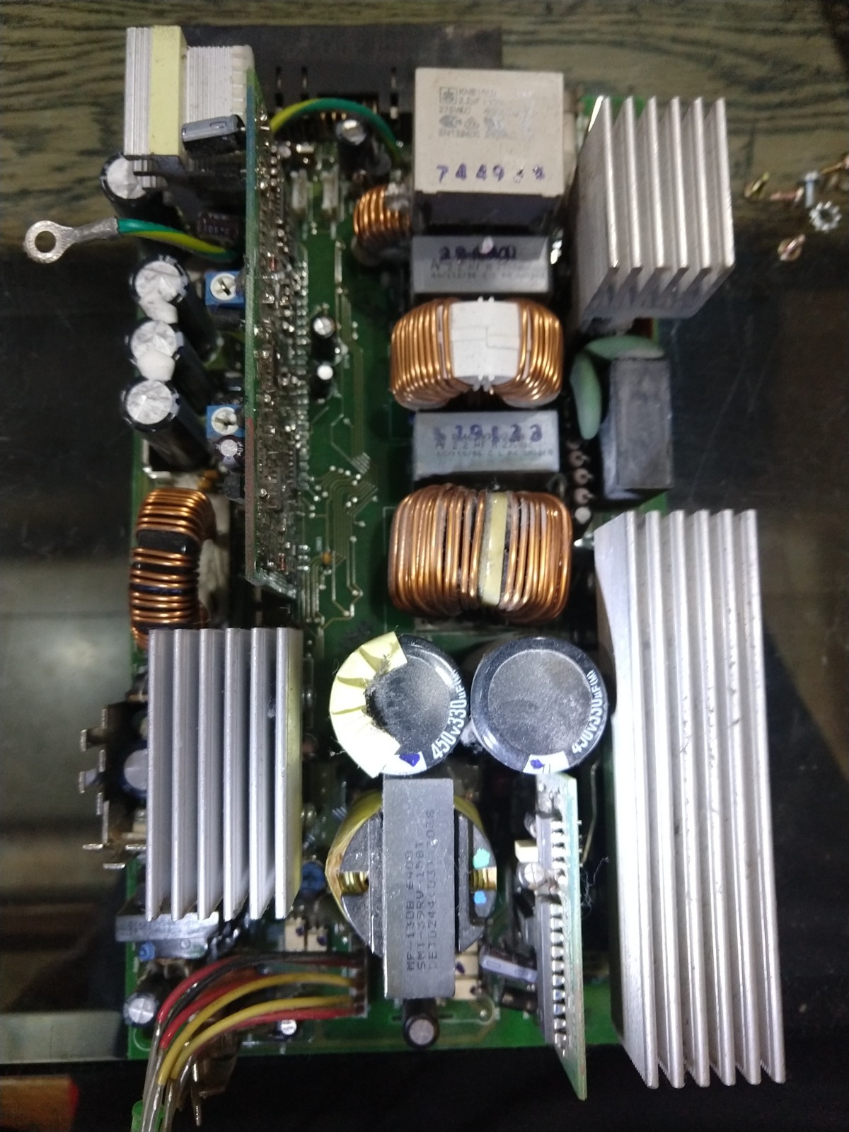

    Anyways trying to figure out which cap is the startup cap. Its been a while since I worked on a power supply but the startup cap has to be on the hotside? should be close to the pfc IC?
    The cap inbetween the 2 heatsinks is c3 a UCC KME 25v 47uF (in between the smaller heatsink with bridge rec and the large heatsink with mosfets)
    the caps on the small vertical board next to the transformer are:
    c511 maybe a lelon? 50v 4.7uF
    c518 ucc KME 25v 47uF
    c15 25v 100uf
    c26? same as c518 I think, cant really read it where it is placed
    c12? ucc SMG 16v 100uF
    So am I right that its probably the startup cap, and which cap do you think it is? If you need / want better or more pics just tell me what area.

      I tested all the outputs and didn't get anything over a volt.
      The caps I mentioned above all had ~ 60v to neutral of the AC input. (around 22v to ground, but my house has some bad wiring where ground vs line is like 56 volts. , so in other words ground isn't very reliable for voltage testing)
      Shouldn't the power to the startup caps be more like 180v? that the main capacitors would see?

        the startup cap will see mains x 1.44 via a current limiting resistor

          I tested the voltage leaving the bridge and get 160v so that seems ok. Also did diode tests on bridge and got normal readings except 3 readings were 0.478 and the other reading that should match was 0.466 , but probably close enough that I doubt that's the problem.

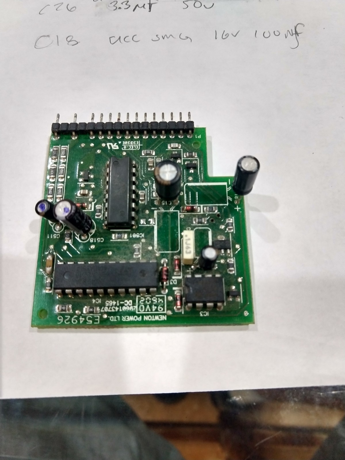

          I decided to just remove the daughterboard that holds the chips that I assume are for the pfc and now I just gotta decide what caps I want to use to replace these. Is it safe to increase the uF on all of these to the nearest thing I have?
          Updated list of caps on daughterboard:
          C511 LTEC 105c 50v 4.7uF - can I upgrade to Panny KA? 85c 50V 10uF
          C518 UCC KME 105c 25V 47uF - can I upgrade to Panny FR 105c 63V 47uF
          C15 LTEC 25V 105c 100uF - can I upgrade to Panny FM 105c 25v 220uF
          C26 LTEC 50V 105c 3.3uF - can I upgrade to Panny KA? 85c 50V 10uF
          C18 UCC SMG 85c 16V 100uF - can I upgrade to Panny FM 105c 25v 220uF

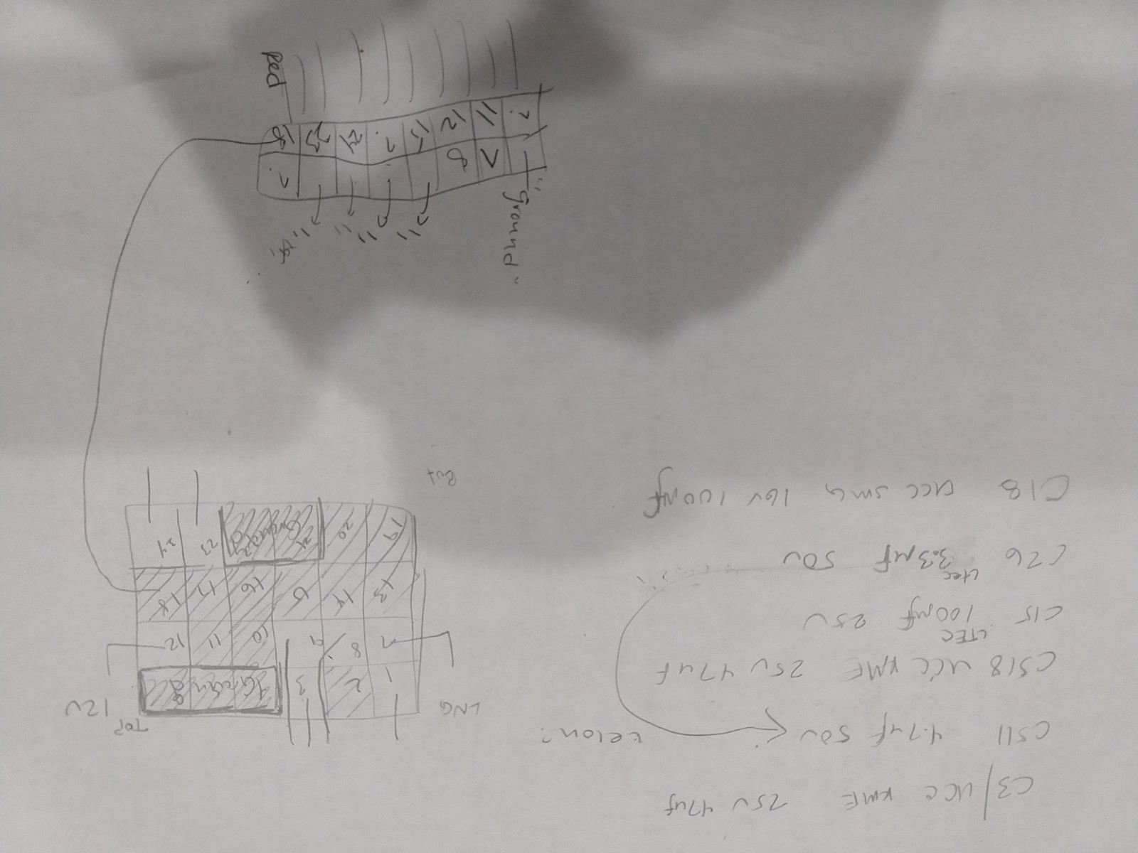

          Also included a picture of my handwritten work on deciphering the pin out of the 4x6 connector in the back of PSU and how it translates to the 8x2 ribbon cable that runs to the motherboard from the power distribution board.

                what is the part number on each chip?

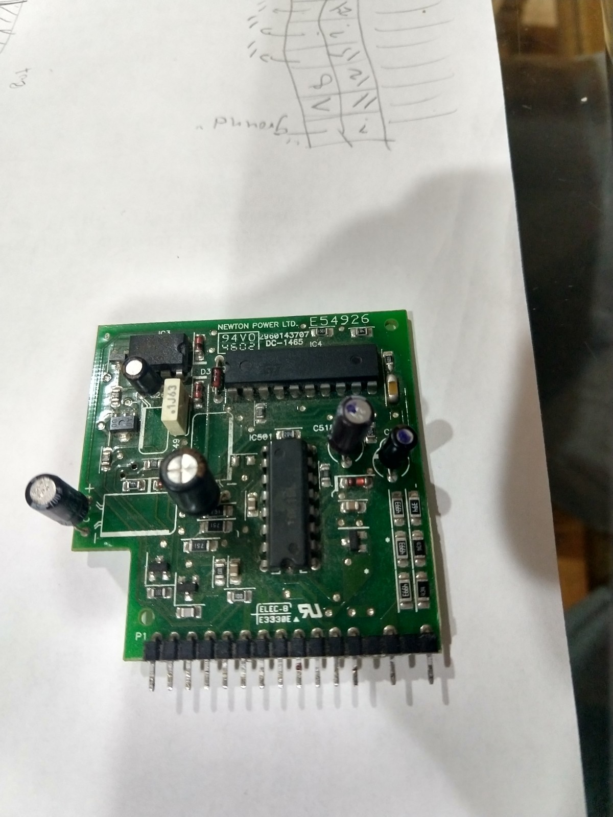

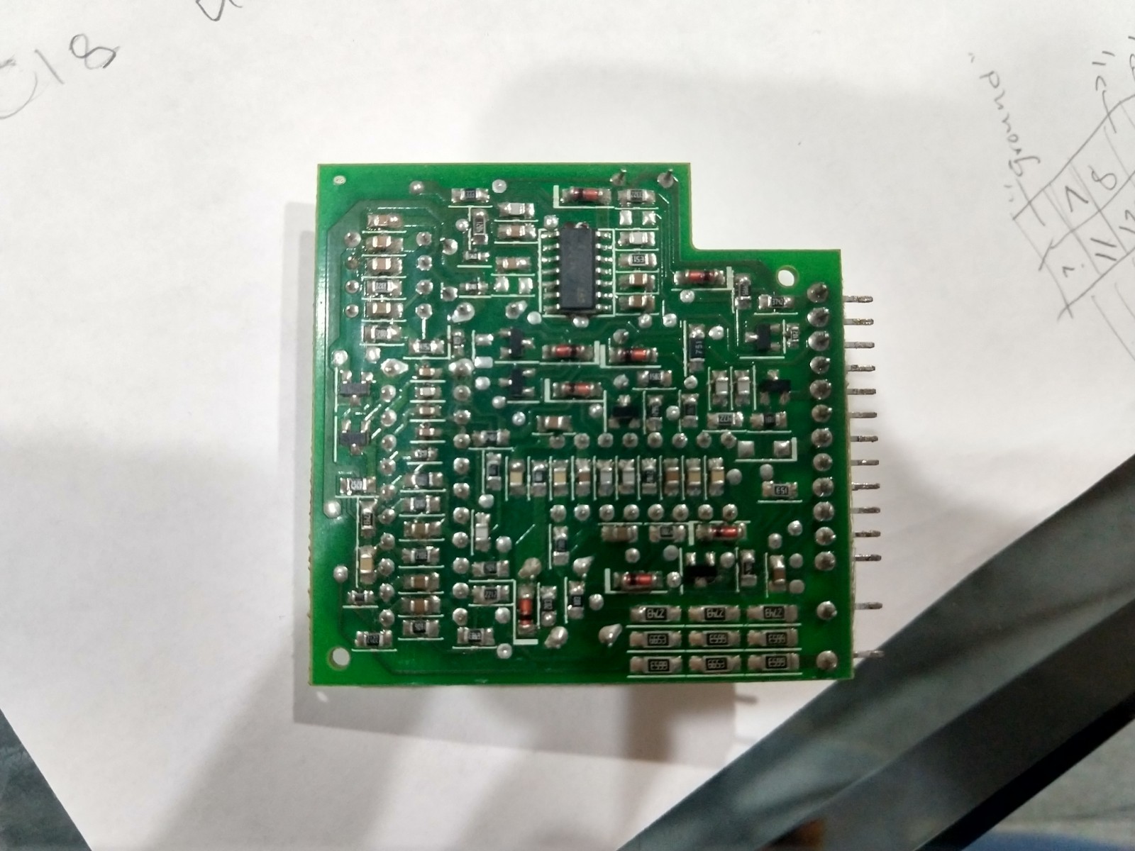

                      Anyways chip wise on the front of daughterboard:
                      IC4 STM L4981A (power factor correction)
                      IC3 ON LM393N (dual comparator)
                      ic501 is a mystery chip top line is "2F3" next line is "1001DL" its a 16 pin chip
                      On the back of the daughterboard is
                      (no board marking) STM NE556 (dual timers)
                      There's a small area where the primary side of the power supply wraps around the secondary and there is :
                      IC901 Power Integrations TOP244Y
                      i'm guessing the active pfc has to turn on first before this chip then handles the standby voltage rail.
                      There's a tiny (dime sized) transformer in the primary (not crossing into the secondary) connected to an optocoupler I think. what does this tiniest of tiny transformer do? (just curious, it has nothing to do with my problem)

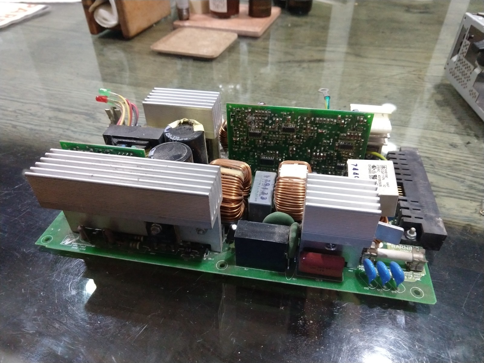

                        Re: Dell poweredge 2600 power supply nps-730ab
                        The PFC will not run when the PSU is in standby.
                        So if you do not have standby voltage present it means the IC901 TOP244Y is not switching on.
                        So check the capacitor connected to that.
                        Remember an ATX PSU is actually two power supplies in one: the standby and primary supply.
                        All controlled via different transformers, the only thing they have in common is the bridge rectifier but you have already confirmed that creates 160VDC which is normal with a 115VAC input.
                        If this is not time critical why not get one of the cheap "transistor testers" on eBay?
                        (The one that is really a tiny LCR meter for $10 or sometimes even less?).
                        I would not want to solder back that daughter board that you have taken out without first confirming the caps are ok or replacing them!

                          The startup cap for the top244y all in one chip that does the standby is 100uF, could i put 2 47uF in parallel for this? And could i test that without the daughterboard (i'm guessing not lol) but yeah i don't want to have to remove the daughterboard again, I did it with about 2 feet of wick since i don't have a solder sucker or hot air station or tip wider then 6mm
                          What are you suggesting the transistor tester for? Would it allow me to test capacitors while they were still in circuit? Its only 6-7 caps I could just undo 1 leg of each quicker then picking a tester on ebay.

                              I replaced all the startup caps, but that didn't help.
                              I did notice the startup capacitor for the standby supply (power integrations top244y chip) goes from 5.8v to 0v when I read both pins of the cap with my multimeter, then eventually back to 5.8v after a few seconds. The manual says: A hysteretic internal supply under-voltage comparator keeps VC within a window of typically 4.8 to 5.8 V by turning the high-voltage current source on and off as shown in Figure 8.
                              So I don't know if that would mean there's a short or something inside the top244y chip, but then why would it eventually return to 5.8v every few seconds?

                                Pretty much every cheap PSU design will retry forever.
                                Meaning it detects a fault: shutdown, then starts up and tries again...
