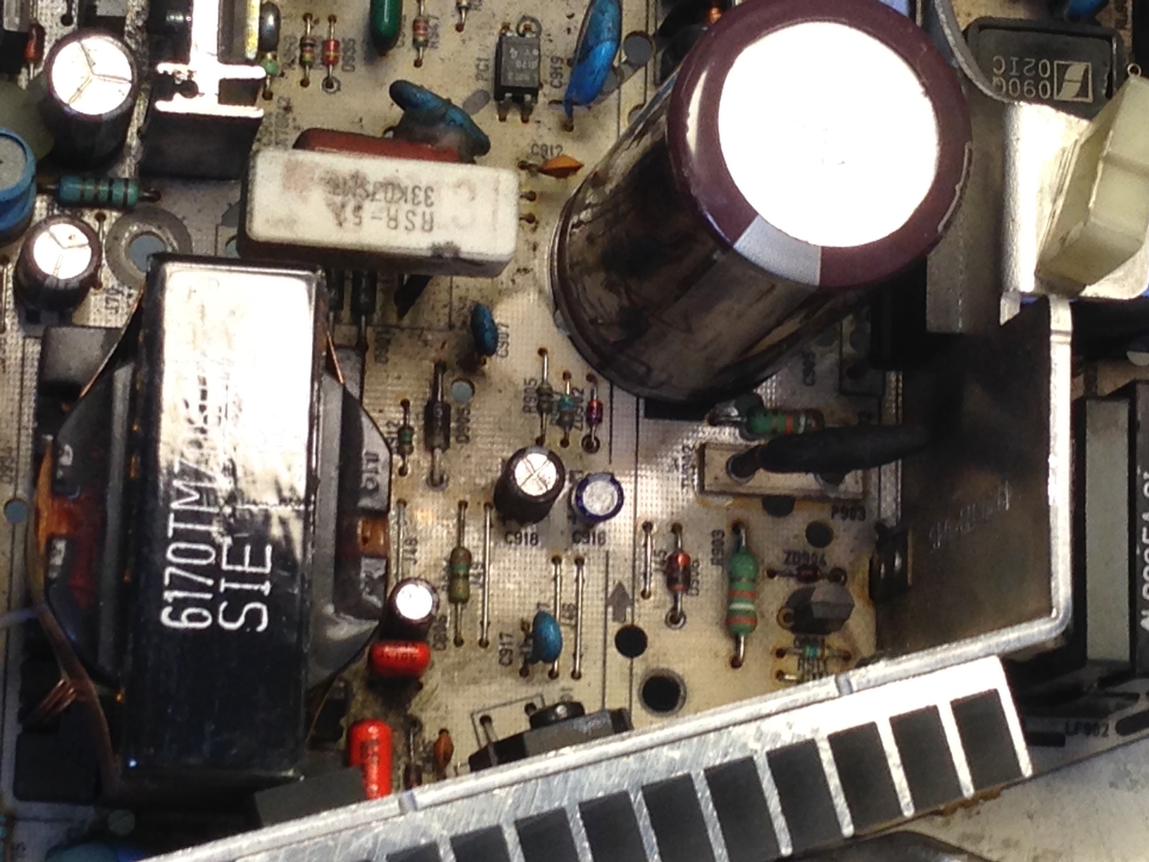

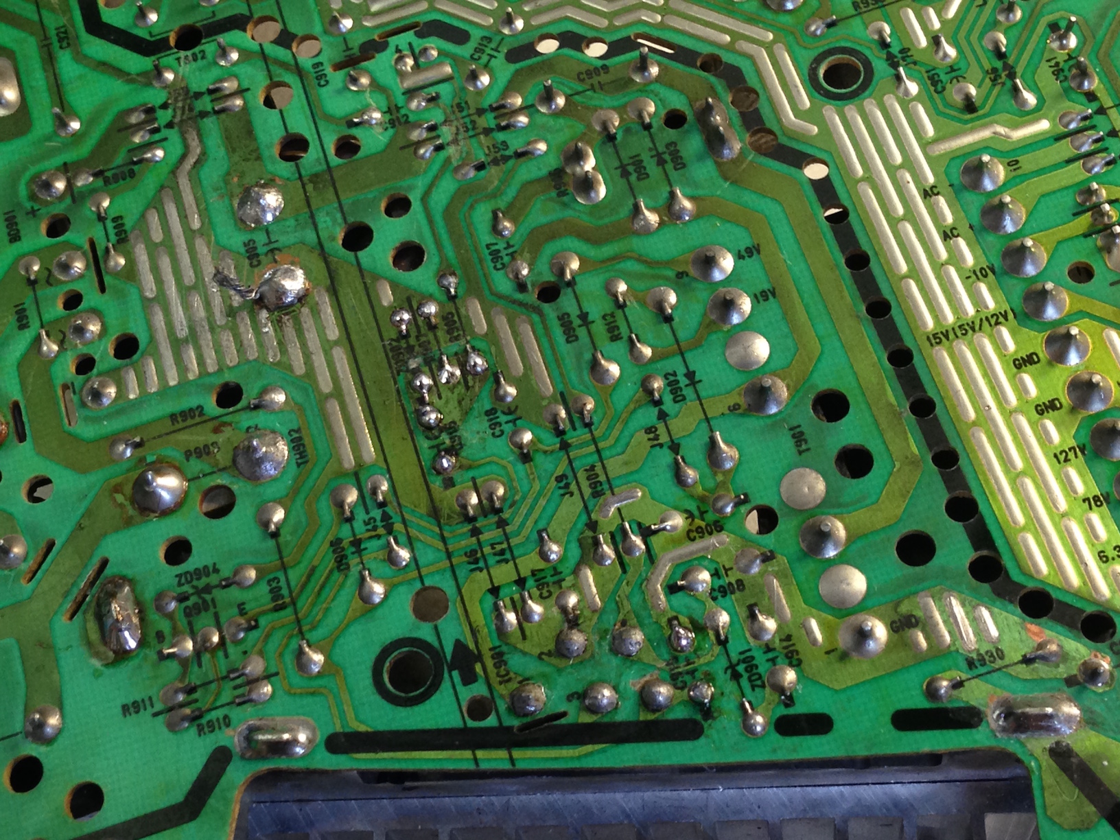

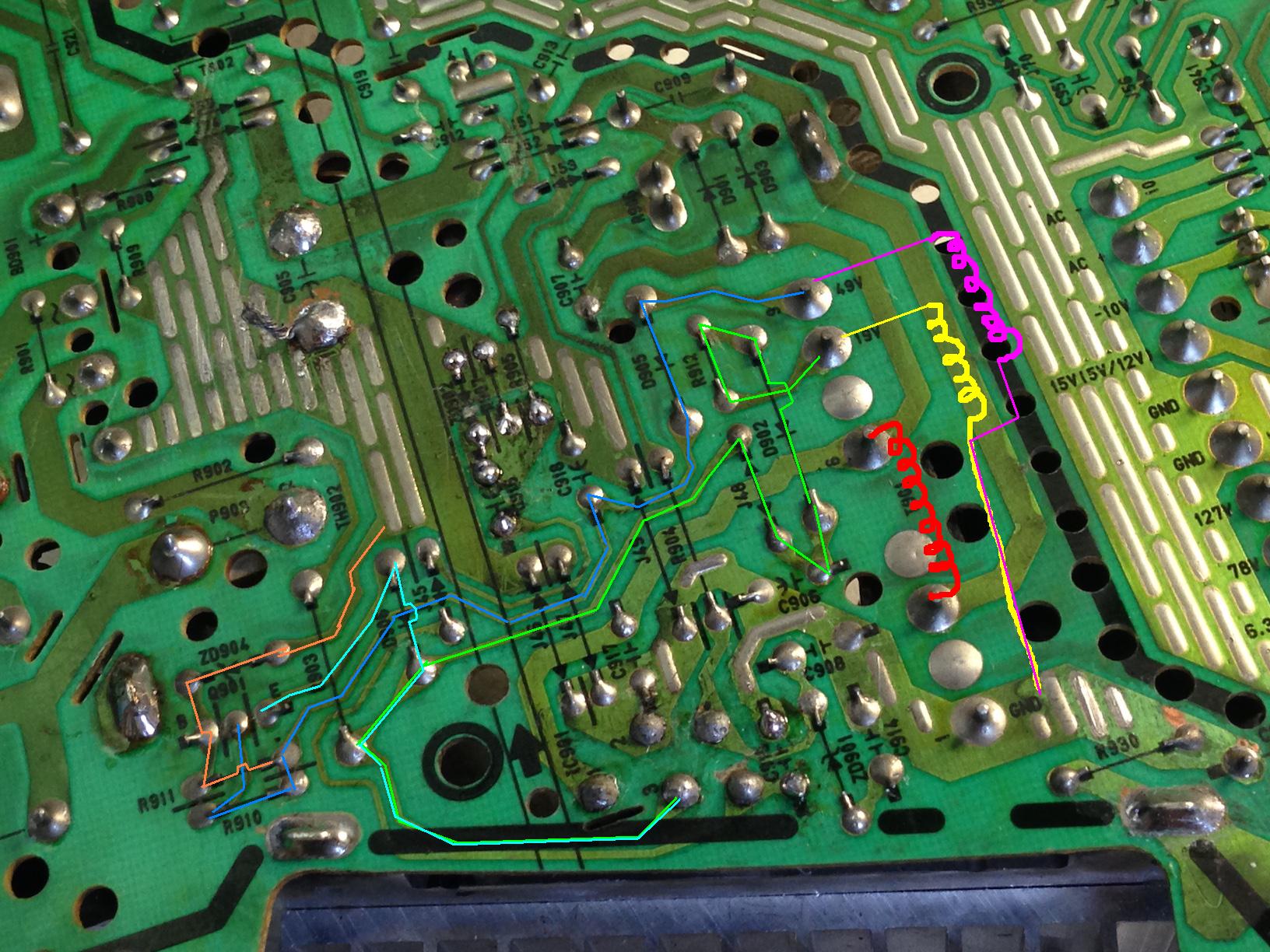

      Here are some pictures, let me know if you need more of them. Thanks a lot!

            What ground are you using to measure the VCC? the ic is rated max VCC 30 volts. You need to use hot ground
            Check R912, it should be low Ω (5~10Ω?)
            The two windings 49v and 19v will have continuity to ground. the 19v winding is used to supply the vcc voltage to keep the ic operating, if either winding is open, the transformer is likely defective, double check its resistance
            The 49v circuit supplies voltage to Q901 which acts as a voltage regulator for the vcc. Check ZS904, its the reference on the base for Q901 and its emitter is the regulated output voltage that feedds the VCC via D906
            If you do not have continuity between 19v and ground or 49v and ground, I suspect you found your problem.
            C905 or C918 could be defective (open or no filter capability)
            The sync input is not that important, its used to sync the power supply frequency to the horz frequency to prevent a beat pattern on the screen.
            The small bridge rectifier may not be used on this model.

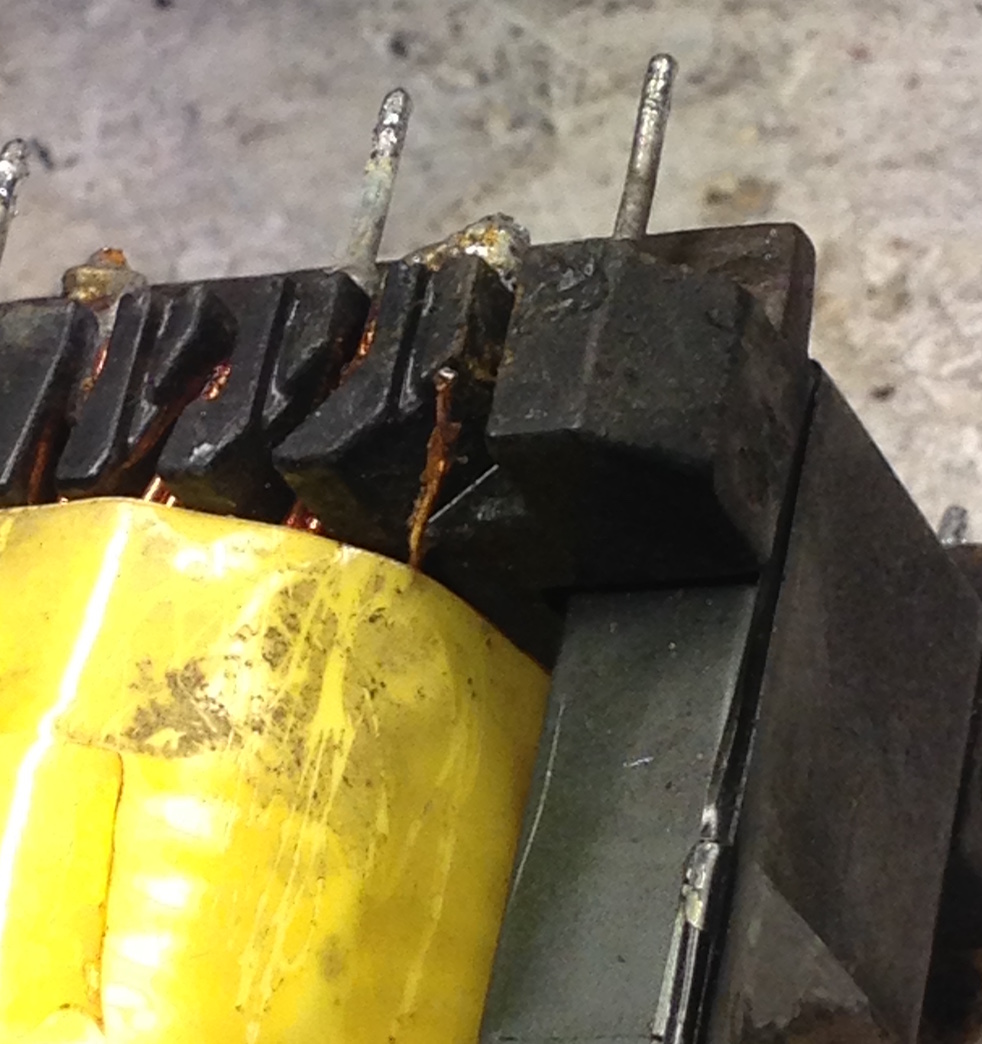

                Good news. I removed the transformer from the PCB and guess what? look at the 49v pin...
                I fixed it with a short wire and soldered the transformer back in its place. Next thing to do is to check the other components of the startup circuit, then I'll try to turn on the iMac and see what happens, keeping fingers crossed.
