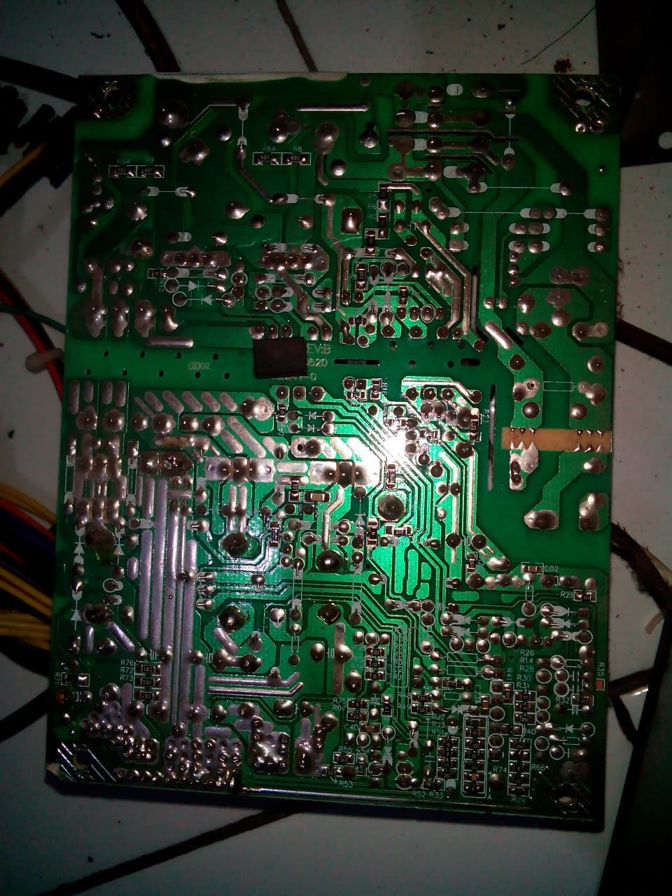

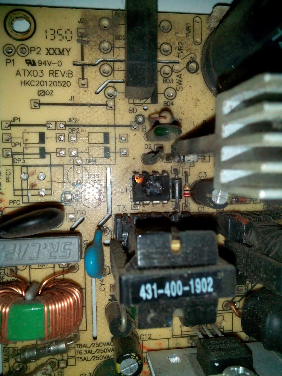

    Hello everyone.
    My friend gave me a dead power supply, thermaltake litepower 450 watt, with model number LT-450NL2NK.
    after i open the case, i found a burnt IC in 5vsb area.
    The problem is, i don't know what is the ic serial.
    i tried to googled it, but i still can't found the same board type or OEM of this psu, so i cant found the type of burnt IC.
    What is OEM this psu use?
    And what is the type/serial of IC used in 5vsb?
    Thanks alot.

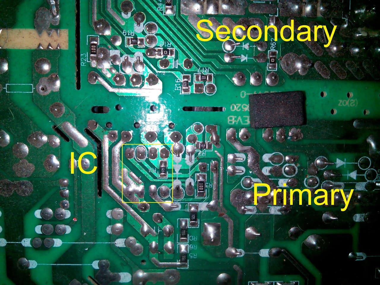

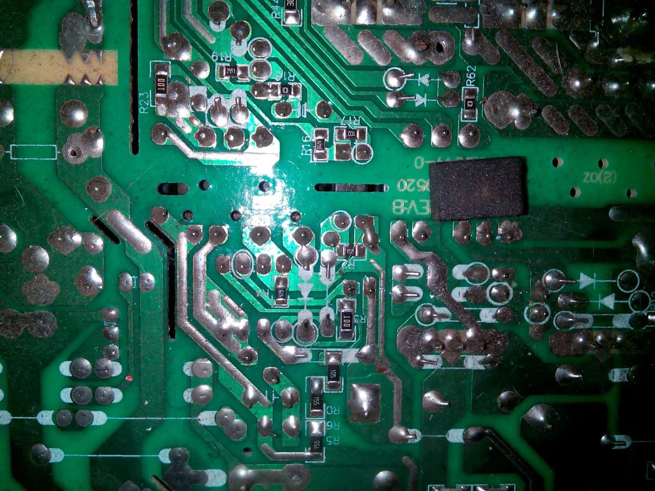

    Re: Thermaltake 450 lite with burnt/exploded 5vsb ic
    Can you provide a better picture of the bottom of ic1? to be able to see the traces and components connected to the ic1
    I am so far guessing it could be a OB5269CP
      Hi, thanks for the response..
      ok, this is the picture.

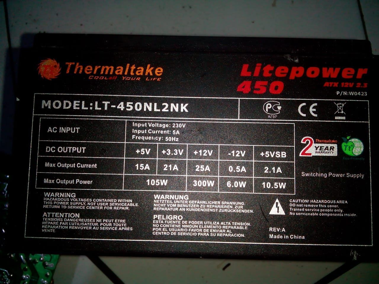

        Forget to include Product number..
        This one is thermaltake litepower 450 watt with Product Number: W0423
          I guess it won't be OB5269CP, this ic uses an external mosfet.
              Its not a TNY176PN either, wrong pinout, I can find lots of ic's that its not but can't seem to find which one is used here,
              It's also not a BH170A

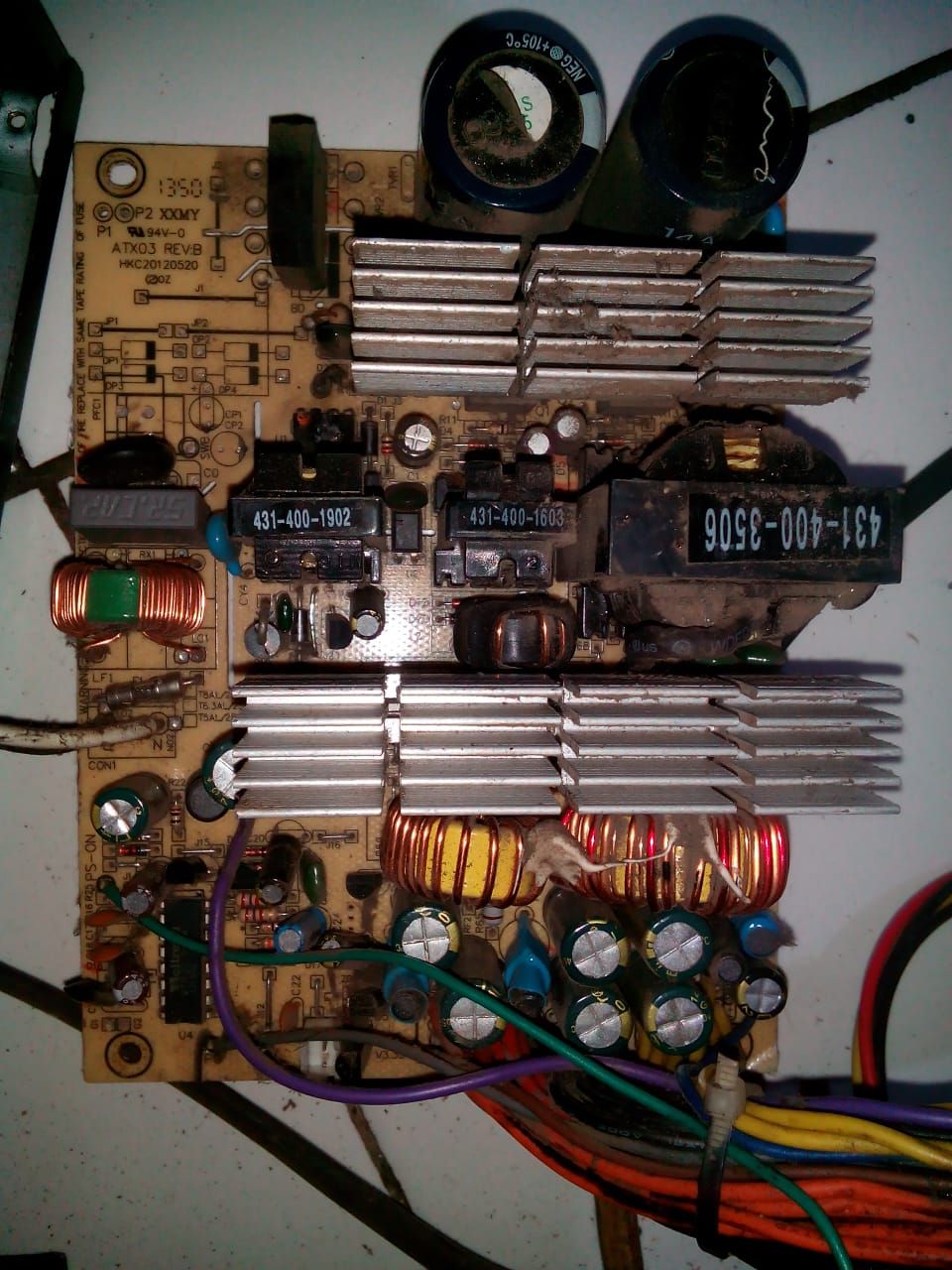

                Yes, this one not TNY series. Because TNY using 7 pin.
                What is the oem this psu using?
                Usually thermaltake using solytech for their low end, but i think this one use atng, based on the type of heatsink.. idk.
                The ic of mystery...
                  What are the other ic's in the primary? and what is that one in the secondary? sometimes searching for known ic's might point towards a similar schematic that has the correct standby ic.
                  I see this 8 pin has pins 7 & 8 connected together and 3 & 4 connected together. sometimes these 8 pin ic's will have pin 7 but it is not used
                    Hello..
                    There's no other ic in primary. Just that one.
                    And in secondary using Weltrend wt7525 as supervisor.

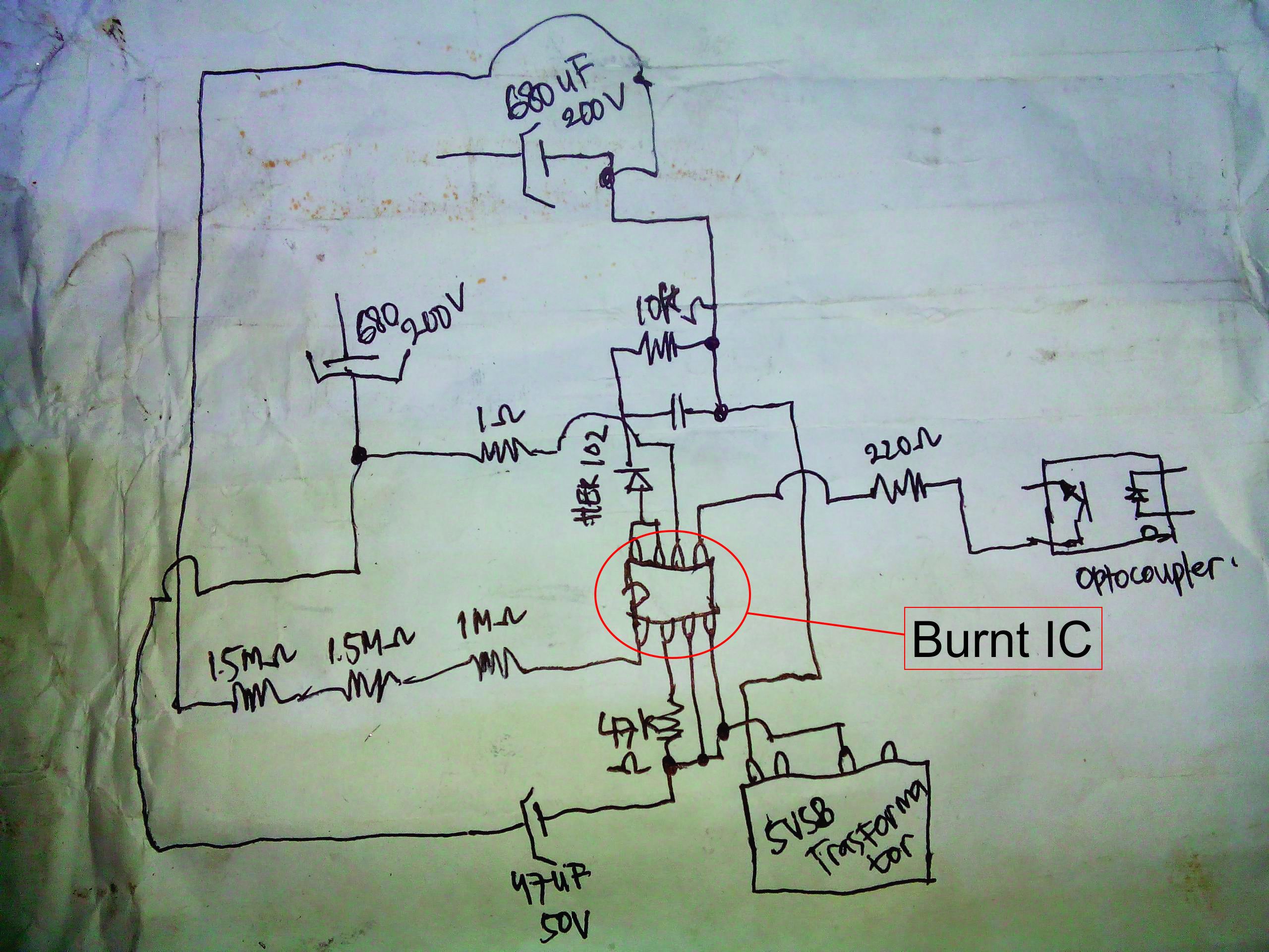

                            I'll try to draw some schematic for 5vsb section.
                            Maybe it'll help to determine the right ic.

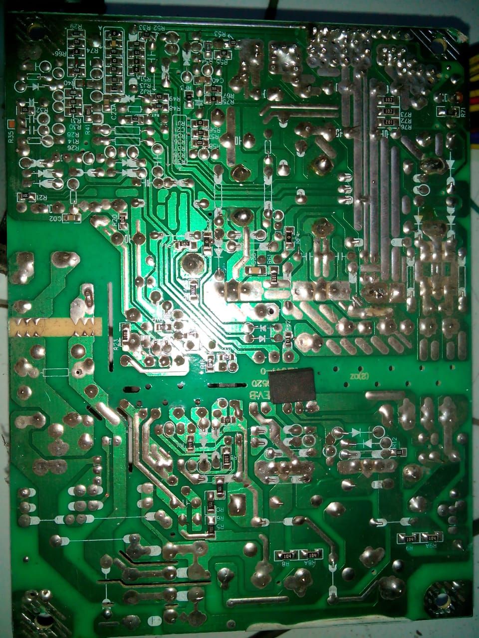

                                      i've already make a simple drawing about the connection of the ic with the other components.
                                      Maybe it can help to find out about this ic serial id.
                                        Its close, pins 7&8 connect directly to the transformer primary, the diode is in series with the [cap. across the resistor] and are connected across the primary of the transformer.
                                        D1 anode comes from the transformer run winding and the cathode connets to R3? (10Ω) to pin 2 (C1 or is it C3?) connects from pin 2 to ground
