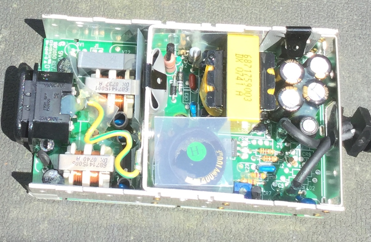

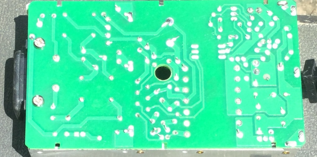

    What are typical problems with this kind of psu behaviour?
    It is ordinary 12V 5A psu, everything measures ok, what could be problem?
    https://youtu.be/-zwaUHZ2OCk

    Let see the plastic housing for this power supply data plate
    Also let see the front side and back side of the board close up
    This power supply looks very familiar to some power supply that I have
    Is this medical grade type power supply
    If this is the type of power supply all the capacitors need to be replaced except the the main capacitor can left alone ——> these are very good switching power supply
    I have quite a few of 5 volt @ 5 amp switching power supply and I always recap them the capacitors that they use are real crap
    I also have a few 12 volt @ 2.75 amp one also
    The photos are from the 12 volt @ 2.75 amp medical grade switching power supply
    On second thought this might not be the same type of power supply

      Re: What are typical problems with this kind of psu behaviour?
      Hmmm, OVP shut down and restart? The low cold resistance of the halogen bulb is tripping over-current protection?
      Some of the solder joints near the board edge nearer the camera, roughly in the center of the board, look like they might have voids or cracks (a poor solder joint could open up if current passes through it).
