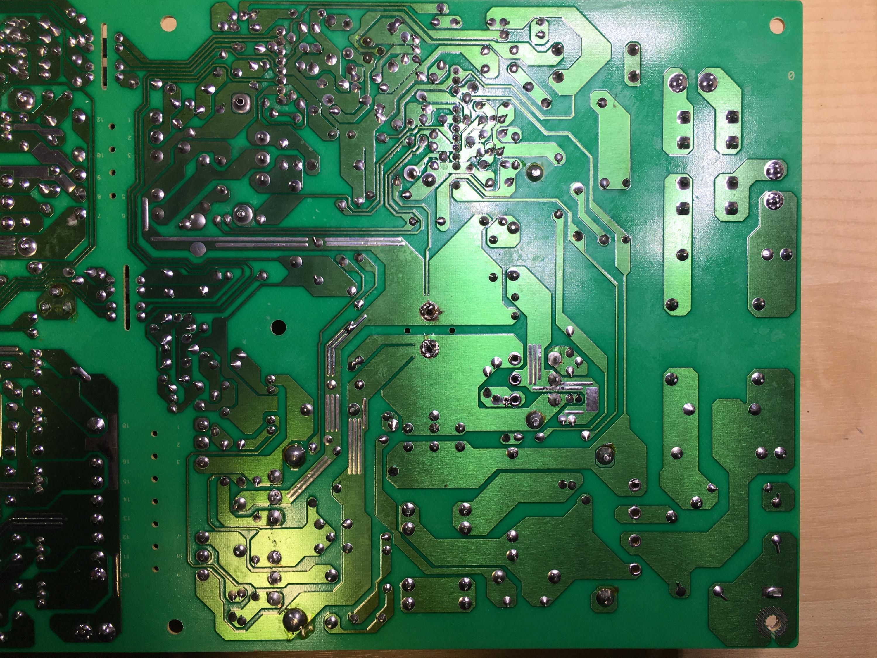

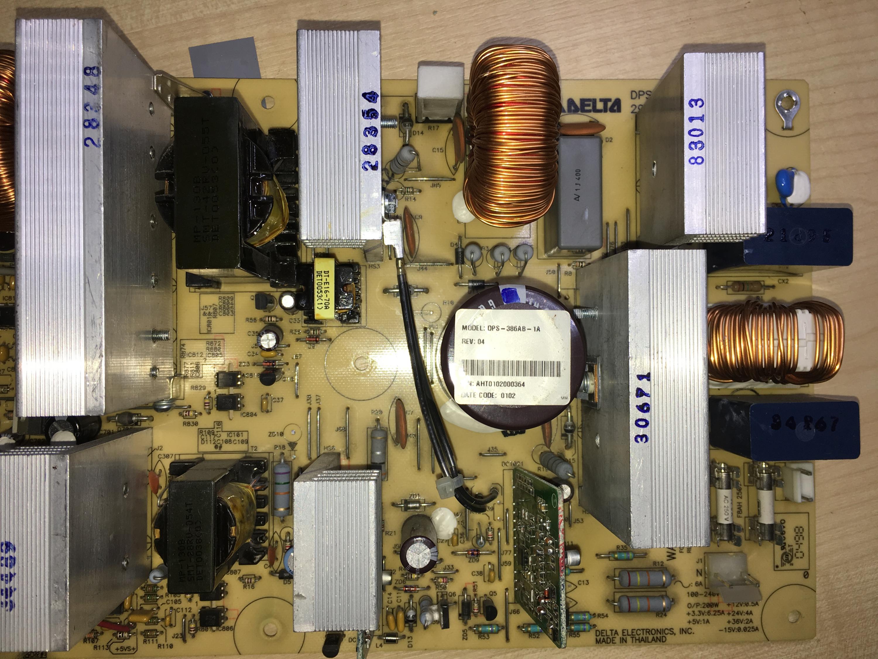

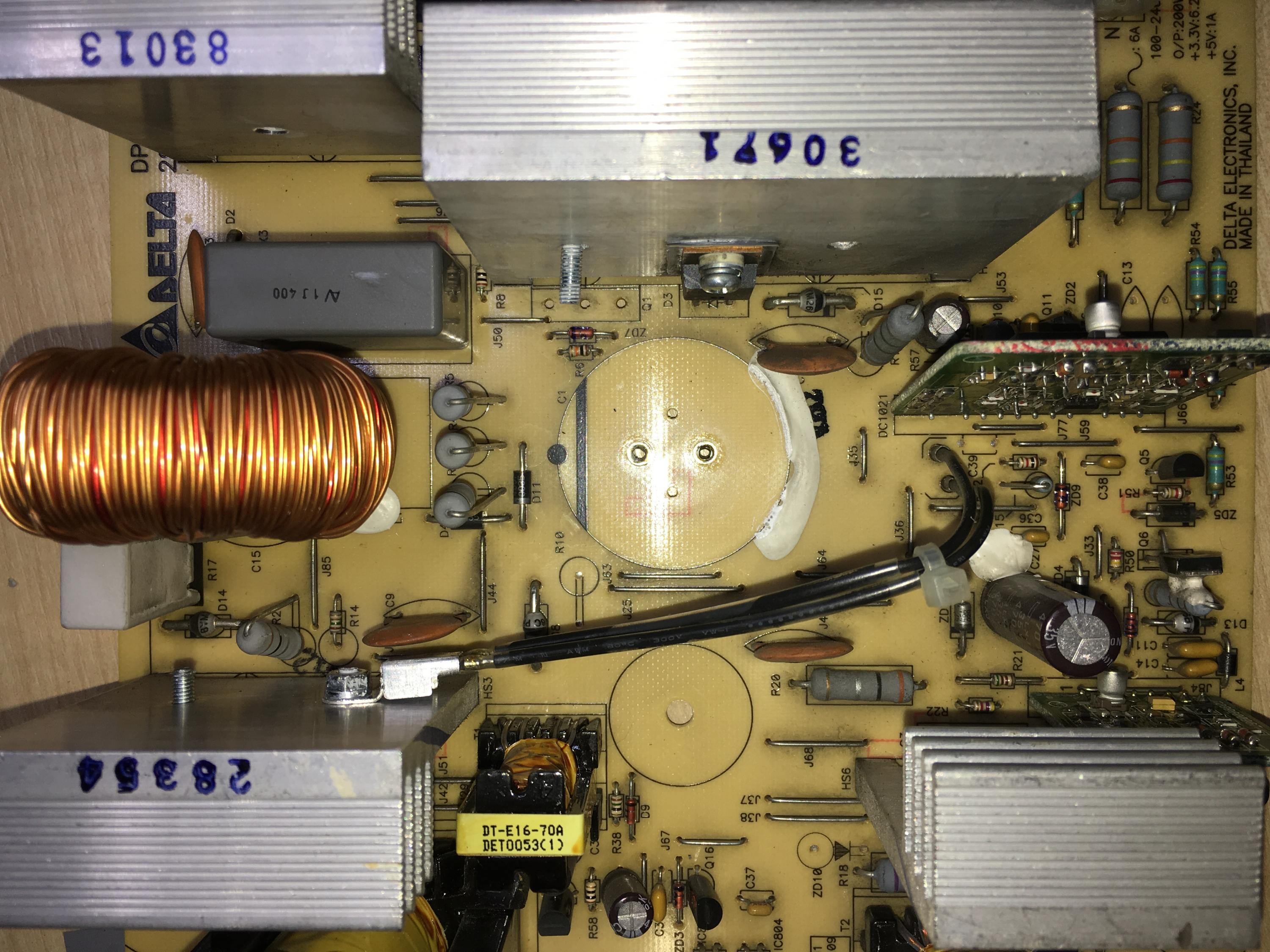

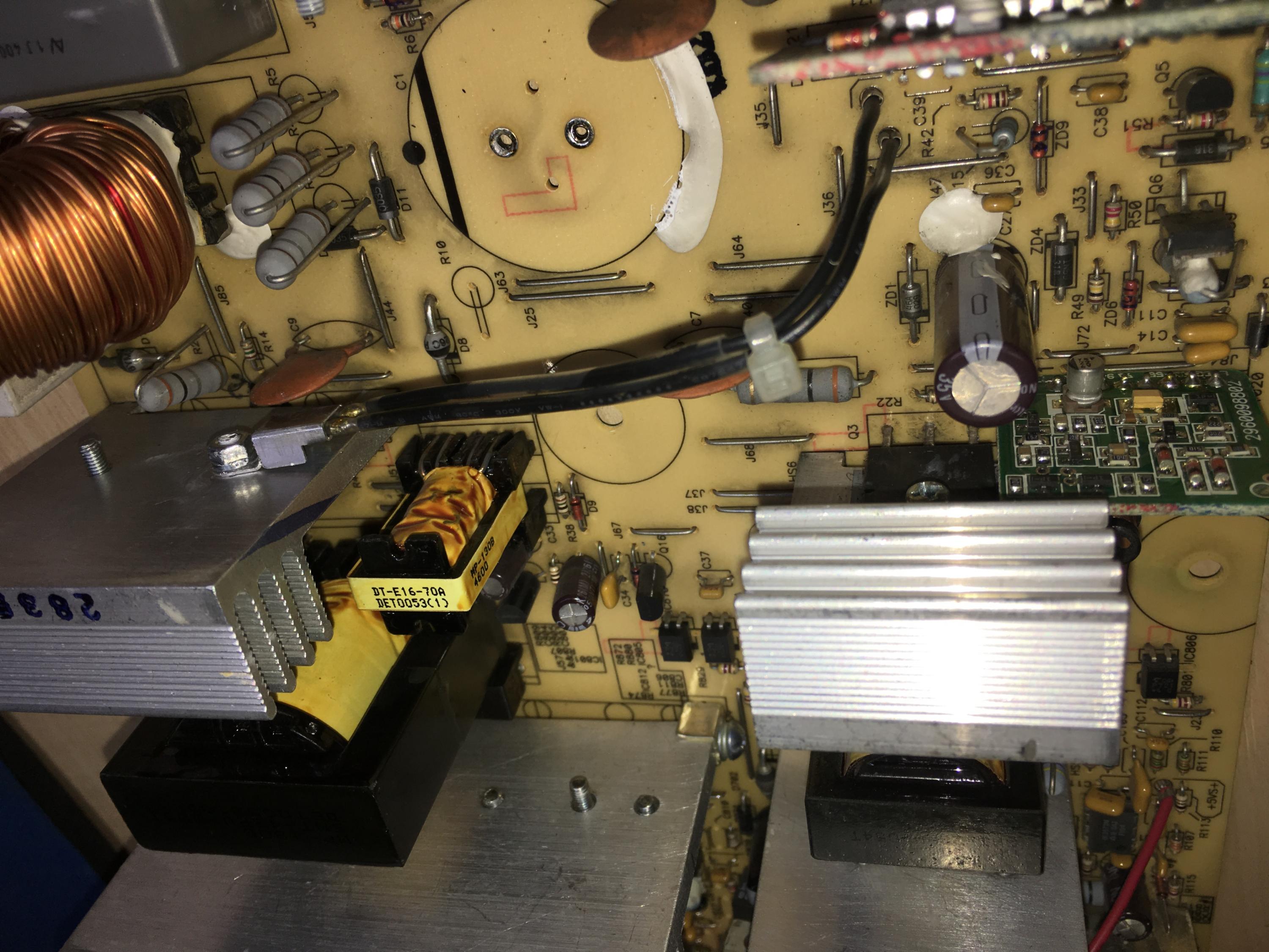

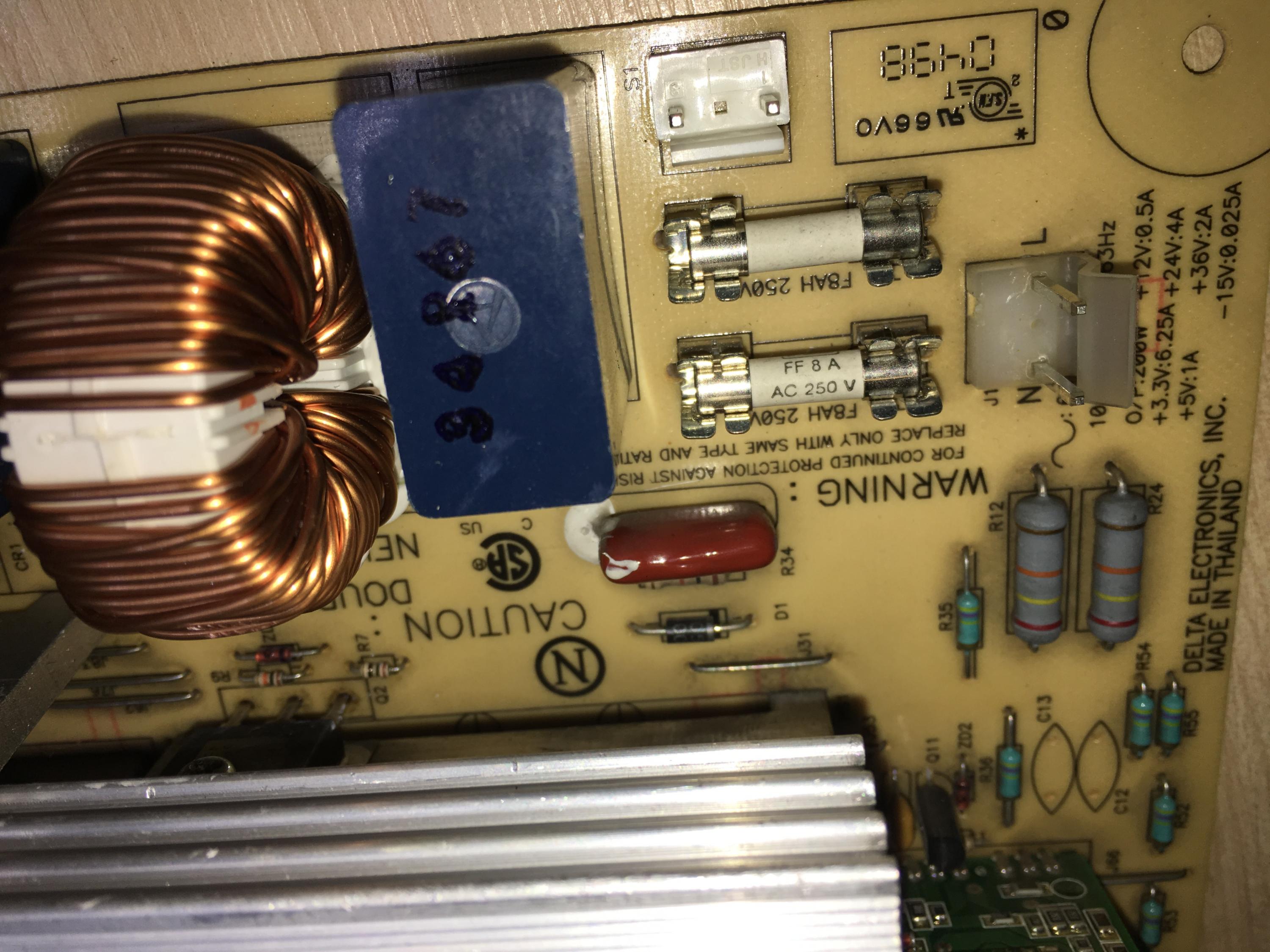

    Hi there,
    I have a problem with my DPS386AP Power Supply, it blew up the fuses after turning on, the same scenario after replacing them. Have found
    faulty MOSFET IRFP450 marked as Q1 on PCB (have checked all of them and all Diodes). Not sure about the rectifier bridge (KBU8K) shows drop of 0.507V and 0.505V on "-" and "~" and 0.944V on "-" and "+" (the last one I'm not sure about). What else can cause the MOSFET burnout? Any suggestions very welcomed. Thanks

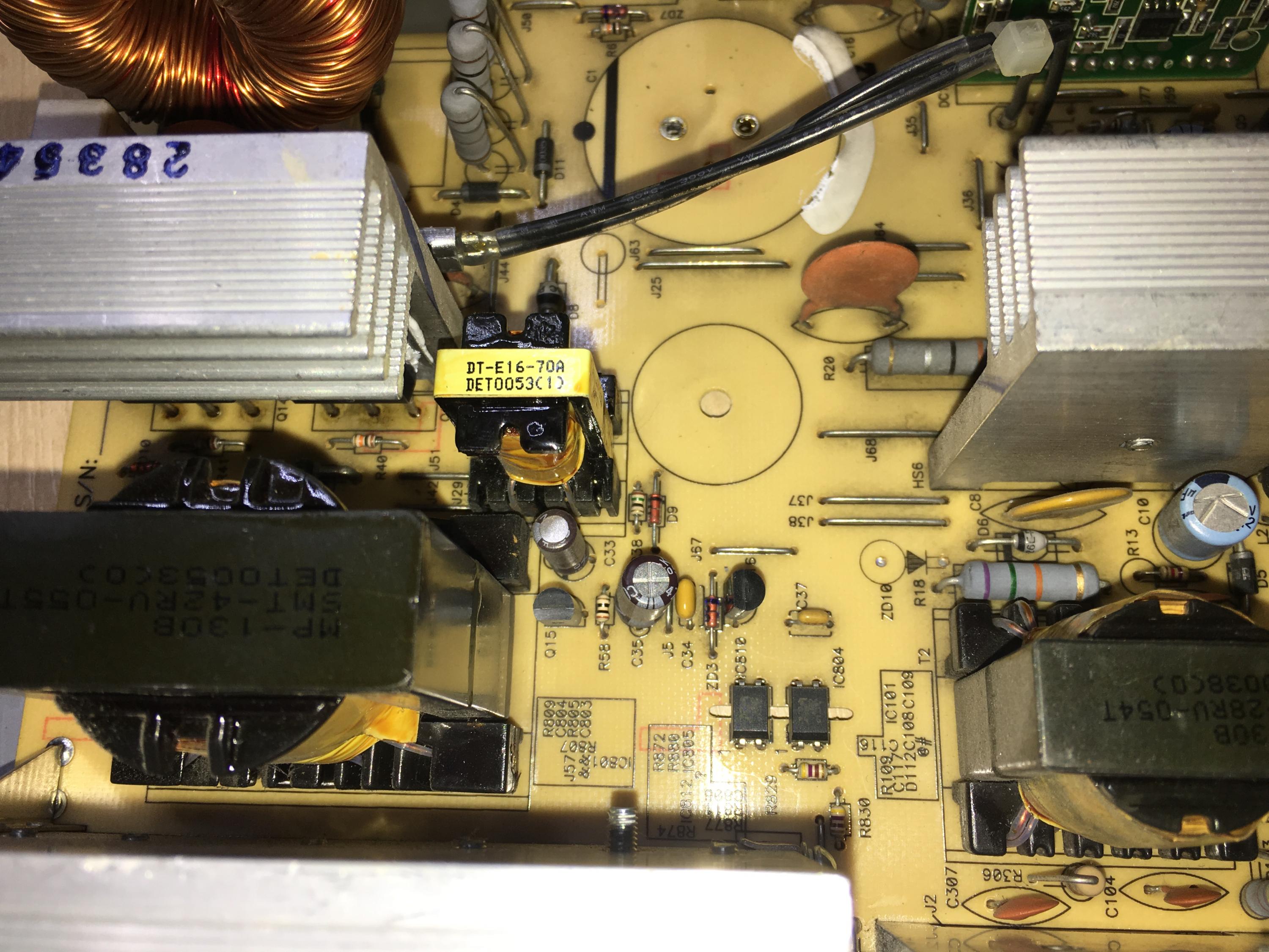

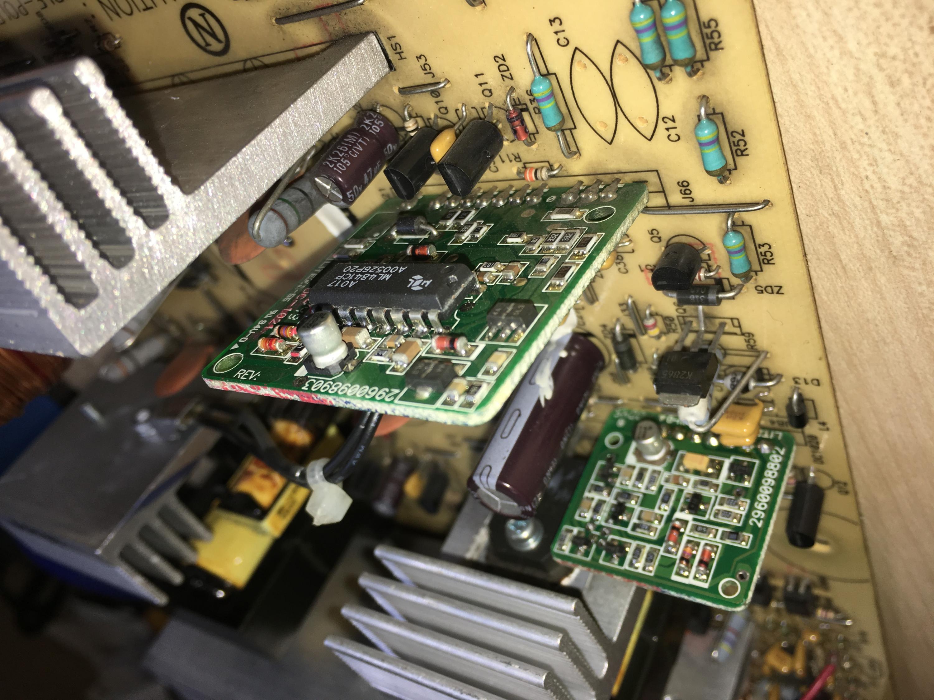

    The bridge is just 4 diodes in a single package, check each diode on its own. If the reading across + & - is low, its likely something else not the bridge, If the man cap has any voltage on it, it can throw off the reading.
    If the fets were shorted drain to gate, check the gate drive components, It looks like the gate drive ic is on the small sub board, it may have been damaged.

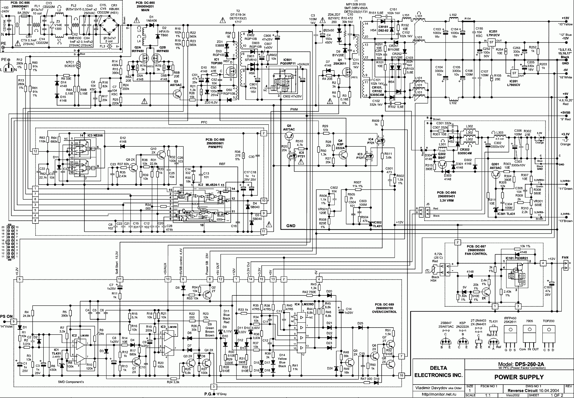

        But what is the VCC voltage? Also check the voltage on pin 14 Vref, it should be 7.5 volts.
        You can check the voltage on the output pin that feeds the fet, but to really check if the ic is ok you need to scope the output to see if it is producing an output pulse
        Download the ML4841CP pdf it may help since there is no schematic of this power supply.
        I found this schematic at danyk.cz/s_atx_en.html, it uses a similar drive ic, It might help?

          Hi, thank you for the schematics just have got time and the parts now, after replacement of the fet the supply is back to life the Vcc is 12.54 and Vref 7.49, PFC OUT 2.73V, PWM OUT 3.42V the source on the Fet is 124V, what else can I diagnose and it could lead to the fet failure. I have just got scope but don’t want to brake it as I heard about Isolating transformers need to be used wit it, cheers
