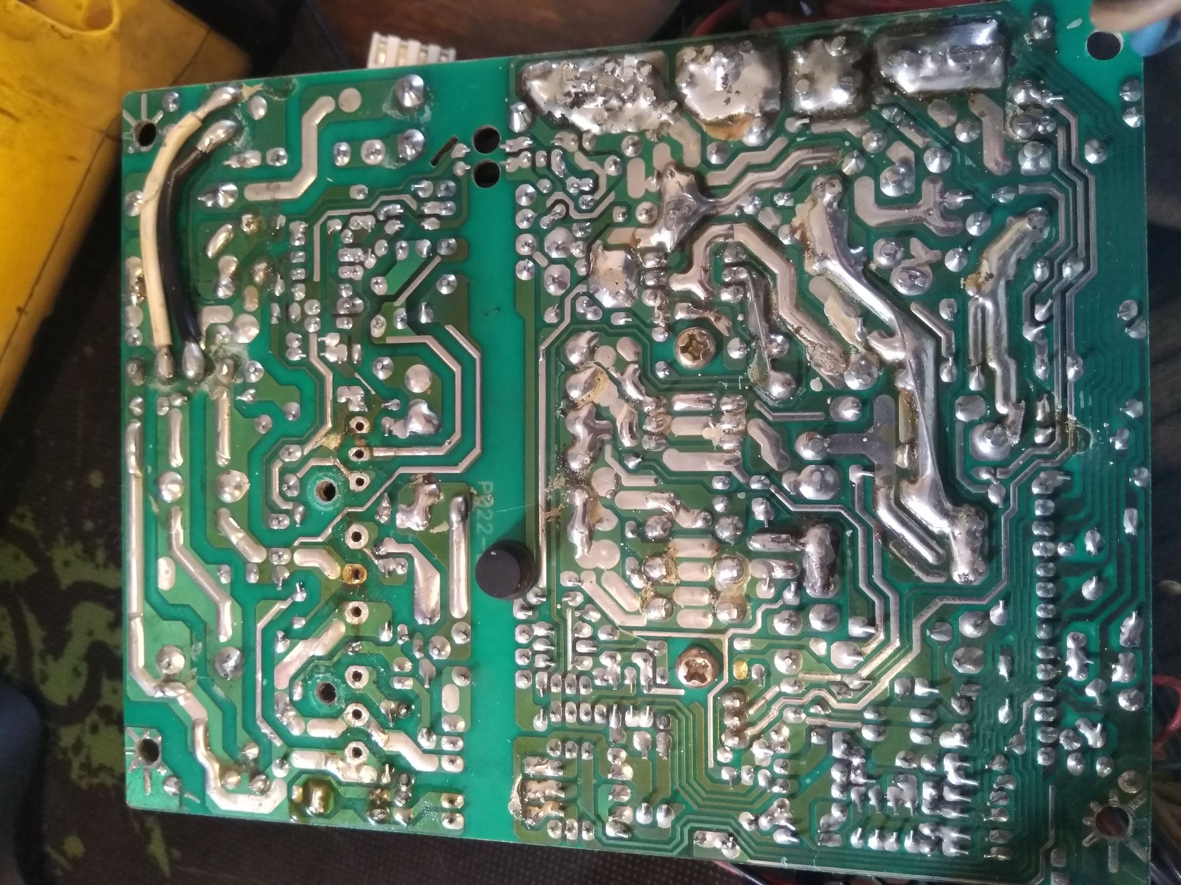

    I have a Tagan EasyCon 480W (TG480-U15) power supply.
    Unfortunately‚ (or not - I'm here now! ) it died so I decided to open it and take a look in hope I will find the culprit and give it another try in case I can fix it.
    By the way, I'm just a hobbyist, coming from automotive industry (automotive electrician) but as my (limited) knowledge is most of the time obsolete comparing it with latest tech trends, and I don't have experience with AC, most of the time you will find me searching / learning by following the tutorials, reading forums and some e-books, looking videos and so on... I want to learn but I'm not following any program.
    As for that Tagan mentioned above, first signs was broken fuse (it exploded) and destroyed Thermistor (https://i.imgur.com/LQSBlIo.jpg ; https://i.imgur.com/1mpkHKI.jpg). As I was lazy enough - I've invested some time just to replace that 2 components and tried to turn it on. Was under impression that Thermistor tired over time and lost the "agility" (didn't even check if that component was in short) so I thought that was that - easy peasy...
    Than it happens again - fuse died (exploded) - burnt into dark color and this time even "automatic fuse" (circuit breaker) on that AC line in home reacted and switched off! It was clear that I had to explore it more which I did, additionally.
    After some quick (bit this time more serious) inspection, I've found that fuses on Primary are shortened, so there was a short circuit on the Primary, just after filtering unit. At first, I've de-soldered / dismantled a couple of diodes but all of them was good.

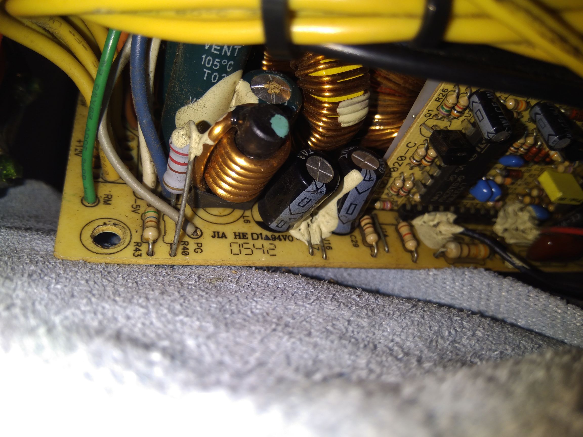

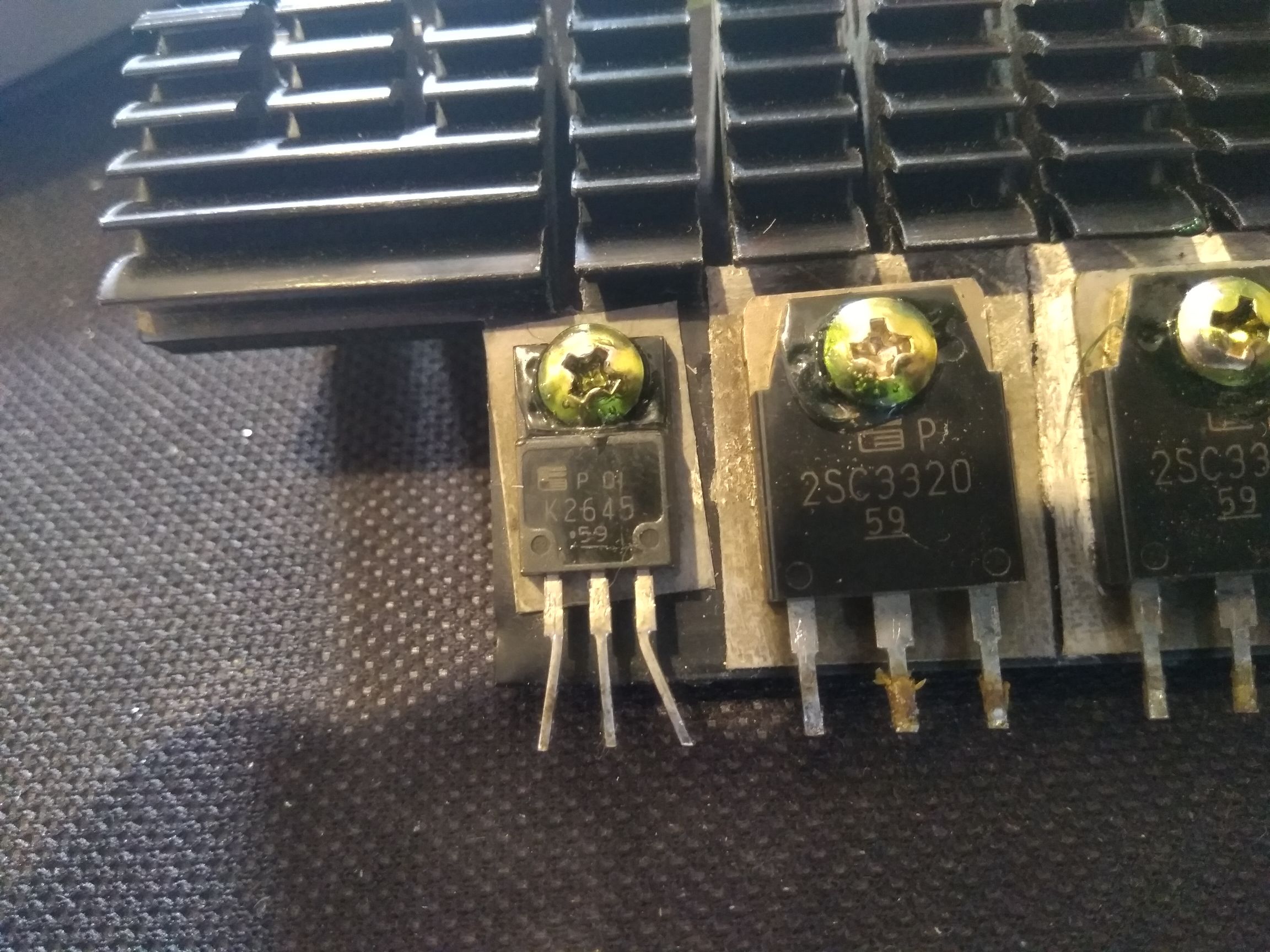

    After all, when FETs (2SC3320 - NPN power transistors) on Primary was removed, I've found that circuit is not in short anymore but both of that NPN's are in short on all three legs.

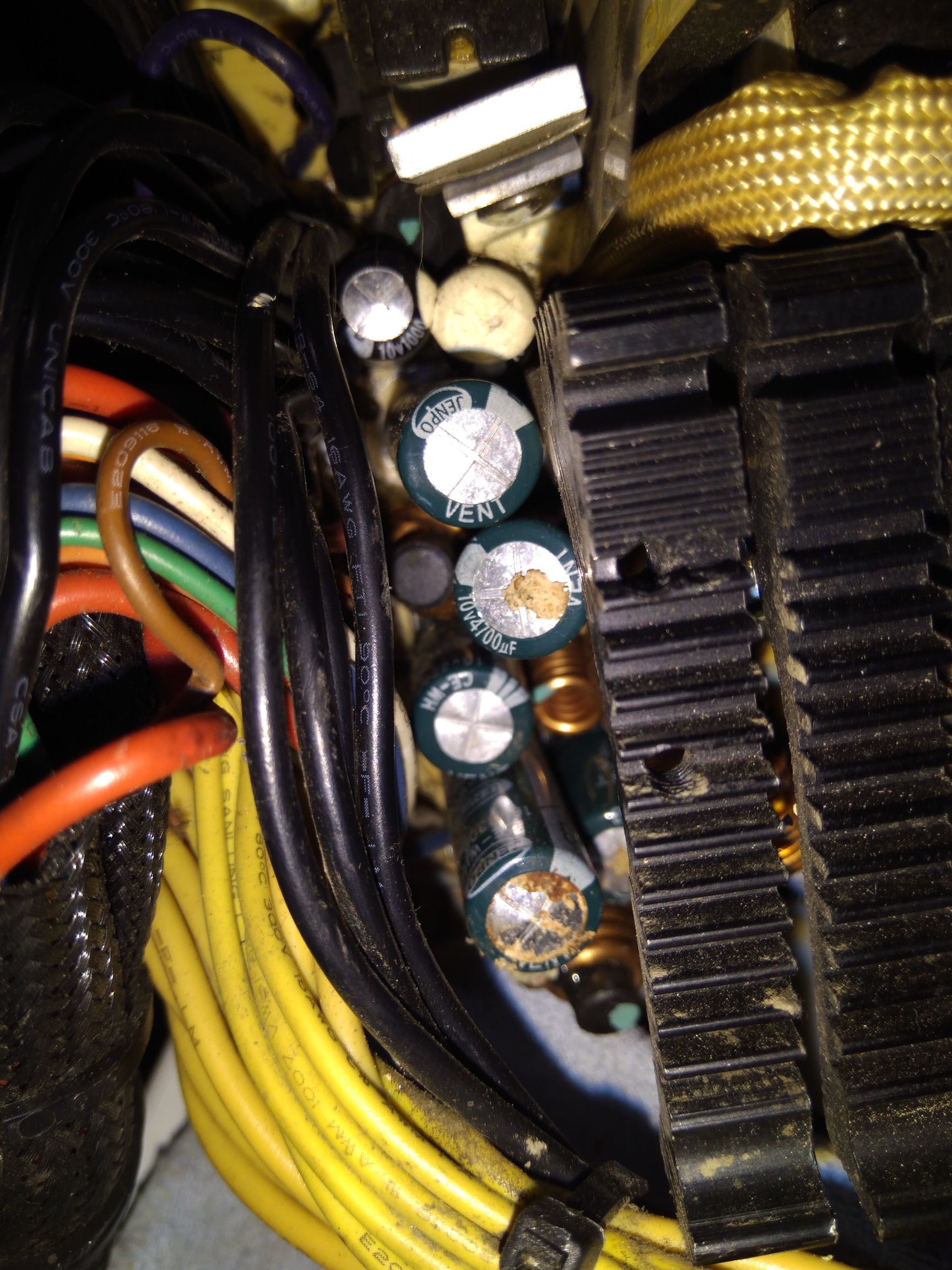

    So I have decided to order those 2 and replace all the cap's on the Secondary as some of them got "bloated" (bulged, bubbled) and seems like they are not happy anymore . I'm always (trying to) sticking to that electronic proverb: "When in doubt - change it out!"
    There is one more 3 leg component - another MOSFET - K2645 - which I checked with "Quick & Dirty MOSFET Test" - and it seems to be OK.
    Now, while I'm waiting for replacements to be delivered, I would like to ask you guys, for your opinion:
    • What could be the possible reason because they (both) died?
    • What could be the cause? Aging? Overloading? Something else?
    • Do I have a reason to suspect that they pulled off something else with them?
    • In case I have to buy some capacitors - shall I go for "low ESR" ones and if so - why?
    In the meantime, if you can imagine from what I've just wrote, level of my (in)experience - do you have any other suggestions for what needs to be checked, reviewed, inspected - if you write a sentence or two - I would really appreciate that!
    Looking forward hearing from you!

    As for the reason for the failure: it could be due to bad caps on the primary side.
    So I would check the primary side caps with a ESR meter.
    As for replacing the bloating Jenpo capacitors on the secondary ideally you should stay close to the original capacitors in the unit now, so the best is to find a datasheet...
    Is there some model number printed on the caps?
      Yes, use low-ESR capacitors. The ones specifically made for PSU use will last a lot longer and provide more clean power output.
      Generally, the capacitors you should go for is any of these:
      Nichicon PW, PS, PM, PJ, and HE*
      United Chemicon LXY, LXZ, LXV, KY, KYB, and KZE*
      Panasonic FC, FR*, FM*, and FS*
      Rubycon YXJ, ZL*, ZLH*
      * careful about using these in old PSUs, as they have ESR that is a bit lower than older PSUs may be designed for. Most old PSUs will still work with these (and often without any major adverse effects), but the output ripple could be worse than with the more "entry-level" low ESR caps, such as the ones listed above without the * symbol. With that said, the caps marked with * will be OK for the 5VSB circuit.

      Check all of the small components that are connected to the 2SC3320 transistors. In particular, check resistors for open circuit and diodes for short-circuit. Sometimes these can blow when the transistors do, but now always. In addition to that, there should be two small TO-92 -sized transistors on the secondary side near the two small transformers, along with some diodes around them. Check all of these. You may need to remove them from the circuit. Or if you want to try your luck, you can just put the new replacement 2SC3320 transistors in and see if the PSU works. If it does, then obviously those small transistors didn't blow. However, if they blew, the PSU may still appear dead or output only roughly 1/3 to 1/2 voltage or go in "hiccup" mode (i.e. tries to start then shuts down, and then repeats this again.)

        I have repaired 2 of these PSUs both with blown primary drivers. On both of them the pramary caps were dead so I would start there. You will need at least an ESR meter for this kind of repair. Also check the 2 caps that are connected to the bases of the primary drivers. They should be 50V and 1uf to 10uf I don't remember atm. Judging by the age of the PSU if they are not dead by now they are definitely dying. If the dry up the PSU will work with no load but will shut down as sosn as you try to draw a few watts
