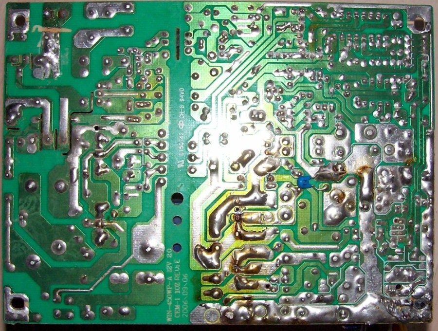

This ATLAS has pfc and somewhat decent buid, but it's clearly not going to do 400W. According to the markings it may be a DEER. That smd chip has "2003" written on it. Came with missing caps and blown mbr1645 on he 12V rail. Put and mbr2045 there and recapped it. Works.
