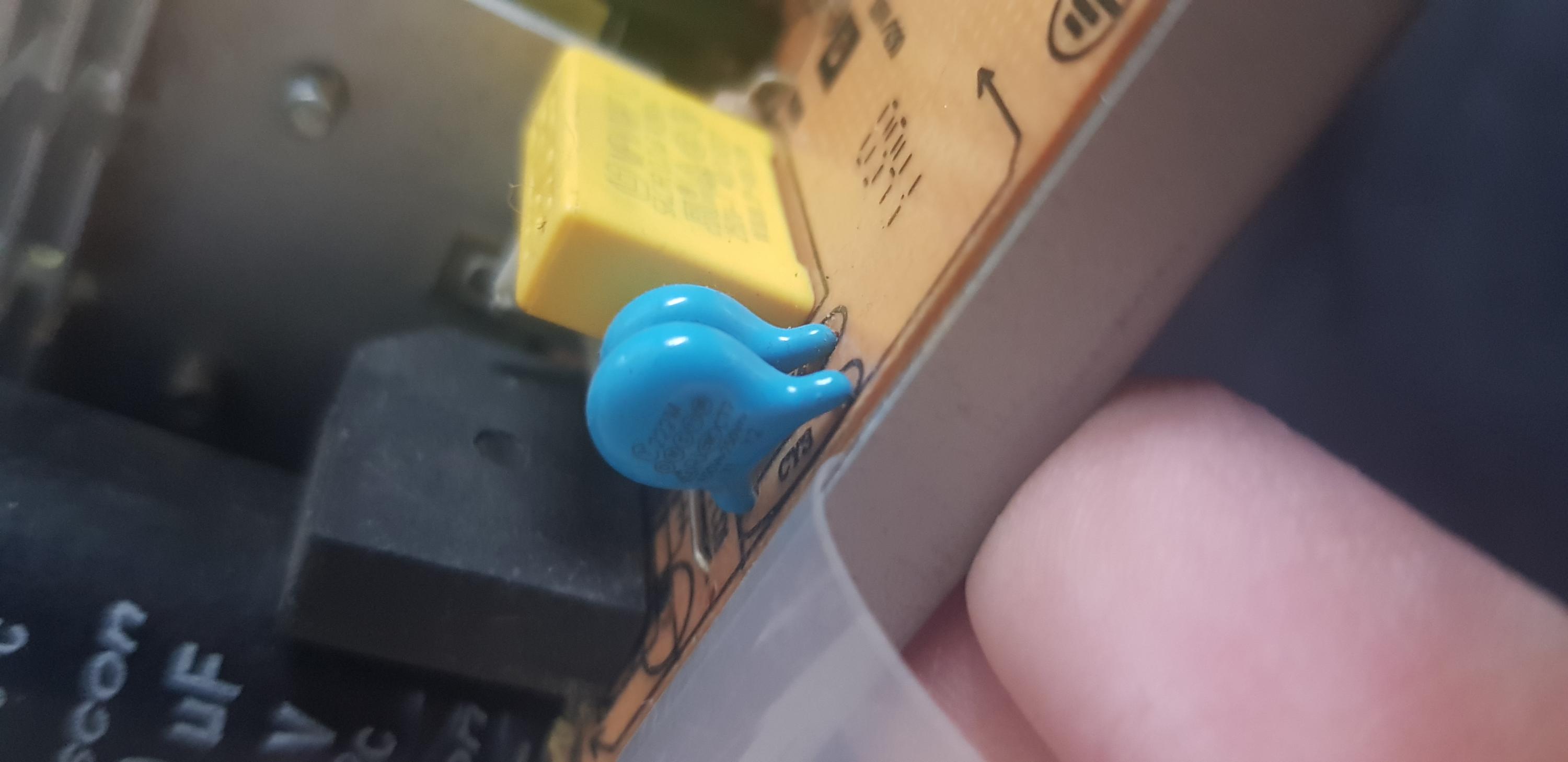

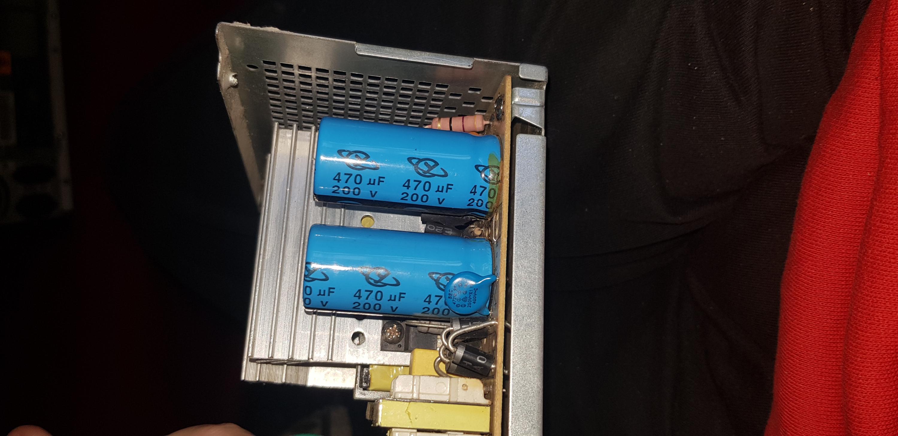

                          hello badcaps i was selling for a scrap a few psu and noticed one that was heavy, hmm i said, i opened up and i found a surprise, looks like a second brand from a psu manufacturer maybe? what do you think?
                          • pc7fan
                            • Aug 2013
                            • 52
                            #3193
                            Looks like a filled up Deer (full input filter and nothing seems to be omitted). If you fully recap this L&C/Deer (upgrade the primary caps to at least 470u for 250W if you have any laying around). Even if this has a 35 size transformer, the somewhat scrawny heatsinks themselves, the classic half-bridge design, and the single 80mm fan will limit this supply at 250W continuous.

                              #3194
                              200W.
                              I'll say this as long as necessary - don't be fooled about the ERL-35-2005 labeling and the transformer shape - that is a rounded ERL-28 transformer which Deer uses to fool people into thinking they have an actual 35 sized transformer. If you have trained eyes, you'll easily notice the rather big free space inbetween the main transformer and the one close to it. An actual 35 size trafo WILL FILL that space.
                              Also it doesn't surprise me it's Allied who does that. They've been doing this absolute BS of using rounded 28 size trafos for almost as long as I could encounter. The only Allieds I've seen that actually had real 35 sized transformers were usually either Modecom FEEL-III units and some of Thermaltake's Litepower units that were subcontracted to Solytech (not all Litepowers were Deers, by the way.)

                                #3195
                                Thanks for the answers, so its a realiable PSU so long 200~250w power consumption? Or it it's better to buy a generic 500w psu anyways? I was very curious because the main filter, and the other horizontal circuit, also kinda heavy.
                                thx for the patience

                                  #3196
                                  It will be good for 200W continuous. Again, that's a 28 size transformer you have there, not a 35 and not a 33 either. I've actually desoldered one of those fake 35 labeled size 28 trafos from an Allied rated a bit higher than yours by quite a lot ("400W", my ass!) and it did indeed read "ERL-28-2005 XF". Not sure what the XF meant.

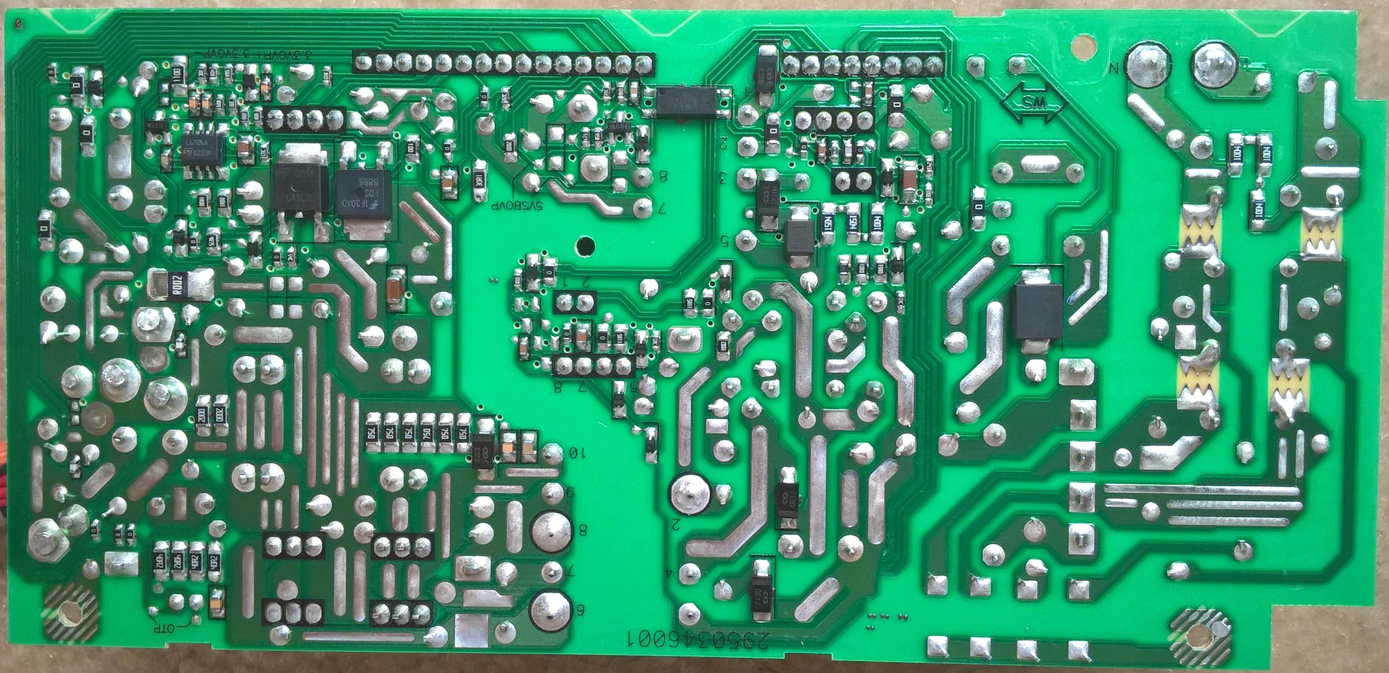

                                    Delta Electronics DPS-180AB-20 A [PCB DPS-180AP-20]
                                    It's been a while since I posted one of these, hasn't it.?
                                    I guess I will start with something mundane to get back in shape for posting more.
                                    For today's consideration is a Delta Electronics DPS-180AB-20 A, rev. 0B small form factor PSU from an HP Slimline 450-120KL SFF desktop. HP P/N is listed as 793073-001, if that's of any importance to anyone.
                                    Case pictures shown below… as you can see, there's not much to this PSU. All it has is a 24-pin ATX connector, a 4-pin 12V CPU connector, one regular SATA power connector, and one mini-SATA 5V-only power connector for the optical drive in the system. All wires are 20 AWG, except the 3.3V rail + signal wires on the ATX connector and the mini-SATA 5V-only, – these are 24 AWG.
                                    Next, let's look at the label. The PSU is only rated for 180 Watts of power, which isn't a whole lot. 5V and 3.3V rail are rated quite low at 10A and 7A respectively… and 70 Watts total combined. But note the rating for the 12V rail: it's stated to do up to 15 Amps, which is 180 Watts alone. This suggests the PSU can output all of its rated power on the 12V rail… so definitely not a “retro PC” unit. It's also 80 Plus Bronze and full-range input (meaning it has APFC.)
                                    Anyways, let's have a look inside.
                                    Seems almost gutless for 180 Watts… but in reality, it's just a modern and efficient PSU, so it doesn't need very big components for such output power. Also, it's a Delta after all. So I doubt anything on the label would be a lie. PCB model says DPS-180AP-20.
                                    In the above picture, the lower-right quadrant contains the input filtering (2x CM chokes, 1x AC wires ring choke, 1x 0.1 uF X2 cap, 1x 0.22 X2 cap, 4x 1.0 nF Y2 caps, and 2x 1.5 nF Y2 caps), APFC booster coil (note blue HF core material), and 5VSB supply.
                                    In the upper-right quadrant is the bridge rectifier (GBU408), main filter cap (450V, 120 uF), and main transformer (size 28). Here's a better picture of these:
                                    Going back to the picture before the last one again… left side of the PSU board has, from top to bottom: secondary heatsink with rectifiers, output toroid filter, and output caps. Here are two alternate shots:
                                    Next, an up-close picture of the secondary side heatsink + rectifiers (2x STPS20L60CT in parallel for 12V rail and 1x STPS40L45CT for the 5V rail):
                                    And here is the output side:
                                    12V rail is filtered with 2x 2200 uF caps (without a PI coil in between them) and 5V rail with 1x 1500 uF + 1x 1000 uF caps (with a 6.5-turn, 3mm core PI coil). The 3.3V rail is a little more special – it is DC-DC –generated from the 12V rail. On the input, it has a CapXon PL series 16V 470 uF cap connected to the 12V rail via. a PI coil (same type as the 5V rail one.) On the output, it has 1x 1000 uF + 1x 1500 uF caps. The 5VSB has 1x 2200 uF and 1x 680 uF caps with a PI coil in between.
                                    By the way, note again the blue core of the output toroid. Not sure what it is, but I guess the standard -26 and -52 material cores from Micrometals are not a thing anymore. Only the black core toroid (L303) for the 3.3V DC-DC supply is something I know – Micrometals -45 (all black.)
                                    On the bottom is a daughterboard that runs between the primary and secondary, and contains all of the control ICs. PWM + APFC IC is CM6802 and the supervisor is an Infinno iN1T406-ddg (?). 5VSB is generated from a TNY286pg.
                                    Here is also a picture of the solder-side of the PSU PCB:
                                    This one shows the 3.3V rail DC-DC single-phase PWM controller is an ST L6726A.
                                    And finally, a picture of the fan – a 50 mm Yate Loon D50SH-12C, rated for 0.27 Amps at 12V.
                                    That concludes it all for this PSU.

                                    ICs:
                                    * APFC + main PS PWM: CM6802
                                    * supervisor: Infinno iN1T406-ddg (?)
                                    * 5VSB off-line PWM-FET: TNY286pg
                                    * 3.3V rail DC-DC PWM (single phase) controller: ST L6726A
                                    Secondary Side:
                                    * 5VSB
                                    *** 1x Ltec LZG, 10V, 2200 uF, 10x20 mm before PI coil
                                    *** 1x Taicon PW, 10V, 680 uF, 8 x 15 mm after PI coil
                                    *** PI coil: 10-turn, 3 mm core, 20-22 AWG wire
                                    *** 3-5A (?) schottky diode for rectification
                                    * 12V Rail
                                    *** 2x United Chemicon KZE, 16V, 2200 uF, 10x20 mm, no PI coil
                                    *** 2x STPS20L60ct (TO-220) schottky rectifiers in parallel
                                    * 5V Rail
                                    *** 1x Taicon HH, 10V, 1500 uF, 10x16 mm before PI coil
                                    *** 1x Ltec LZG, 10V, 1000 uF, 8x20 mm after PI coil
                                    *** PI coil: 6.5-turns, 3 mm core, 18 AWG wire
                                    *** 1x STPS40L45ct (TO-220) schottky rectifier
                                    * 3.3V Rail (DC-DC regulated from 12V rail)
                                    *** 1x CapXon PL, 16V, 470 uF, 10 mm dia., connected to 12V rail via PI coil with 6.5-turns, 3 mm core, 18 AWG wire
                                    *** 1x FDD8896 MOSFET (TO-252) on high-side and 1x D514 GA5C2C MOSFET (TO-252) on low-side
                                    *** 1x Ltec LZG, 10V, 1000 uF, 8x20 mm + 1x Taicon HH, 10V, 1500 uF, 8x20 mm
                                    *** Micrometals -45 material toroid
                                    * -12V Rail
                                    NONE – this PSU does not have a -12V rail.

                                        What's with output rectifiers' current ratings being higher that the safety label current ratings for the 5V and 12V outputs! [/sarc] More seriously, my guess would be for the lower forward voltage, i.e. efficiency and lower heat dissipation.
                                        I notice the one 12V rectifier that is fully visible has ferrite beads on the leads. These may take care of the spike noise the ferrite rod inductors filter out.
                                        PeteS in CA
